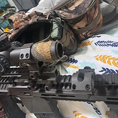

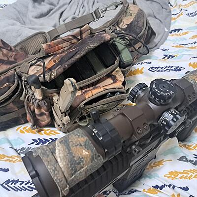

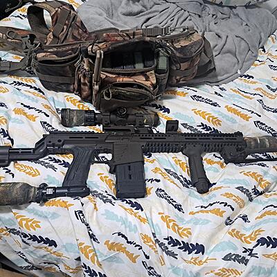

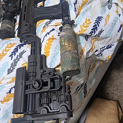

                        Here is one of my semi auto FSR Platforms. So I found the BEST sniper rig happens to be in Real Tree so I colored all of my FSR shooters that use DAM mags to match. The supremacy comes with caps and a honey comb and quick dial for Magnification. I found that little 9ci tank to go with my adjustable stock.
                        This gallery has 4 photos.
