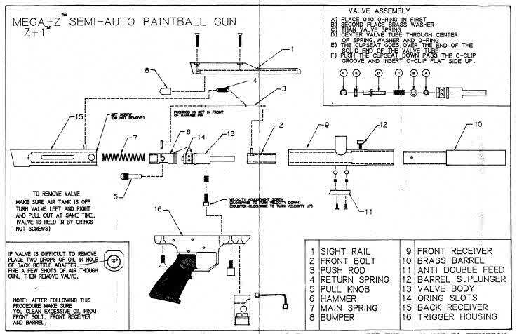

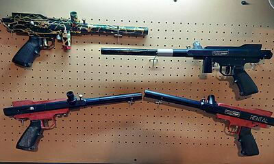

    Ok, so I have four Z1 projects that I am working thru. 2 "Rentals", 1 original MegaZ, and one "converted" MegaZ. (Would love to add a stock Z1 to my collection if anyone is willing to sell.)
    I see Doc has the "rebuild" kit, and I will most likely pick up at least a couple of those, but what I really need is a parts list/manual. The detent springs are rusted out, and while I'm sure I could find something suitable in the parts bin, I'd like to know what the originals are. I am also needing the bumper. I have 4 Z1 projects to work thru, and really don't want to have to buy 4 rebuild kits just for the bumpers.
    I also want to replace some of the more rusted screws so would like to know what sizes they are.
    Anyone have a parts list/manual by chance?

    Ask and you will receive.
    Click image for larger version  Name:	montmanual1.jpg Views:	0 Size:	57.6 KB ID:	391697
    Unfortunately they are no specific sizing of any of the components.

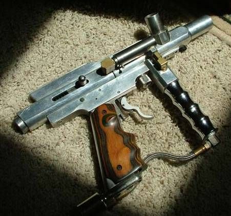

                For reference, these are what they look like: 3-rd party, and factory:

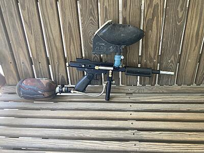

                    • 1299
                    Nitro’d Z1 with the factory volumizer and vert asa. Has the long hammer and an unstamped valve that I modified a bit( enlarged the valve body ports mostly). Ninja SHP into the palmers stab running at about 800psi. This sweet spots around that, and I’m pretty happy to be averaging 300 fps with the velocity adjuster all the way out. I’m hoping to use this quite a bit this summer.
