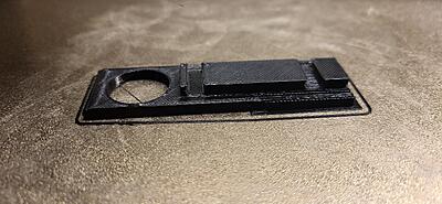

            80F100 Not really. I need a magazine, less I play single shot with it. I bought a MCS pistol mag, and the mounting pins aren't the same. I thought I had a lead on a miltech mag, but no dice.
            I've been trying to design a 3d printed adapter plate to make mcs mags work on this beast, but I am just eyeballing dimensions and editing the model. I'm at Rev 2 and it's still not right. Once I get the adapter usable I'd put the files up for others to print.
