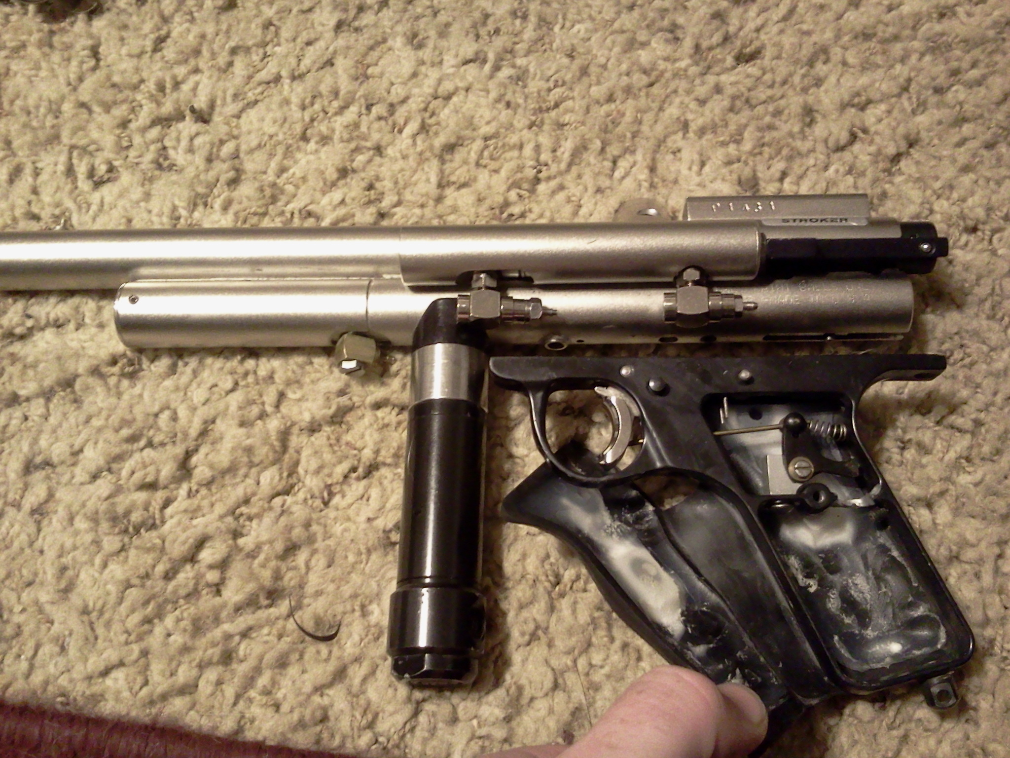

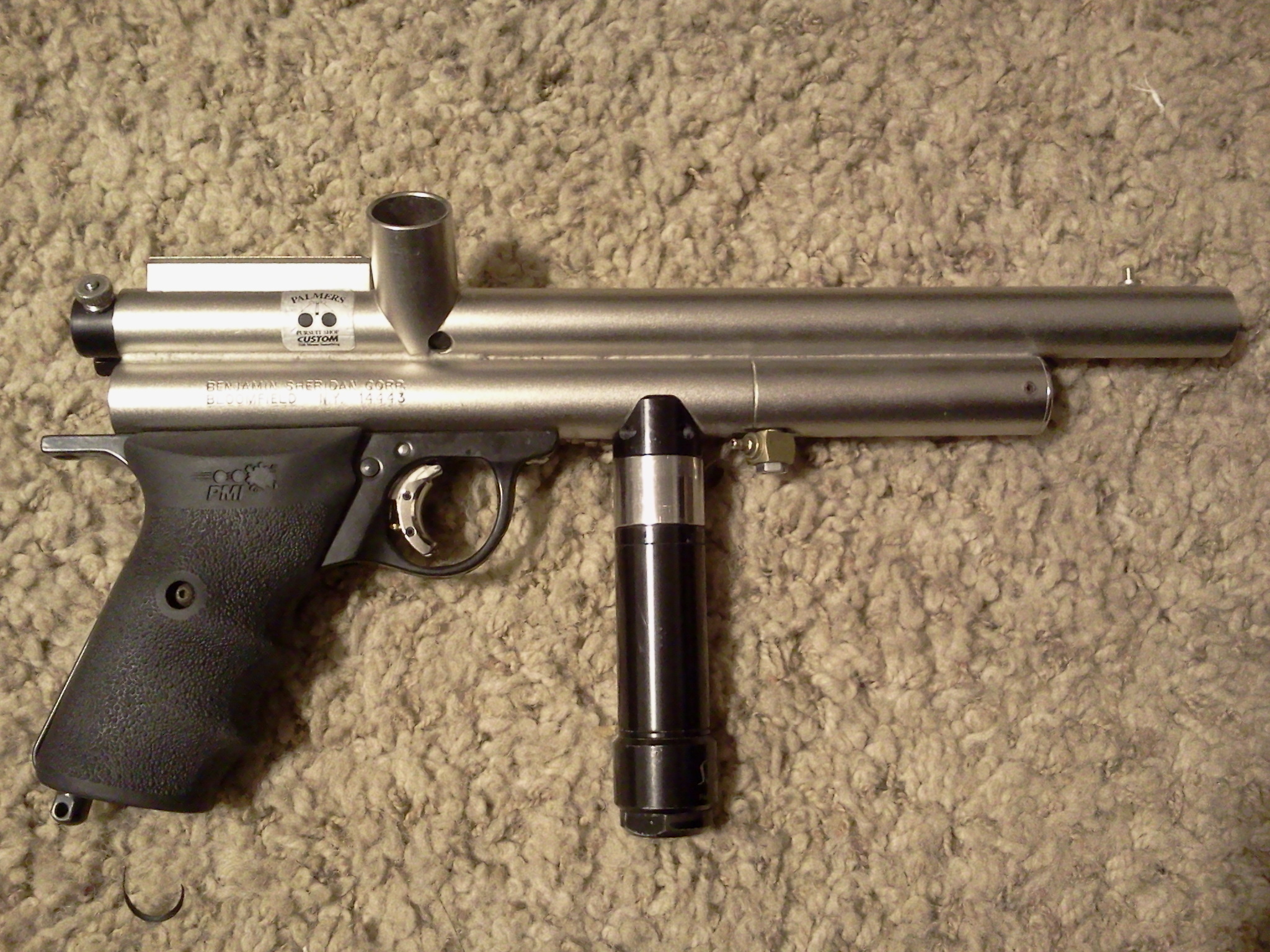

Picked up a PPS Stroker at Super game without a frame, RVA, or hammer. Found a frame later, but not sure if I need to cut the front tang off the frame so I can slide it forward in order to get the rear grip frame screw in or not. Other strokers I've seen the lower tube sticks out further and isn't flush like mine. Either that or I need a different style longer RVA that is tapped on the bottom for the frame. Both ways would work I'm sure, but it would change the hammer to sear lock up location. The bolt is also unfinished without a lug to interact with the hammer, or ports for air flow, dimensions off another would be appreciated. Thanks.
PPS Stroker Info Needed
Yeah,you wanna cut the front tang off to get the frame in the proper spot. -

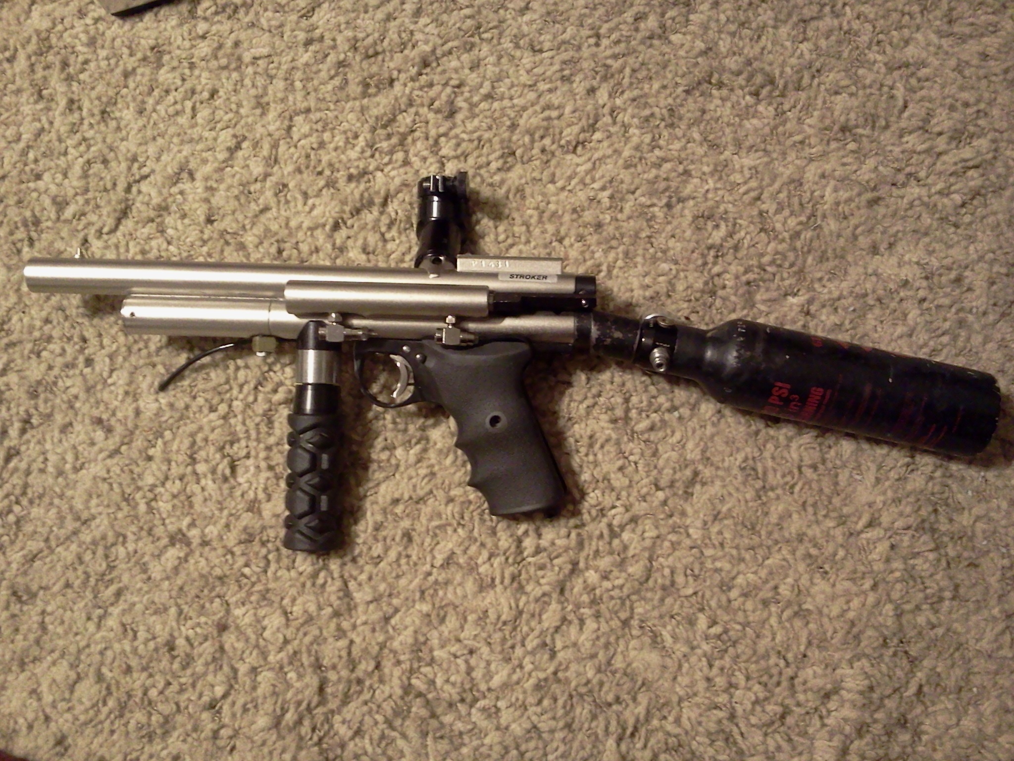

All right, well got it ground off, sanded and polished, apart from missing paint you cant really tell. Going to run it with a back bottle adapter, and I'd like to hard line it to a gas through vertical grip, unless I should add a regulator but I'm guessing it needs to be run at the standard 800ish psi for sheridans. I pulled the valve out, looks like it was already modified with larger porting for HPA.Attached FilesComment

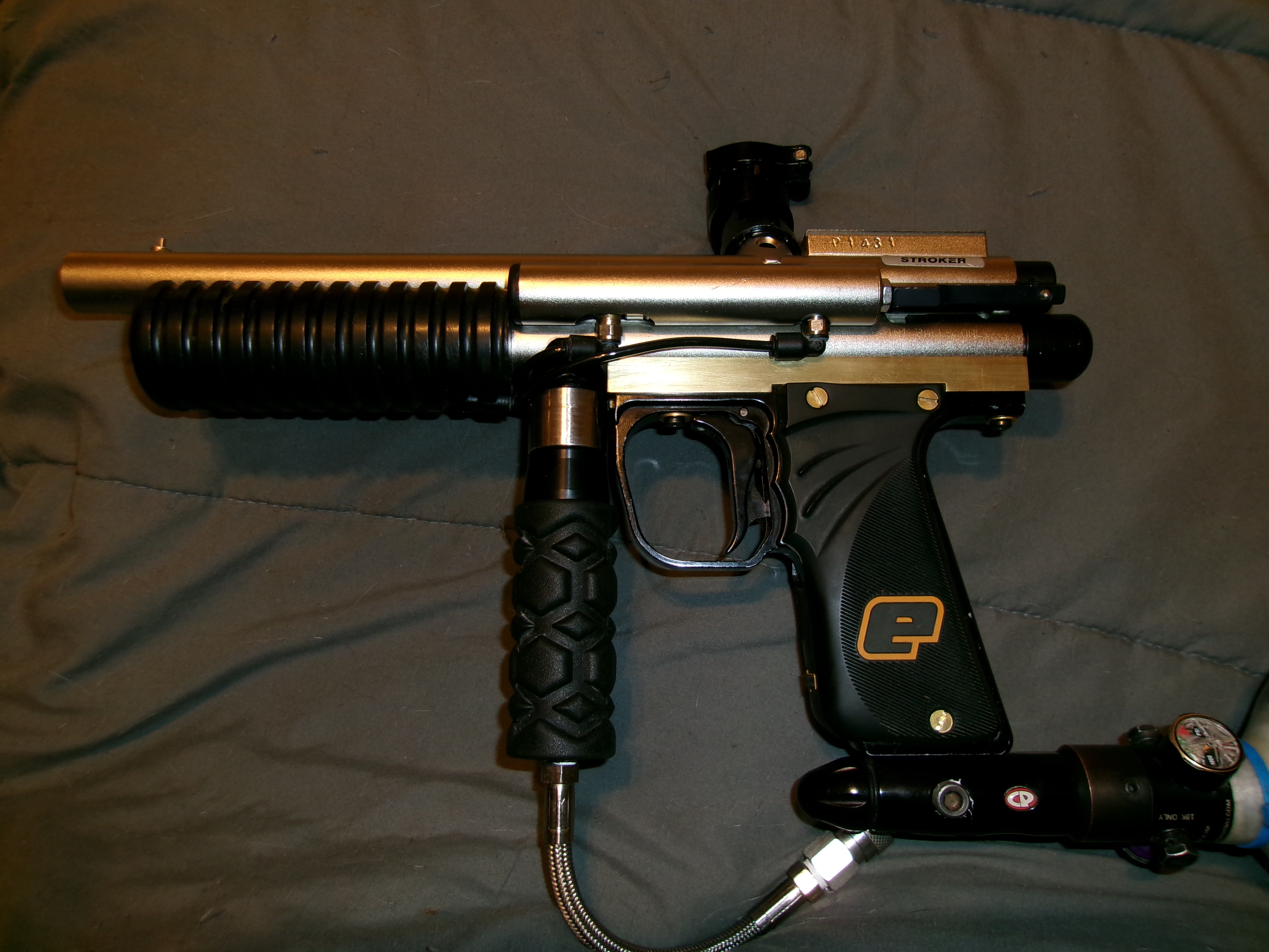

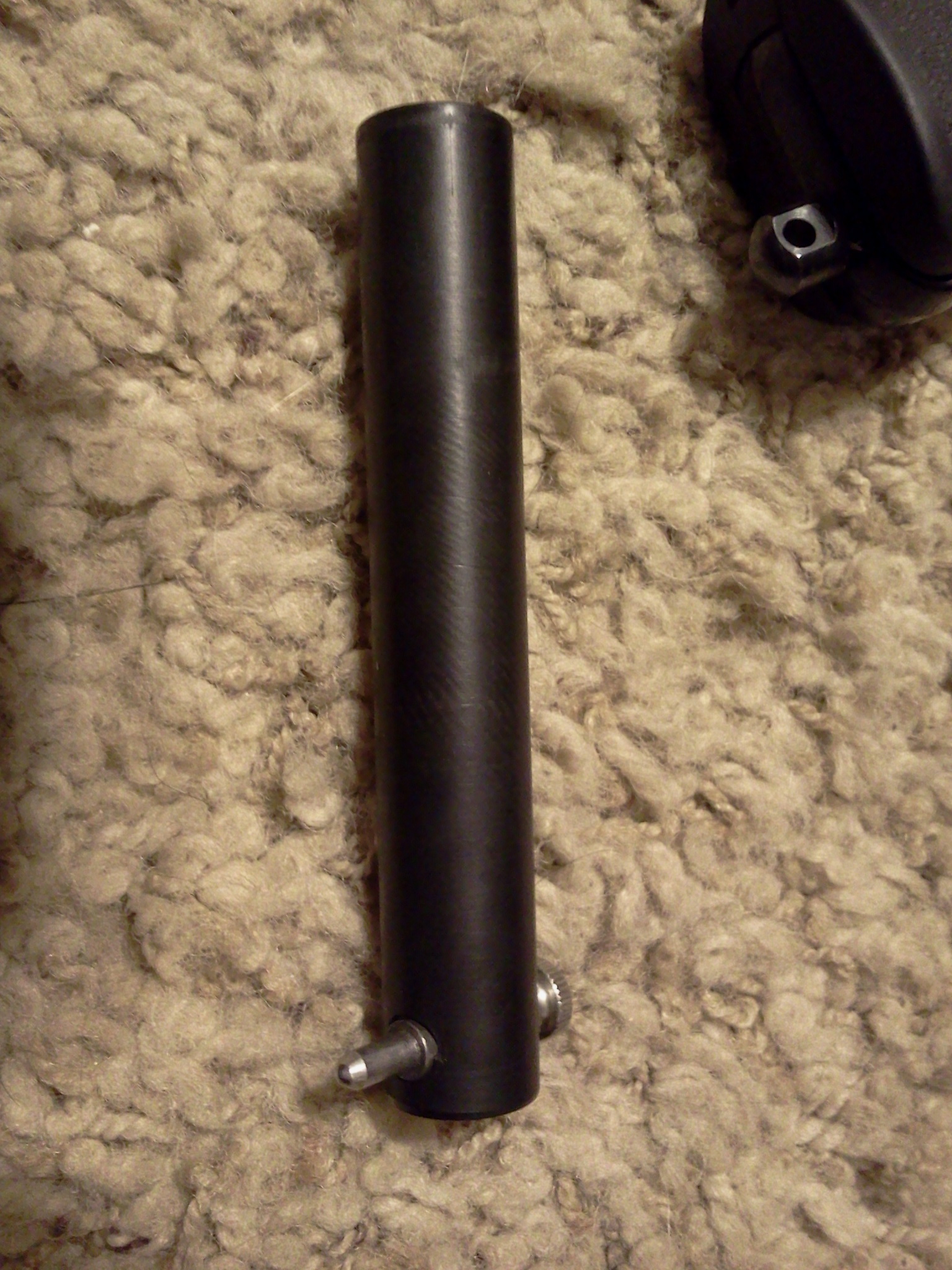

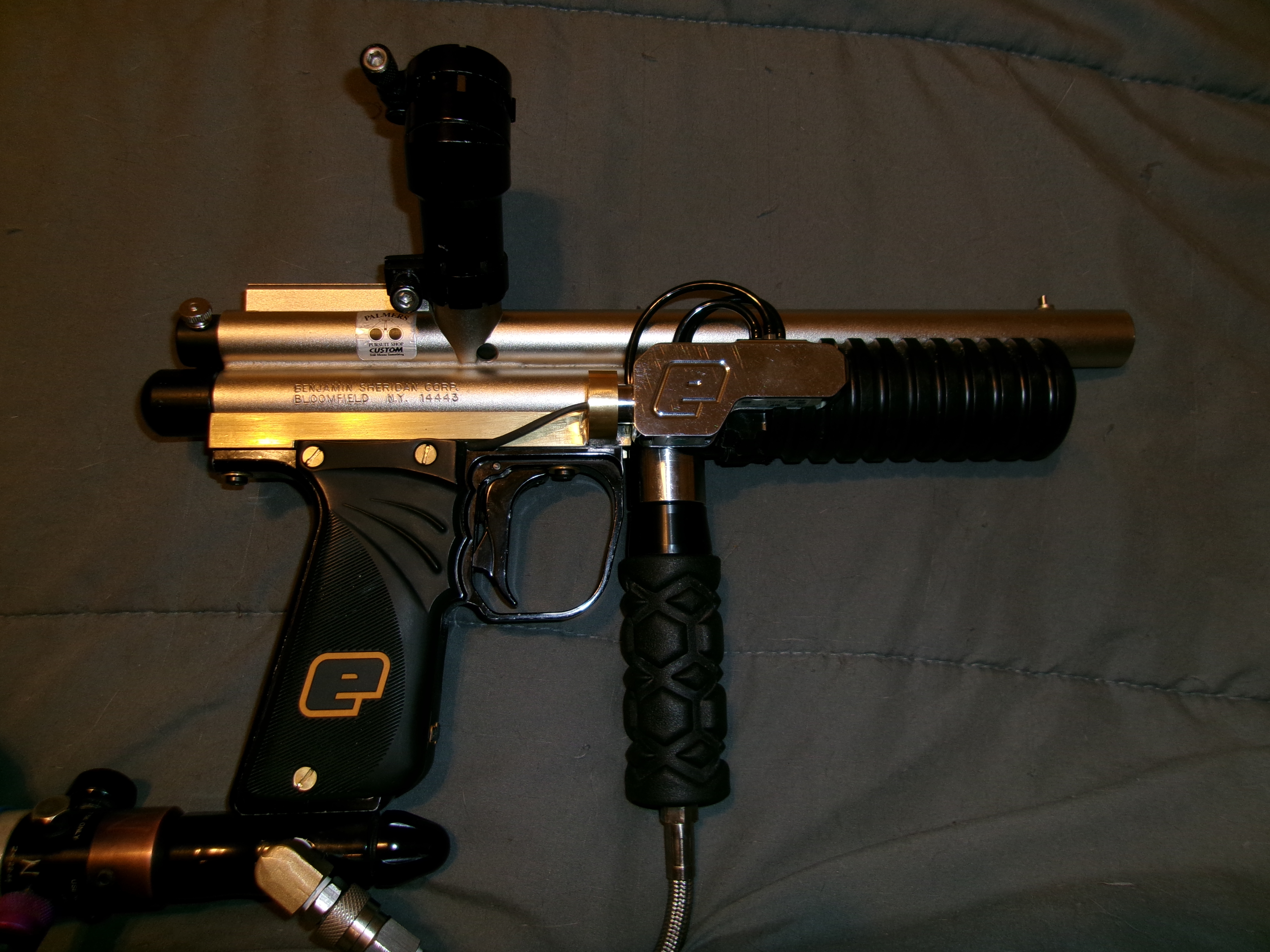

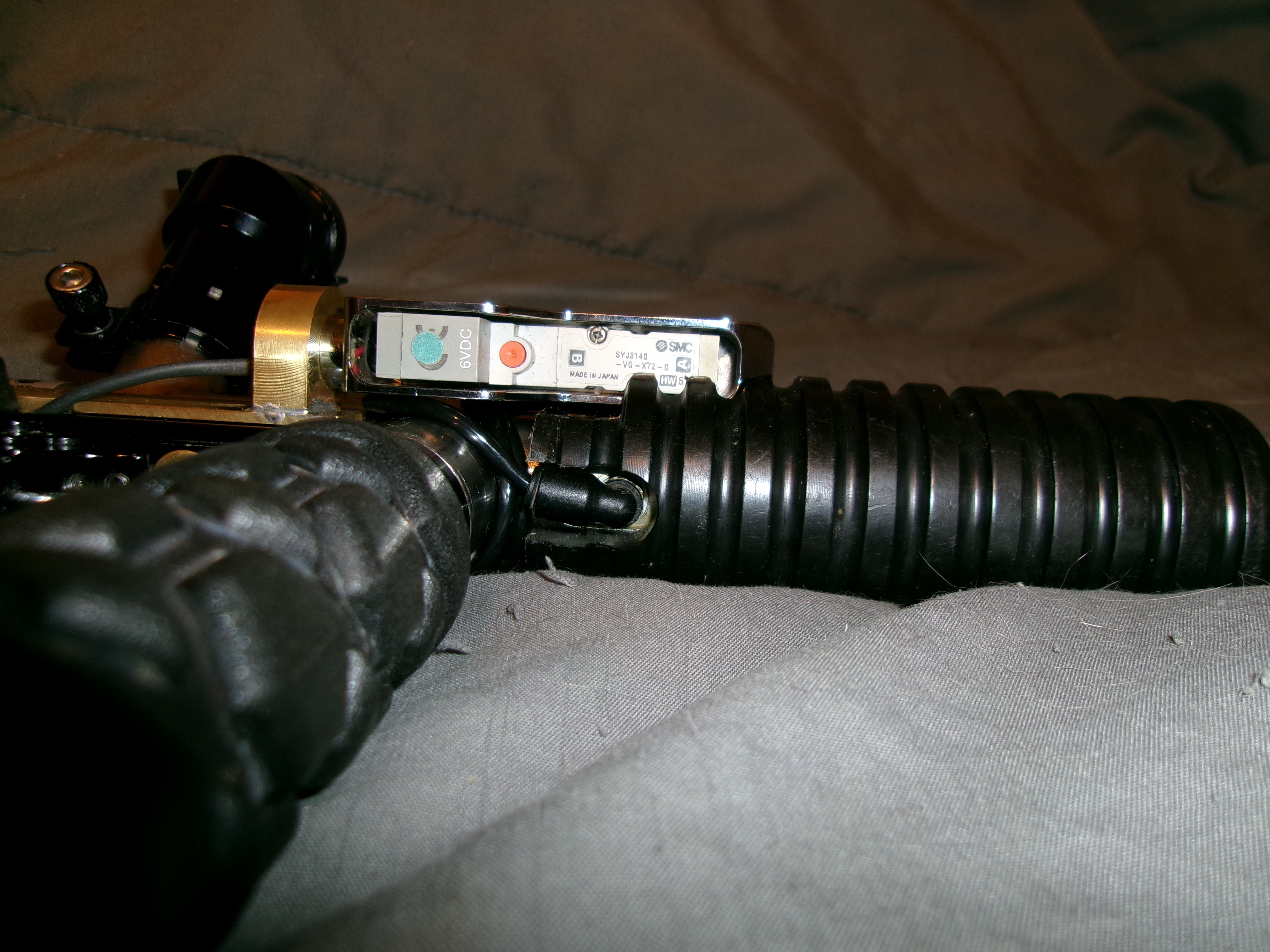

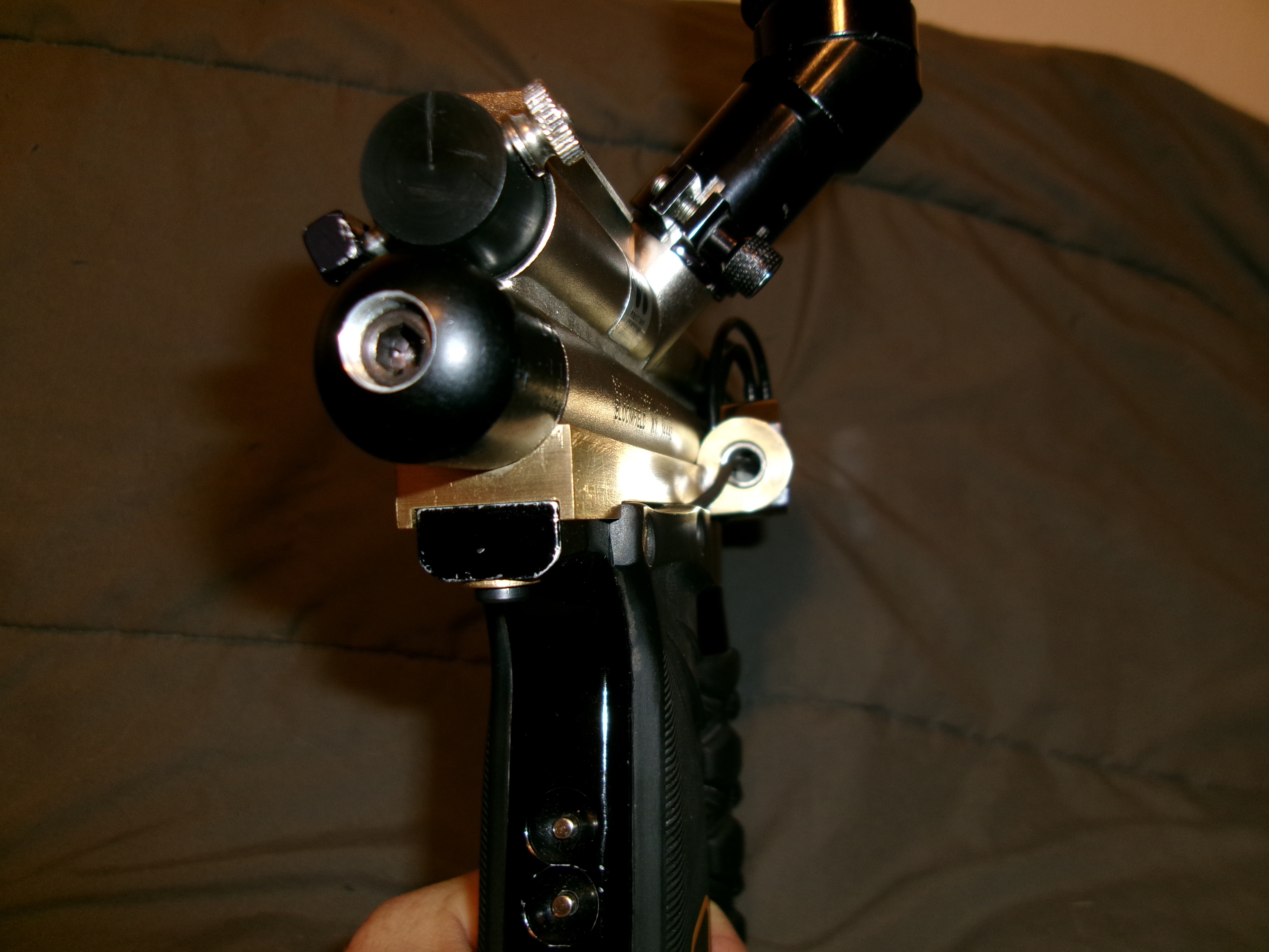

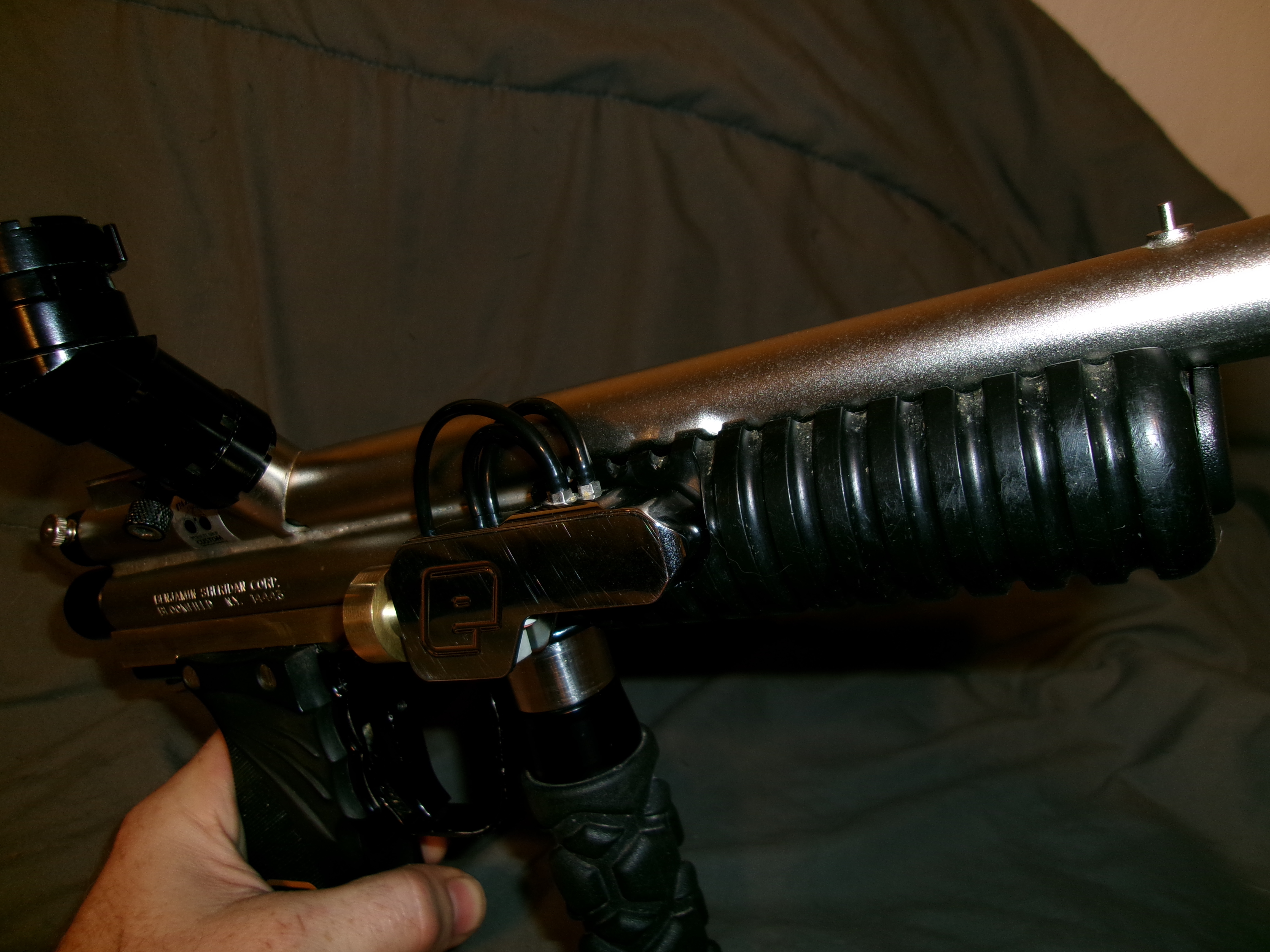

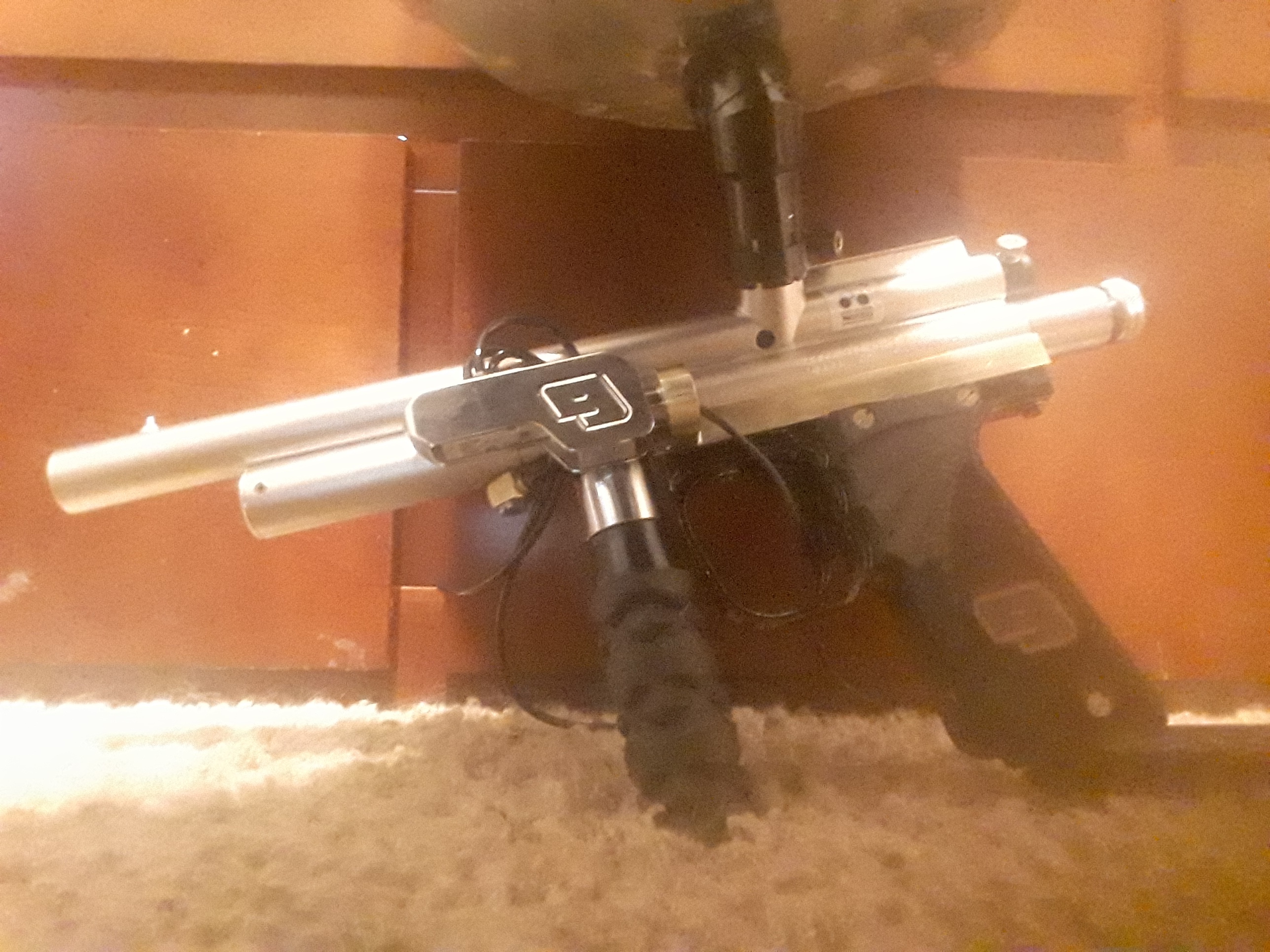

Well going another route, made a RVA, and hammer, milled an adapter plate for an eblade and soldered a mounting point for the noid housing. My camera is messed up, but it's coming out well.Comment

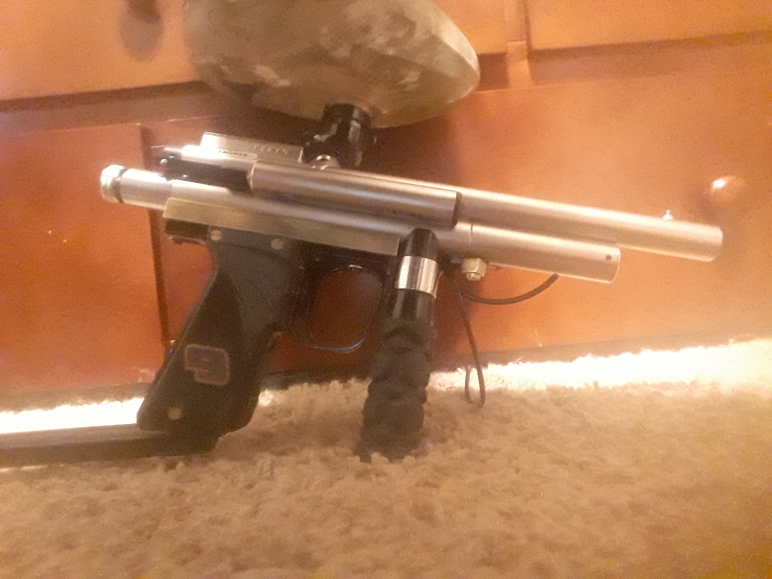

I got a bit more done yesterday. Milled a slot on my adapter rail that centers the frame now, and some relief cuts on a pump handle to hug the solenoid cover and serve as a foregrip. Just can't get the valve stem to stop leaking down the barrel new one on the way, but it is cycling the bolt nicelyComment
