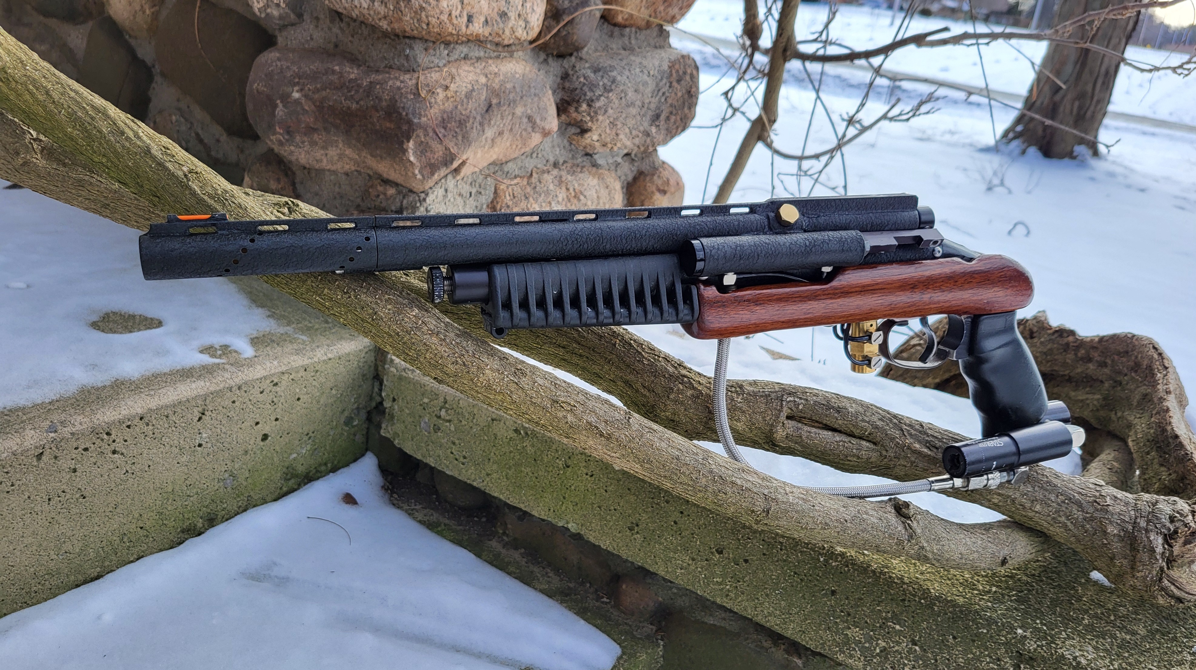

    Fast forward to January '24 - I've been experimenting with building brass Sheridan-based markers for a couple of years now, with the end goal of developing a skillset that would allow me to build a new body for my Hurricane based on my own specs. In the process I've scrapped a few projects or stolen parts off others, and taken more than a few ideas off the stuff other people are building (a lot of talented builders on here, and I'm grateful they post their stuff up for others to gawk at and drool over).
    I didn't want to cut up the original body so I built another one using two partial Sheridan lowers and a scratch-built upper. This one takes Freak XL inserts, has a 10 round spring feed, and uses an external Microrock in the usual under-barrel location. I built it to accept all the usual PPS internals and cocking components, so it retains side-mounted Humphreys ram, the quickstrip PPS bolt, and Hurricane 4way and Zbracket.

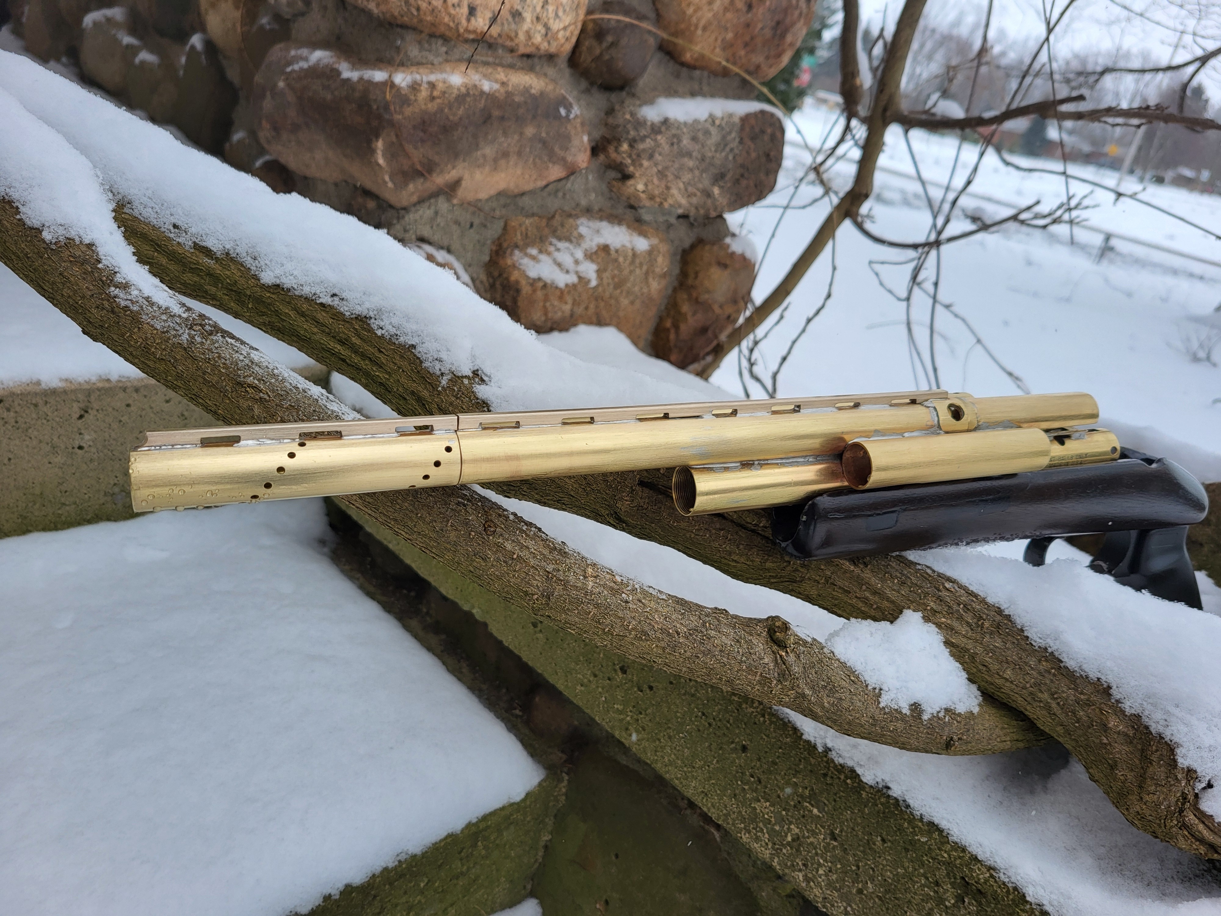

    Drilled and tapped the breech for the detent (always nerve-wracking) and got a good start on the lugged rail.
    I think I'll taper it down by the breech and figure out something for a sight rail. Maybe a Picatinny setup? I have some rails left over from some SP1s, might build a mount to accept one of them.
    Probably going to run a fiber optic rod at the end, like a shotgun sight, too, but I'll solder a bit of brass tube in as a holder.

      Hotwork is done! I need to grab a few things from the hardware store to finish off the springfeed, and I'll put it all together to verify function before I decide on what I'll finish it in (probably wrinkle black, I think I have just enough left).

          Change of plans, slightly... I had originally planned on running a Stabilizer directly under the lower tube, with a pipe nipple connecting the reg to the gun, but I can't get the Stab close enough to the body to look and fit like I want it to, so I went a different route and mounted an Inline Stab I got from woouulf off the bottomline ASA.
          So I guess that makes it 97% complete - I just need to pick up a couple of knurled thumbnuts for the springfeed and then air it up to make sure there are no leaks.
          I'm pretty happy with how it turned out.

          Got the pieces I needed and finished off the springfeed today.... running some paint through it revealed some feed problems with the ramp on the feedplug so I had to change up a couple things. Seems to feeding properly, I ran 20 or 30 rounds through it after the mods without any issues.
          All done until I can get to the field in a couple months and try it out. 🙂
