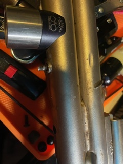

    The head stripped out, wound up having to drill out the head, now the screw turns freely and wont come out what is going on??
    • 3398
    The threads on the gun are a nutsert I am willing to bet the solder holding the threads in failed, and that nutsert is spinning on you. . Try holding the threads in place carefully while you turn the screw.
    Or if the female nutsert is solidly bonded to the body, but the screw threads are still spinning. That tells me you gauled the threads on the screw you can try pulling while you turn carefully and see if you can't get the threads that are left to catch. You may also have luck simply torching the nutsert out, and soldering a new one in.
    Jeeper Creeper has re soldered that insert for other members before so if it's above your skill set, shoot him a pm maybe.

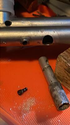

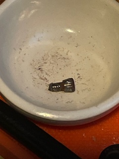

    ok got it apart, here's what i got, i've heated the thing up as hot as my stove burner will get it and the remaining bit of the screw won't budge, where can i get a replacement and get it put in?
      • 3398
      Ooof level 100. Man that sucks.
      I am and or was really hoping one of the smarter guys would pipe in here, but in my morning coffee hour I've found that what I believe you are after is called a clinch nut. I found these on Amazon, but I advise you do your own diligent research before buying them on my recommendation.
      uxcell Self -Clinching Nuts,#8-32 x 0.12-Inch Stainless Steel Rivet Nut Round Head Steel Metal Sheet Mounting Hardware Fastener 50pcs https://a.co/d/9Xtif7D

        Craig confirmed this one will work, now trying to find out how to get it in there
        https://www.mcmaster.com/98560A542/
        McMaster-Carr is the complete source for your plant with over 595,000 products. 98% of products ordered ship from stock and deliver same or next day.
          BrickHaus commented
          Do the jingle! Do the jingle!!! Like a good neighbor JeeperCreeper is there!
          Honestly dude, I'd personally have someone who knows what they are doing solder it back in.
        • JeeperCreeper
          JeeperCreeper commented
          They aren't soldered in, they work like rivets. Theres a tool that works great, you can buy a tool on Amazon for about $40. They come with some 8-32 nuts, but they are too long for most Sheridans / PPS and need to be shortened before install.
          There's ways to do it with a long screw, washers answer a nut, but it's going to be harder to keep it straight. Putting these riv-nuts on a tube is more difficult than flat plate.
          If you want, I'll put one in for you. Pm me
