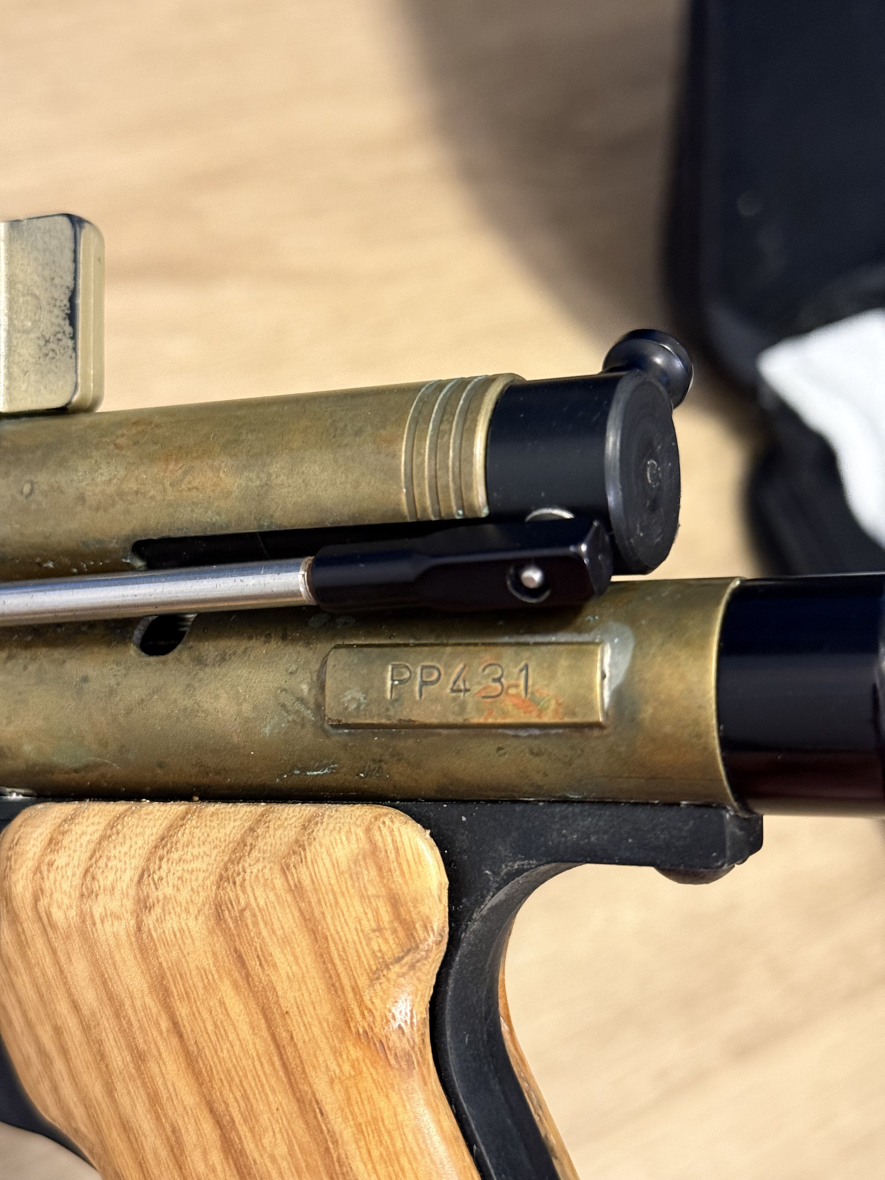

ring markings on houndstooth barrel
  • Drcemento
    Tiger Stripe Enthusiast
    • 744
    • NorCal
    assuming these are bore size indicators? or just decorative? I seem to remember something about them
    • 4509
    Nah it just means Palmers Pump
    Edit: oops read too fast, what Loophole said
    • Loophole
      • 1421
      • California
      Three rings should be .680. I would snag that in a heartbeat!
      • Drcemento
        Drcemento commented
        I like your definition the best. fingers crossed for .680 cause it has no wedgits. snagged you vultures!
      • Loophole
        Loophole commented
        Good man, well now we need to see some more photos lll
    • Pyrate Jim
      Shi Tamajutsu Ka
      • 709
      • The Group W bench
      Mine has no marks like that. It's probably a later model, the serial number is on the sight rail and all polished nickle.
      As early as that one appears the marks could have significance, but I've never seen them before.
      • Loophole
        • 1421
        • California
        IIRC Two rings is always .685
        One ring or three rings is .680
        no rings is .690
          Carp commented
          I will agree with that. I found this old quote about Blazer barrels...
          Originally posted by Giuseppe
          Just for posterity, Palmer's confirmed that it's:
          .680 = 1 ring (or 3 rings!)
          .685 = 2 rings
          .690 = 0 rings
      • Funsi00
        • 226
        • Cleveland ohio
        Depending on time period. 0 = 690, 2 = 685, 3 = 680. When Craig was marking/identifying barrel ID. A caliper is your best friend to give you approximately barrel ID also.
