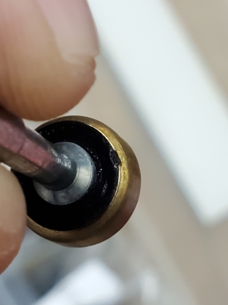

    looked like the valve stem seal had a blow out.
    Ordered the valve kit from palmer website, came quick.
    Installed valve stem and body oring.

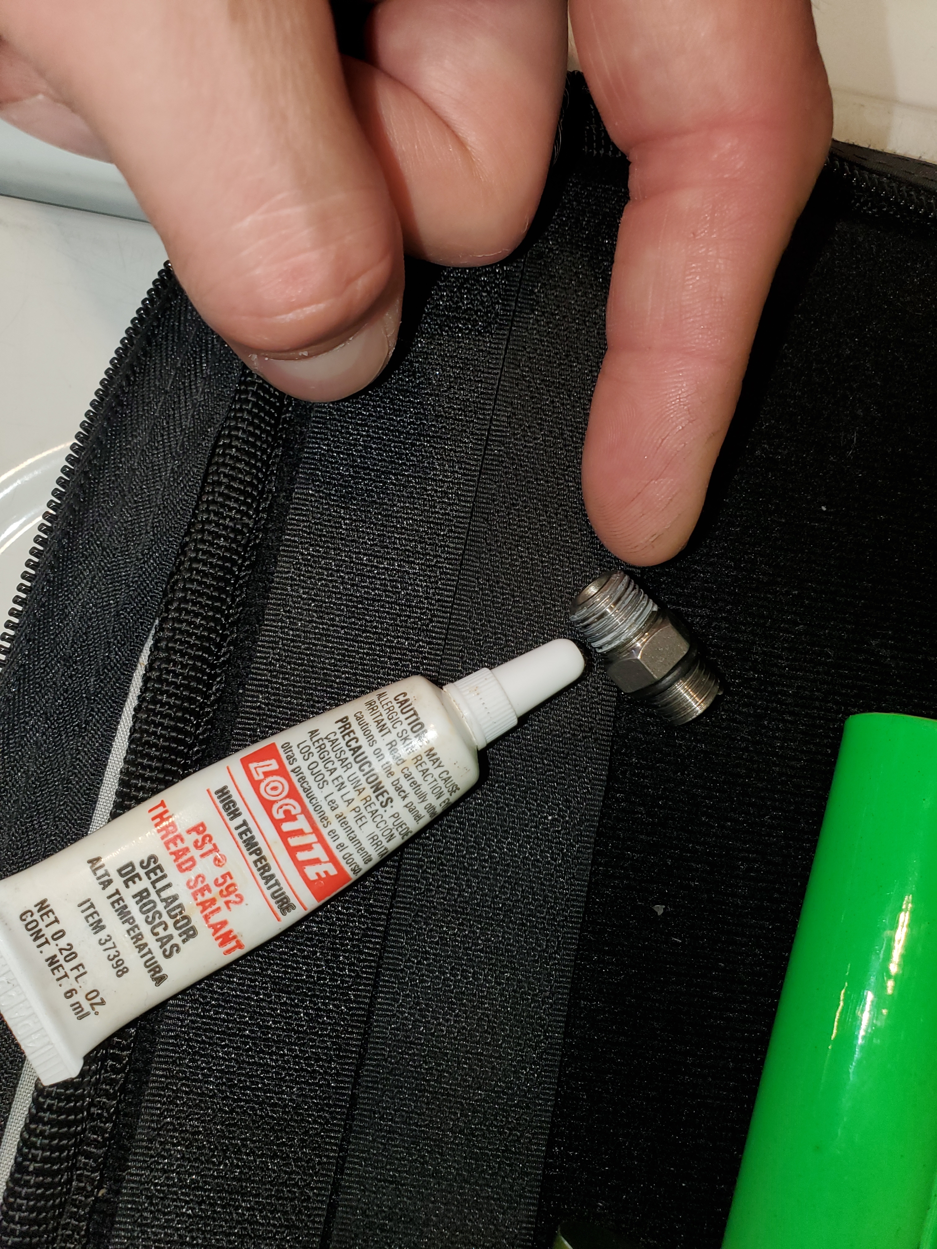

    All orings replaced including the #11 vasa and #12 inner body oring my finger is pointing to. Loctite thread sealant on the vasa fitting to the body. (It had black sealant on it previously)
    12 gram still dumps out the lower tube blowing the cap into the pump arm. Does the brass piece need to be sealed somehow?
    Updafe: the loctite needs 2 days to dry on that asa pipe threads, did that again and it's all good.

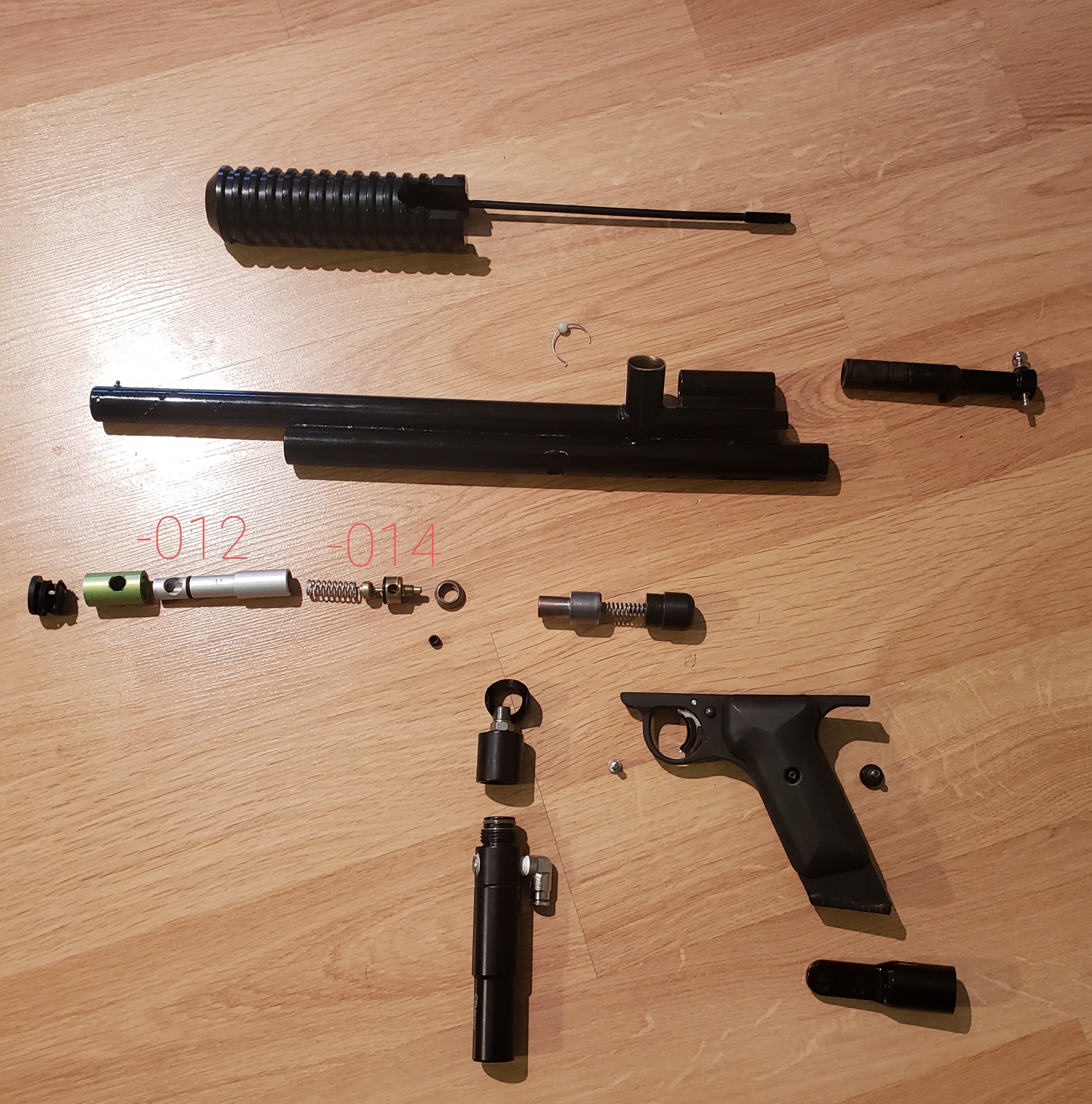

      image.jpg​not a SS but similar internal setup. More than likely you need to replace the #12 o-ring.

        Yep, you are going to have to pull of VASA and replace the -012 oring. That's a unique little build you have.

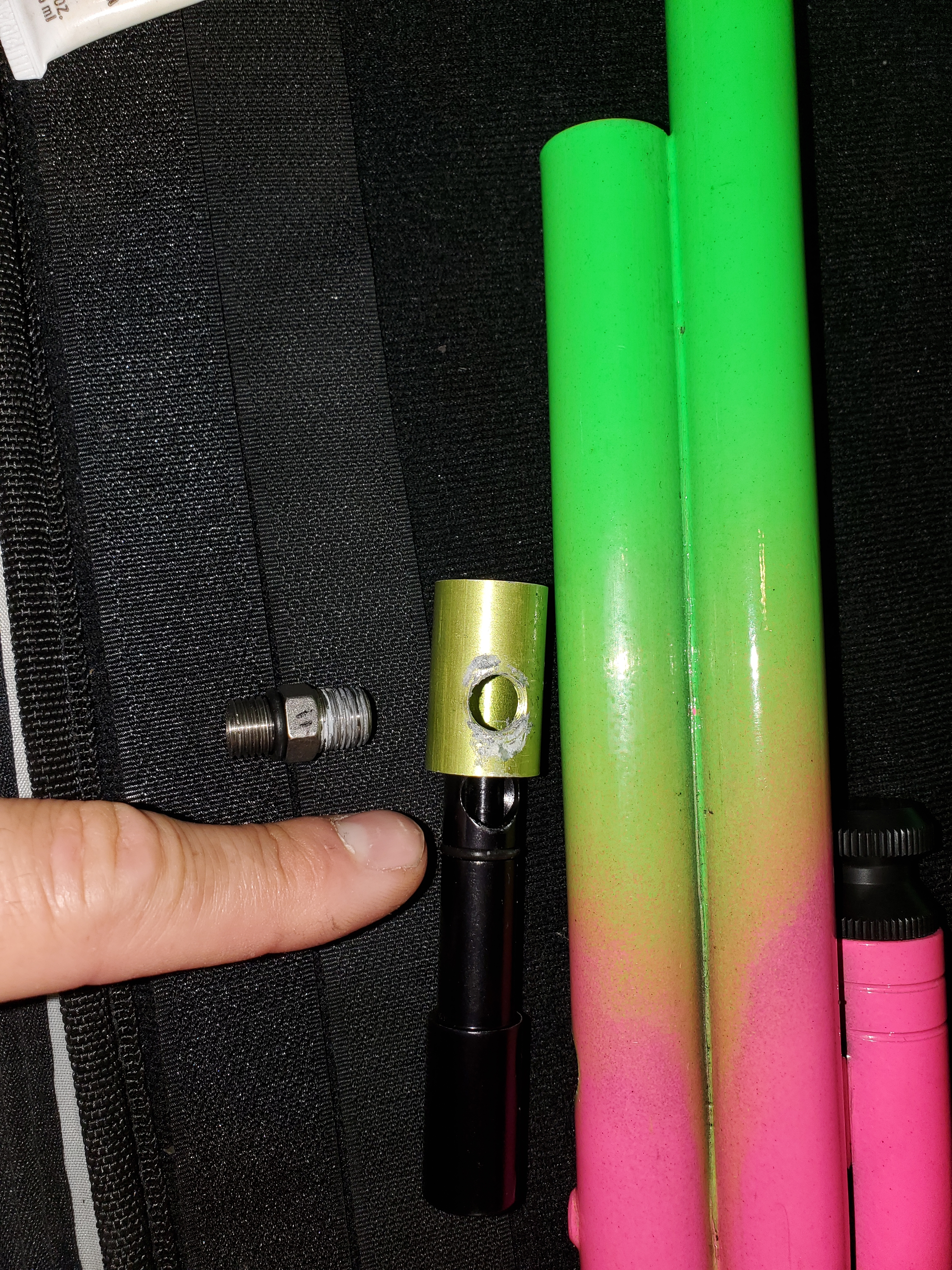

            Ok, it's gotta be the 12 oring in vasa. Had no idea that was there. I can use a soldering iron to apply heat to a fasteners.... but where is the bolt that holds the vasa on???

              Does anyone know what size oring this is under vasa cover?
              ps- use a soldering iron to heat a vasa from the inside, comes with off with padded vise, no damage to powder coat.
              ETA- that little oring is #11. It's got thread sealant going into the marker body.
              Now how do you remove the front guts? It jiggles back and forth

                That threaded piece unscrews and then there are two components that come out - one through the front of the tube, one through the back.

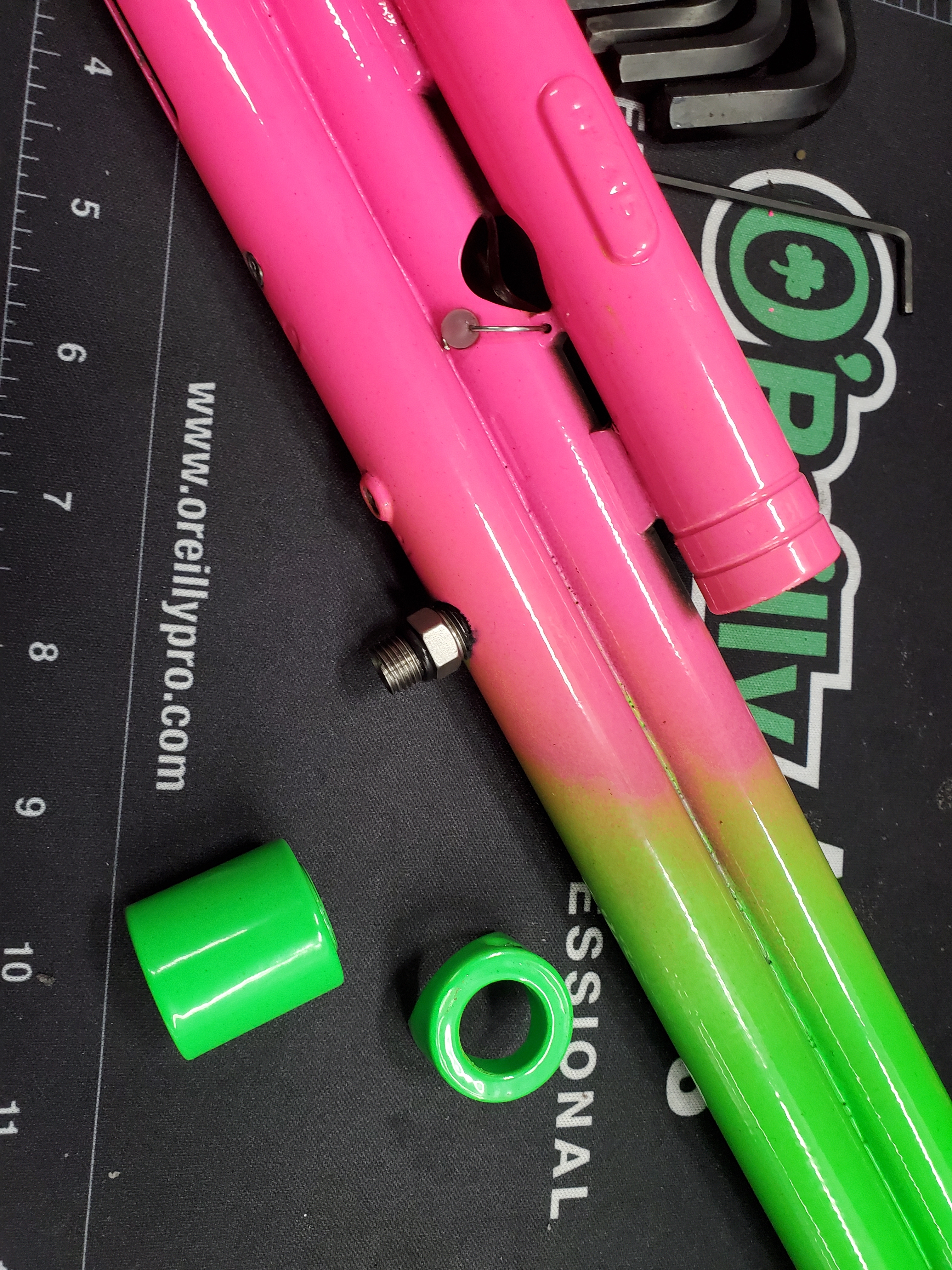

                  If anyone has any tips for the front tube, I got them out and replaced the oring, then used sealant on the top vasa threads. 12 hours later tried a 12 gram and it vented right out the front. Perhaps I did not let the loctite 592 dry long enough? Oring did not blow upon inspection.

                    I generally wait 24+ hours for loctite to cure and use blue 242.

                  Yup had to let loctite cure longer on those asa threads. I used loctite 542 white. Palmers had something black on them originally.
