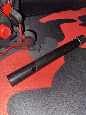

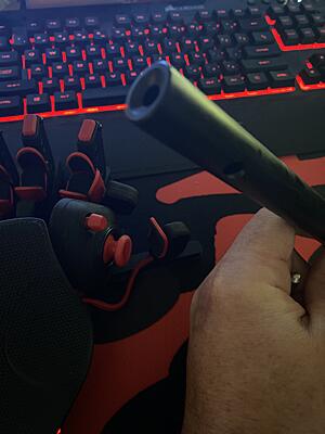

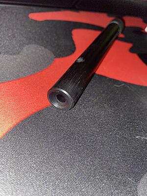

            Anyone tested 2k+ Bolts?.. I am looking for a new bolt for my scout. Hoping someone has done a bunch of testing
              My Scout came with a special small bore bolt built for it. I’m assuming to get some extra efficiency. Even though it’s not very efficient.
            • 6380
            #27
            Stock Scout bolt made by Ken. I should try a CCM in it see what happens can’t hurt I know I got one laying around somewhere.
            This gallery has 3 photos.
            • Loophole
              Loophole commented
              I see! You have one of the run of 9. I have the prior 6 with dropouts. Mine was one of the ealier ones at that.. so it just had a modified pre2k bolt drilled for 2k+. Curious if anyone has done testing with bolts.. i would like to upgrade to something with detent slots so i don't destroy my dual cocker detents!
              Yeah I’m almost positive mines the last one. It’s the one Ken made for himself. I got it from him years after they were out of production. I would like to find the one out of 15ish that was built with the regulator built in. I have never seen it posted or shown off. I’m curious how he added regulation. Yours is definitely an early one if not the prototype.
