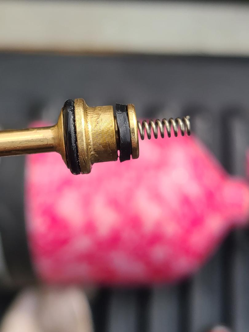

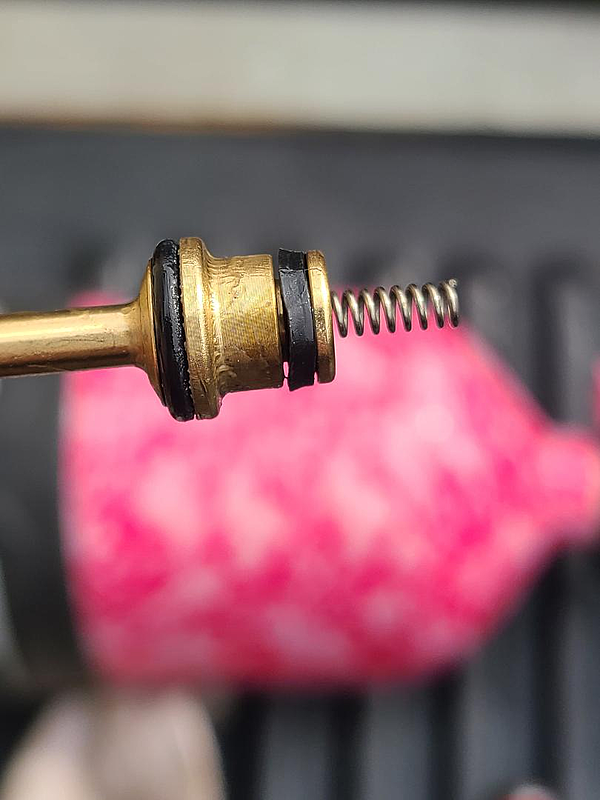

      Hi Mike. I remember you telling me the trick with your reg at Slim's. I may have accidentally figured out what the problem was in my case.
      In the reg on this particular T2, I had swapped out the pin o-ring (basically the one that acts as the reg seat), for a polyurethane 006-N90 instead of the stock Buna-N 006-N90 based on the recommendation of Tim Firpo (PaintballTek) in a video he did on rebuilding CCM regs. His claim was that the poly o-ring was better for this application than the stock one.
      Interestingly, I went back to messing around with this reg again, and happened to put it on an HPA tank that was outputting ~700-750 PSI. At first the CCM reg seemed fine while testing its output, but it suddenly started creeping and then shot up to like 600+ output. Basically not regulating at all. When I took the reg apart, I found that the poly o-ring was partially sucked down into the opening on the poppet nut. Exactly like what I was seeing at Slim's when I was having trouble getting this to work.
      I tried swapping out the reg internals with an entirely new set, but still with the poly o-ring on the reg pin - same result, output shot up and o-ring getting sucked down into the nut after a couple of cycles.
      As a last troubleshooting attempt, I put the stock Buna-N one back in and tried again on the same tank output pressure. Lo and behold, no issues staying consistent at 300 psi output.
      For shits and grins, I took the ICD lever changer stock I got recently and hooked it up to try testing the output of the CCM reg to see what would happen. Went through 3 12 grams testing and no issues staying at consistent 300 psi output.
      Last step, I put the ICD stock and reg back on the gun and hooked it all up to test it. Put a 12 gram in, and proceeded to be able to fire the gun many times without any issues. Put a second 12 gram in, and tested it again, and I counted ~30 full power shots and then like the next two were basically nothing, and then the 12 gram was completely spent.
      There's a stock class day coming up at OSG soon and I'm going to give this gun another try on 12 grams there. Thanks again for the stock feed!
