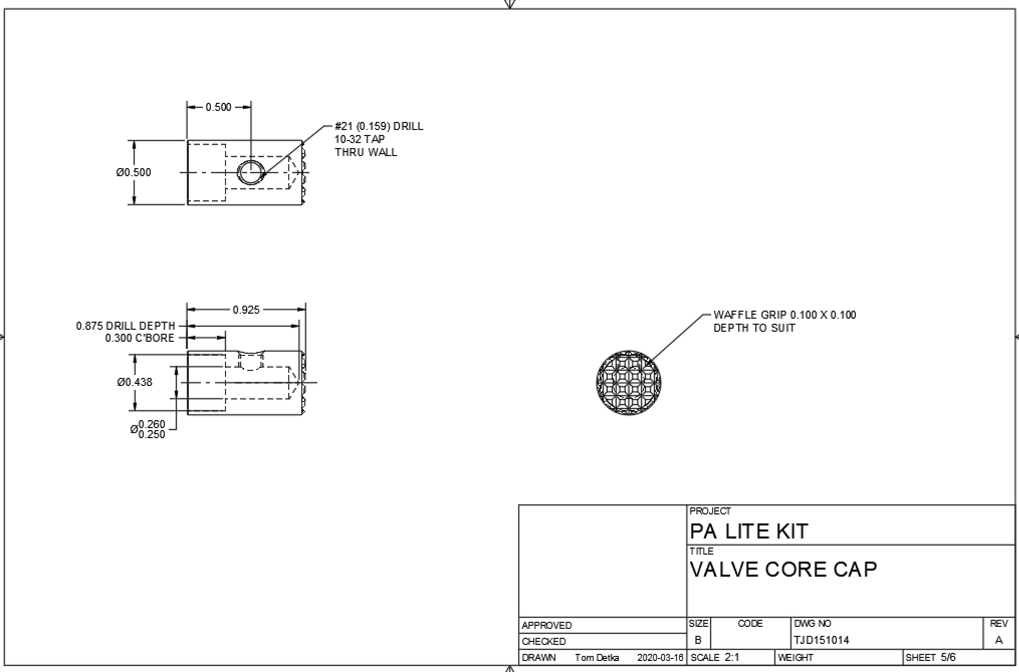

          #19
          Well I'm not sure a hitman tang is a good idea on those. since there is no rotational stabilization it could just rotate to the right side of the gun and be really hard to "find" while playing. Secondly because the 3 way is only supported by the orings if you move the pull point away from the axis you might get binding or premature wear in the valve body and stem. All that being said though I can tell you that the set screw that holds the cap onto the valve stem is 10-32 so if you wanted to experiment for cheep you could just use a long 10-32 screw as your hitman mod. If its not binding and working how you want then you can just put some washers or a tube under the head and then you have a pretty simple hitman mod.

              #21
              Here is the drawing of the base cap if that helps. I was planning on releasing something like this so that if people wanted to try their hand at 3d printing their own they had a good reference to start with.
