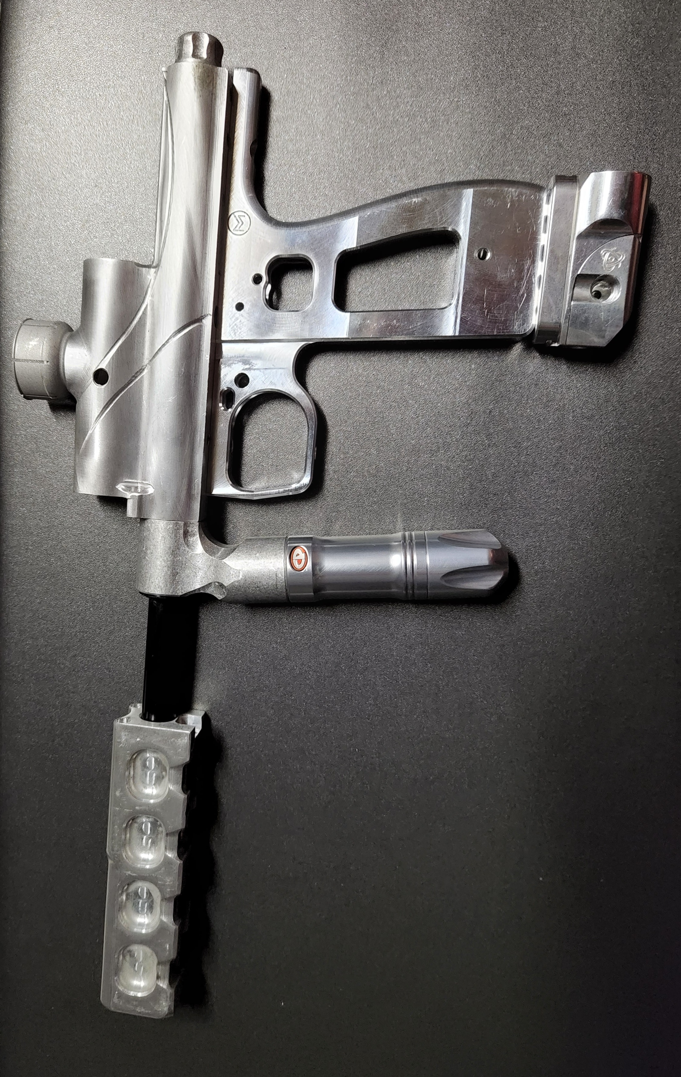

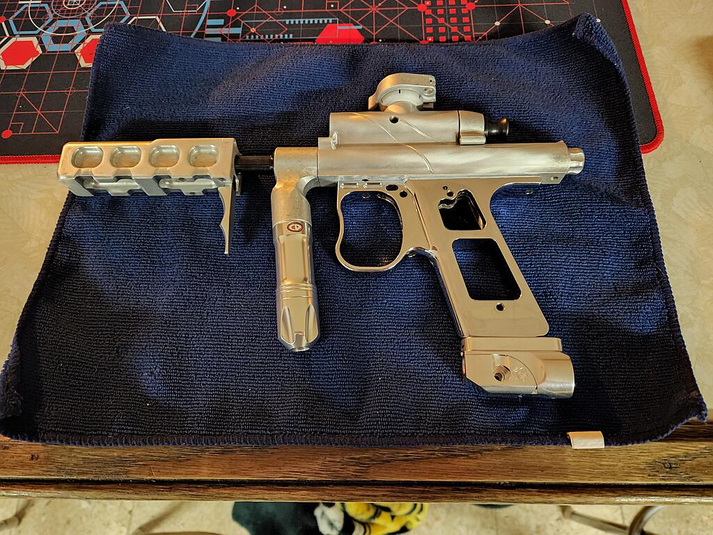

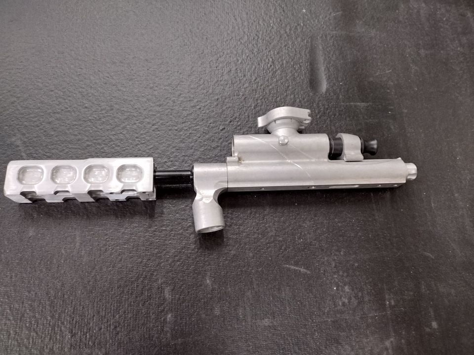

      Quick mock-up (double frame is a stand-in, still waiting on barrel):

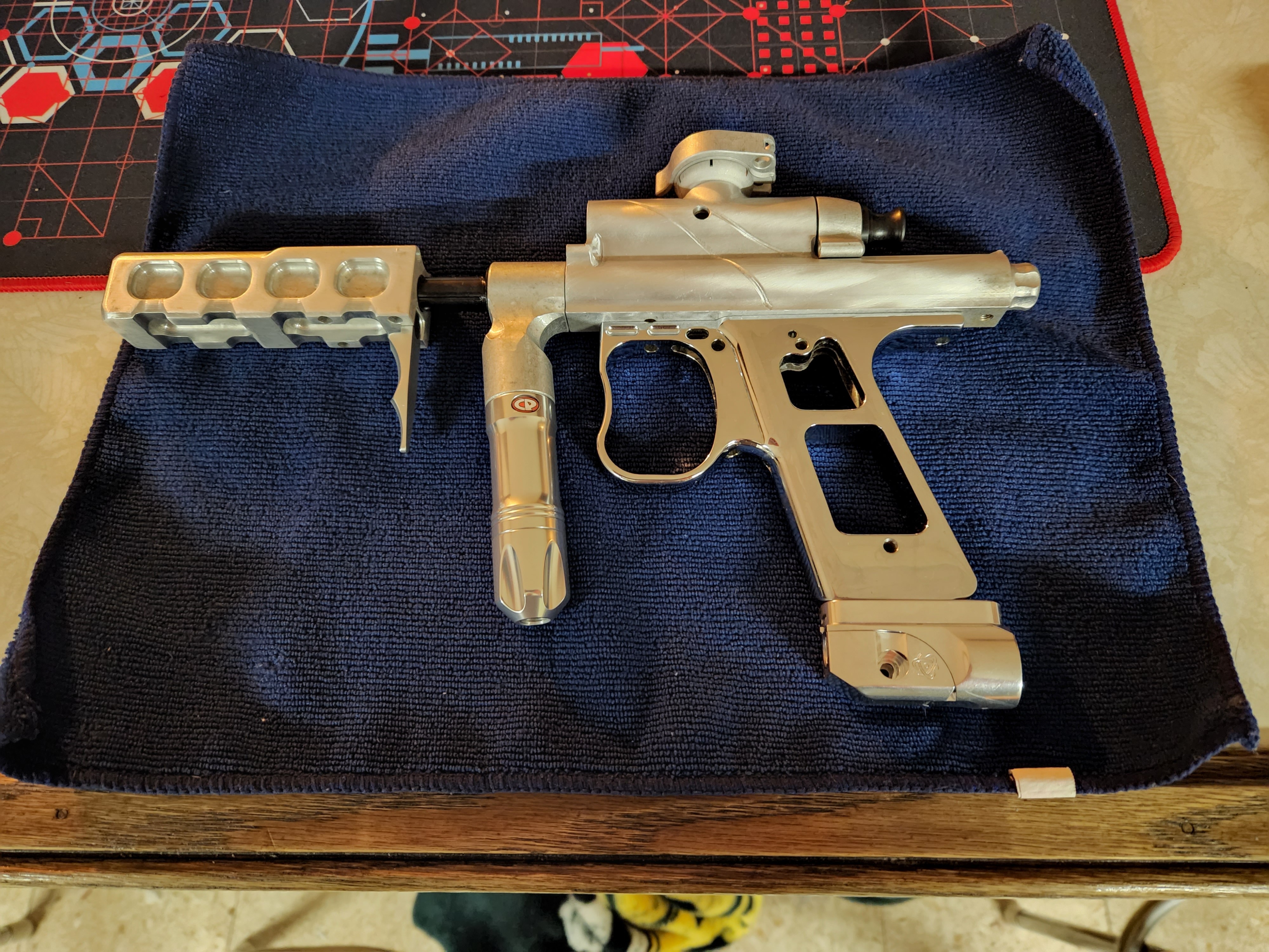

          Mock up with the Mozak 86! Goes out for anno tomorrow!

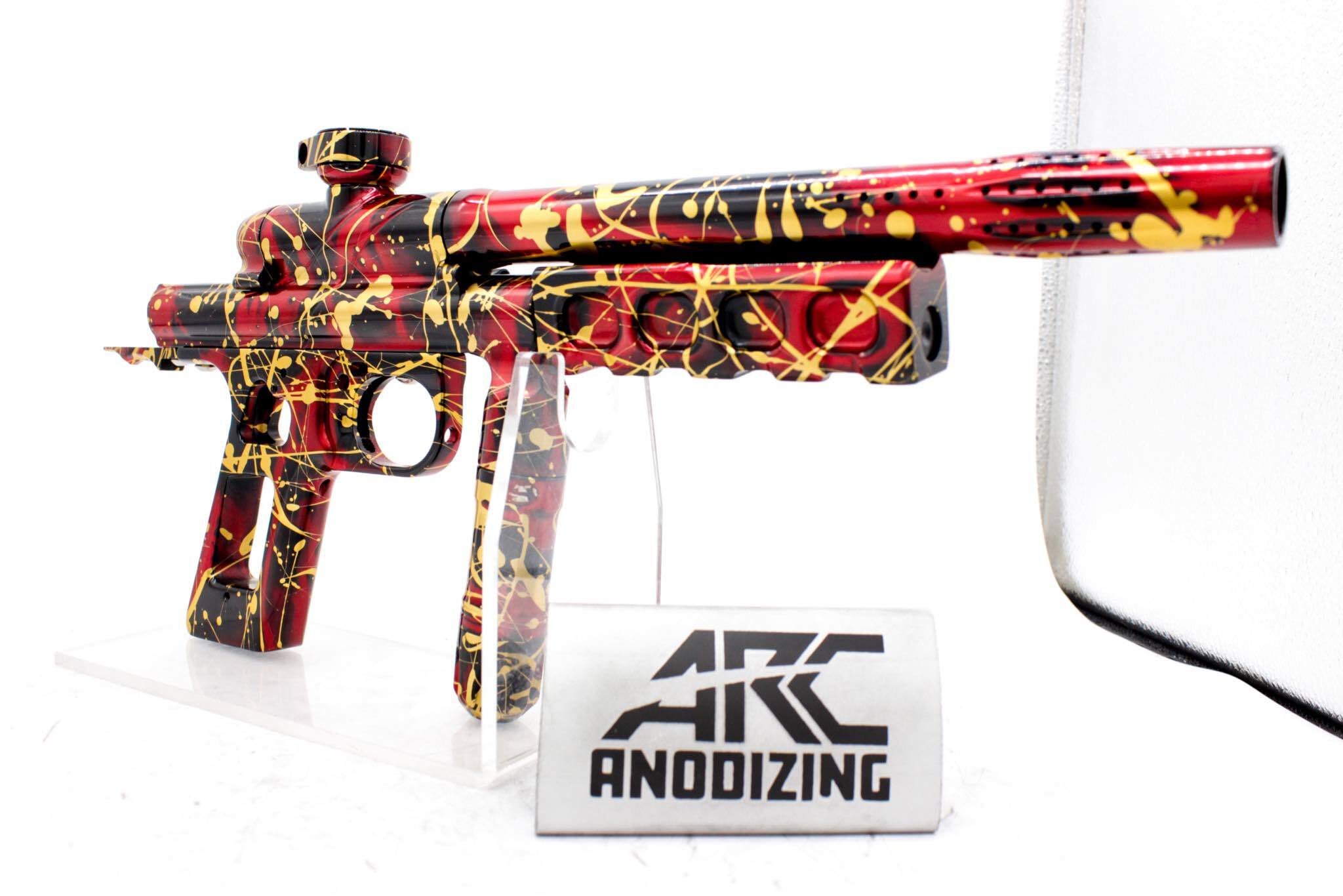

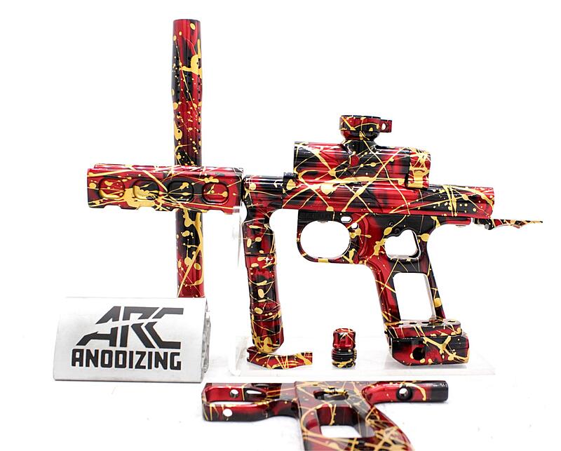

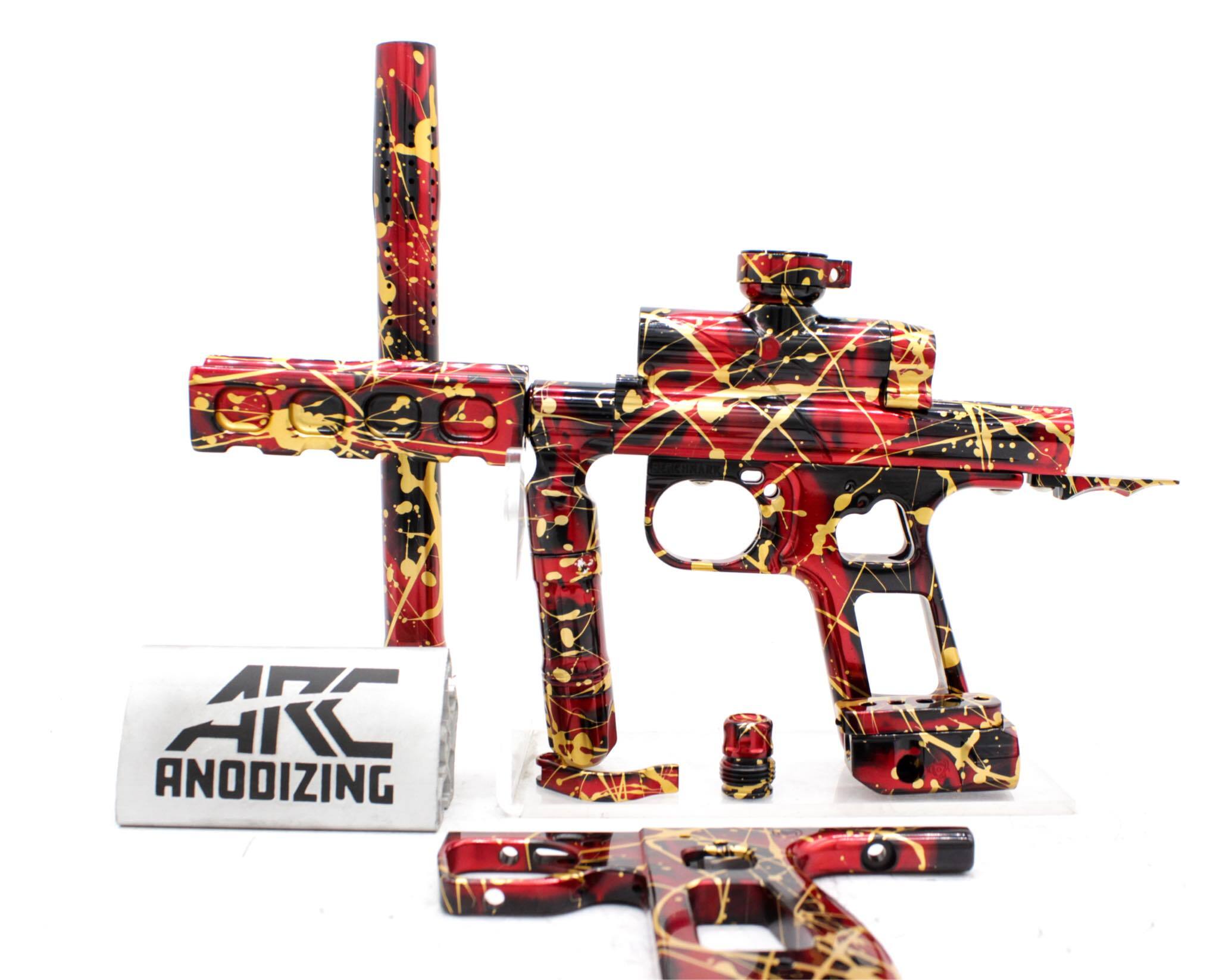

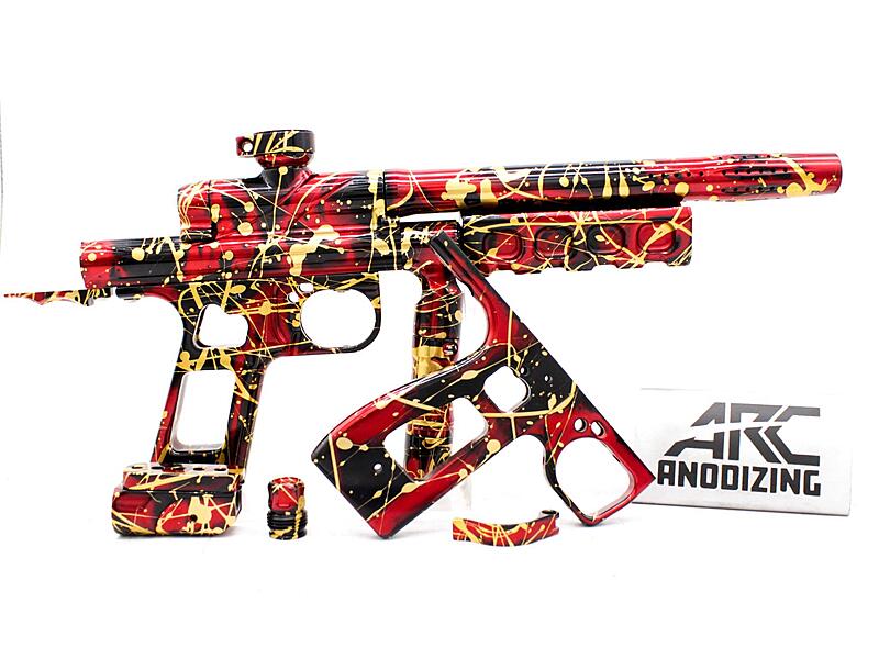

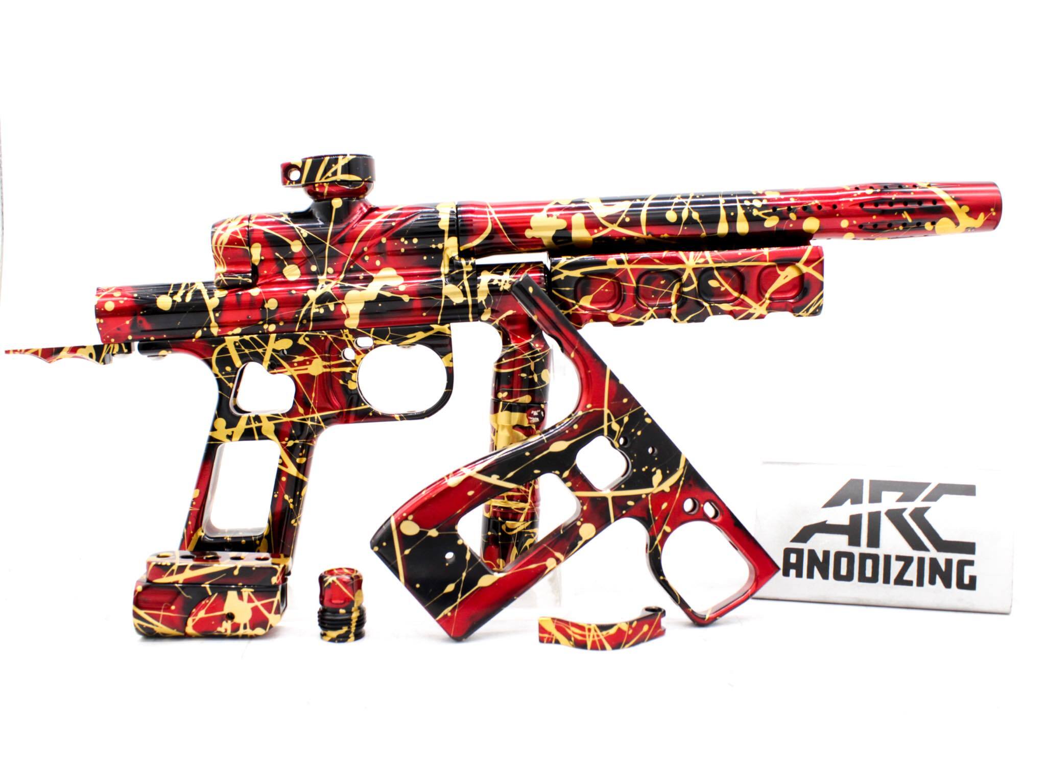

            Proof photos from ARC. Can't wait to get it in hand and on the field! (And yeah, I know he mocked up the hitman plate as if it was a snatch grip)
            Click image for larger version  Name:	292146736_3212919218955926_506869913342047151_n.jpg Views:	8 Size:	198.9 KB ID:	298095
            Click image for larger version  Name:	292028450_5285821038161325_7402465295166243251_n.jpg Views:	8 Size:	166.7 KB ID:	298096
            Click image for larger version  Name:	295345499_616347019733948_8283160105840133902_n.jpg Views:	8 Size:	187.5 KB ID:	298097
            I'm probably going to set it up with the Mozak frame first.
            MCB Feedback
            • BigRed
              BigRed commented
              Love the colors...gorgeous!

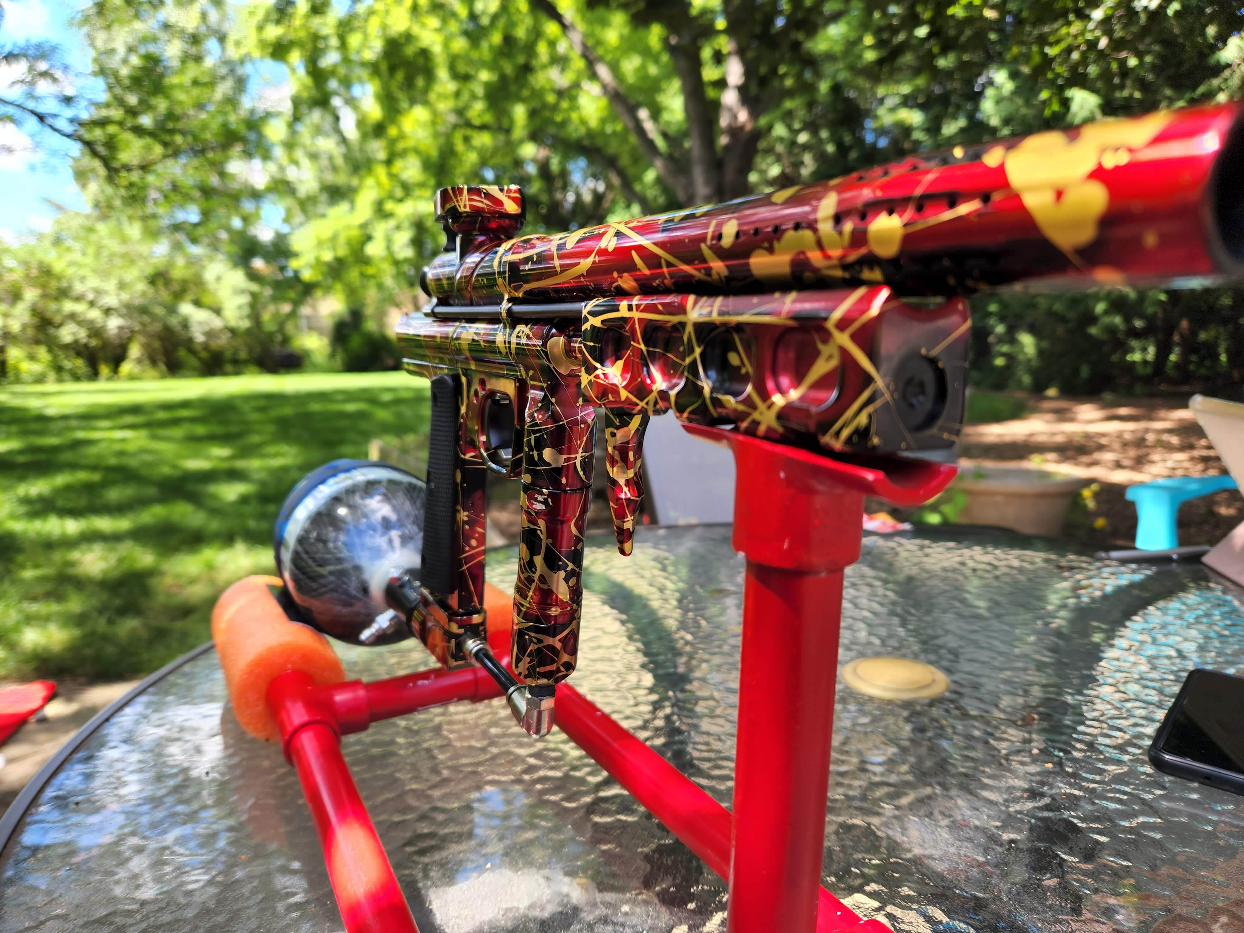

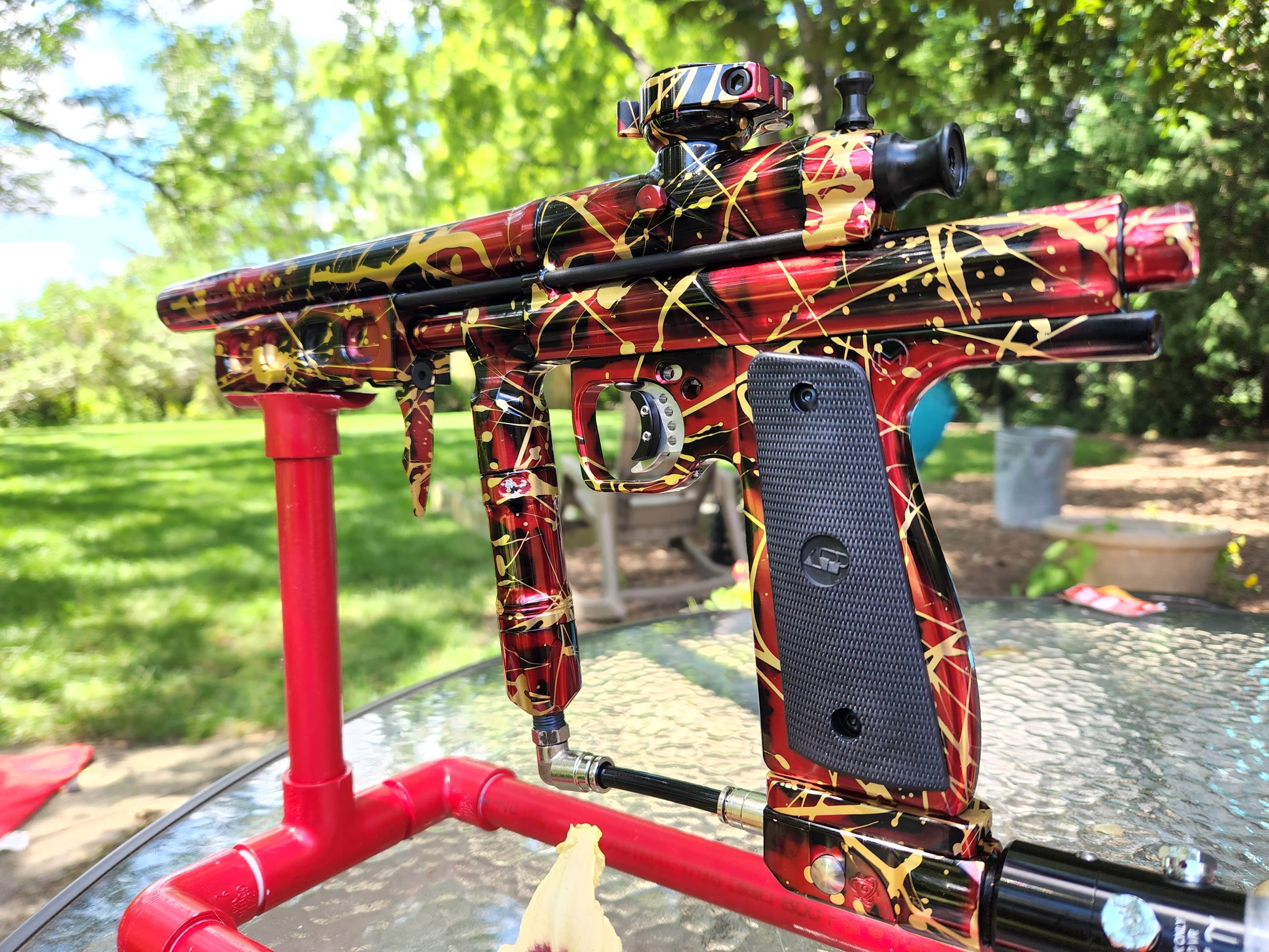

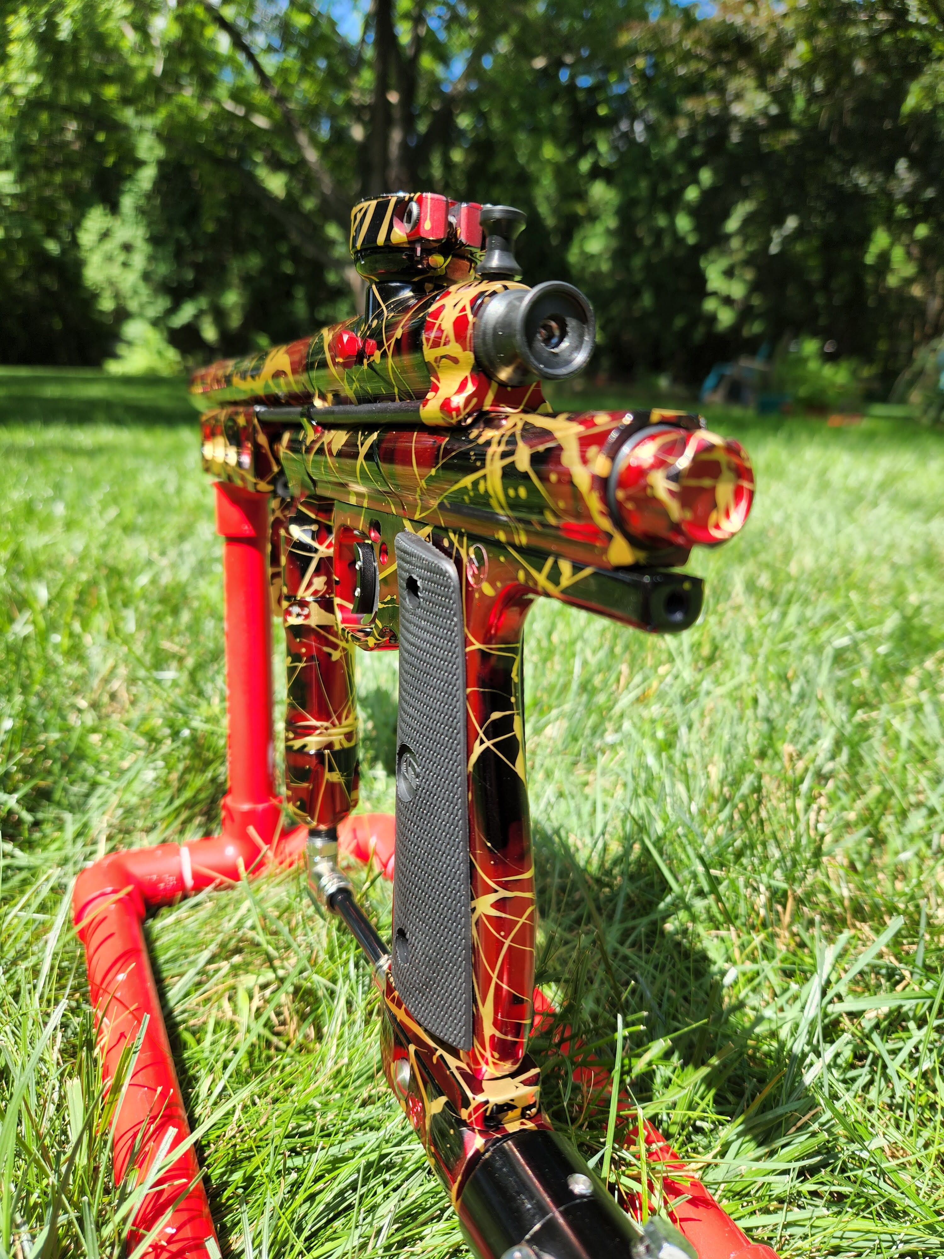

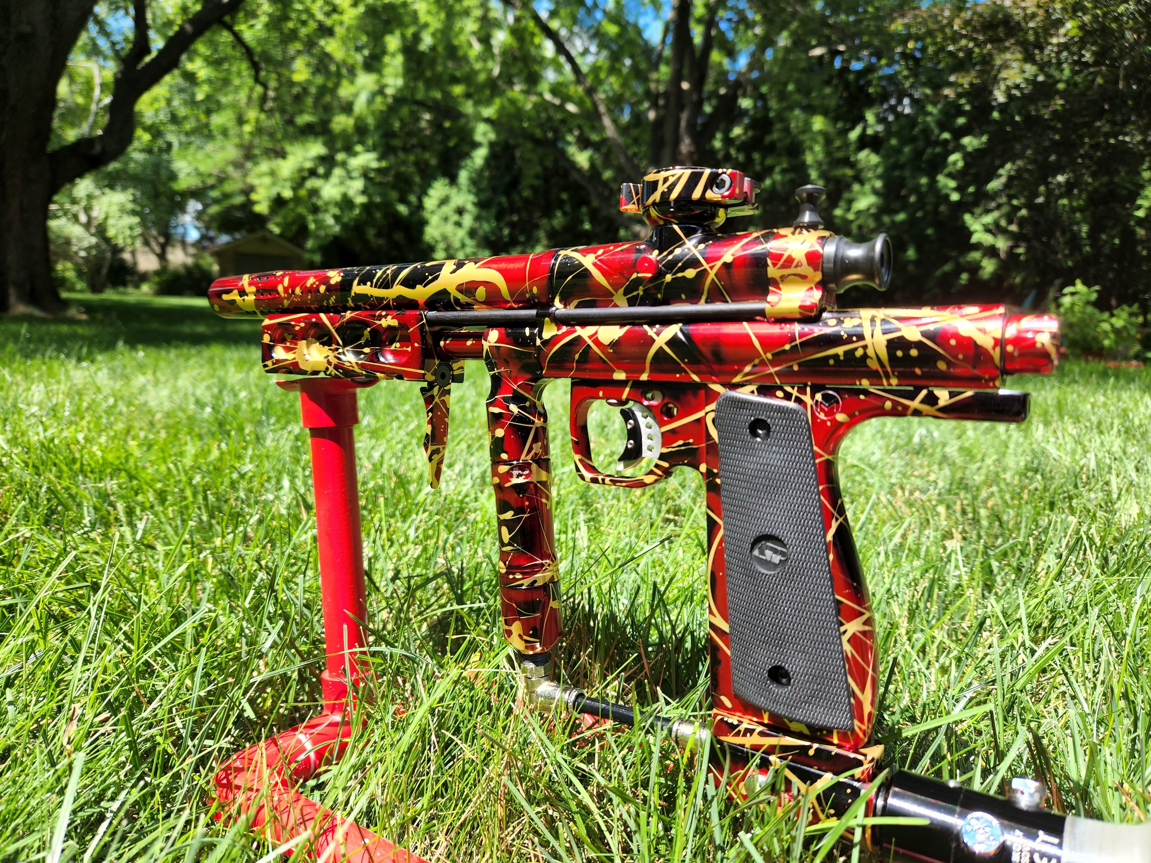

              Alright! All put together and leak tested, it's all good my friends.
              Build Details:
              Sanchez Machine Pump Body Kit (non-production from woouulf)
              Inception Designs universal hammer
              Palmer's Low Turbulence/Low Pressure valve
              CP gen3 Regulator
              MozakMachine Thin 86 Frame
              Inception Designs EZ On/Off ASA and T-Slot adapter

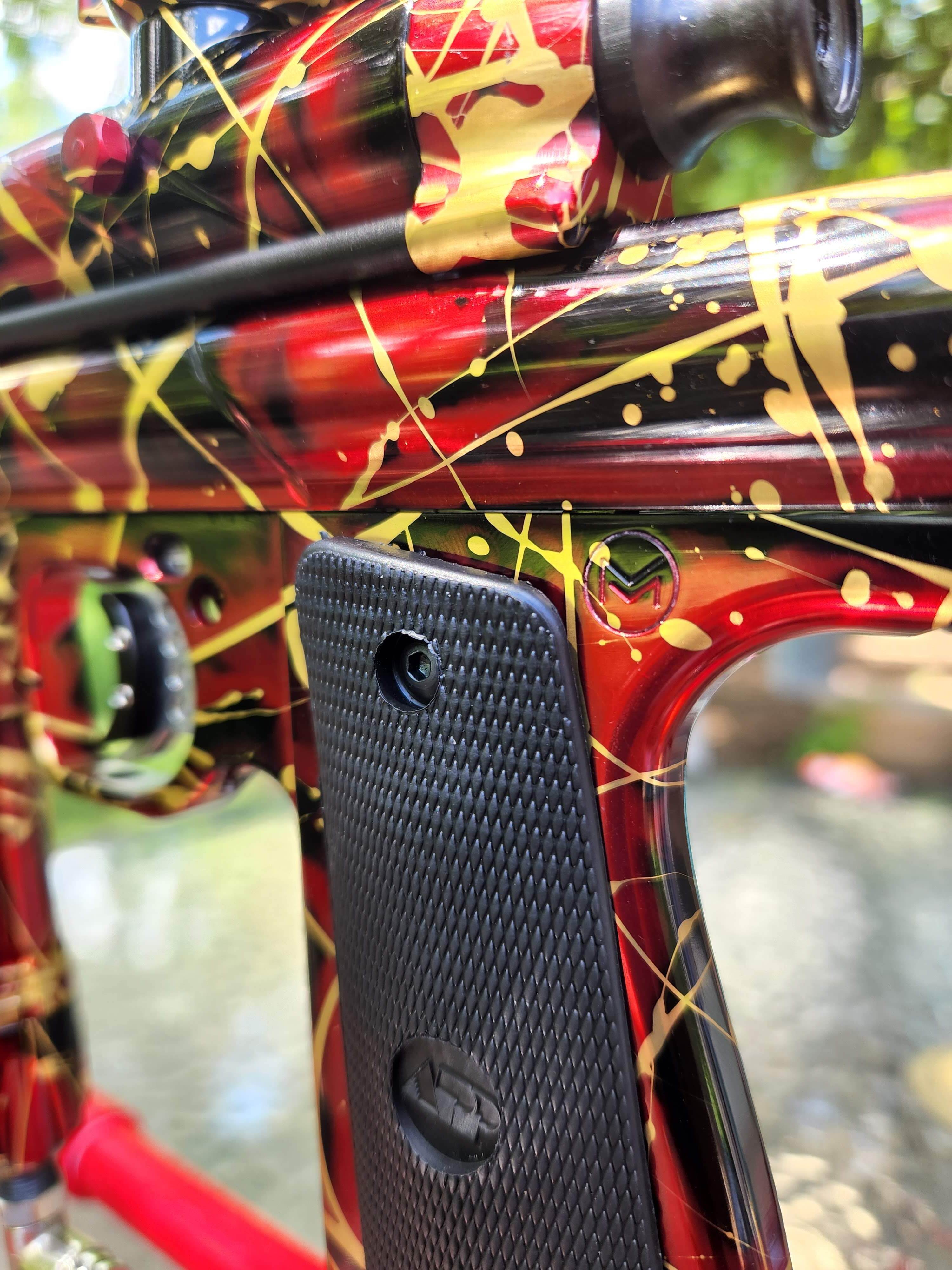

              ARC did the anodizing and they absolutely knocked it out of the park! While I'm generally a fan of blue and grey tones, I've always had a soft spot for red and gold. Although a modern build, I wanted to pay tribute to all the crazy annos from back when I started playing. I had always wanted an acid wash and splashed marker as a kid, but could never afford it.
              Still playing with the pump rods a bit to get them secured without binding, but overall I'm in love. This thing is light, compact, and I can't wait to get it on the field!
              MCB Feedback
              • zinger565
                zinger565 commented
                So, the guide rods are interesting, they don't thread into the pump handle, rather it uses a set screw to hold them in. It solves the usual binding issue of mismatched rod length, but creates a new issue. The set screw forces the guide rods upwards too far, causing binding on the body guides and pump guide. I've been experimenting with using some tape as a shim to keep the rods centered in the handle. Seems to be working.
