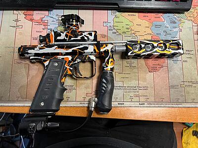

    Looking for more info about this pump marker
    I've had this for the better part of about 8 years at least. I know there is a green splash one of these out there. Forget where I saw it.
    I think it's a Sanchez Machine but I'm not sure. It's missing some milling that the SM-1 has, so I'm unsure what it really is.
    I'm having issues getting the velocity down to 300 and would like to know the best way make the pump stroke smoother. I know very little about old school pumps/markers.
    Any help would help!
    PS. If I'm posting in the wrong sub please let me know!
    PSS. If someone is a pump master, I'd be willing send for full service as this was my late brothers and I don't plan on ever getting rid of it, but would like it shooting tip top.
    • 6291
    Sanchez machine custom Ano Dye reg, and PE Asa.
    If you are having issues getting it below 300 FPS your reg pressure is to high. The regs on pumps are your base line fine Adjustment is done threw the IVG at the back of the marker lower tube. In to go up out to go down. There are some great YouTube videos on how to “sweet spot your reg”. This will give you the best performance and make your marker operate the best. It’s best for you to lear how to do it yourself so that when it needs to be cleaned down the road you don’t have to send it out each time.
    Pump handle likely just needs a good cleaning and guide rods polished. You can polish any surface area. Make sure the pump arm isn’t binding on that body guide and there isn’t twist in it between the back block/ bolt and Handle. s
    Sear and hammer lug can be cleaned up with some very fine wet sandpaper and some jewelers Rouge if they are pitted and in ruff shape. Light oil with some quality oil after your done cleaning up and it will shoot great for you.
    This should solve your high velocity issue.
      Yeah, I got that stuff down. I'm trying to figure out exactly what SM pump this is as it has different milling than the SM-1.
      And what parts would be compatible to get this going good again.
        • 6291
        They did do a few different body cuts over the years. There was some prototype bodies sold. There’s one in the BST now. But the internals are the same as far as I know. You
        would need to pull it apart to see what’s in it.
        Its a custom Ano so it could have custom matching done. The lower tube looks to be missing the pill shaped cuts that most of them have. It may be an early one before they started adding them.
        Its a cool piece. If for some reason you can’t get it working right yourself I’m more the willing help you. Honestly it’s not hard, you just need to know how. Knowing how will keep that thing shooting a long long time.
        Start with the reg and the video I just posted let me know how you make out. Put the IVG about one and a half turns in from flush and make your adjustments on the reg. If you still have trouble it may need different springs but I highly doubt it.

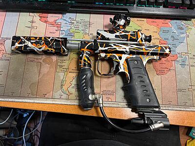

              Just providing an update for everyone who's been sooo awesome to reply! Going to get the right stuff to polish the rods and everything. Will take photos during my teardown. My Paintball Radarchron (cheap chrono) no longer works when I tried to get it going last night so I'll probably have to wait till I'm at a field to start setting and counting my turns. My reg is set for 500psi but I do have old SLP regs if you guys would recommend that.
              My pump stroke does seem kinda hard. Much harder than the empire sniper. Would this be the spring? maybe I have something wrong in there. Will take lots of photos tonight though.

              make sure your frame screws are in the right order. Long one goes in the front short in the back. Otherwise it will bind lower tube springs and cause all kinds of wacky issues.
              Check that The dual pump rods are evenly torqued. If one side is to tight it will force it out of square and bind on thoes body guides. Polish up and clean the inside of the handle and the guild rod it rides on. That should make a big difference.

                Set your HPR/ Reg (the one on your Gun, not tank) to 325-350psi.. With the cap screwed out where its just no threads showing (if you dont have a cap as an IVG , then make sure IVG flush with the back of the Marker. Adjust the IVG in to get the correct FPS... Sanchez markers have a harder pump stroke. I found that using a lighter Valve spring and lighter Hammer spring helps some, but Its never going to be a CCM . Lighter Pump spring helps too. Run some lube on the pump handle guide rod and a lil llube on the pump rods just where they go through the body and a lil lube w sled bottom (its the part the bolt goes into......
