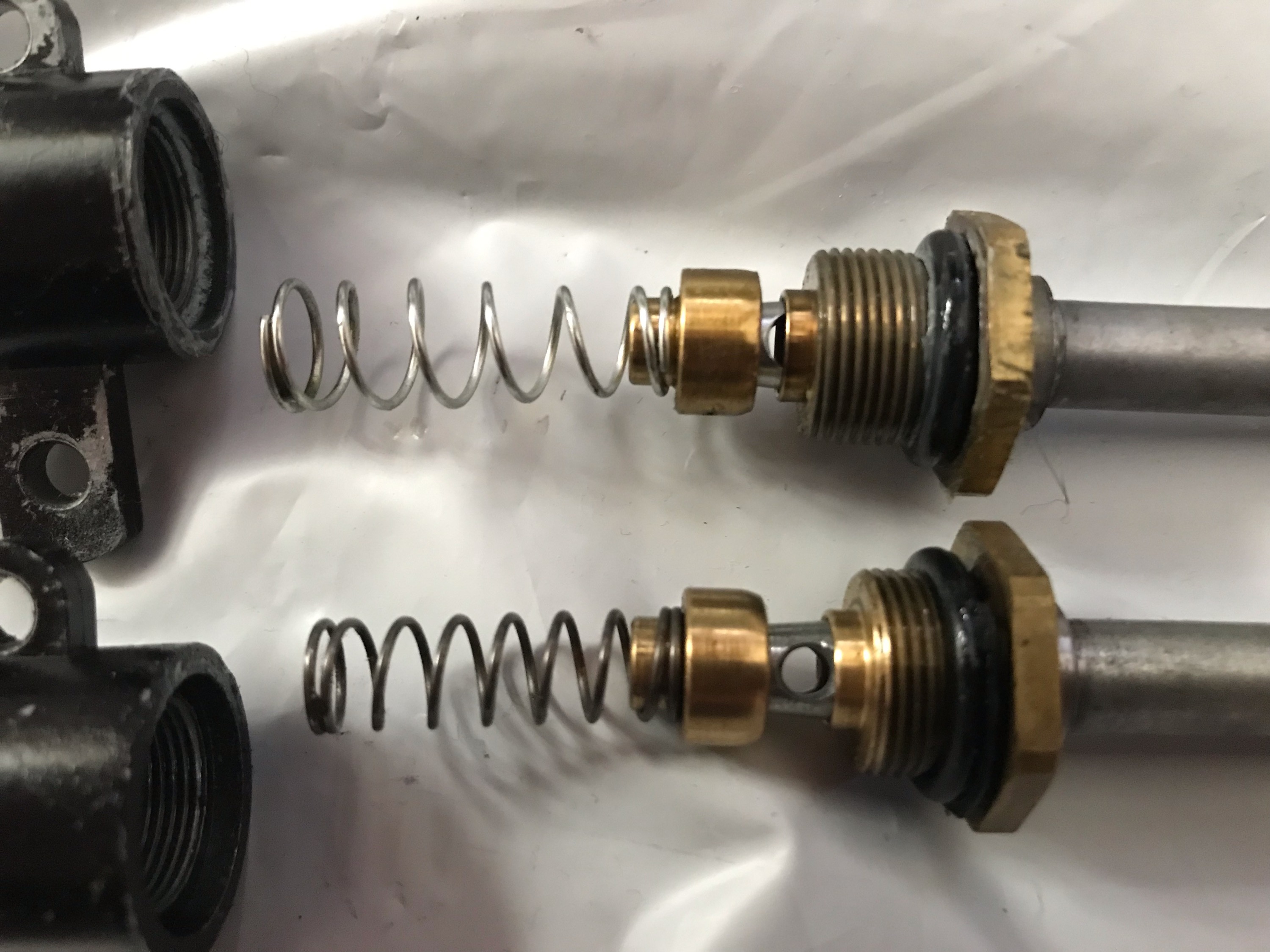

          Nish is right, I'm a fan of the TigerShark and I have more than a few with freak bored barrels and velocity mods. The velocity mod is going to be the biggest issue. If you have the valve apart you'll see that when the hammer hits the power tube, the inlet holes on the powertube inside the chamber are barely exposed. You're not likely to get above 250FPS until you have those holes fully exposed. Ty McNeer (who has since closed his shop) turned down the Valve Seat/Nut so those air holes are fully exposed. Any airsmith with a lath and some experience should be able to do the same. Once this mod is done velocity can be adjusted with a standard spring kit. Over here we're trying to convince Doc to make some velocity adjusting bolts for the TigerShark/Talon https://www.mcarterbrown.com/forum/p...ext#post345392
          Upper picture - Stock TigerShark valve
          Lower picture - Ty McNeer upgraded valve

          • The Great Equalizer
            The Great Equalizer commented
            Powertube is stock. If you find old modification posts, they talk about shaving down the... bump(?) on the power tube. I can't remember what it's called, but the thick ring where the hammer hits the power tube. People said they were able to make this ring thinner on the side facing the valve to expose more of the holes in the power tube. But, since that ring is recessed in the hammer when the hammer connects with it, you also have to put a spacer in that recessed area in the hammer or the hammer hits the valve retainer and you don't get the extra millimeters to expose that hole. I found a nylon spacer in a hardware store that fit, but I never tried that modification. I'll also note with that modification there is no way you could expose the entire hole in the power tube within the valve, but you might get it a little over 50% exposure. I think the modification Ty did is the way to go.

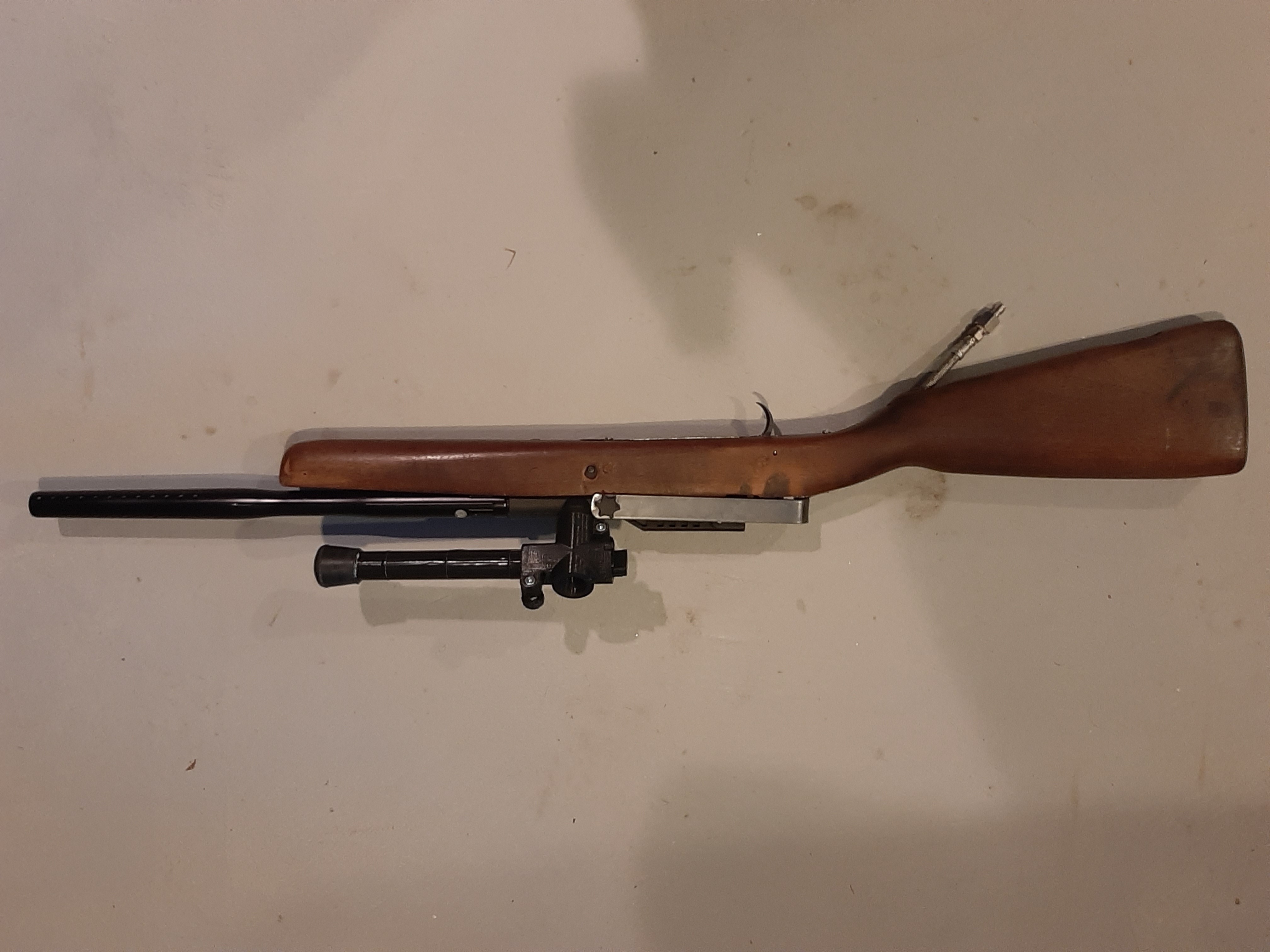

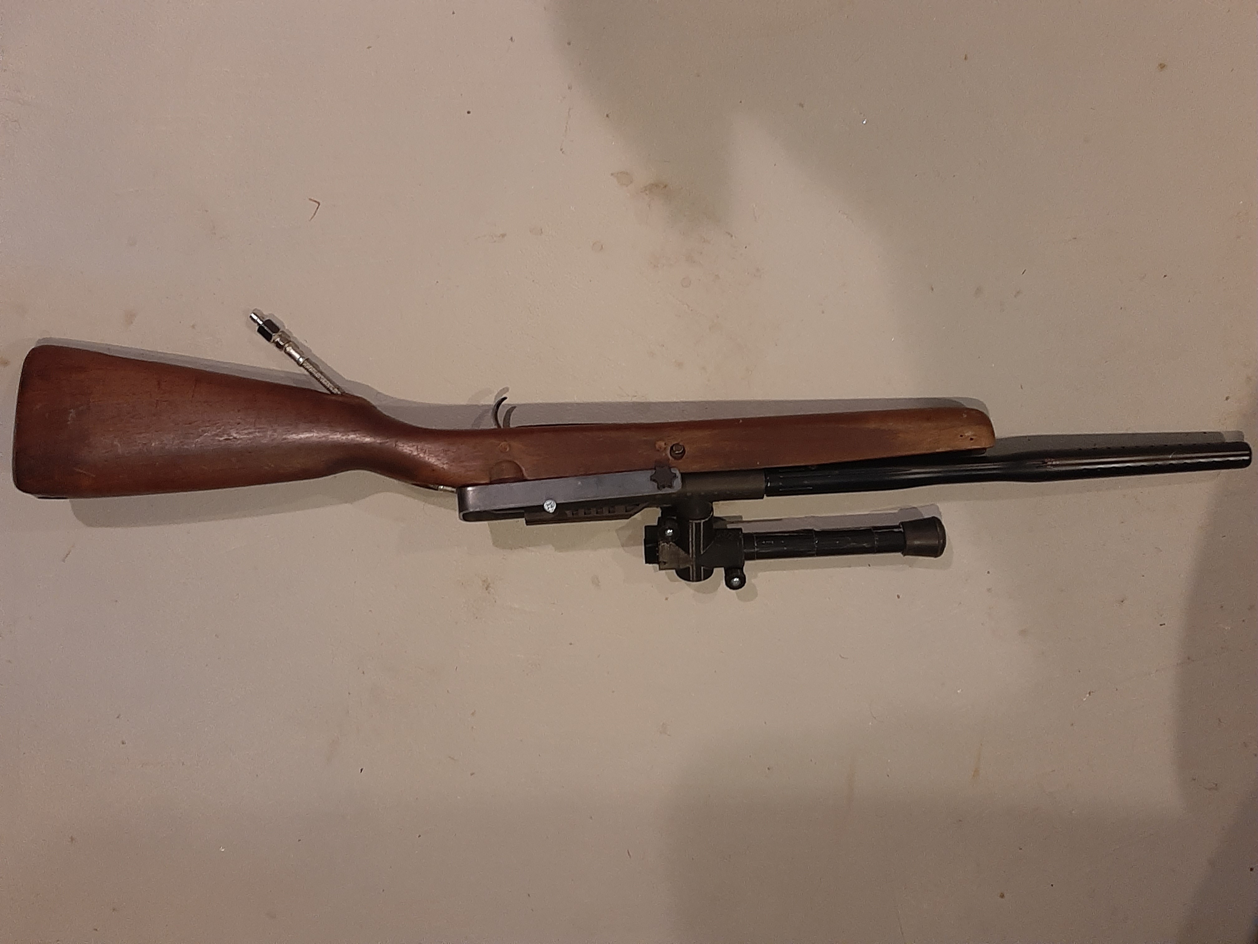

              Granted, it kinda looks like crud right now... But it's slowly taking shape. Meant to be single shot at a time for firststrike, pumped from the top for a prone position, and lightweight, thus the 12 gram adapter still installed or the potential of using my remote line.

              Okay, so shaping getting closer to complete... I think the front end is getting a military-esque shark mouth and eye painted on, and I kinda shaped the handle area like a shark fin... It evolves as it goes on.
              • RADwriter
                RADwriter commented
                The front end is kinda weird shaped, yes, but it gives me a comfortable foregrip while still giving me room to pump. Not intended to be a rapid firing pump

                Thought I would throw in my Tiger Shark rifle. I reamed the valve hole with a Dremel grinding stone, giving it more air flow. Probably needs a trigger guard.
