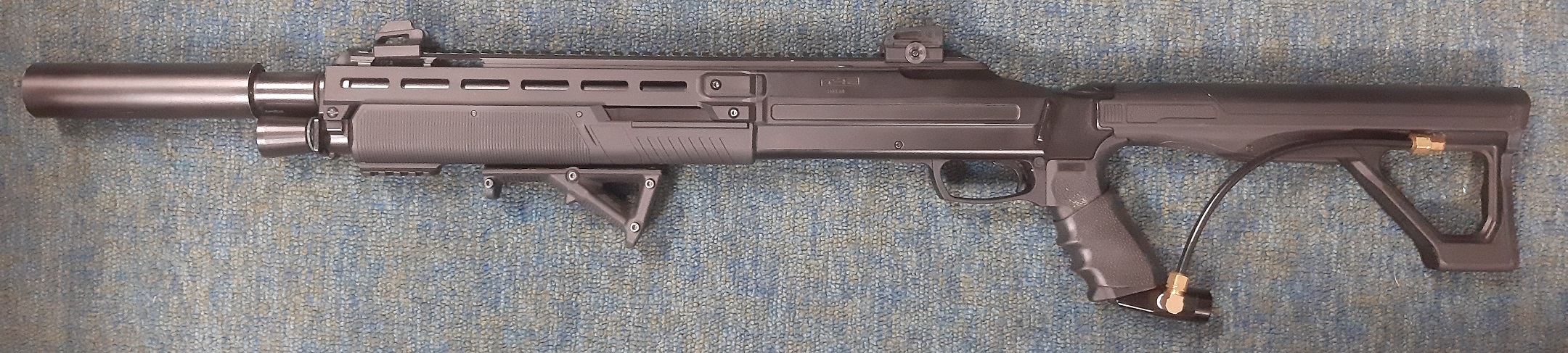

        I pulled the spring and chaser out and pour the paint in from the cap at the front. you get 20+ rounds. you can rig a phantom feed gate for a speed feed. Of course you need to twist it upside down when you cock it but its even more fun that way.
          • ElectricBullshark
            • Jul 2021
            • 39
            • Spring hill fl
            I like the foregrip and the supressor add on. Where did you get the foregrip?
            • capitalpaintball
              capitalpaintball commented
              Standard Milsig AFG or more likely the cheaper airsoft equivalent. I did have to mount a rail to the pump handle.
