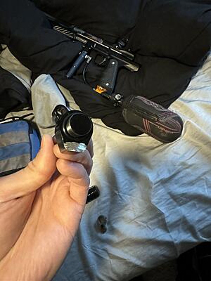

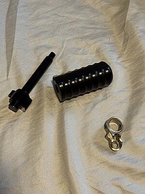

    I recently purchased this prostock body with the hopes of building my first pump. I was hoping to get some insight on somethings to keep in mind and parts I will need to complete this build. I am getting back into paintball after an 8 year break and do not have much prior knowledge in this department. The body and barrel are all I currently have for the build. I know I will need an ASA, regulator, pump kit, frame and back block. Wondering what else I should expect to purchase for this build.If you have any parts that would work for this build let me know as well! Any advice is much appreciated!

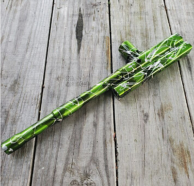

                  I've got a genesis pump kit I got from a member for cheap, I havent managed to buy a 2k+ cocker to use it with. The other member shaved the lip on the bottom of the front block to work on a system X body, but it should still work fine.
                  Ill sell it to ya for the same $25 shipped I paid if you are interested. Welcome to MCB.
                  Here's pics from the other members sale.
