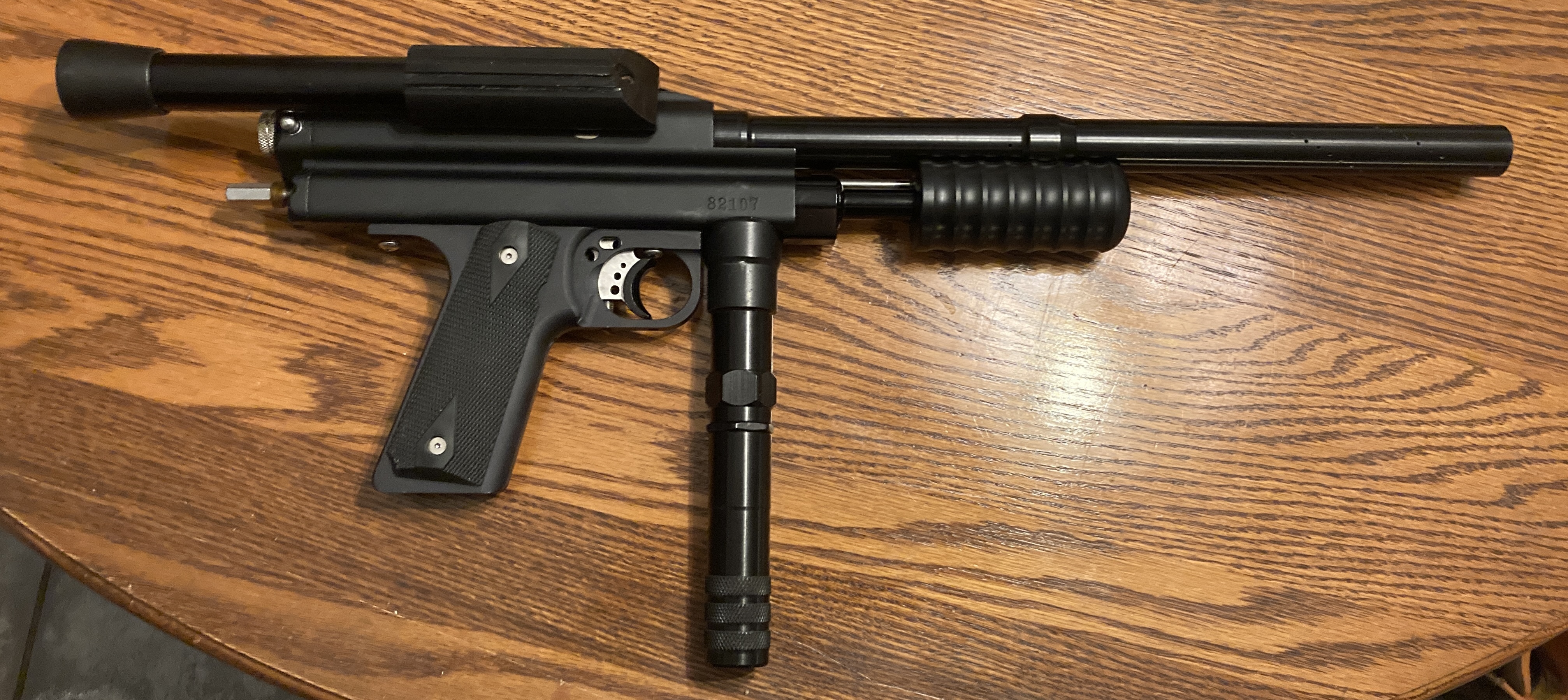

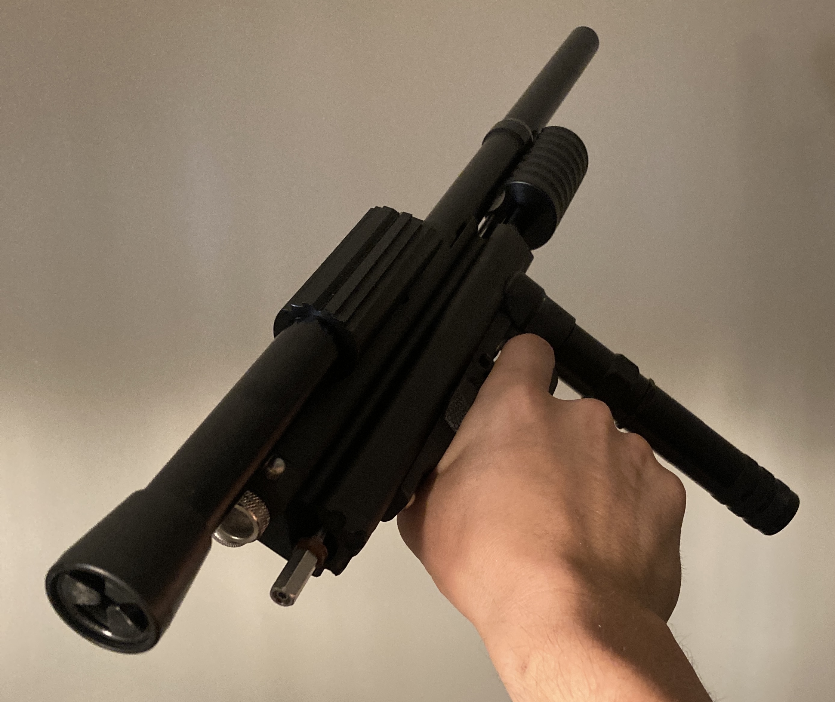

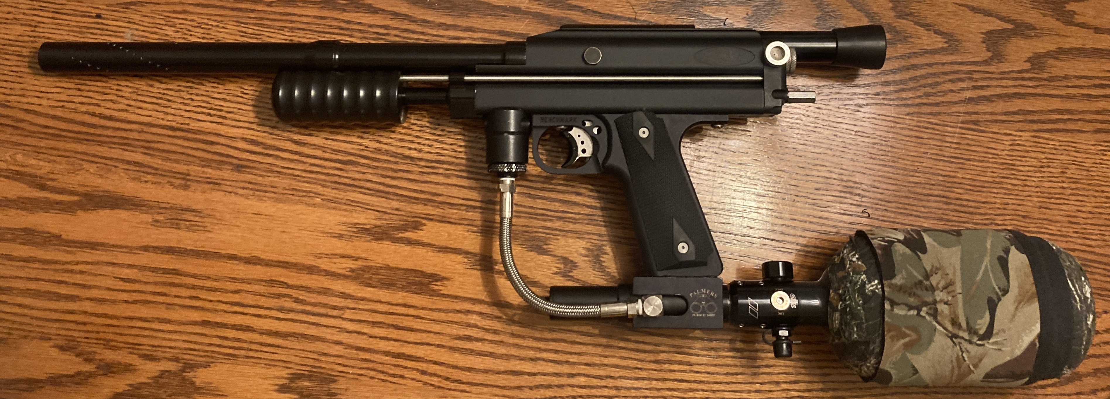

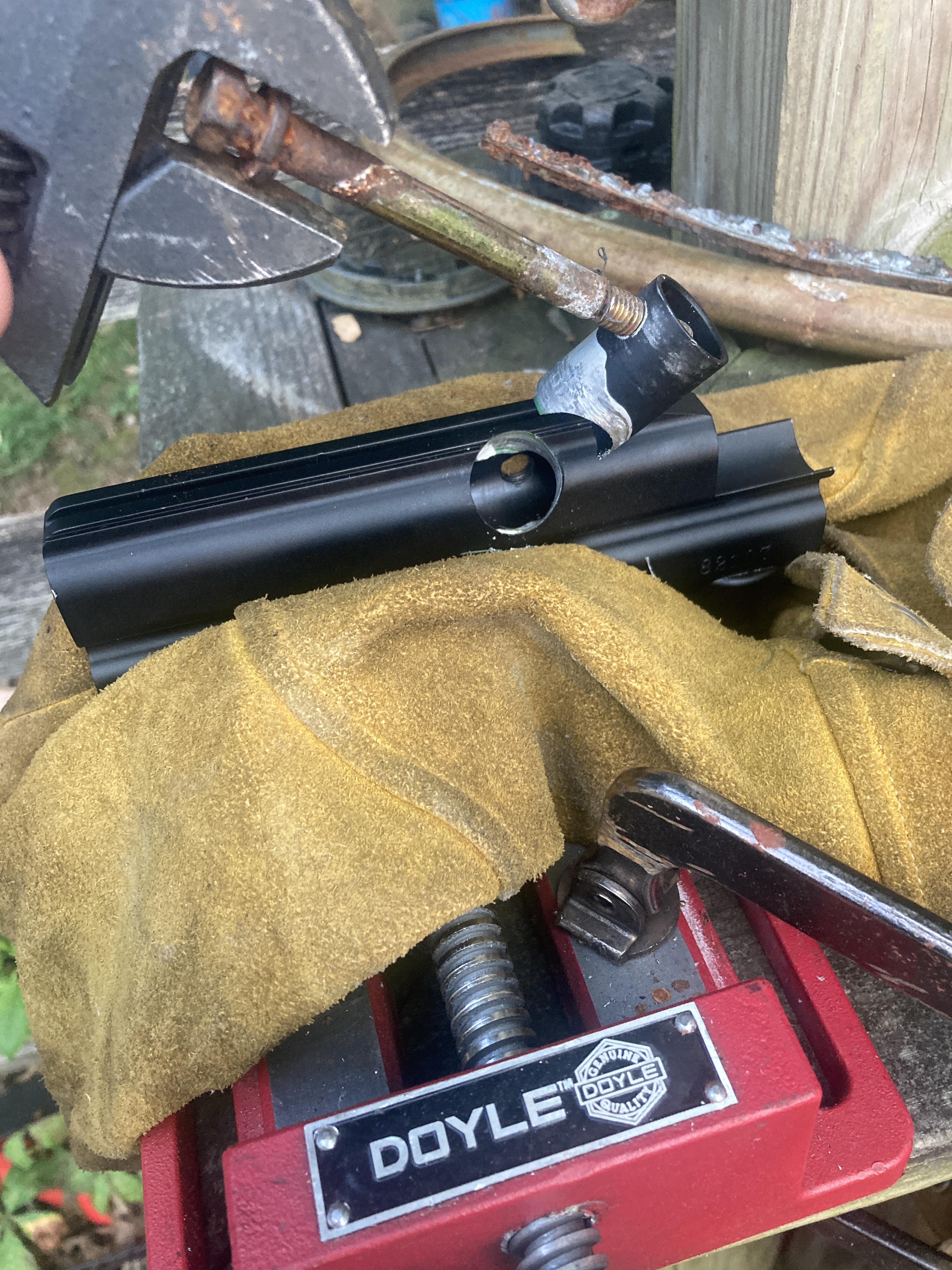

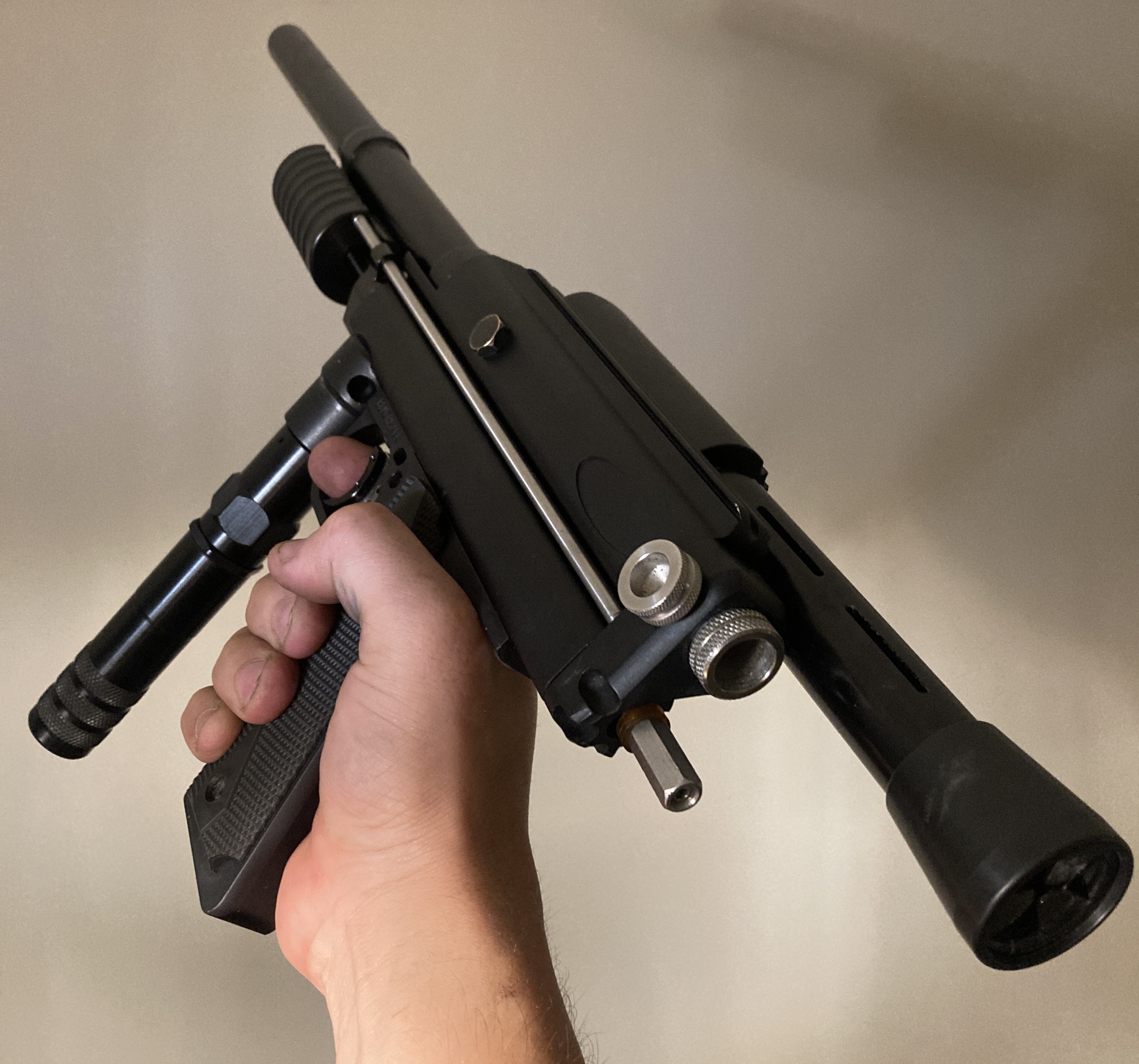

    Stock Class RF Sniper
    made this sniper a dedicated stock
    class feed today!

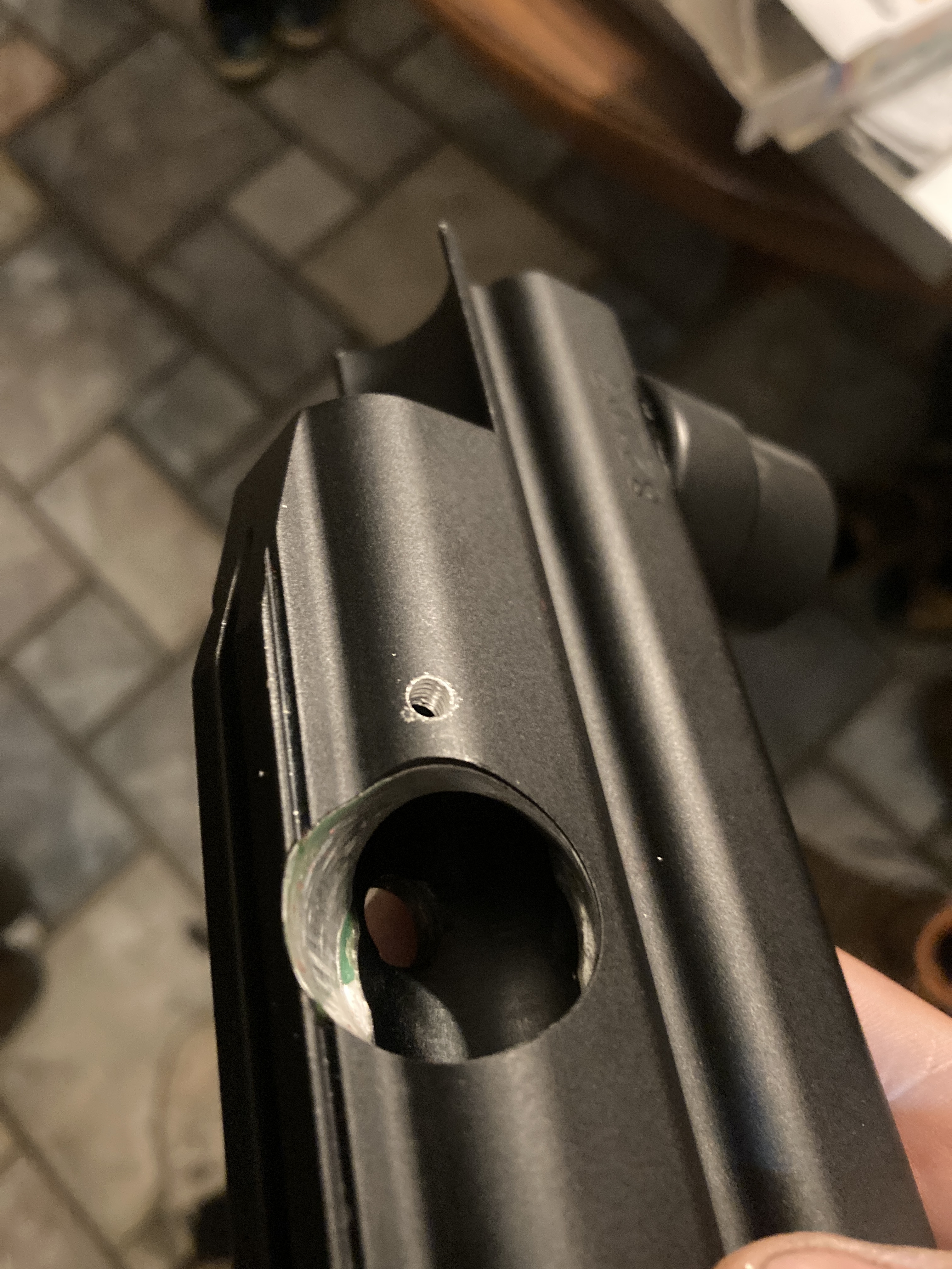

    pulled the neck, drilled + tapped my screw hole and threw it all together!
    sorta "Sleeper"-ish
    feels great in the hand and dialed in to 30shots @ ~275 per cart
    WELTHOUSE x Timberghosts
    my feedback

    Slick! Is that an inline reg on the 12g changer?
    • $L!mBo
      $L!mBo commented
      yep, Palmers Cart Reg set at~350psi

    Looks great , I have done this couple times and just a heads up as to not crank down too hard on that feed screw as it strips the aluminum pretty easily. Yes that’s how I ruined one.
    • NONOBLITUS
      NONOBLITUS commented
      That’s a good idea , I will look into that
      Carp commented
      NONOBLITUS ASP still has 3 of the 8-32 in-stock. But, the 10-32 is out-stock. Not sure, which you'd need/want though.
      Available in 8-32 and 10-32 internal threads. 8-32 inserts measure about .110″ high and 10-32 inserts measure about .200″ high. Sold in packs of 5.
      You need the 8/32 that’s the size the Phantom uses.

    Nice Save on that body it looks great! I got some devolumizeing printed pieces in mine. But I’m having issues getting the tune right I have been experimenting with.
    My Goal is Trying to get the 2k + volume down to pre 2k volume to see if I can edge out some more shots. I think I need some heavy springs. The piece I added could be dragging on the springs as well causing in consistency’s as well. I’m running a palmers cart as well. They can be a pain to adjust I got a dummy cart I plan on hooking some bulk c02 up and testing different input pressures. I may have taken to much volume to so I might need to trim it back a lil. I’m fingers crossed hopefull for a drop in 12g efficiency kit for 2k+ marker.
    I got the project center feed body with the feedneck milled off from Alex. I have gotten some good numbers out of it but it’s in constant. He made the devolumizer pieces I’m working with. I may try trimming the piece back a lil at a time see what numbers I can get.
    Alexndl is the one who had the idea for devolumizeing the lower tube.

      i bought the cart reg off Colby after he "gave up" on building a stock class sniper. Poor dude was trying everything possible, driving himself crazy. we've all been there! His process was pretty logical : pre2k body, tiny hole valves and bolts. just couldnt quite get it where he wanted.
      i threw ACP Gold(CCM clone) guts in mine, immediately got 23 shots at 300fps. switched to a lighter hammer spring and backed the ivg out a quarter turn and now shes getting 30 shots at 275. good enough for me, so im letting her sit like that.

    Seems like if you try to get anything more then 25/30 shots of a 12vie your just beating a dead horse, I have seen snipers get 45 decent shots but I think they were set up like your usual sniper/cocker
      Hellion has one that gets really great numbers to. It’s tuned perfectly. I would like to get mine there. Then I will make it all pretty. I got a Milled out Dock stock to go on it when it’s ready for Ano.

      would love to get mine milled Estilo/Mozak old school style. cut throughs, a few pill cuts, maybe the Evo style "popsicle stick" on the top tube to blend the jewel spot in. would just leave em raw
      Yeah I plan on sending it out for a fancy cut but I got to get it shooting right.

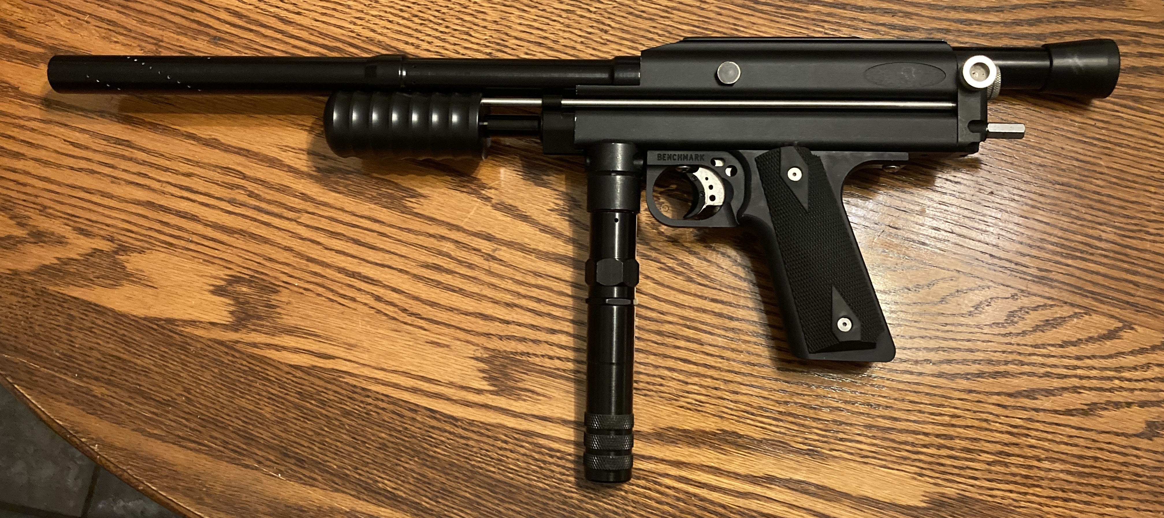

    I had Mozak make me a custom rf empire spec stub. The feed cap that comes on the ICD feed is hot garbage so I put a little piece of tape and a CCI feed cap.
    I went with a CCM lower tube kit and have the reg set at 350. I'm getting over 30 shots at 280 fps. It will shoot every shot at full velocity then vent a tiny hiss. I'm not getting any drop off.
