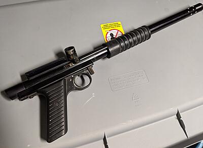

    Snagged an old WGP Ranger, any sources for information on these? Plan on going through it and fully rebuilding, anything I need to watch out for?
    First Nelson based marker I've ever owned, wouldn't mind setting it up for stock class/12g play, but I have never ran stock class either!

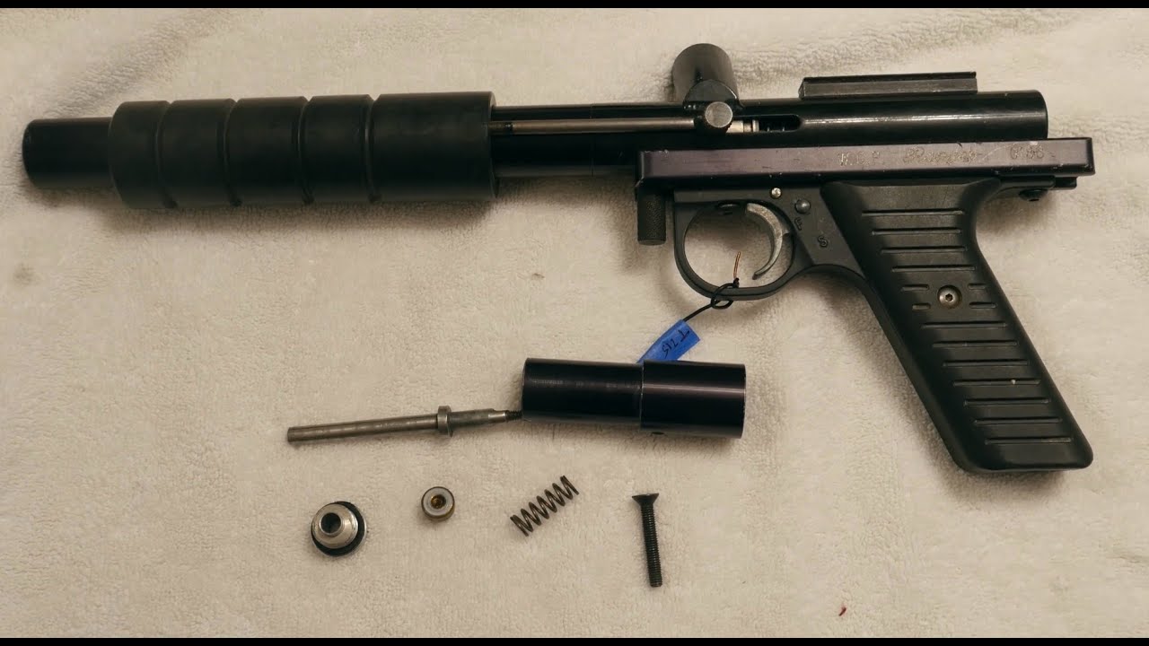

        Ranger showed up today, looking forward to restoring this one. Currently will not cock, excited to see what's inside!

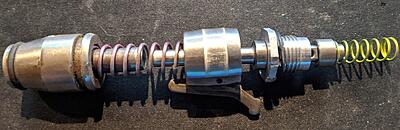

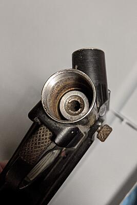

          Internals: The valve section is incredibly clean and the threaded insert is very soft, newish looking aluminum, is this something different from stock?

            That's definately a bore drop bolt. Does the asa have an adjustment screw in it? Many Nelson's did velocity from there.

              That is a velocity adjustable bolt you have there.

                It will only stay cocked when air is put into it. It's likely fine internally besides some old o-rings. Air it up and see if it leaks!

                  Thats a light weight (Pretty sure) valve spring and a heavy main spring.
                  As Sethzilla said Most Nelsons won't cock unless you have them pressurized.

                    That's not the stock ranger valve nut and cup seal. For whatever reason rangers have a solid brass cup and there is an oring on the back of the nut it seals against. It's not a bad thing that it's been changed, I've never got mine to shoot on hpa with the stock valve train but it works great with a lapco #6 power tube.

                          I'm playing tomorrow! First time shooting it!
