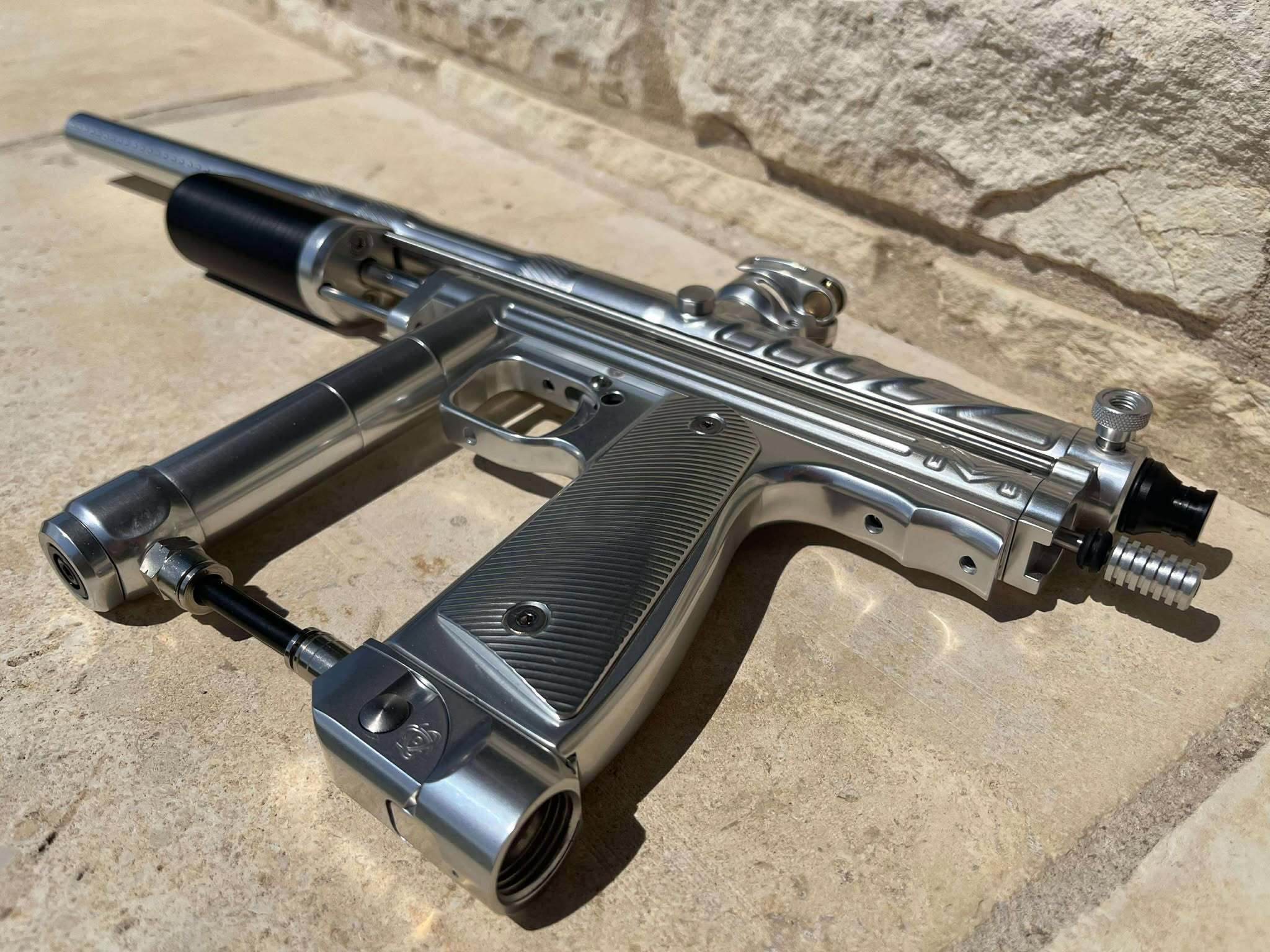

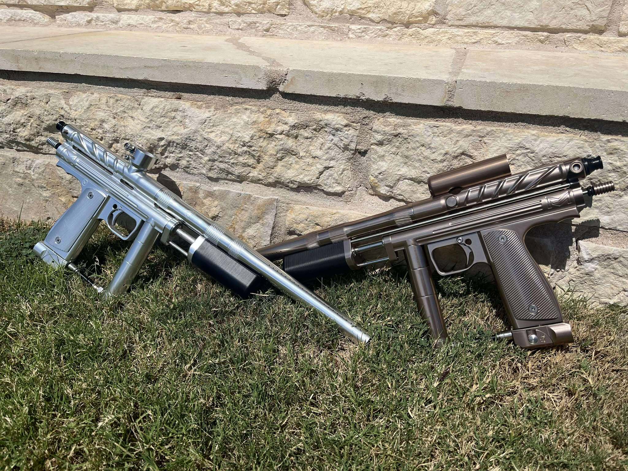

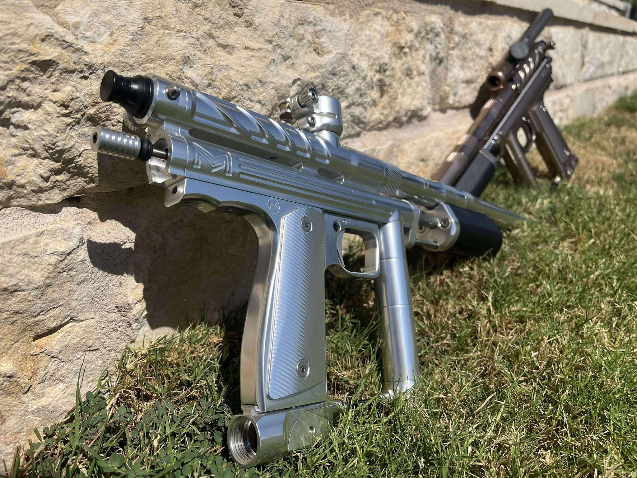

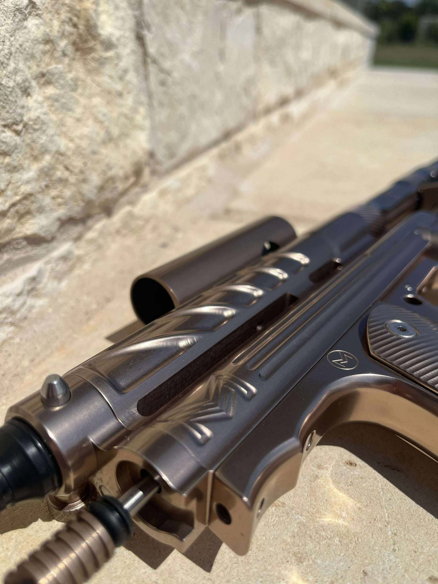

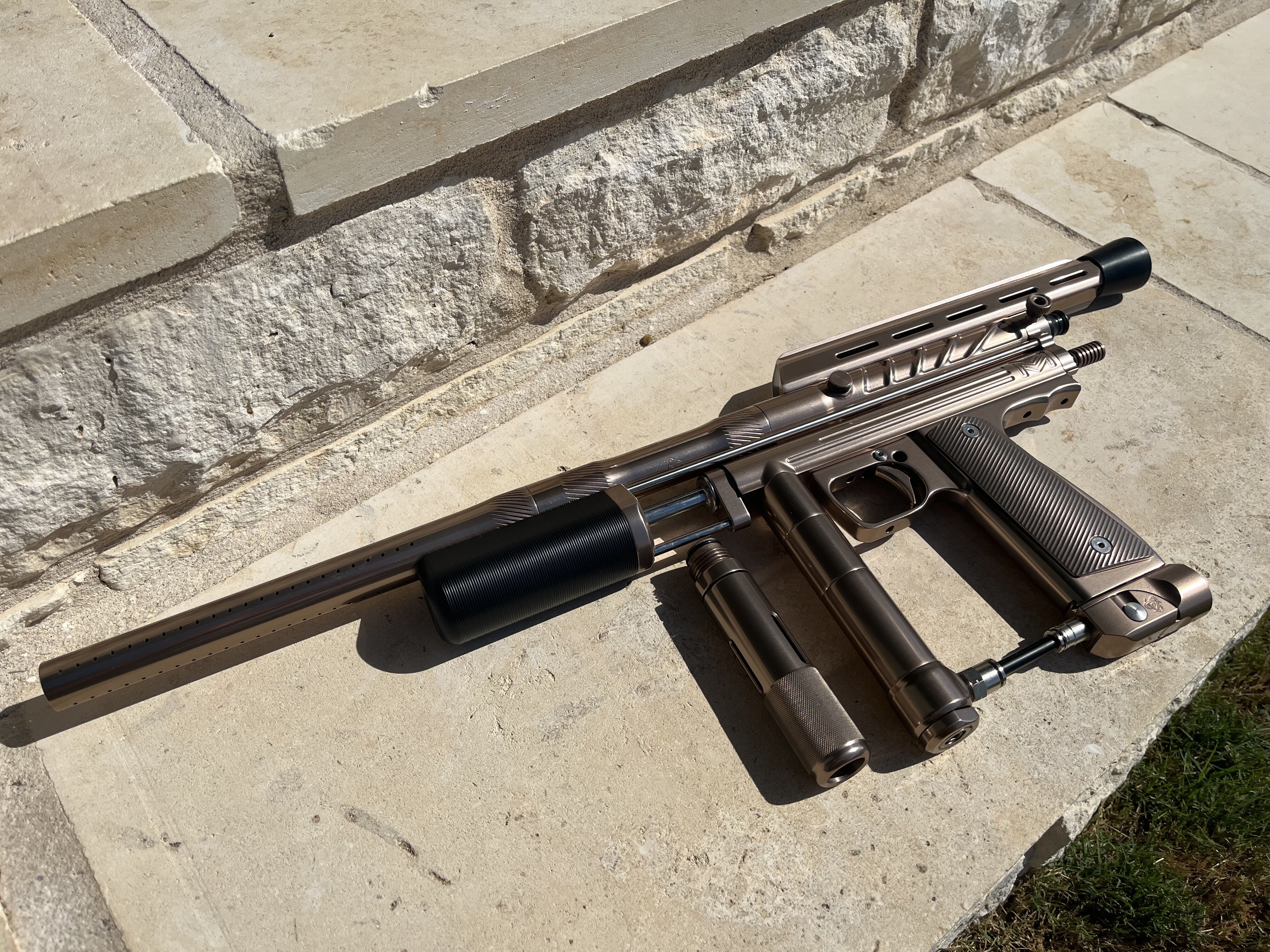

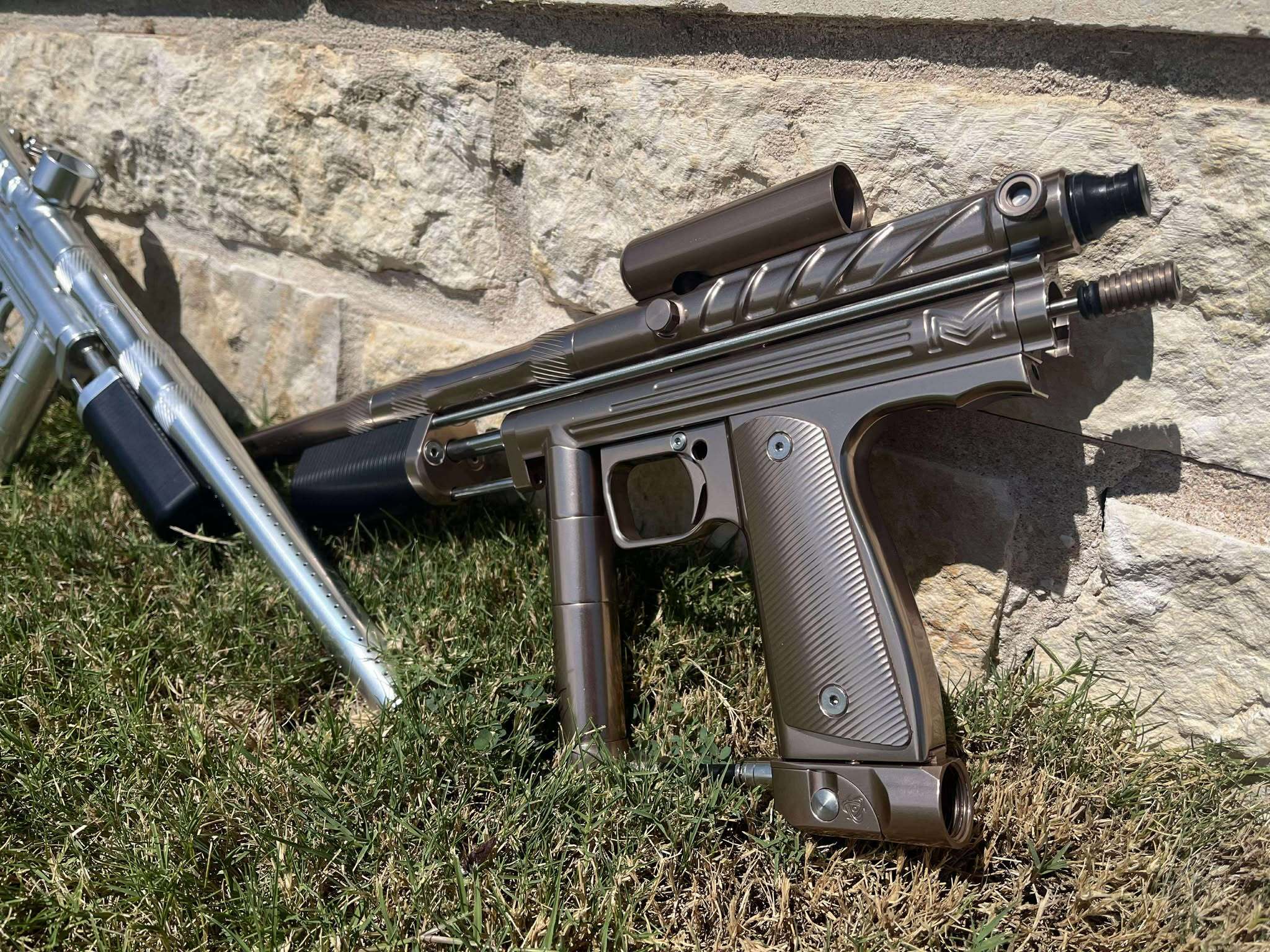

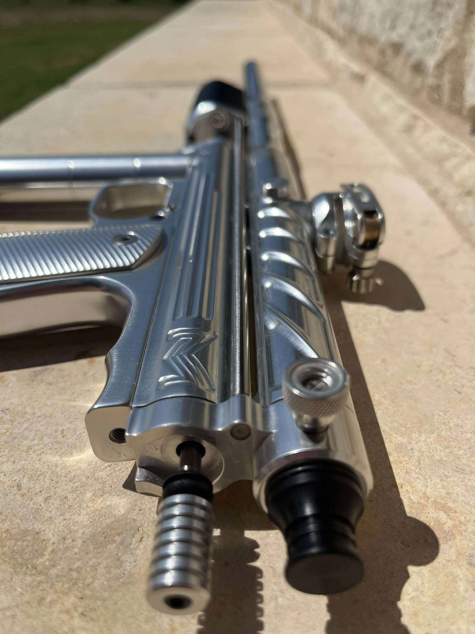

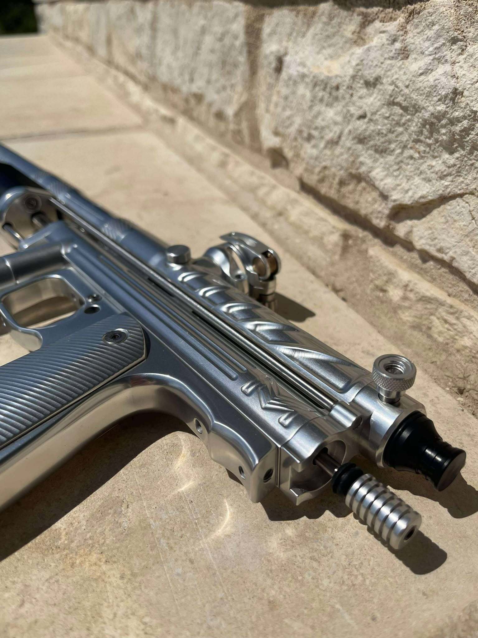

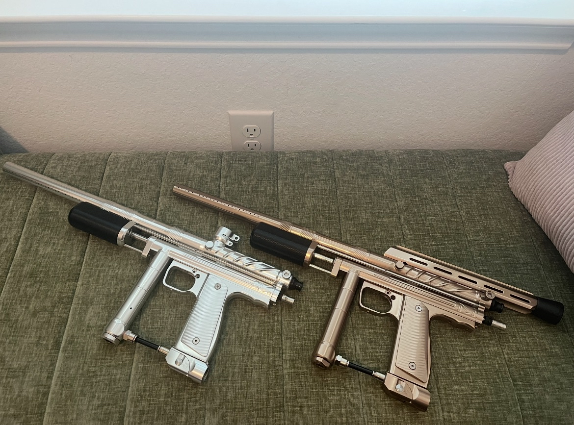

    I wrapped these builds up about 4 months ago, but I haven't gotten around to posting these.
    This originally started as just the stock class build with a custom cut from Mozak. He had to make the OD on the NOX cut body a little larger than the standard cut to make the stock class feeds sit flush on top of the body.
    Somewhere along the line I picked up a second Mozak 86 frame for future use. Then in February, Mozak posted an extra NOX body for sale. That began the open class build and I set out to make two identical snipers to cover all my recball needs.
    I had these anno'd by Ruckus and I'm happy with his work. The open class pump is basically just a clear / silver anno and the stock class has a darker bronze anno that Ruckus helped me pick out.
    Highlight so far has been playing IoN 2025 with the stock class sniper.
    I'd like to build a gold anno Vee Twin with dual 12rd phantom feeds to complete a trio of bronze, silver, and gold snipers, but I'm going to enjoy these for a while before I go spending more money
    Parts shared between both builds:
    • Mozak Machine NOX Cut Body
    • Mozak Machine Slender 86 Frame
    • Shocktech Super Fly Bolt
    • CCM Internals
    • CCM EZ Pump Kit w/ 10" ACP Karni Length Pump Arm
    • AKA Cocking Rod
    • AKA Sidewinder w/ Long Top
    • Inception EZ ASA
    • ACP Ball Detent
    • 14" Freak XL Barrel
    Parts specific to stock class build:
    • Kit Cram N' Jam
    • Phantom 12rd feed (not shown)
    • Phantom 12g bucket changer (not shown)
    Parts specific to open class build:
    • Inception Feedneck

      I wanna see photos of the stock class one with the phantom parts on it! These are so damn purty

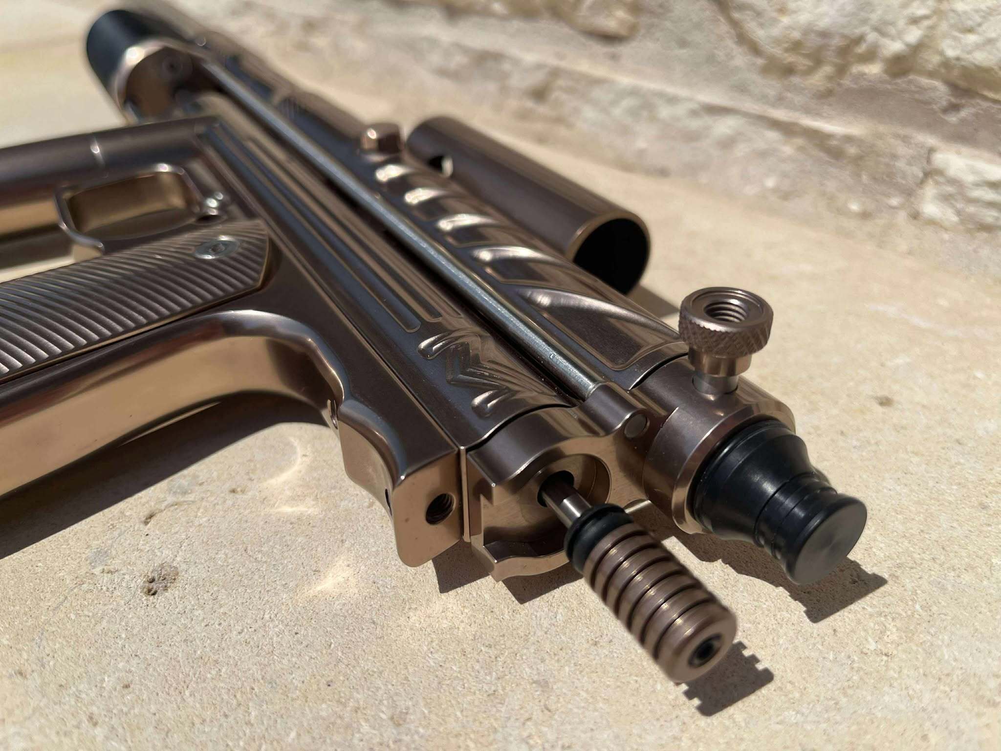

        Impactfour I usually run the 12rd feed, but I just got the cram n' jam back from anno, so I've got that on there right now to try out next weekend!

          Oh man. It's better than I imagined, what a beautiful pair you've got hahaha

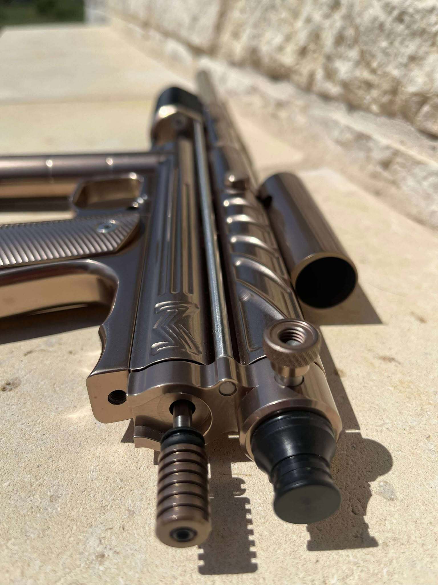

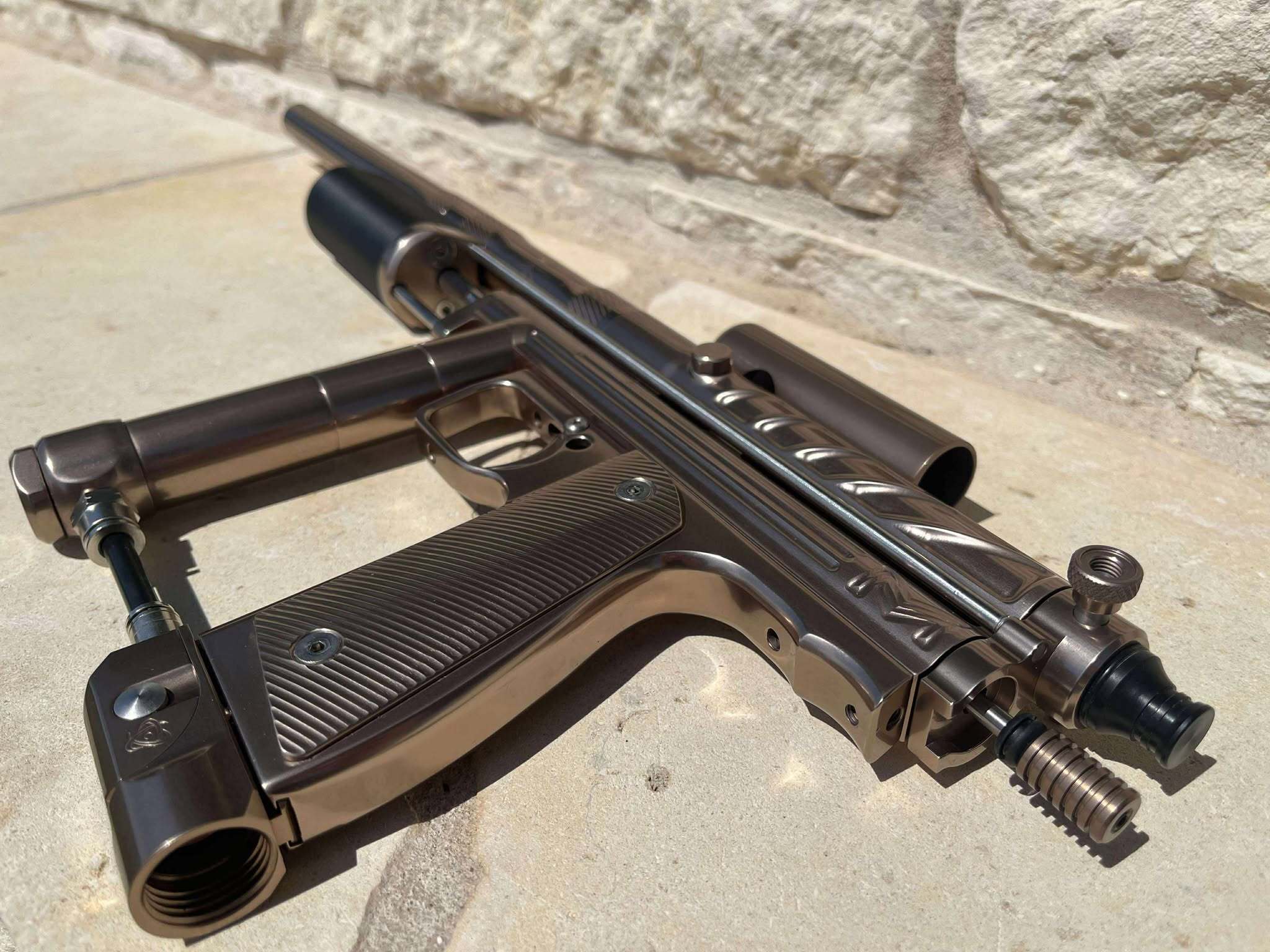

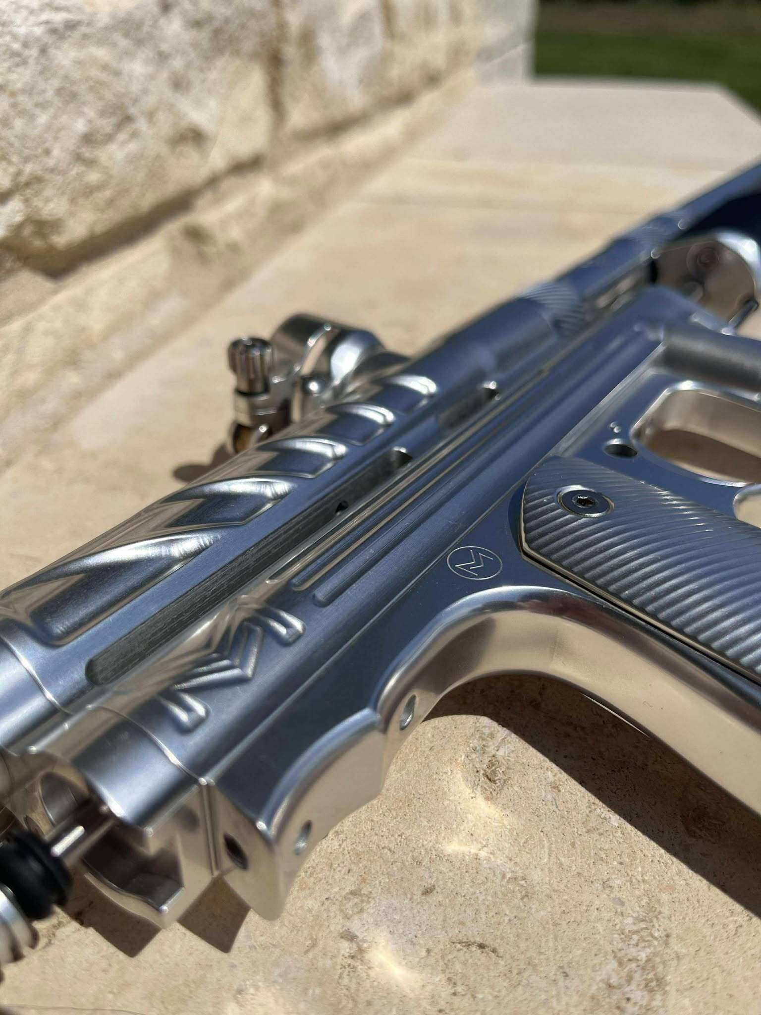

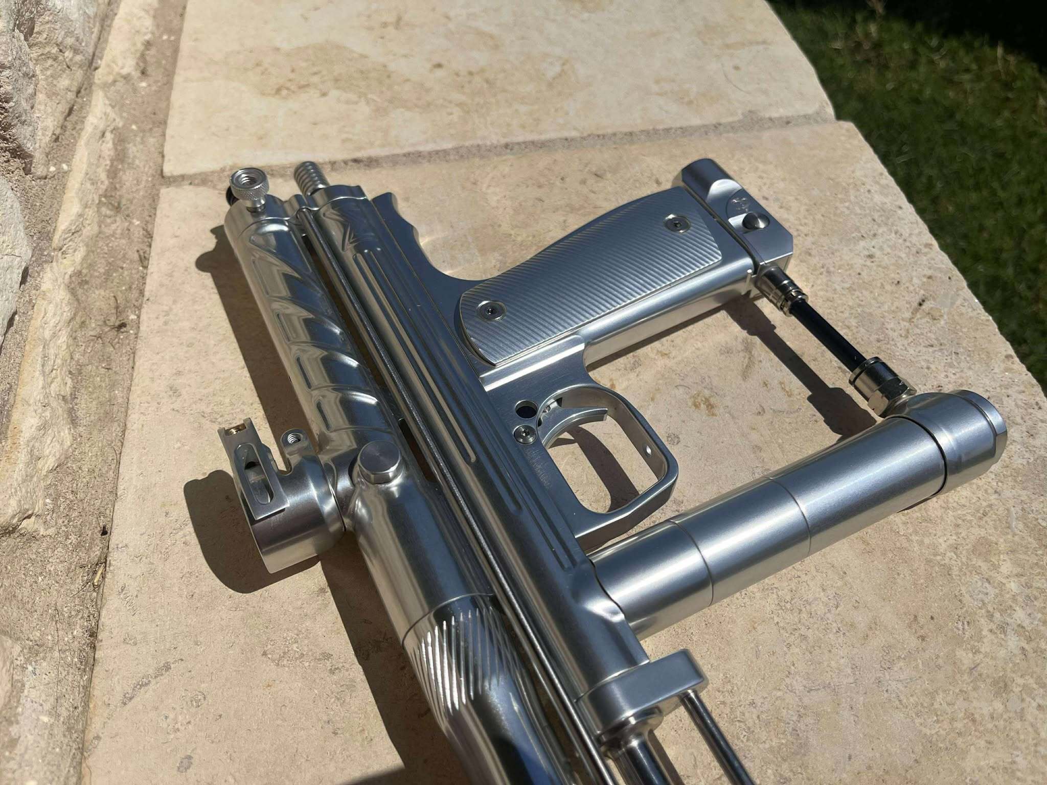

          Some better pictures with the 12rd feed.
          I haven't tried running it with 12g yet. Curious to see if the CCM internals can take them unregulated. I might need to throw some different springs in it.
          • BLachance75
            • 1114
            • Western MA
            Both are amazing looking, love the colors.
            Try running the 12g regulated. I switch my S6 back and forth between hpa and 12g with very minor ivg adjustments. 12g are about 10 fps slower than hpa for me. I also have a pre2k sniper with CCM internals that I run on 12g. It is regulated and I get 35+ shots per 12g on a nice day.
            Red One
            • Booska
              • Feb 2023
              • 79
              • TX
              Thanks! I'll have to give it a shot regulated. Jared at AKA told me the SW takes 12g quite well.
              Do you run a braided hose on your S6 when running 12g?
              • BLachance75
                • 1114
                • Western MA
                No, macroline with CCM fittings
