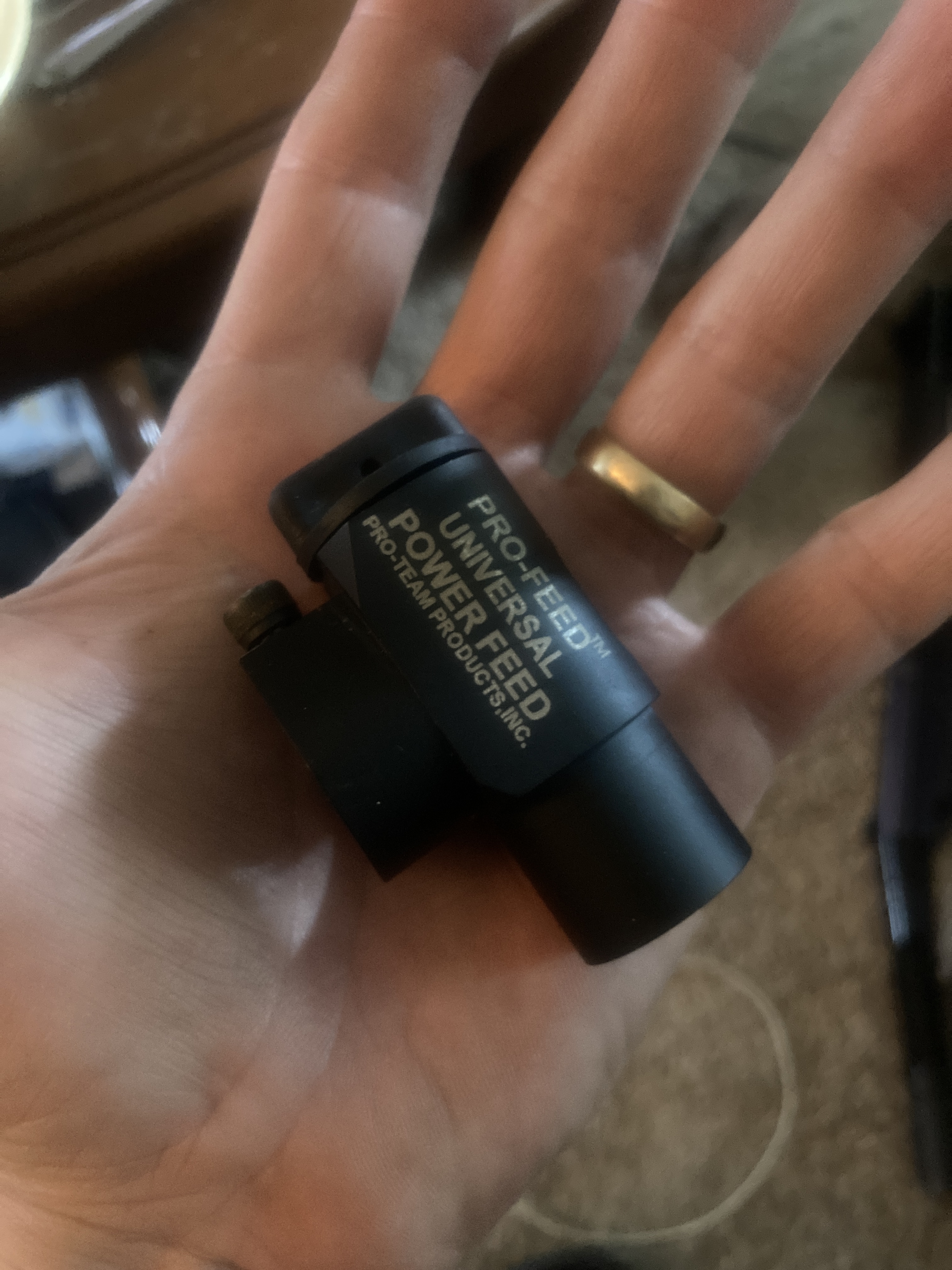

    I had a cool part show up today, PtP Universal powerfeed! fooling around in my parts bin, this new little piece would form the basis for my next frankenstein!

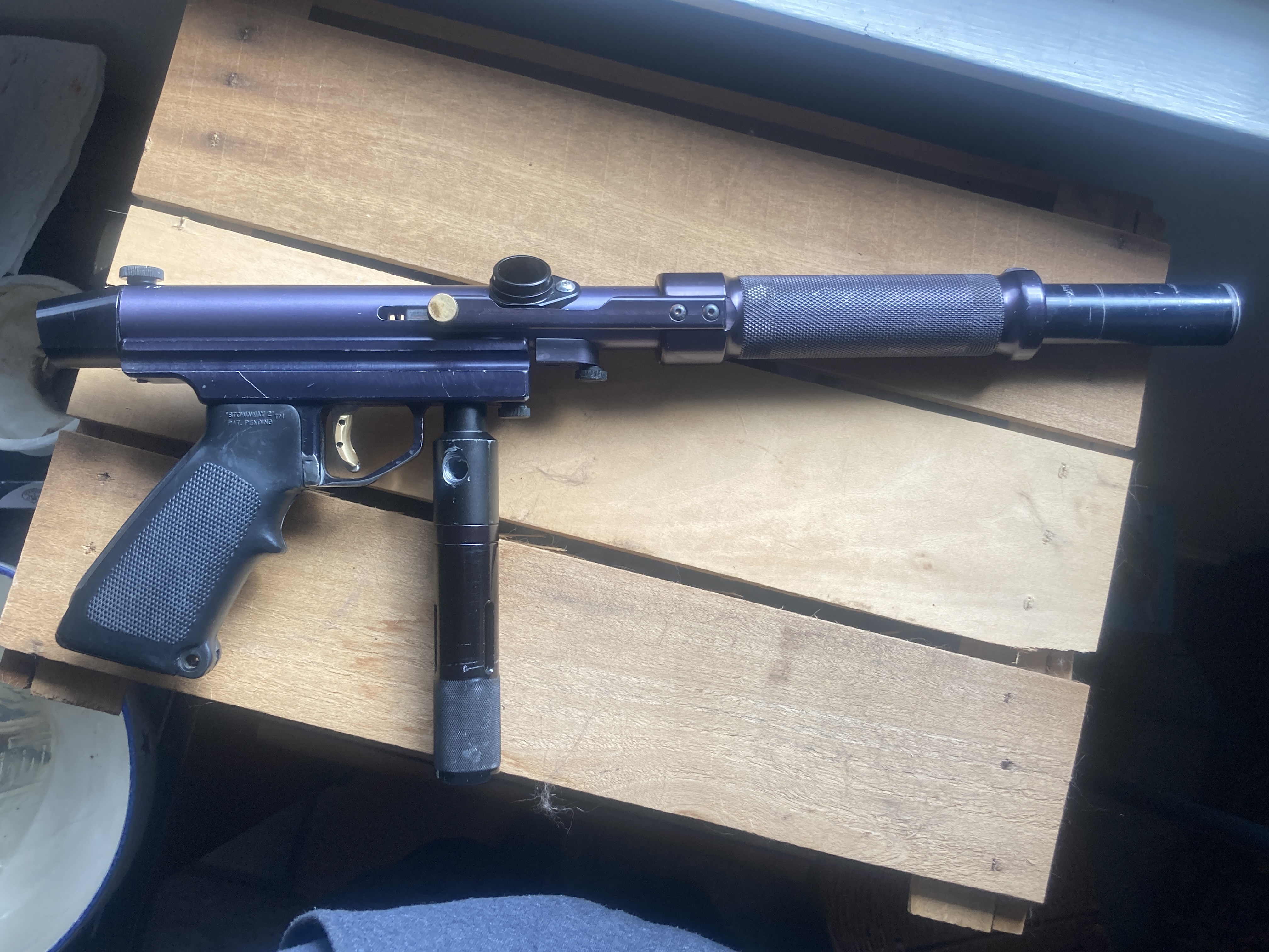

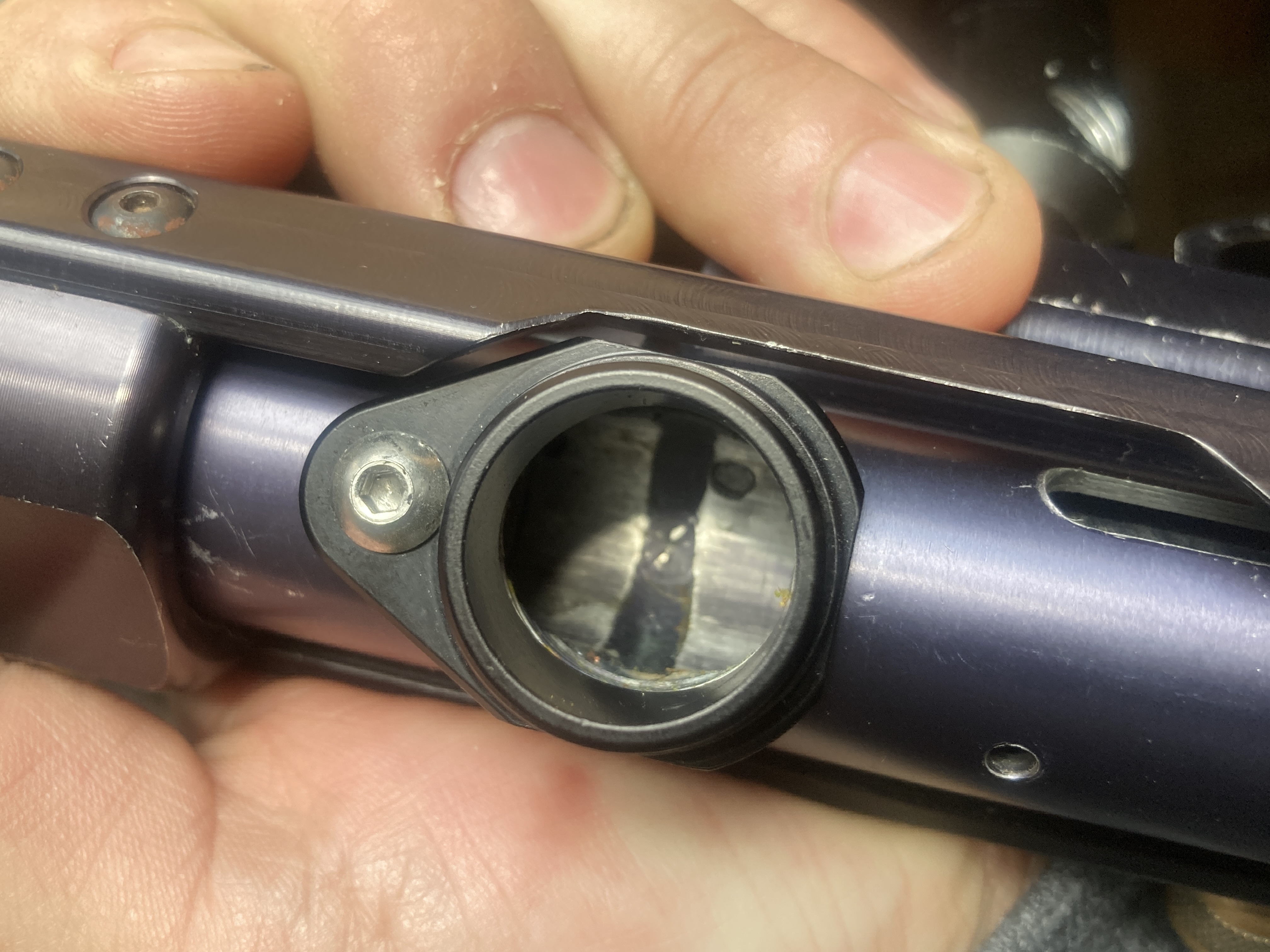

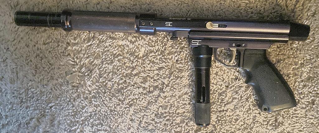

    This is a Bushmaster i picked up from a seller on the West Coast who claims it used to belong to Jack Wada, of the Kamikaze Shooters. While that is a very cool (if true) factoid, i mostly grabbed it because it had a removable barrel that was bored for freak xl inserts and some other parts i planned to use for other things.
    Click image for larger version  Name:	IMG_5223.jpg Views:	0 Size:	37.3 KB ID:	810600
    The Bushy gets loaned out at our stock class events, but besides that, she mostly sits. I also like to put it in folk's hands when im showing off my collection to the younger generation. "back in the day, THIS was the hottest gun out there!"

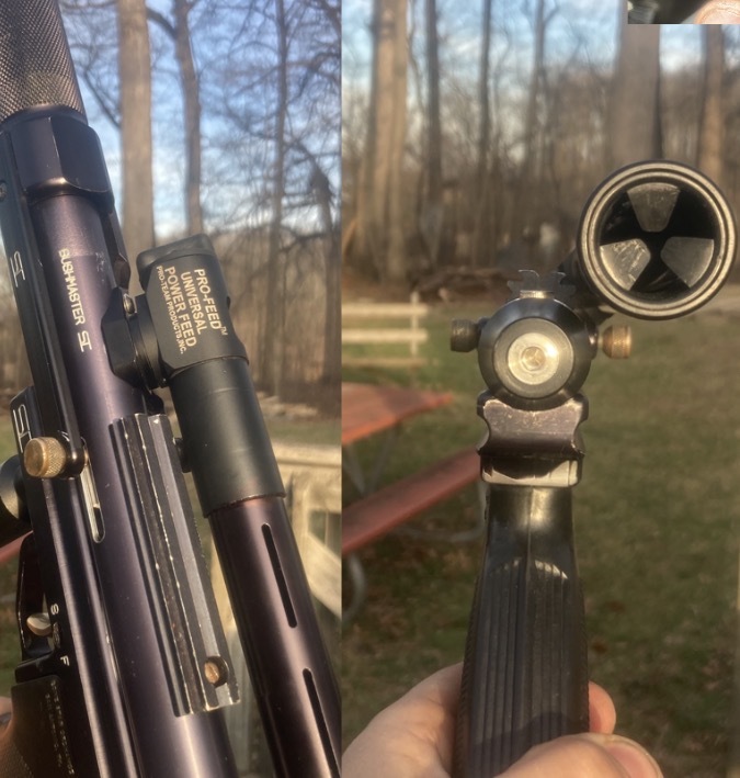

    After swapping things around on my Lapco to turn it into a Vertical Stock Class configuration, I was pleasantly surprised at how nice it was to have an old, "phased out" side feed marker modernized a bit. A sort of anti-Phantom. Maybe 'bizarro' is the better term!

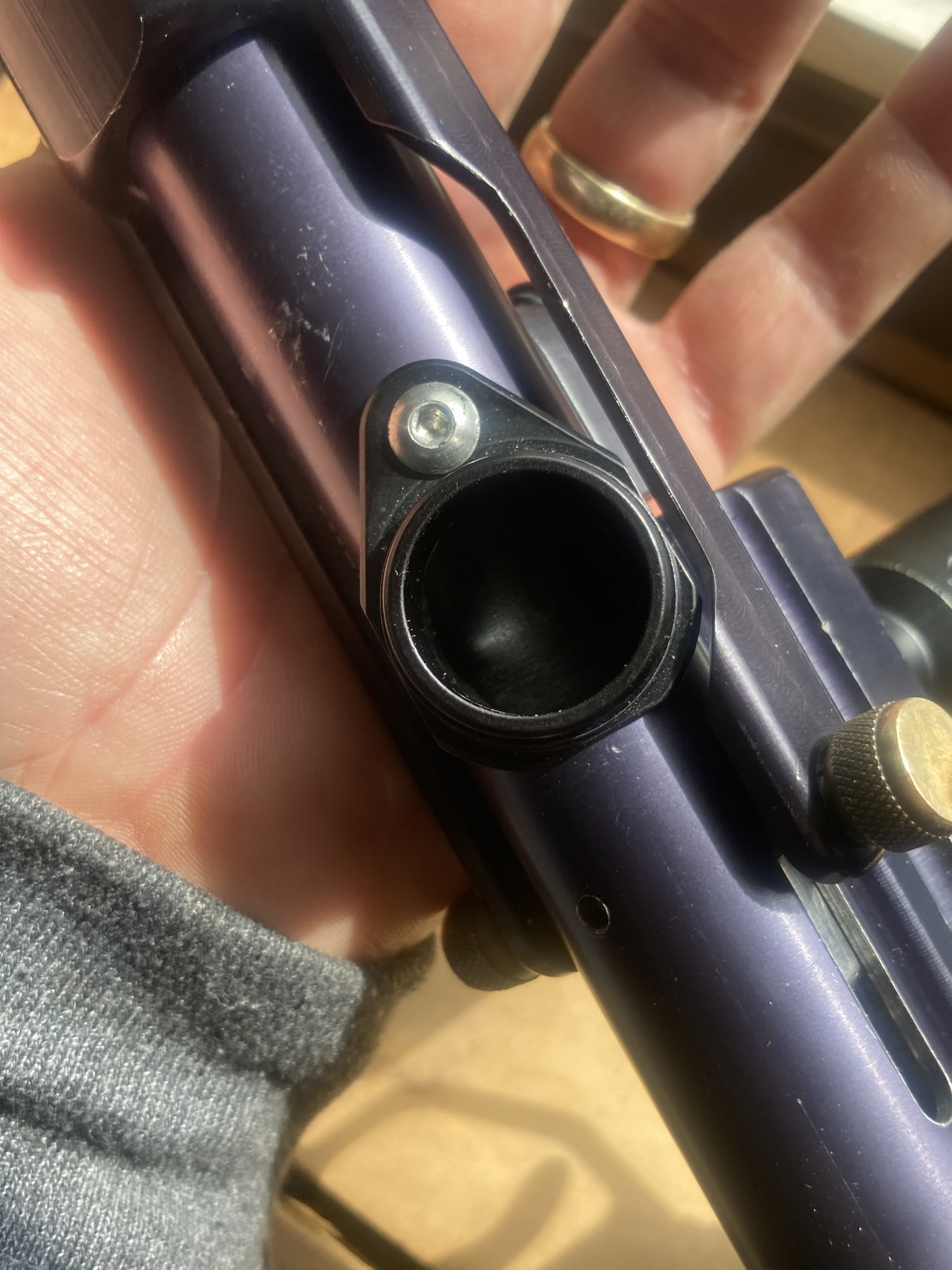

    Being dual rod, my usual modus operandi of pulling the feedneck and drilling and tapping for a phantom feed wouldnt have the clearance. But with this ProTeam feed, and one of flyweightnate 's phantom neck adapters, the ball is rolling!
    This combo fits like it was made for it! Everything's in the 'fitting-up' stage right now but i'll probably get it attached soon.

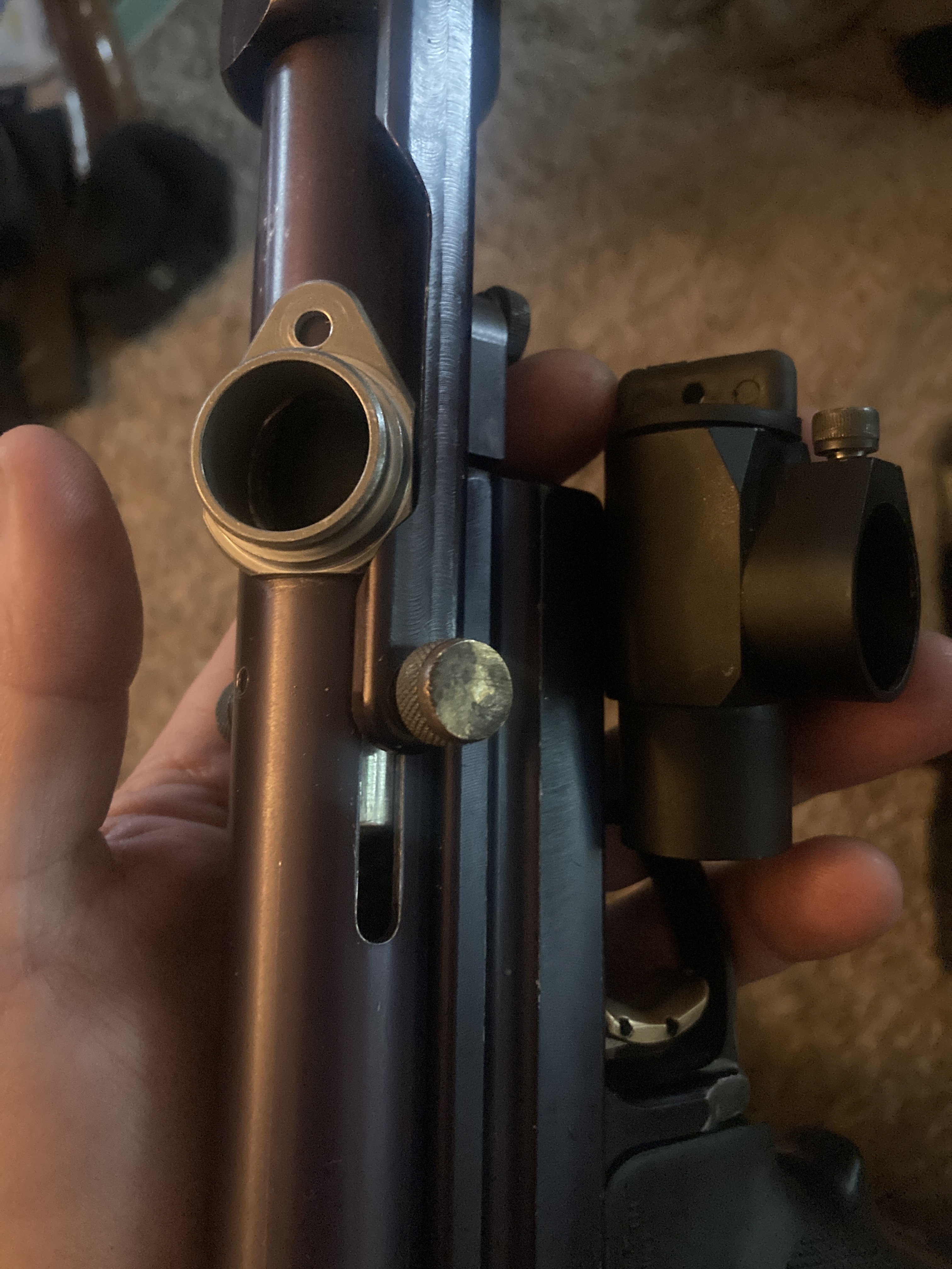

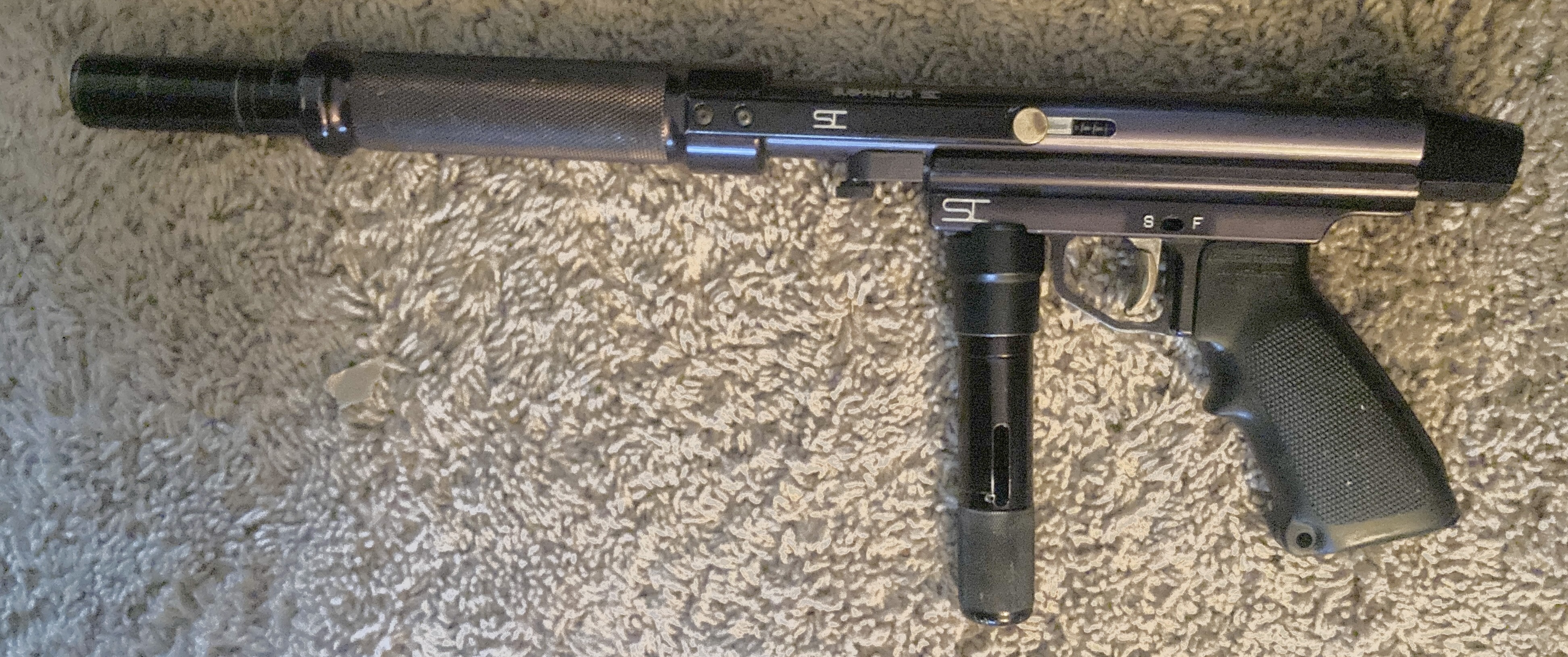

    Onto the vasa! I think ill be able to mount something on the same screw hole that attaches the trigger group to the rail, right in front of the guard. a WGP piece actually fits the contours beautifully! But maybe ill try an AGD to save me the trouble of putting the 1/8th NPT hole in.
    Click image for larger version  Name:	IMG_5222.jpg Views:	0 Size:	3.00 MB ID:	810601

    That’s rad. I was thinking of running vasa on my bushy but who knows when I’ll get to that. Was the feed neck easy to come out? Very cool.
    • $L!mBo
      $L!mBo commented
      it unscrewed with a little elbow grease.

    Back in the day, I turned a stud that was 10-32 on one side, 1/4-20 on the other so I could mount a Mag VASA (with the ears trimmed off) on the front of a Bushy frame. I'm getting similar vibes!
    Planning to plug the vent on that Cocker VASA somehow? I might need to make a little plate to turn the air 90 degrees for you...

      out of my parts bin options, im heavily leaning towards the wgp. the ears fit the rail perfect and i kinda like the chonk iness
      i was gunna just booger up the passages with jb weld or hit em with the spoolgun at the shop
      but a phrameworks piece would be top
      shelf
      if youre interested,
      what i REALLY would appreciate help with is a cleaner looking valve body. something that comes back just a little past flush, maybe tapped for a rear gauge? ill probably go through the body (or slot it?) for the hardline connection

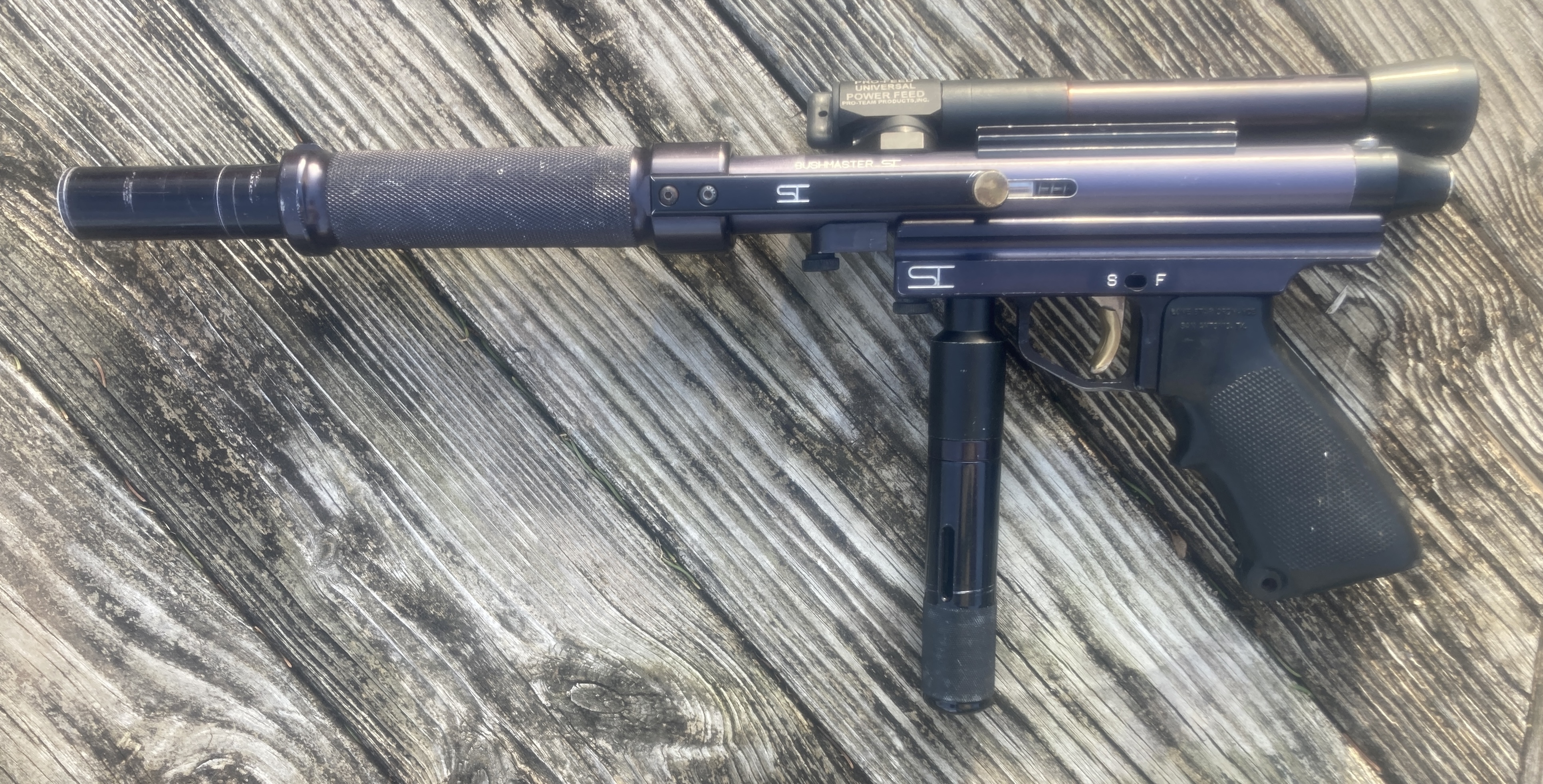

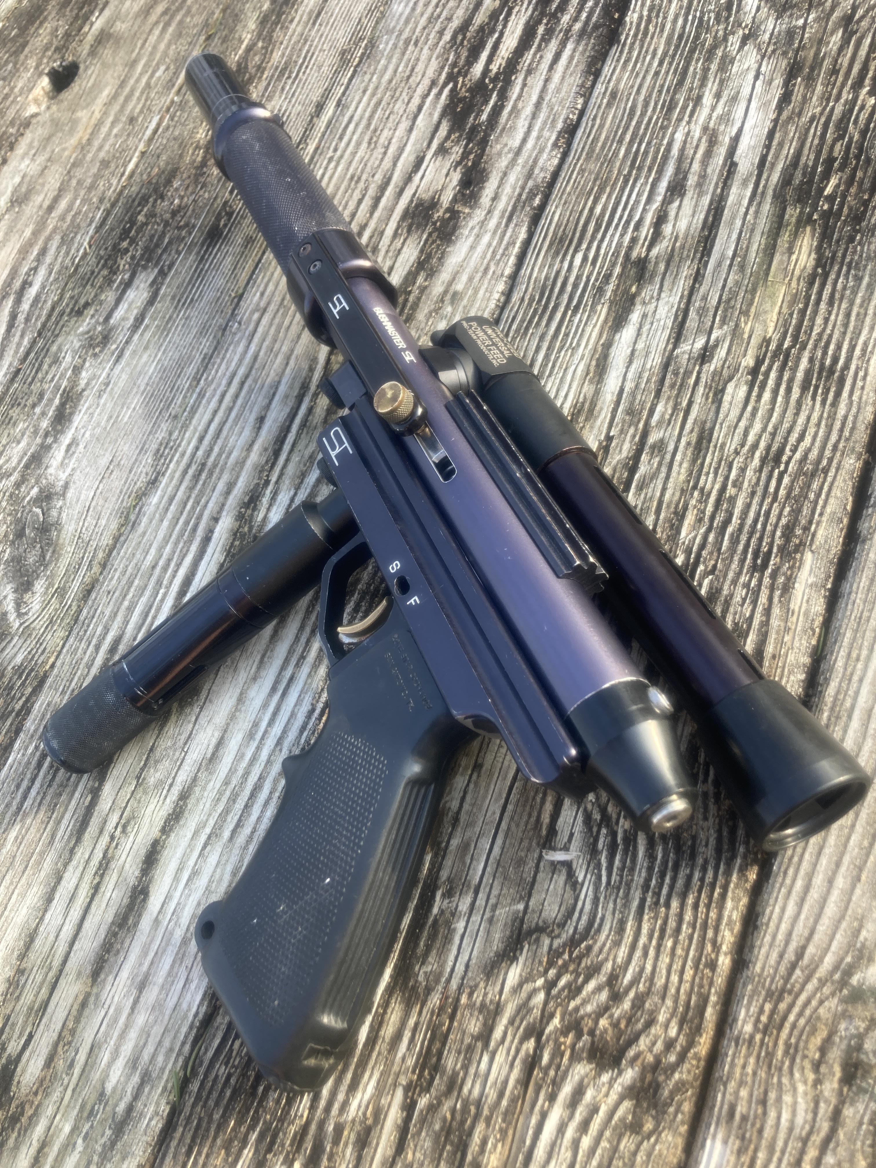

        gettin CLOSER
        Click image for larger version  Name:	IMG_5462.jpg Views:	0 Size:	4.46 MB ID:	814293 Click image for larger version  Name:	IMG_5463.jpg Views:	0 Size:	3.11 MB ID:	814291

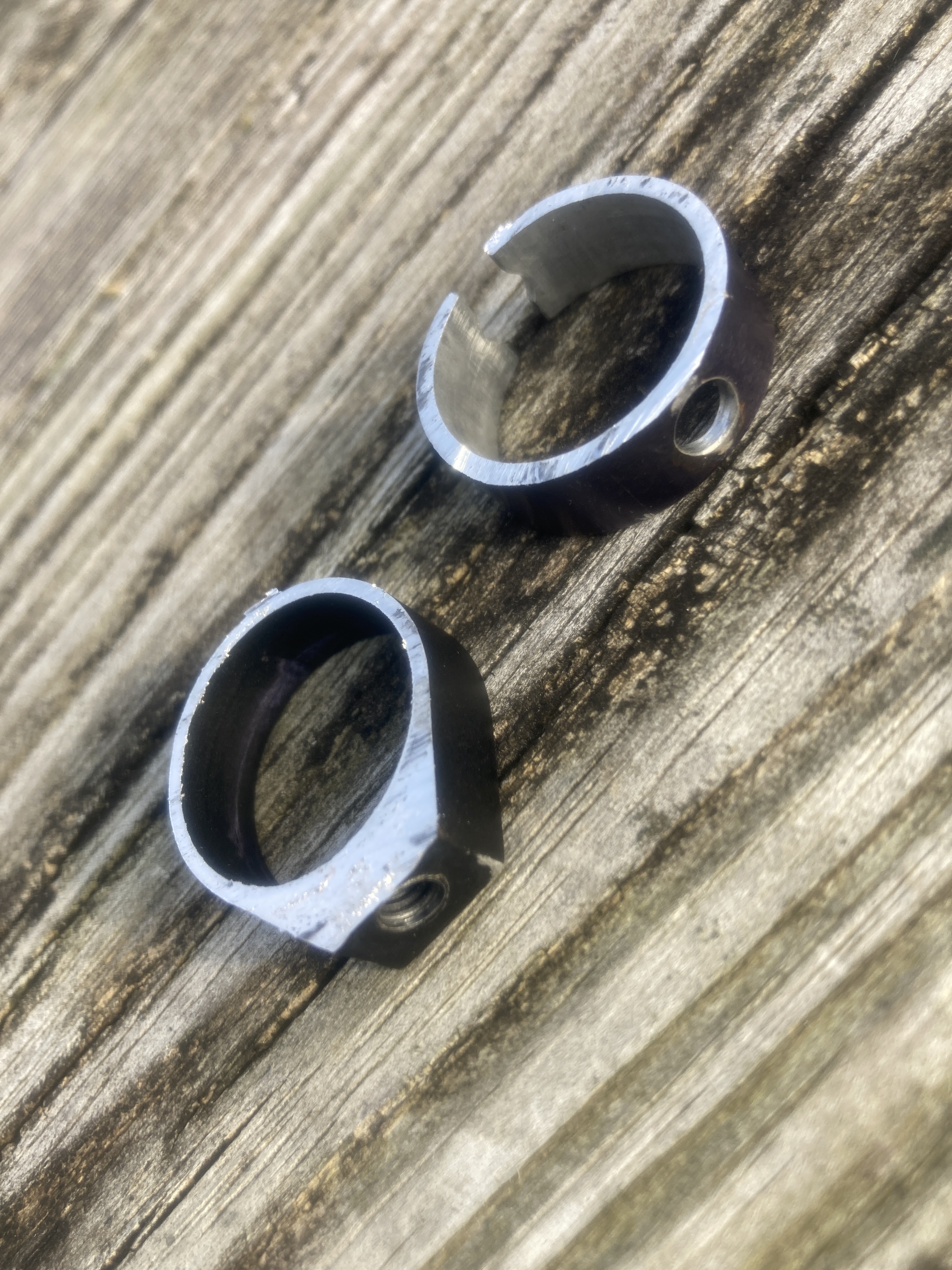

        the feedtube/feedblock coupler is hardware store copper rattlecanned matte black
        snipped the ptp feed for a lower profile and nipped the bushy's behind to fit a lapco valve body!
        Click image for larger version  Name:	IMG_5461.jpg Views:	0 Size:	3.42 MB ID:	814292 Click image for larger version  Name:	IMG_5475.jpg Views:	0 Size:	113.2 KB ID:	814290

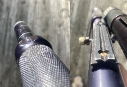

        also found a vgroove sight rail in my pile. looks good on there, matches the pump handle sight
        Click image for larger version  Name:	IMG_5473.jpg Views:	0 Size:	35.0 KB ID:	814289

          Looks great, how is the pro-feed held on?
          • $L!mBo
            $L!mBo commented
            friction fit! good enought for the feedcap,
            good enough for me!
            its on there pretty tight
            i can carry the marker by the feedtube no problem

          Time to cut this one loose! Took it to Slim's Spring Game, no dice S/T!
          Let me know if anybody would like it!
          Small updates:
          Ive drilled a hole through the PtP adapter so the mounting screw can be tightened/loosened without yanking the thing apart everytime.
          Just pull the feed plug and shes easy to get to.
          The EV hardline seals SUCK so i swapped to braided stainless. kinda matches the knurling all over everything else
