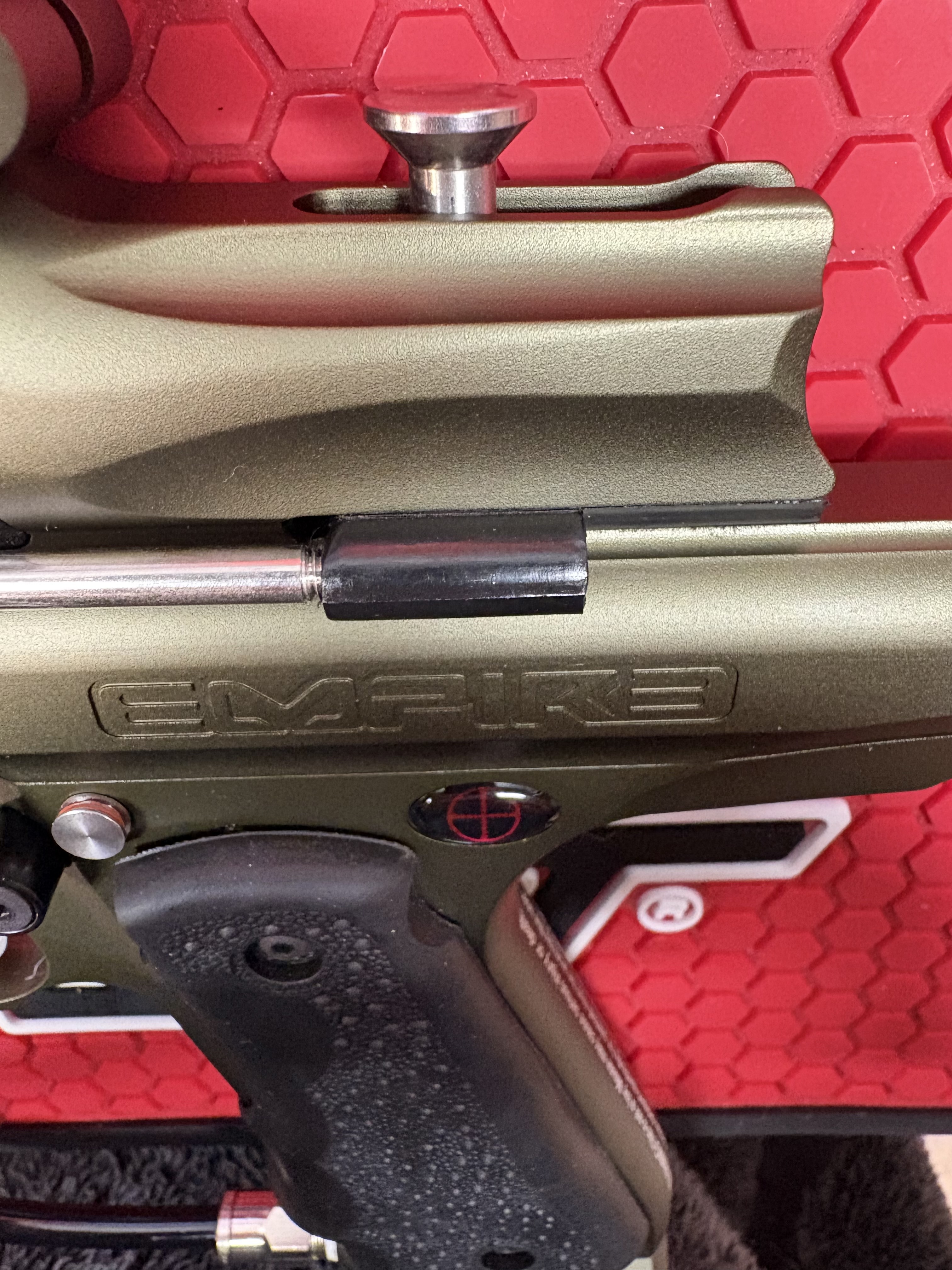

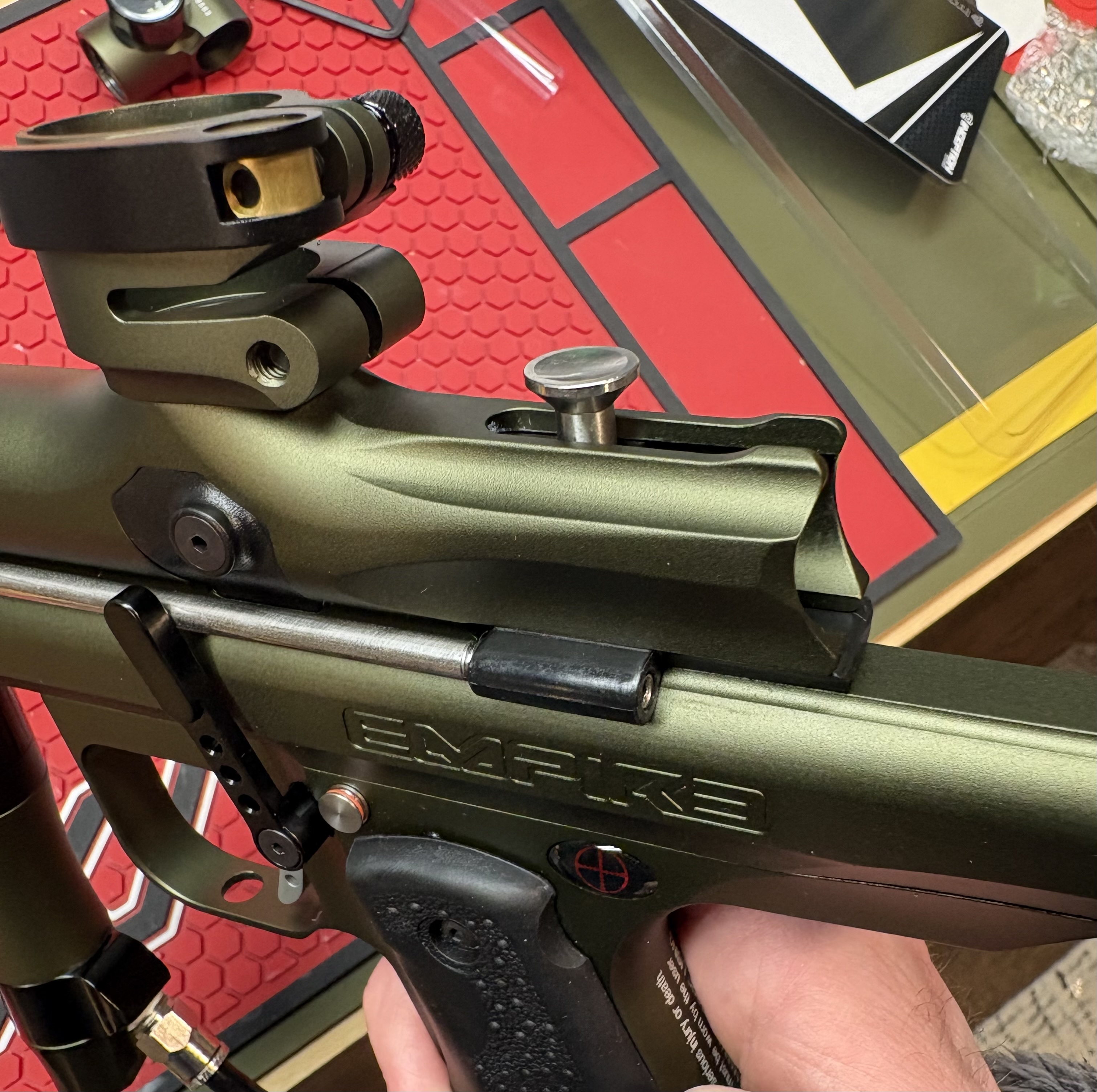

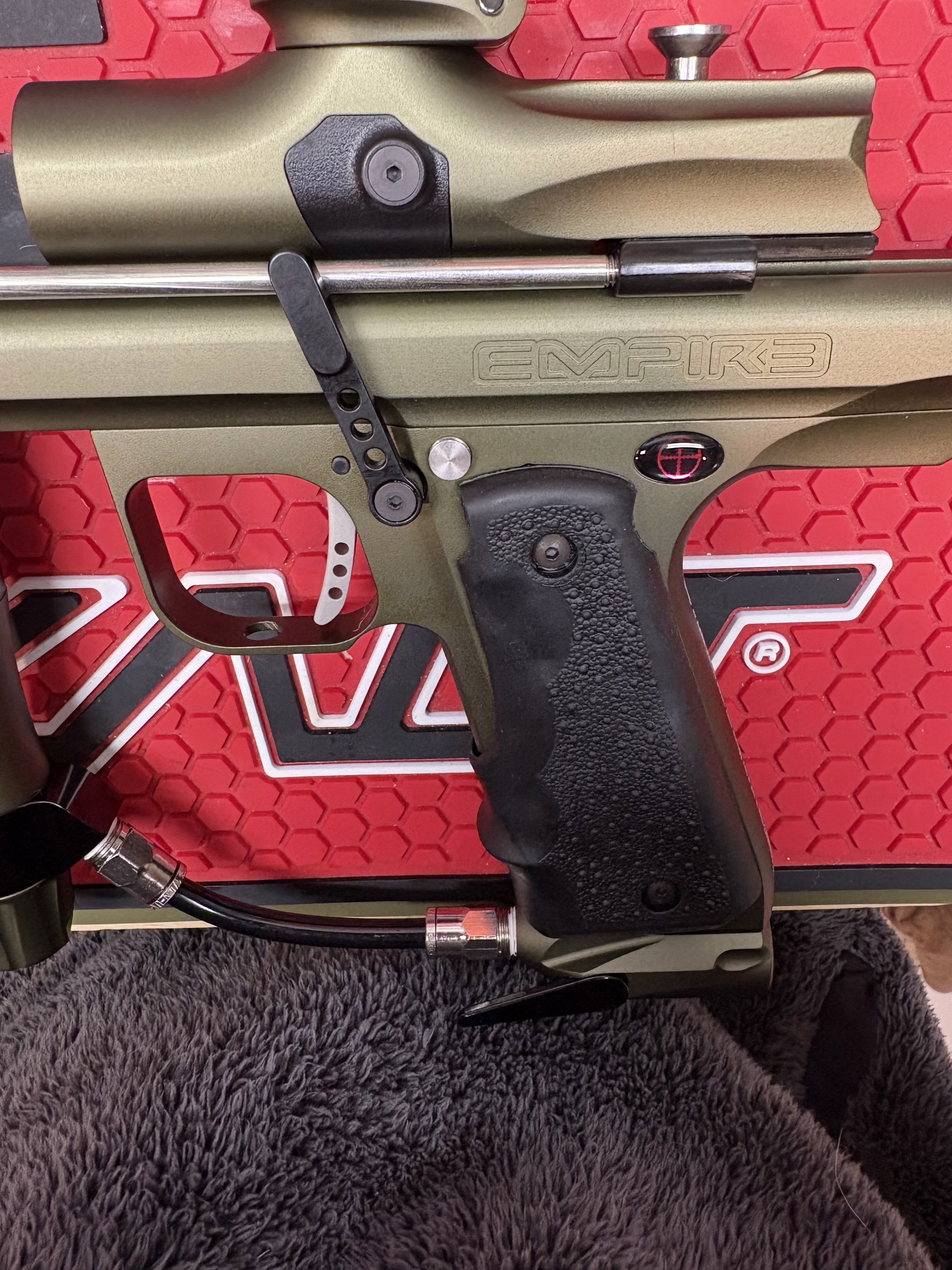

    Now onto the ID drift kit - I installed the kit and it is quite the upgrade from the stock pump kit. I noticed that the sled is rubbing near where the pump arm attaches. I reached out to ID on facebook and they said that rubbing is normal. Anyone else seen this before? Is this an issue with the sniper? It was pretty much brand new so no damage to the frame or body.

    1) I had the ID Drift kit on a Ressy and it rubbed a little in that same spot. I could reduce the rubbing a little bit by clocking the sled slightly (relative to the pump arm) but I wouldn't worry about it.

      I have the drift kit sled on my Sniper and my Resurrection; the rubbing is normal and nothing to worry about. The downside of having the ano rubbed slightly by the sled is offset by the perk of having the drift kit in my opinion.

        I had an issue when I installed the drift kit at first where the auto trigger connection peg was too large on the drift kit and was causing binding. I was able to switch out to the stock rod peg and it now works great. Wonder if something like that is contributing to the sled wear.
