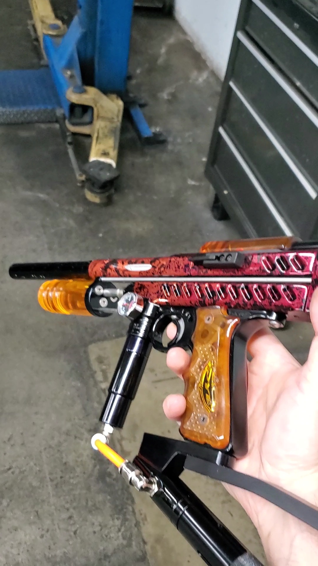

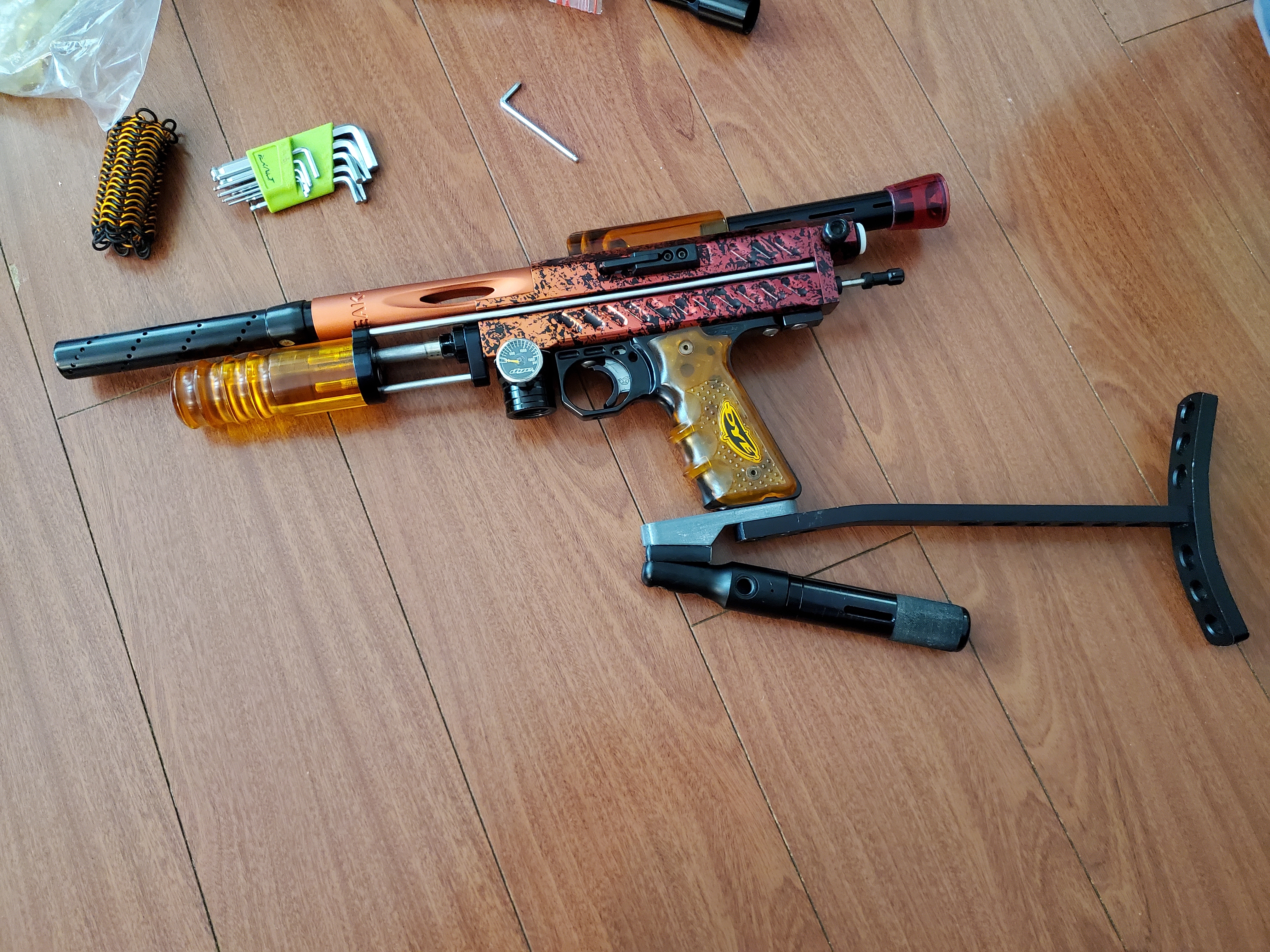

    Help me set this thing up.
    99 body
    I've got a cp reg, and a stock wgp reg if i need.
    New ACP gold valve, and what looks to be a palmers valve. New from ACP stock springs.
    unopened madman spring kit if i need.
    what combo should I use and about how much pressure on the reg? I've got a gauge on the vasa.
    Any input is appreciated

                          Ok update today:
                          wgp hpr 325 psi, madman blue hammer spring, still acp gold valve spring, ivg about a half turn in, 35 consistent shots at 275 no farting. I just could not stay consistently under field speed with the acp gold hammer spring. I could try again and turn the hpr down even more.

                            Some screen caps when I tried to take video I guess there is a file size limit
