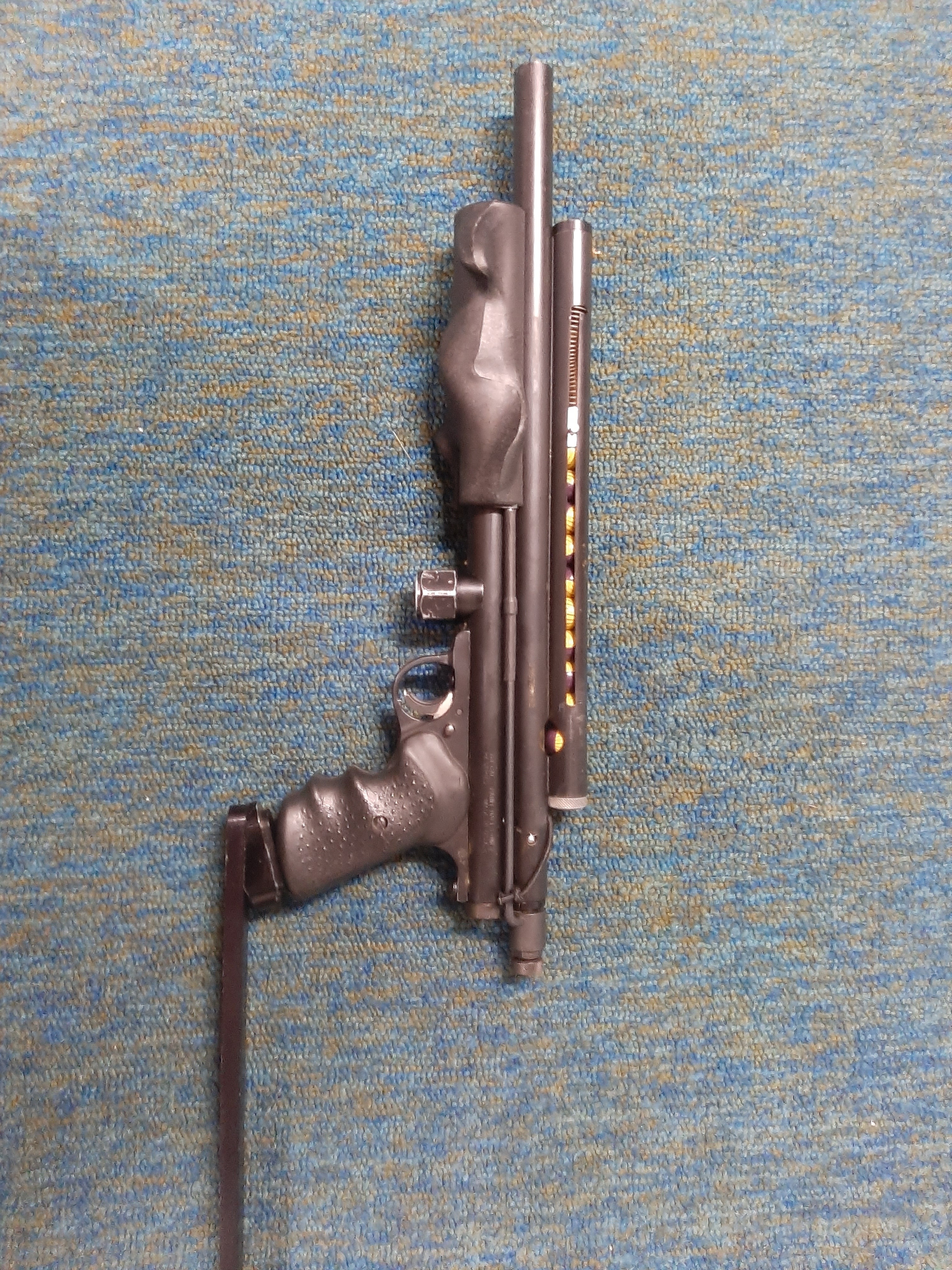

    Does anyone have any pictures or advice about springfeed modifications?
    I'm thinking about doing a springfeed modification to my KP2. Does anyone have any advice or pictures they can share of the components, especially the follower? I'm leaning towards going with a string-based retraction system, at least for now.

      Have you used a spring feed before on a KP?
      Also you may need a new feed plug that acts more as a ramp instead of the standard sheridan plug.

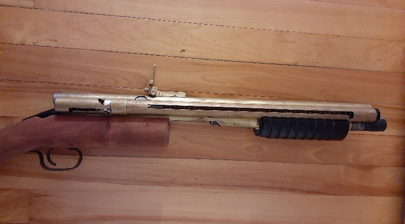

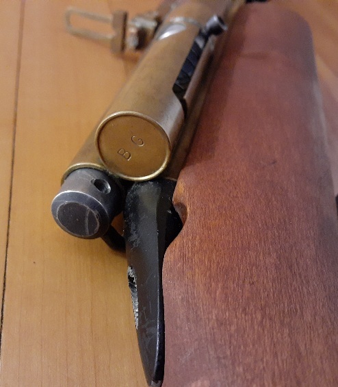

          This one was done by BretG, i would guess the follower and feed was custom piece. Not detailed puctures but could help
          The speed feed is nice
            BrickHaus commented
            This is cool with the dual springs. I woulda never thoughtto do it that way.
          I haven't, but I had the springfeed on my Empire Trracer for a while and adapted a RAP4 Firestorm to fit an Ion and MG100.
          I figured as much.
          What are people making those from? I was planning on using a 3/4 dowel and turning it down a bit to make the plug and follower from wood.

            Wood works, I personally 3D print mine.
            Make sure you have kick ass detent ... otherwise the spring will push the entire stack into the barrel the instant you pull the pump ...

              I have a spring feed on my Squallicane, 2x KP2, and KL and have removed it from the KPs and KL. For semi auto it is necessary but with smaller paint, I really don't like the spring feeds anymore. On one of my KPs, I used the string method but didn't like the spring hanging off the gun all the time. Its very simple to make and you don't need to do any modification to the brass.
              For angled, feed plugs, you could make your own or buy a palmers: https://palmerspursuit.com/products/...270e8cdd&_ss=r
