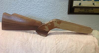

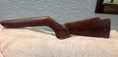

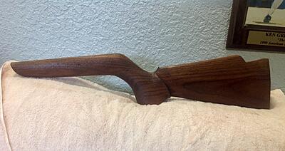

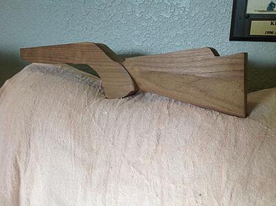

    i have been on kinda wood binge lately and wanted to show everyone how I do it..
    i had four stocks that I had rough cut a few months ago and three of them are mostly completed.
    First picture below shows you the shaping of the hind quarter so to say..
    Second is the rough out of the rear end
    Third picture is of rough filling completed for the most part..
    I used a hand rasp and a bastard file on her so far.
    thanks for checking it out....
    Pictures are mixed up and that's that I guess.

    Thanks for showing the stages, it's the inspiring.
    After roughing on the band saw is it all done by hand?
    • WALZ
      WALZ commented
      I actually used a jig saw for this and yes just a rough rasp and a basted file and a lil time..
      I stayed with this one and it took between two and three hours to get to this stage..
      . ( I did take a break or two)

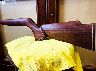

          Sanded this down to 220 grit and then added some brass inlay around the grip frame and ran out of brass wire to wrap the butt end.
          (Ill order some more and complete later...).
          Sanded it down again to 400 and stained it with red oak...
          i like the reddish tone it has...
          all I need to do now is give her a couple more coats of stain and seal her up.... after I finish the inlay....

              Finished stock.....had to complete a lil brass inlay at the butt section...
              Straight to uplifting grain, the best way to make a stock..
