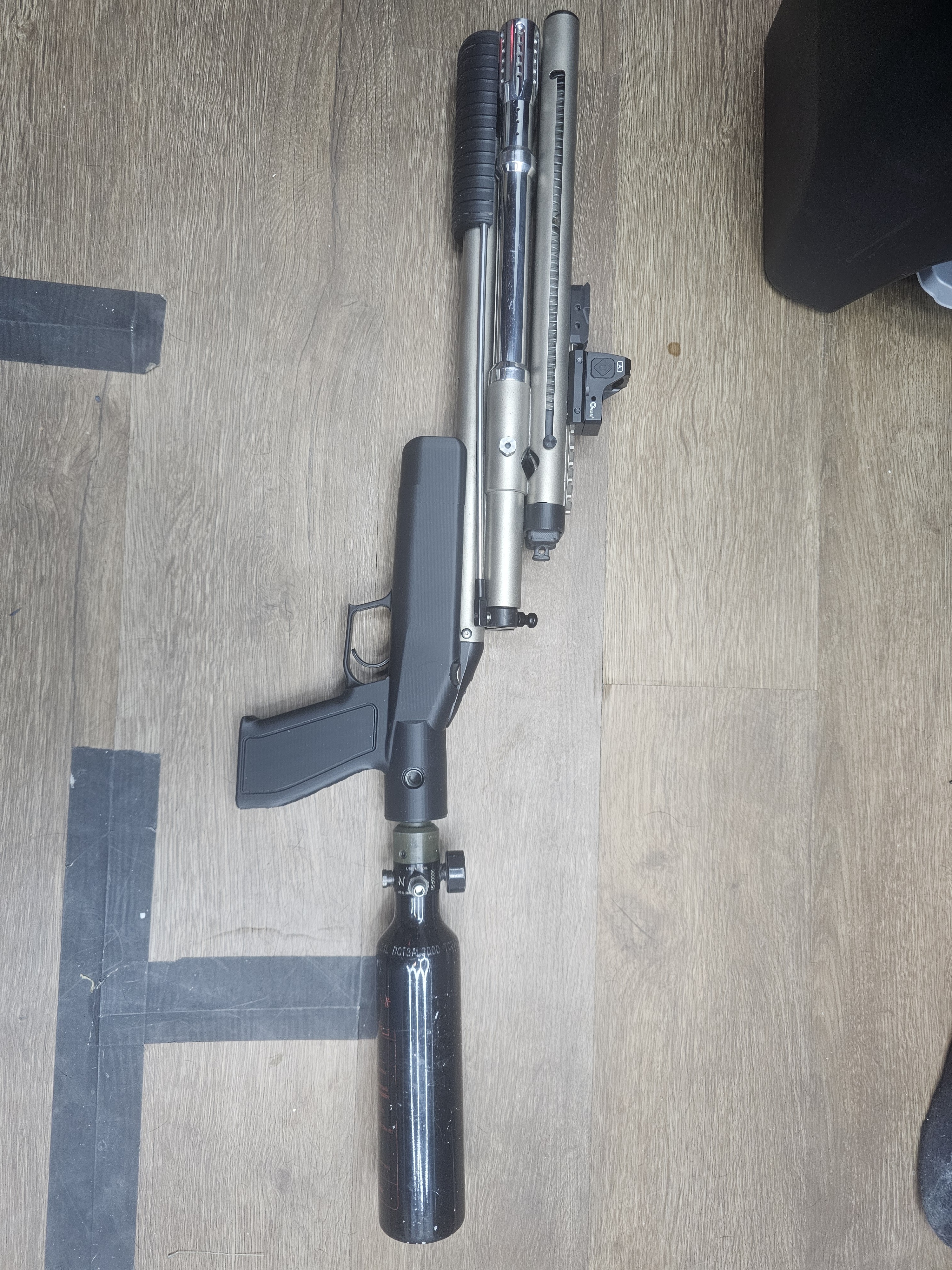

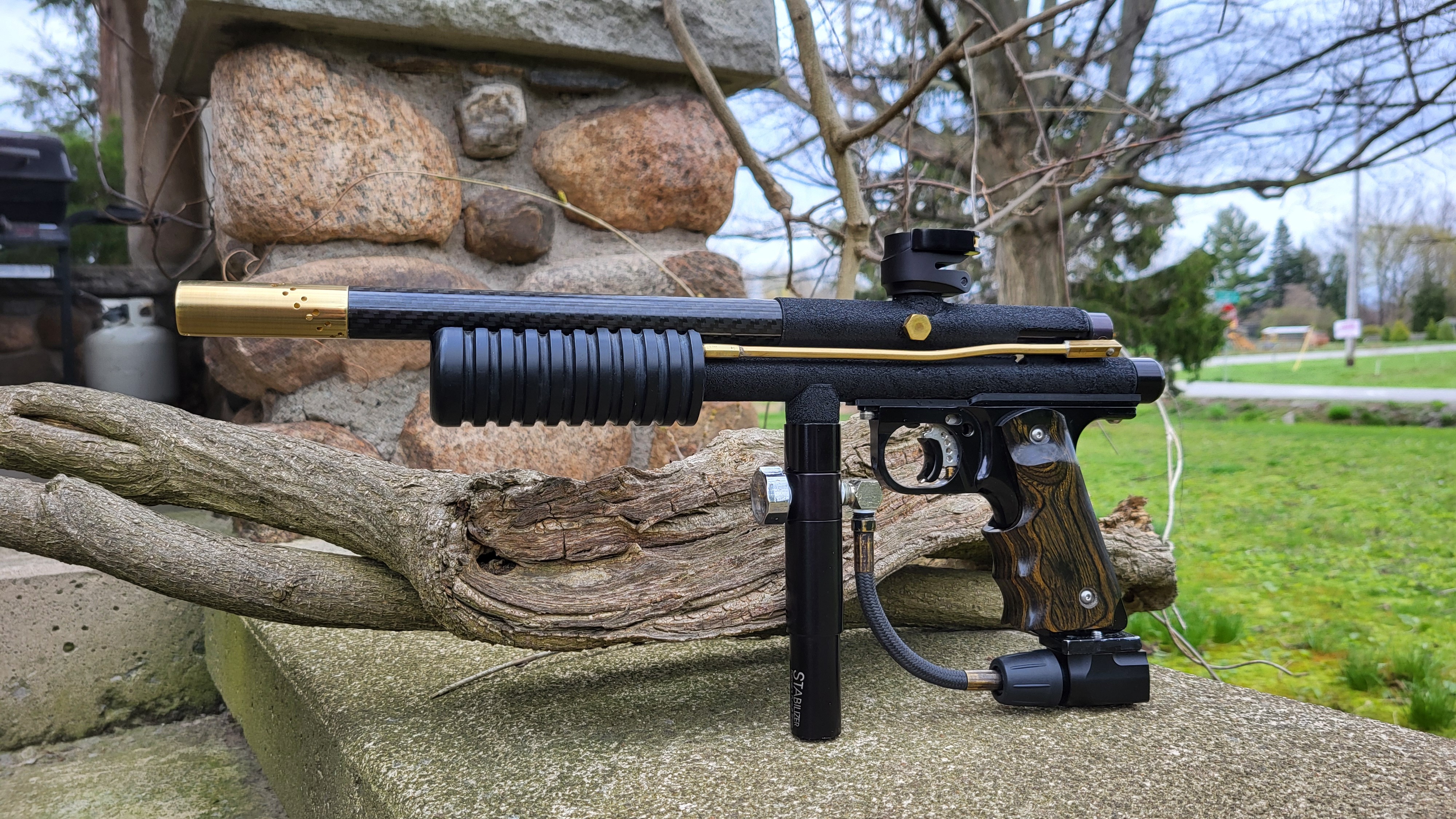

    Updated PMI Pursuit-based build... now with CF and CF!

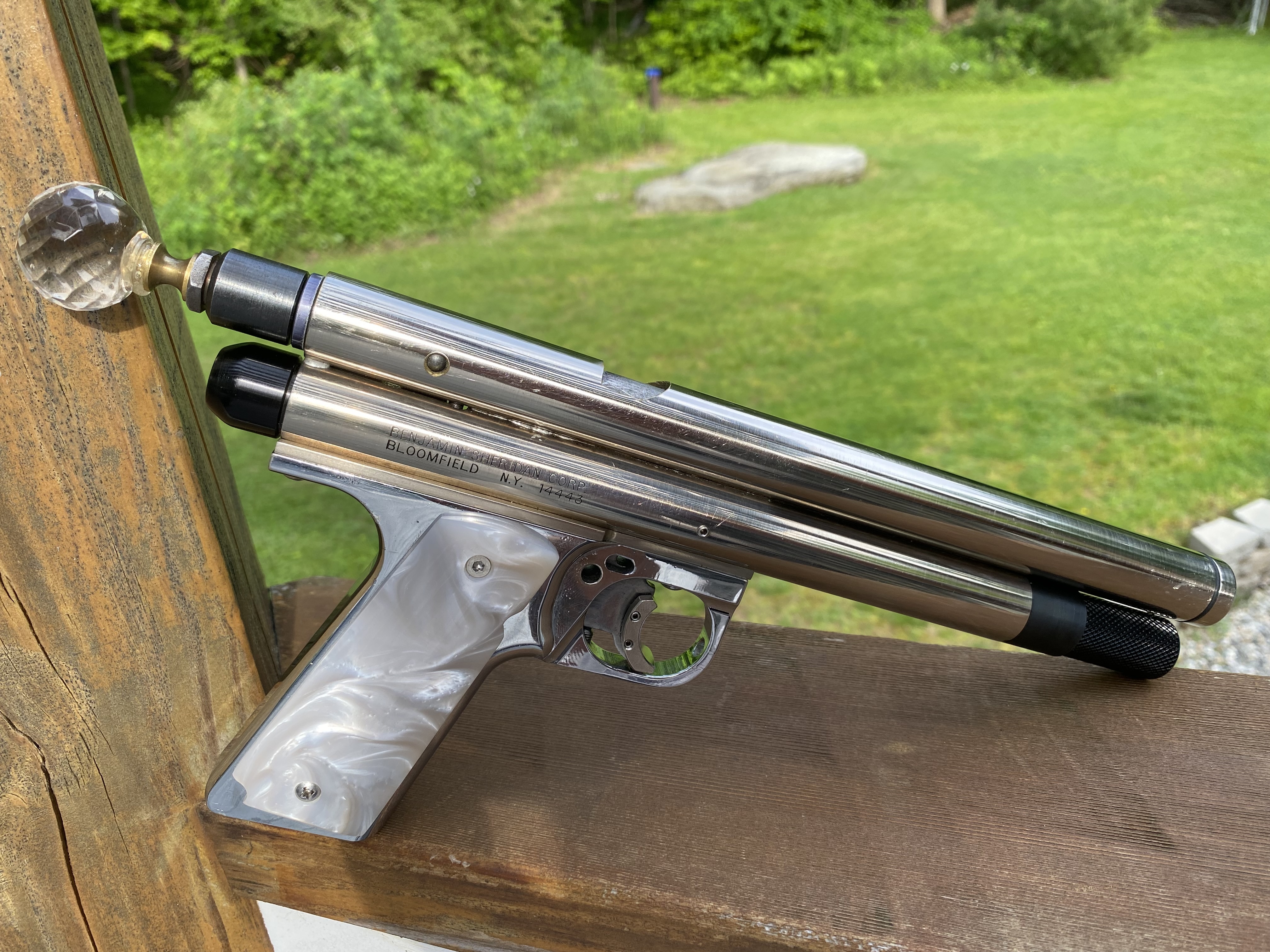

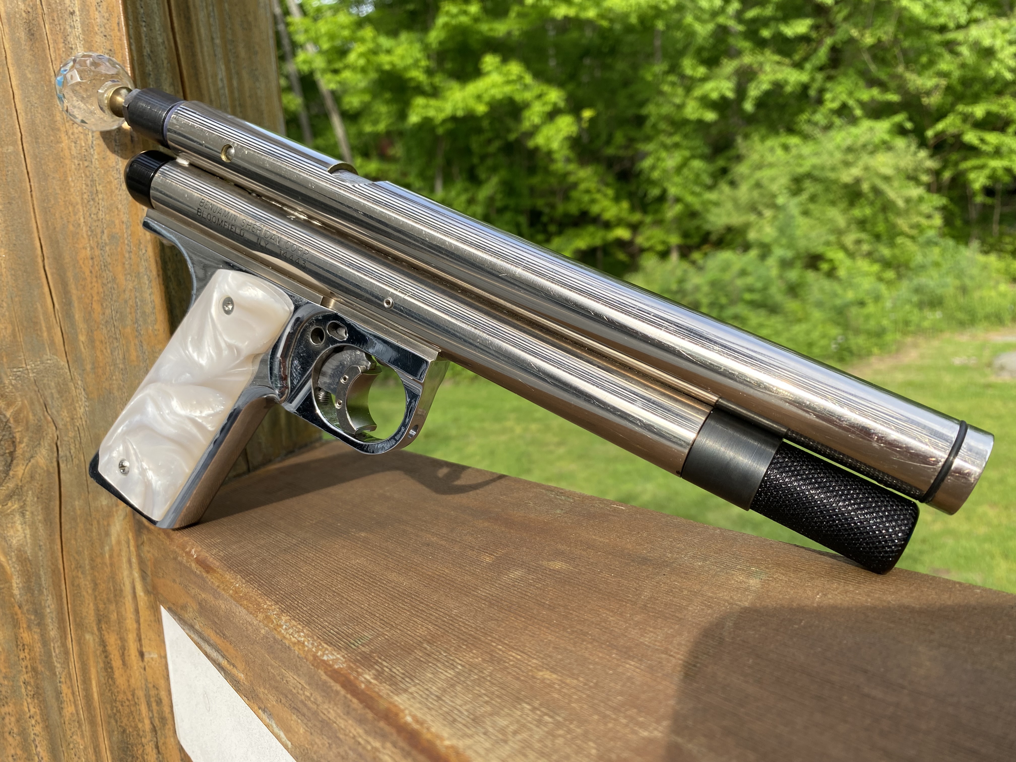

      Couple changes with Pearl grips ,brass nickel plated frame adapter and Docs quick changer. Thanks JeeperCreeper for the work again.

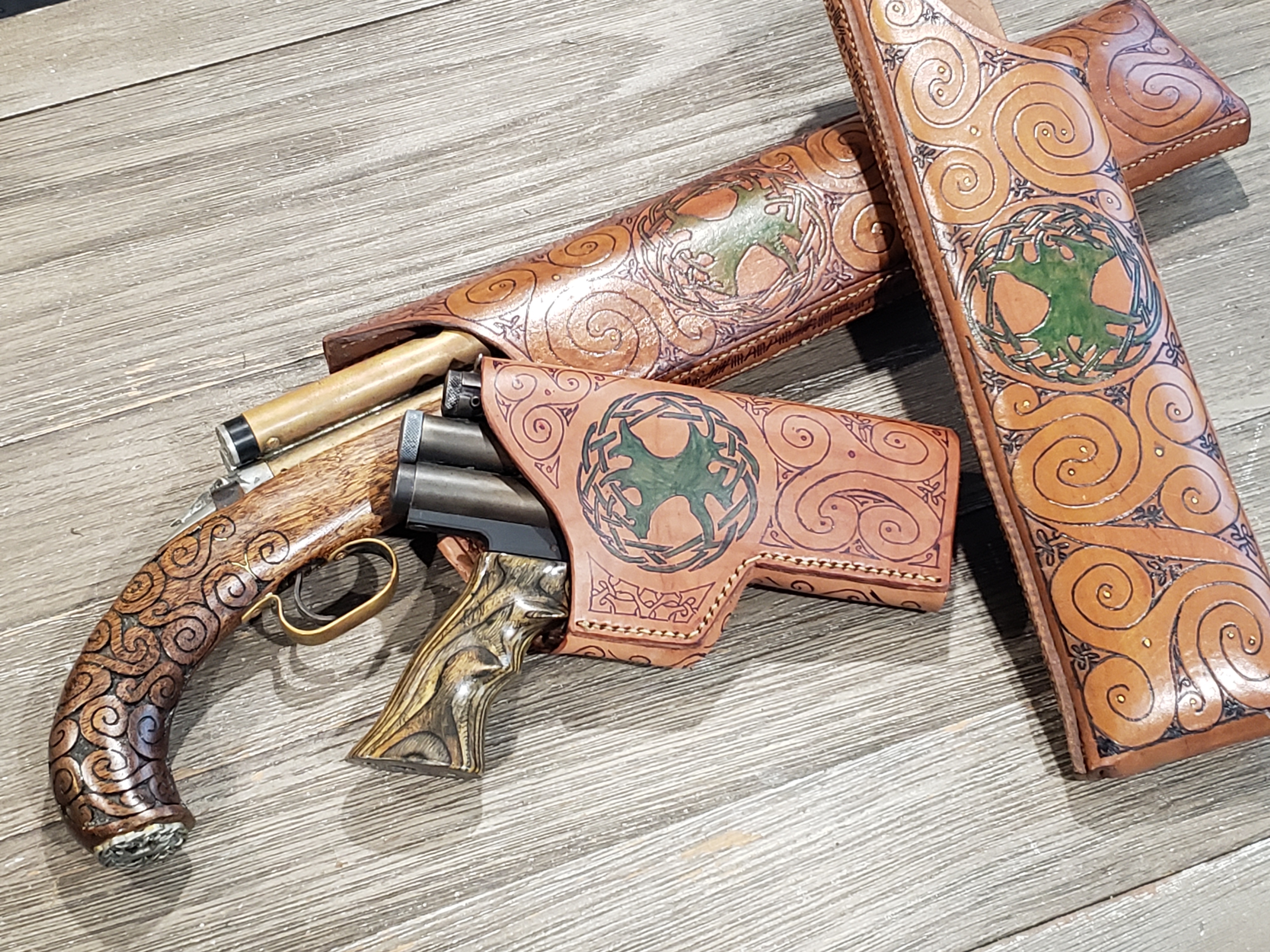

        finally finished sewing up a stubby holster for my pg in the same style as previous long holsters (though without the light tooling. here with my flat topped & pumped k2

          Those look great, what's the trigger frame sneaking out on the pg,if you don't mind me asking?

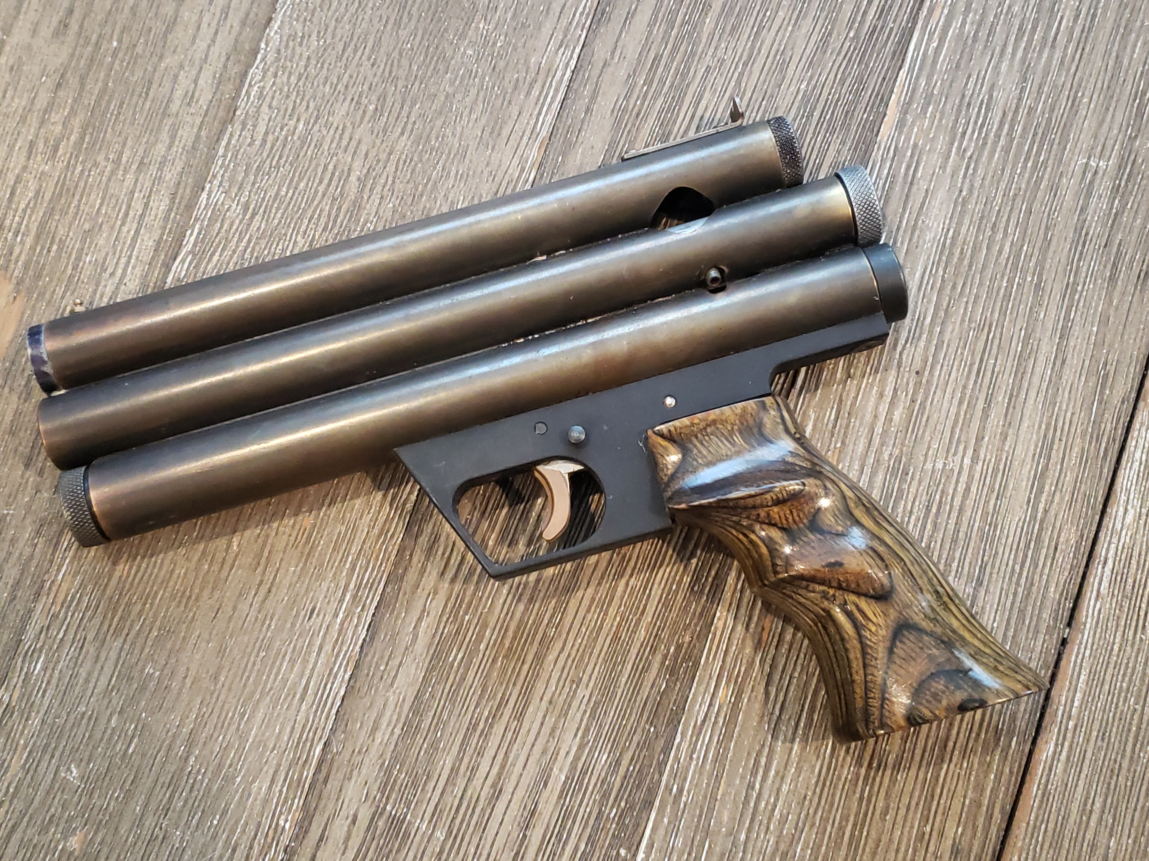

        it's an aftermarket frame similar to bluefork designs (not sure who made this one)
        • chplnstone
          chplnstone commented
          highly recommend. it's surprised me with keeping usable velocity despite shrinking paint, even better than my efficiency modded k2 & p68sc's. comfy, pointable, & super compact

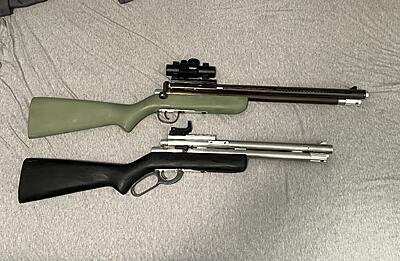

        Just got these made from G&H customs…sorta “old meets new” I guess…havnt gotten to play with them yet but just shooting them in the backyard is a ton of fun already, excellent build quality and they feel VERY nice so far 🤘

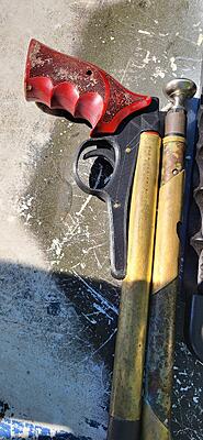

          Sun annealed my krain frame today
            Carp commented
            Ooof...😖

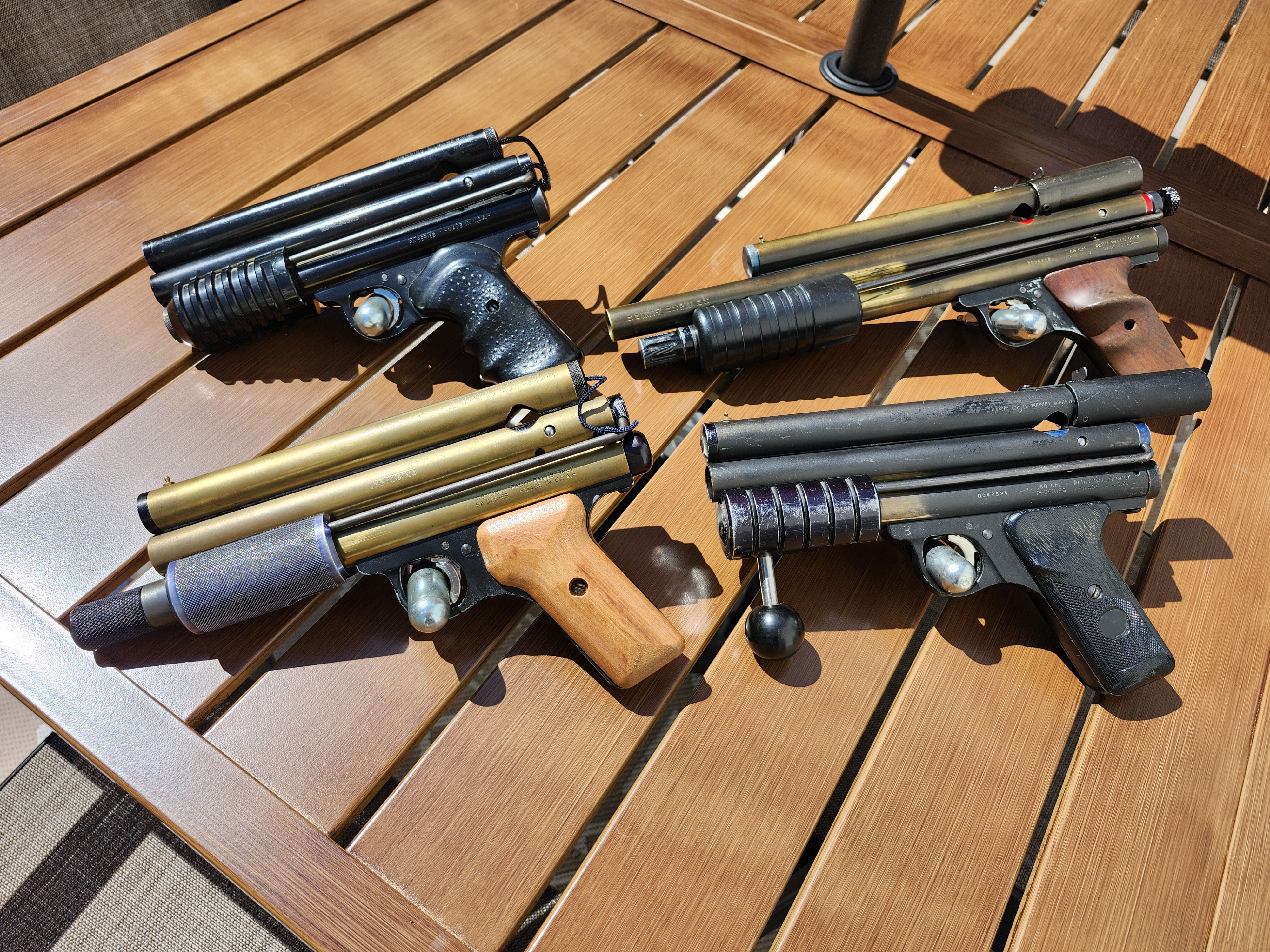

          Nothing too crazy but they all have something special about them. I finally got them all rebuilt today after years of them sitting in a box in the closet because I didn't have a valve tool or face seals.
          It was fun disassembling them and discovering all the old school mods their previous owners had done. Somebody loved each of these guns.
          The PMI-1 in particular has a delrin pump, Cooper-T bolt, speed feed, trigger shoe, fast changer, and a velocity adjustment mod on the hammer that I thought was ingenious. The hammer is tapped for a grub screw that's accessible through the bolt-lug hole when the gun is assembled. There is a ball bearing inside the hammer that the main spring rests against. When you turn in the grub screw it puts pressure on the ball bearing which compresses the main spring. It's like an RVA but in reverse! An FVA!
          I don't have a detent solution yet, I'm hesitant to attempt home-brew wedgits. Maybe I can find some giant paint but until then it's rollout city.

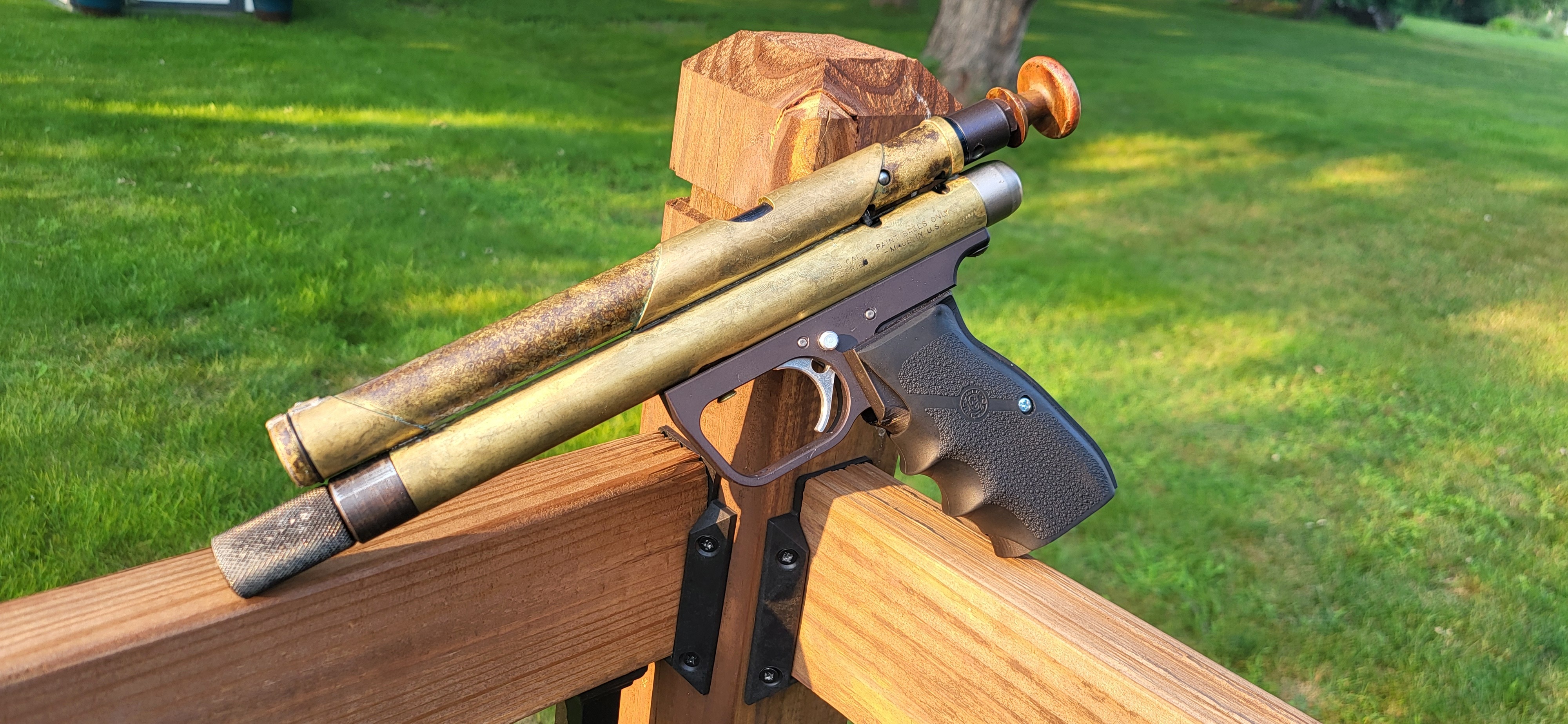

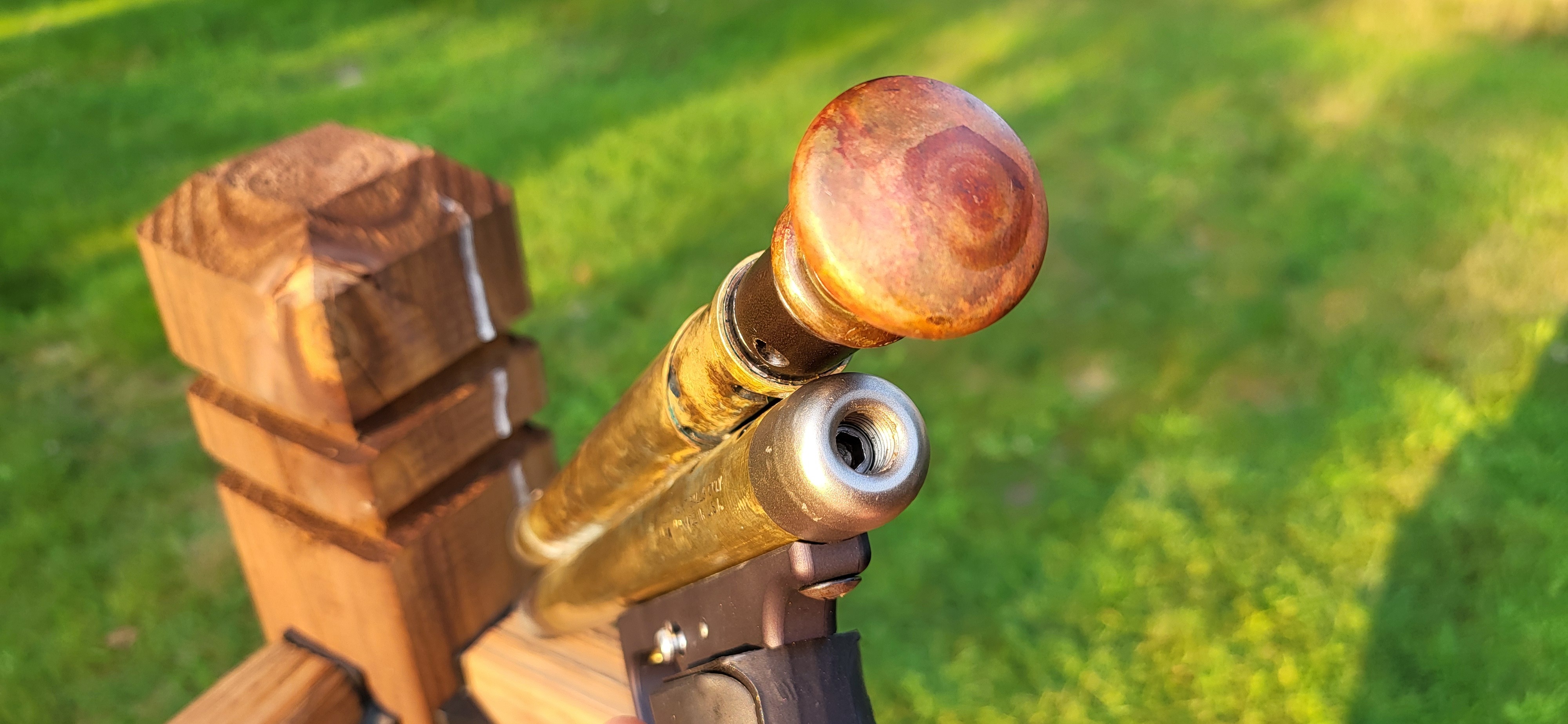

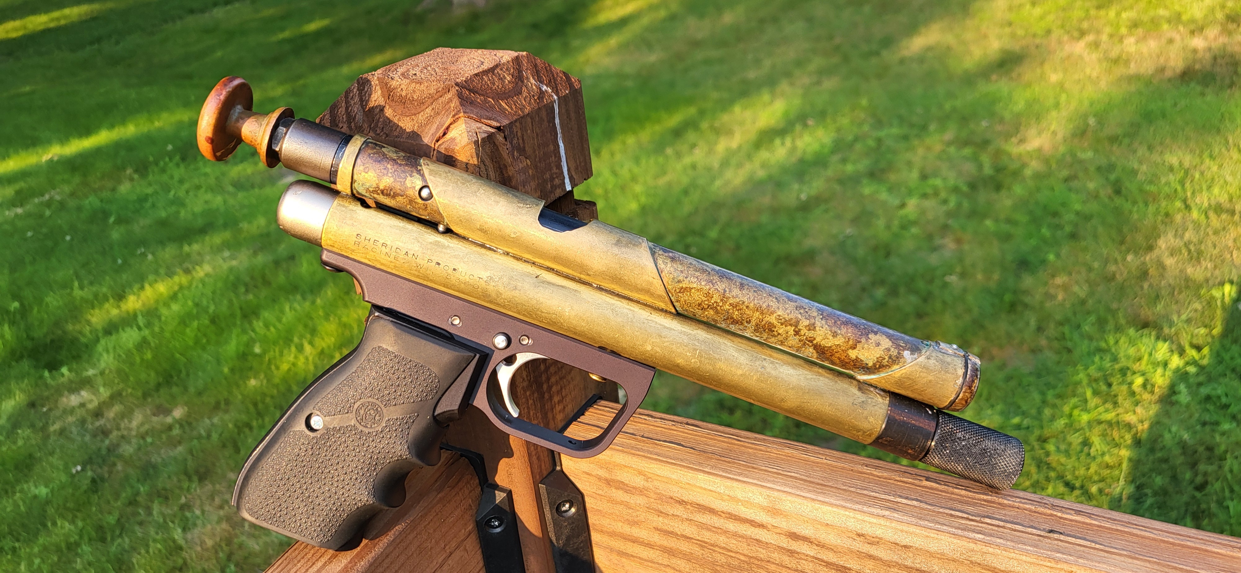

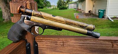

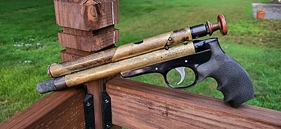

          JeepDVLZ45 made Walzmas pistol, with my flea market knob bolt added on a bluefork frame. Just swapping bits around. Figured I'd share.
            JeepDVLZ45 commented
            That knob really fits the patina well! Especially for only $1!
            BrickHaus commented
            Yeah that knob is way cooler than I initially figured. I managed to wash it with soap and water to get the rust and haze off while leaving this beautiful deep patina. I also like the fact that that blem on the back is from this knob being in a bucket with a 3/8" bolt for who know how long.

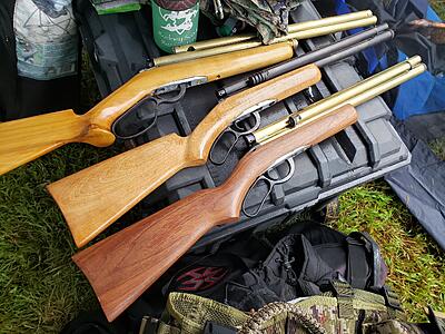

            trio at supergame east
            • Cal440
              Cal440 commented
              Nice trio, is the lower tube on the top rifle pmi length or p68 length?
          • chplnstone
            anachronistic fabrication
            • 307
            #88
            pmi/p68 length valve tube with 25 rd. ammo tube & barrel length to match (per client's request).
            • Cal440
              Cal440 commented
              Thanks

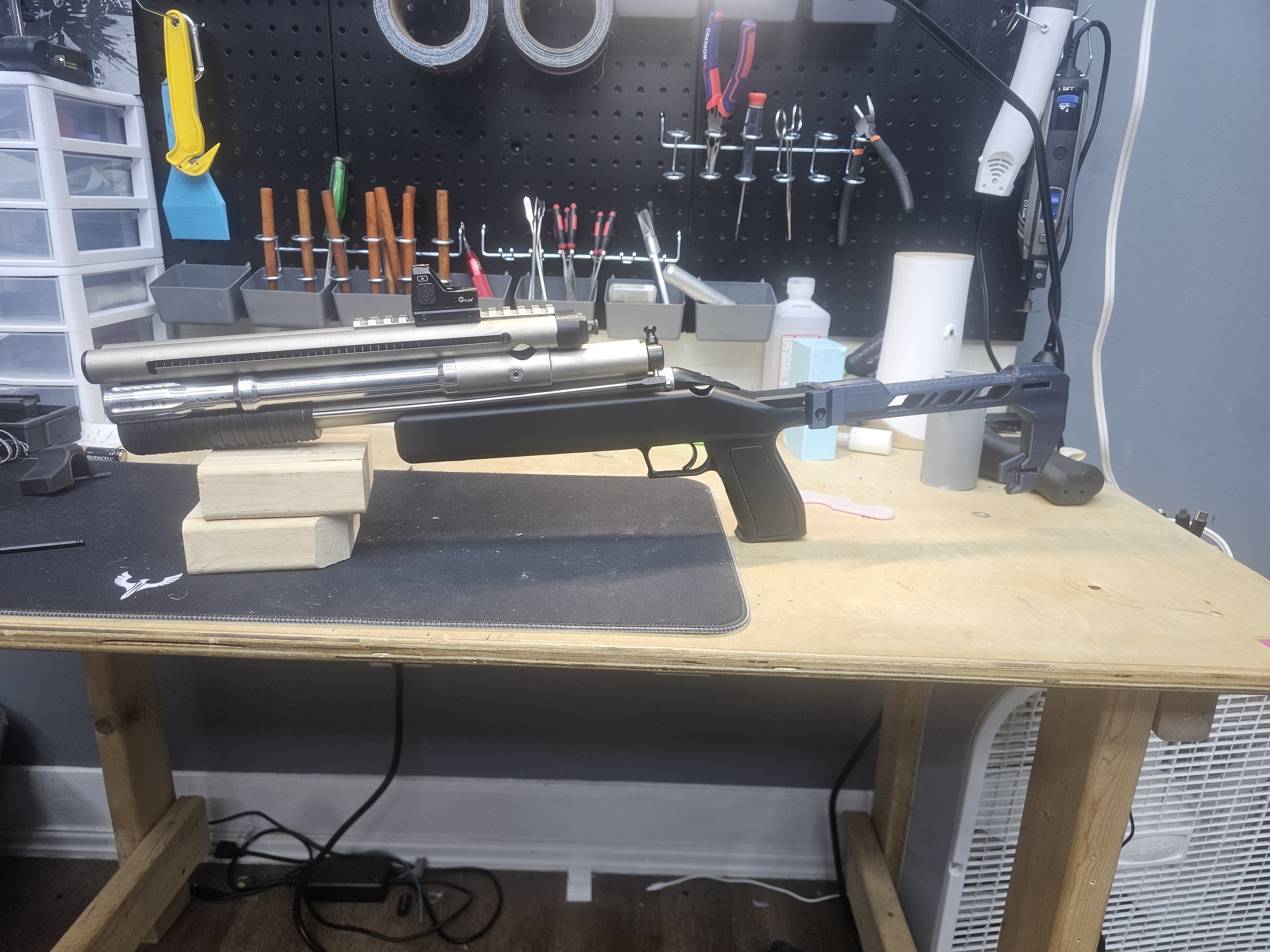

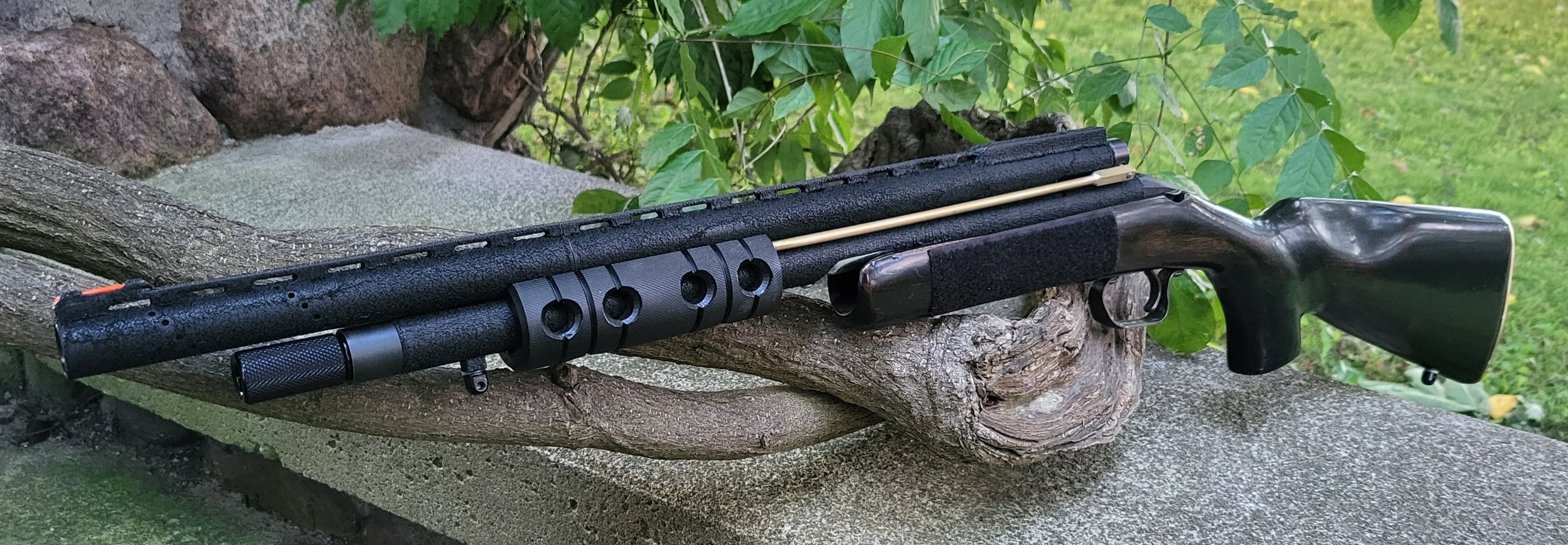

            I need to refine the stock angle a little and some minor refinement.
            • JeeperCreeper
              JeeperCreeper commented
              Interesting. I almost wonder if you should make a new pump handle that matches the style. I think it would finish this nicely.

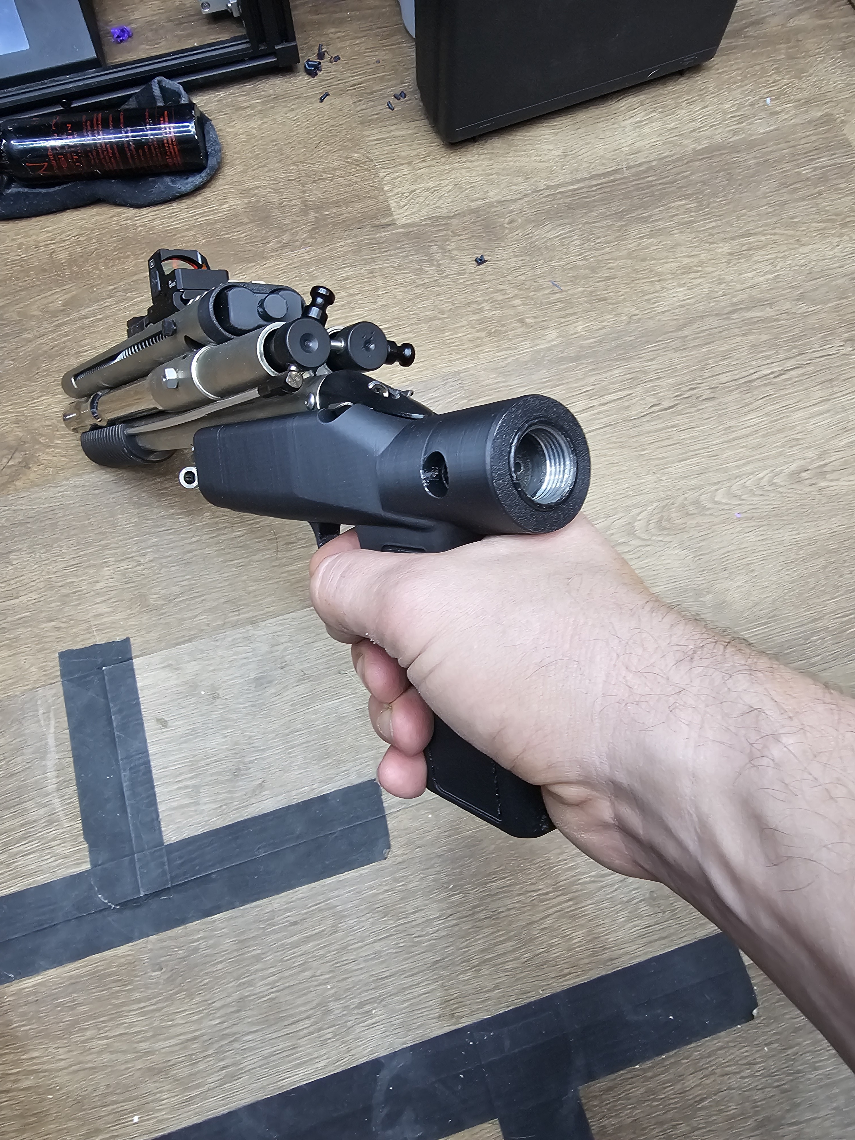

            Getting closer, extended the grip, played with a pic mount.
