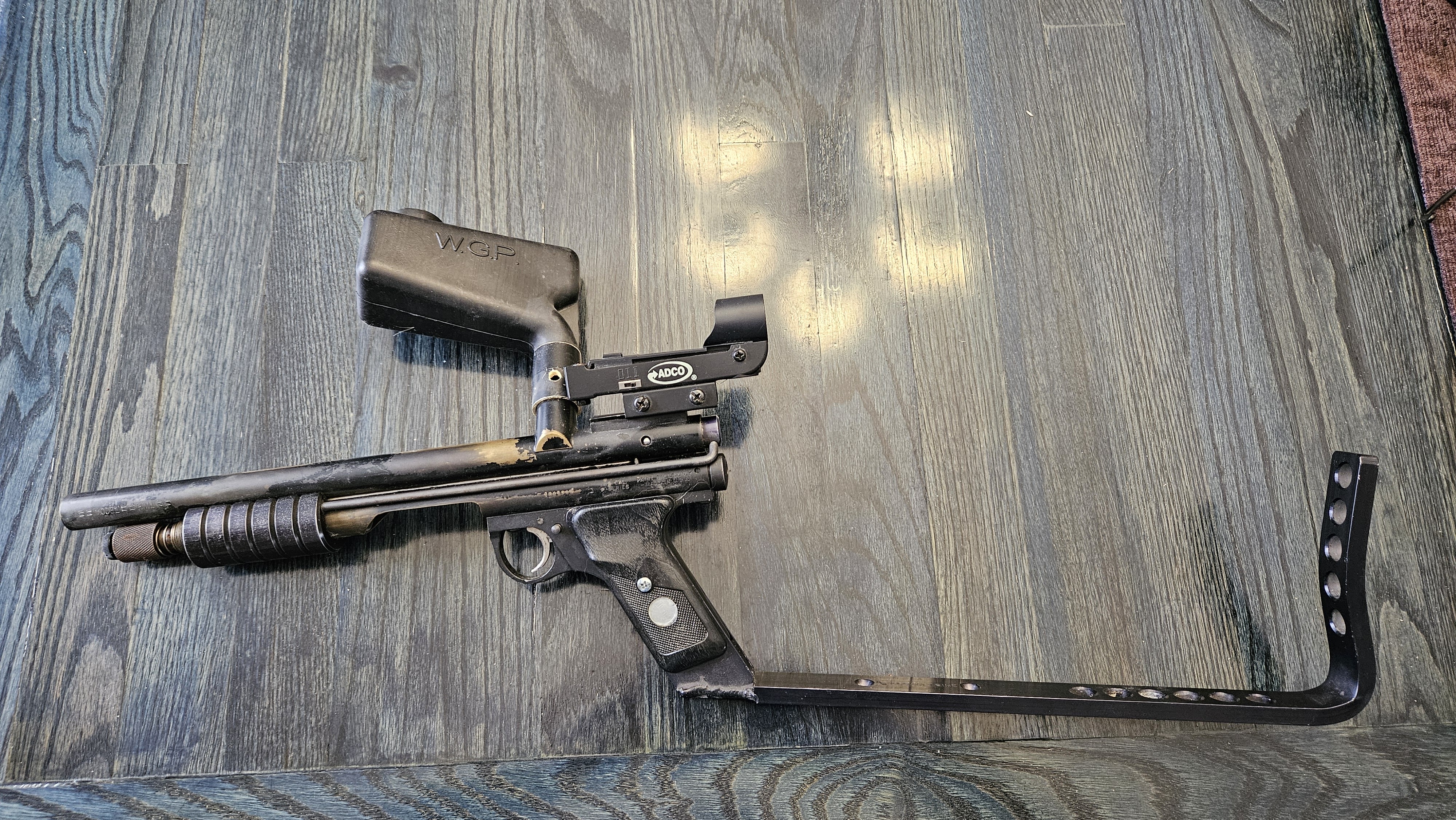

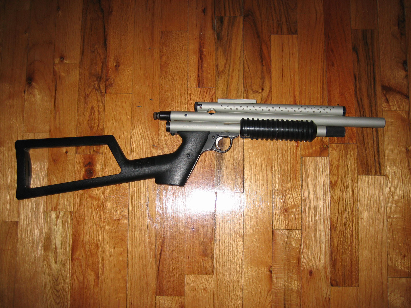

    My P68, modded to my specifications by Sam Tussing and included his barrel hone, valve tune, and silver finish. PPS fast changer, Crosman stock, and fishline feed tube lanyard by me (other side). This picture is from 2005, so it has more scuffs and wear now, but I just rebuilt it last month and it's shooting great!
    Slinging paint since 1992
    • GattoDiavolo
      GattoDiavolo commented
      Drunkscriblerian - The Sheridan grip needed modification to accept the Crosman stock, since the screw holes don't line up. IIRC, the lower part of the frame is filled with epoxy which was then drilled out for the stock's grip screw. Since the epoxy doesn't have anything for the Sheridan screw to bite into, I used sex bolts instead of screws. (https://www.mcmaster.com/products/sex-bolts/)
    • Drunkscriblerian
      Drunkscriblerian commented
      I figured it would be something like that. Good to know, will probably buy a Crosman stock anyway (they're only around $30 with shipping) and figure something out. Thanks for the info!
    • GattoDiavolo
      Drunkscriblerian - If I can get my act together, I can take some pictures of the mod to the grip frame and inside the stock.

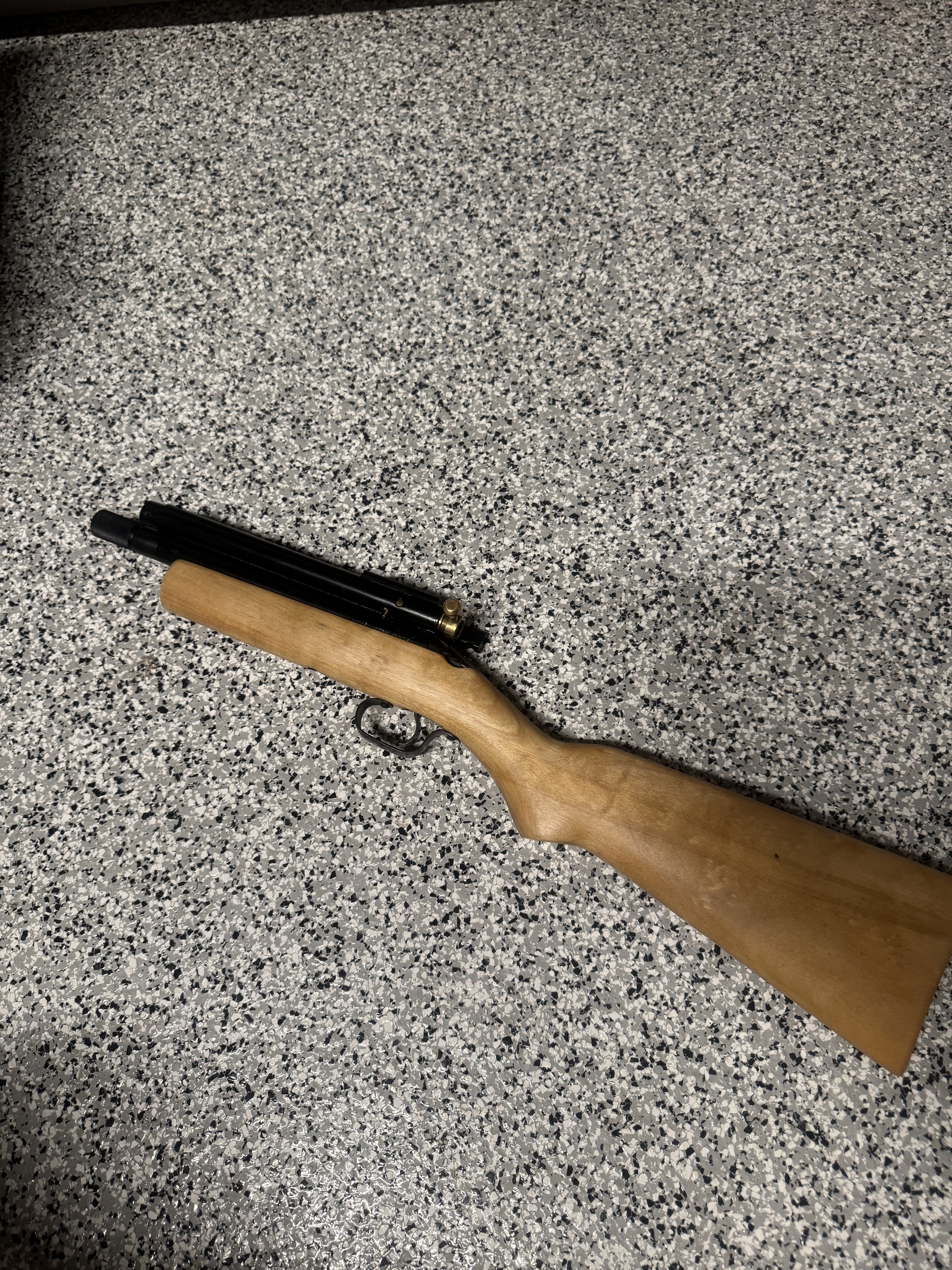

    Was just cleaning the closet out and can't bring myself to toss this one. Going to be donating it to your museum if they want it
    • Cal440
      Cal440 commented
      If you're just tossing you can toss it my way!
    • chplnstone
      chplnstone commented
      I believe I see a mac-quick...

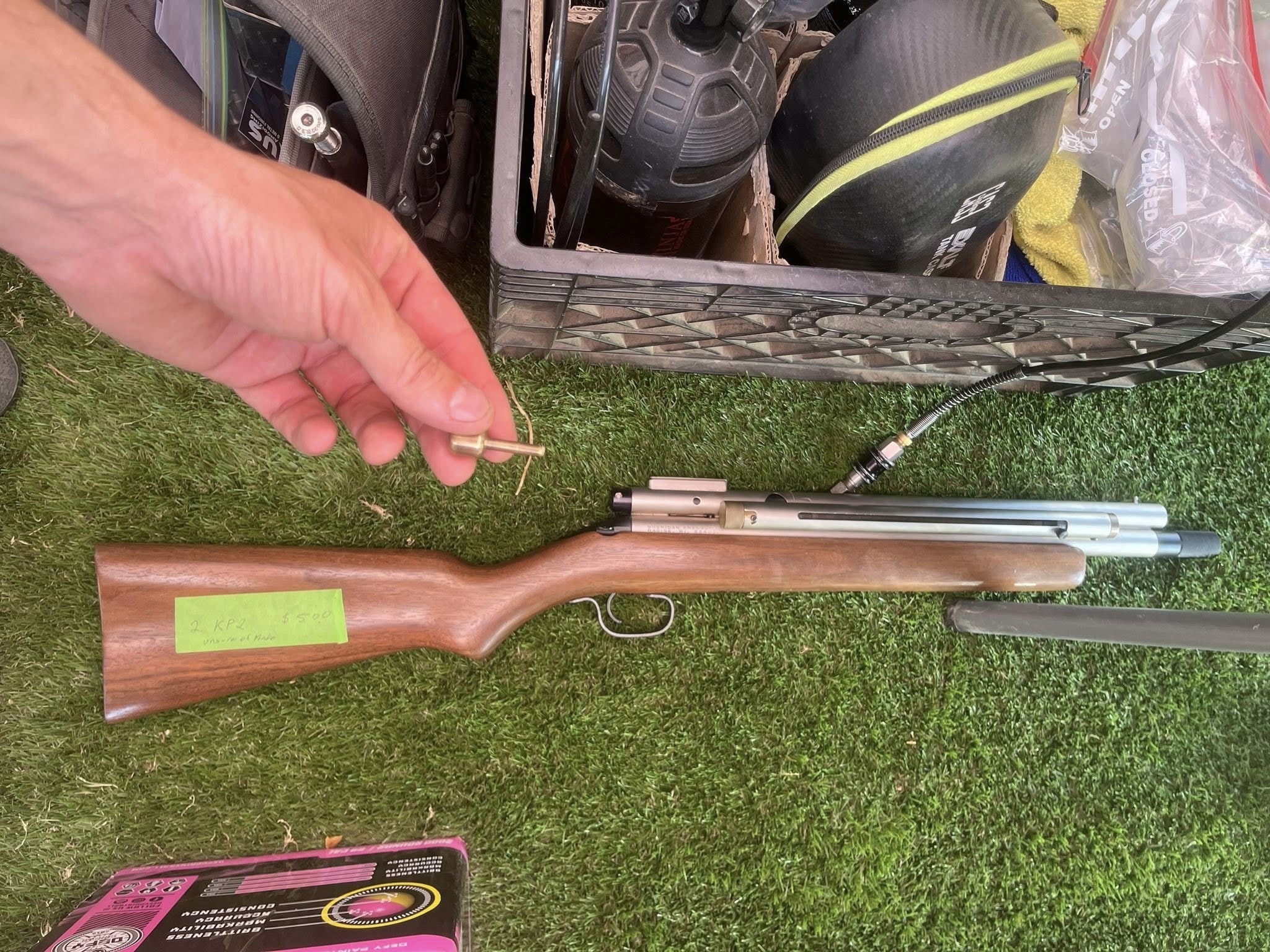

      Two Palmer builds me and a buddy picked up. We picked 3 of them up from a pile of insane estate sold at SPEW. Unfortunately they sat out in over 90* weather and every rubber seal was melted. My bolt actions bolt broke as soon as I charged it. Terrible design for it was made if brass and very thin. I have it with Estilo Paintball to be extracted and have the bolt sleeved for a stronger handle.

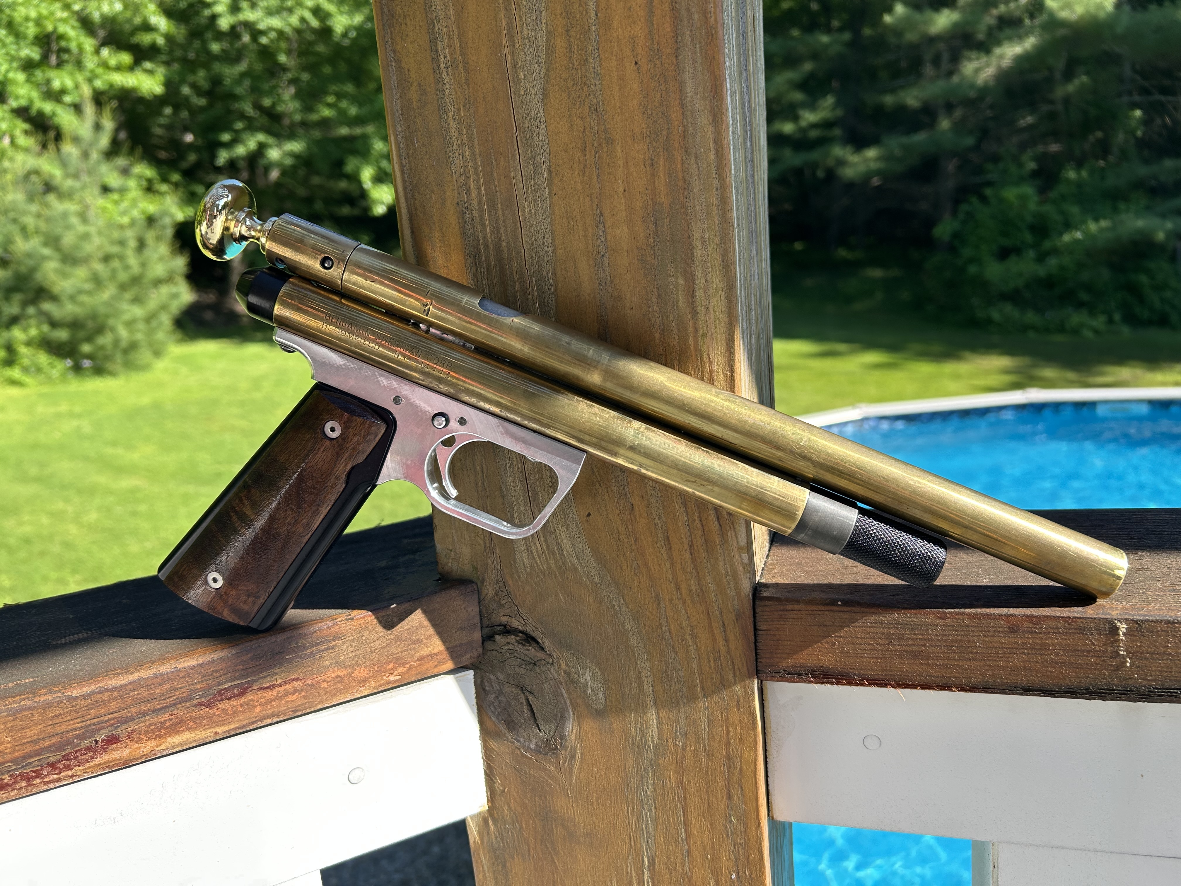

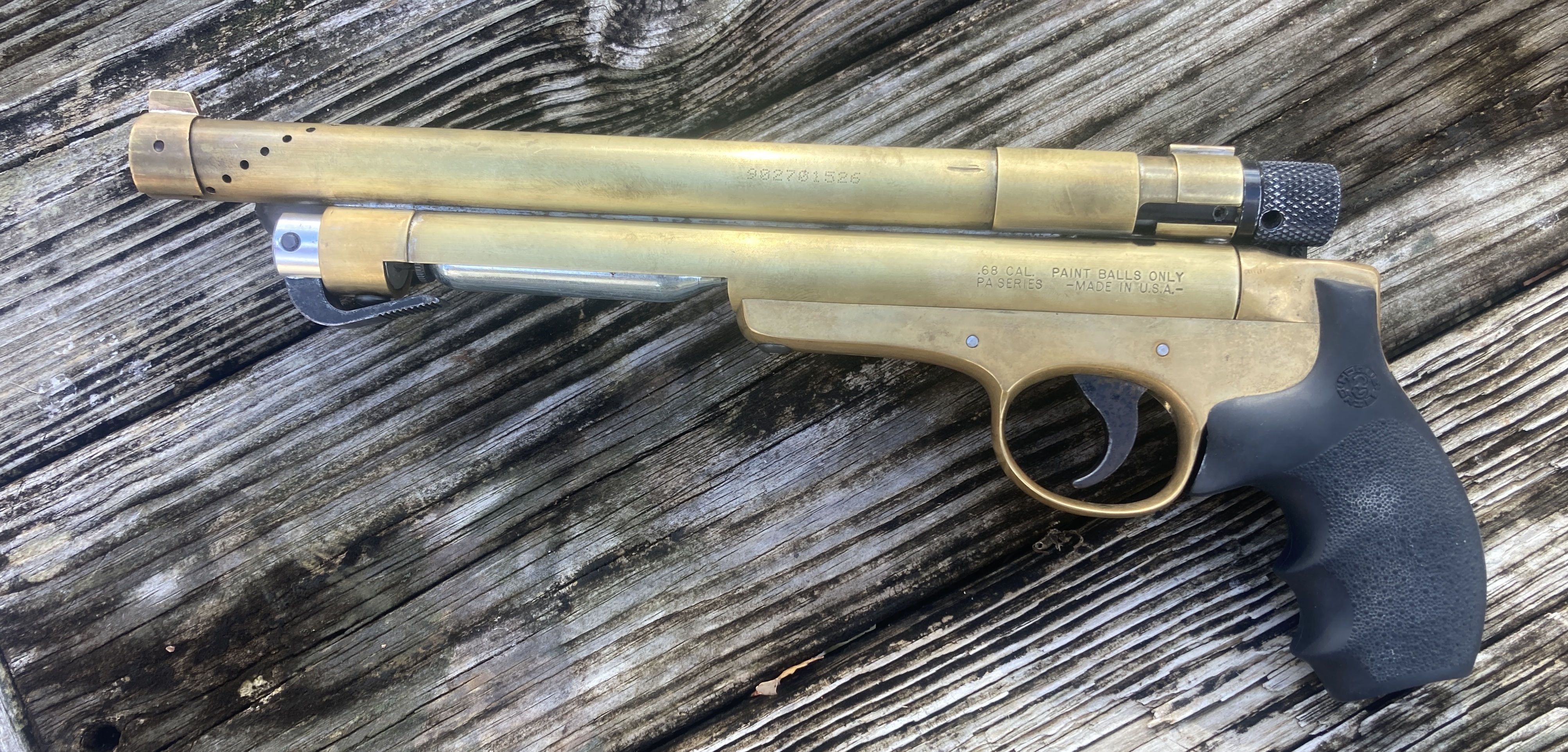

        Many hands involved in this one
        Started out as a Side feed cram n jam i got from AnarchicArctic a few years ago. Had BretG take it in for some G&H treatment!
        Spiral porting, valve work, front sight blade, and drop out came out great! chplnstone provided the lever parts and i recently nabbed another kframe so no more swapping this one when i take my singleshot out.
        Can not recommend G&H enough! She's a totally different beast, better in every way.
        Such an amazing shooter. Nice, flat shots and amazing effeciency.
        I recently added a slot and tapped the top tube for a ccm detent and cut down the feedplug for better grip on the cocking knob

          Looking good baby
        • $L!mBo
          $L!mBo commented
          AnarchicArctic i gotta get you to put your hands on it for a tube or two! one of the best brass pistols ive ever shot
        • Impactfour
          Impactfour commented
          Chiming in to say not only is that purty as hell, I also would echo recommending sending a pgp to G&H. I sent mine in for some valve work and it's really hard to overstate the difference.;

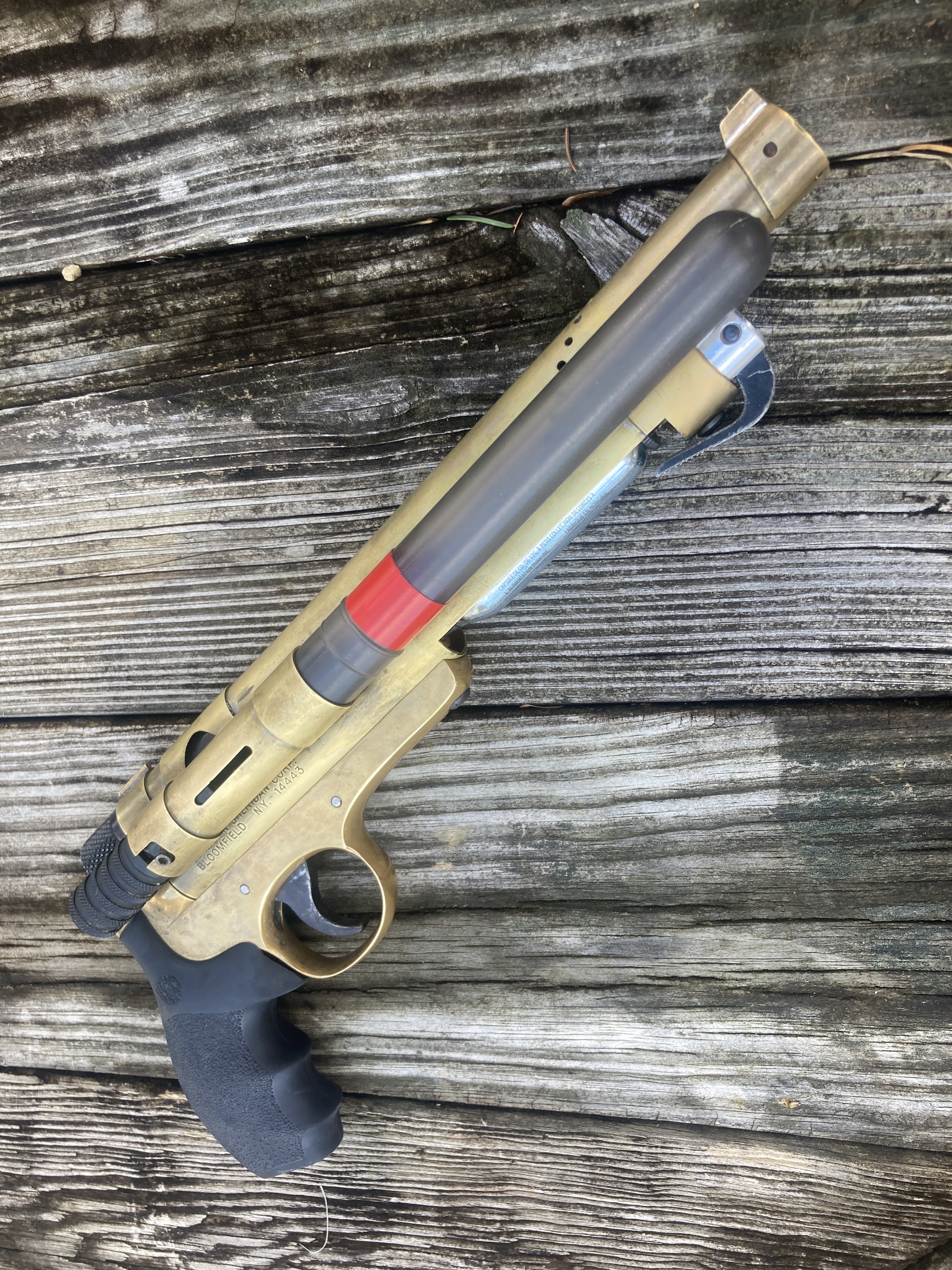

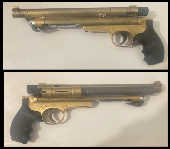

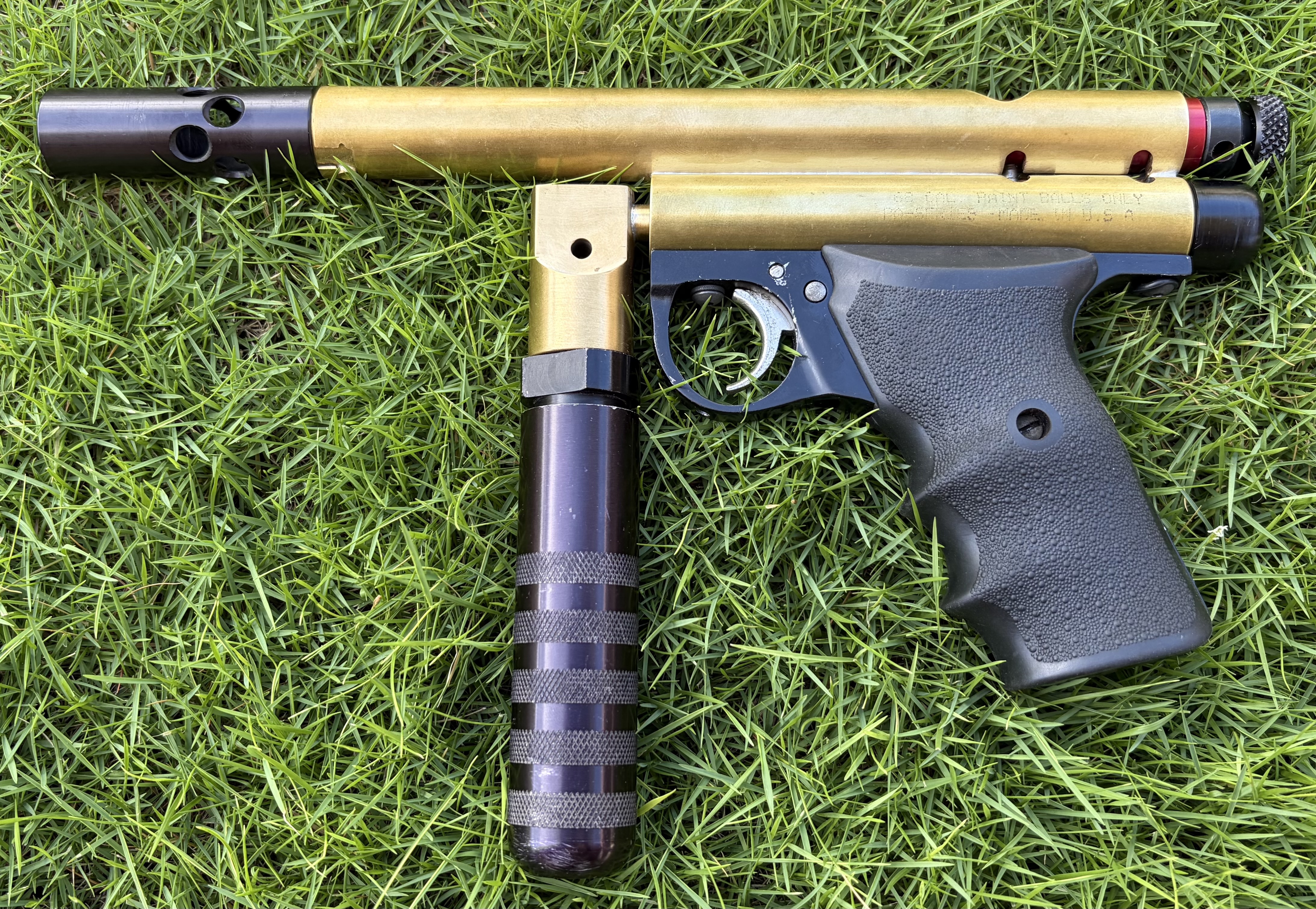

          My first build. I’m almost finished and made a FEW mistakes along the way but that’s how you learn. This was a really fun build/experience. So far it’s a single shot but I might change the setup. Im thinking of putting on sights on it. Still need to do some testing and see what I get on the chrono. I’m not sure when that will happen but Overall, It doesn’t leak air and I’m satisfied.
          -5” freak
          -Rimfire Cooper T bolt
          -Tippman 98 Vasa
          -Palmers Tip (This may change to a brass tip)
          -RVA
          -Rat changer for the pic
          • Impactfour
            The more I look at it the more fun this could be with a reversible clip on stock class feed, again what an awesome build!
          • Swedgin!!
            Swedgin!! commented
            I agree! Reversible stock class feed would be fun. Cal440 I guess I could do a small write up and yes I did take pics but I should’ve taken more
            That’s super cool! I put that same tip on my Lever Action build. Looks great on that. Cool idea with the 98Vert assembly.

          TOTALLY!!!
          Swedgin!! Did you do the freak mod yourself?
          My Collection
          • Swedgin!!
            Swedgin!! commented
            Yes, I did all the work 👍🏼

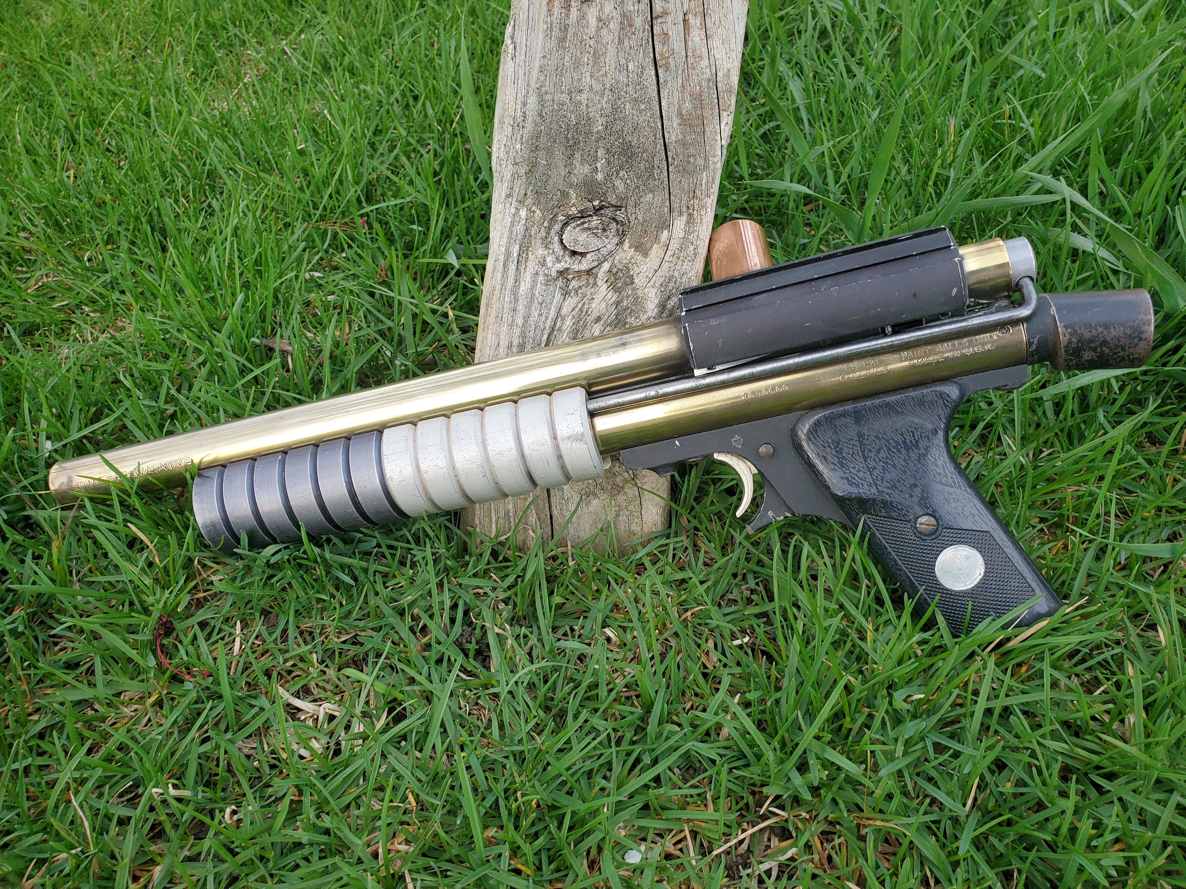

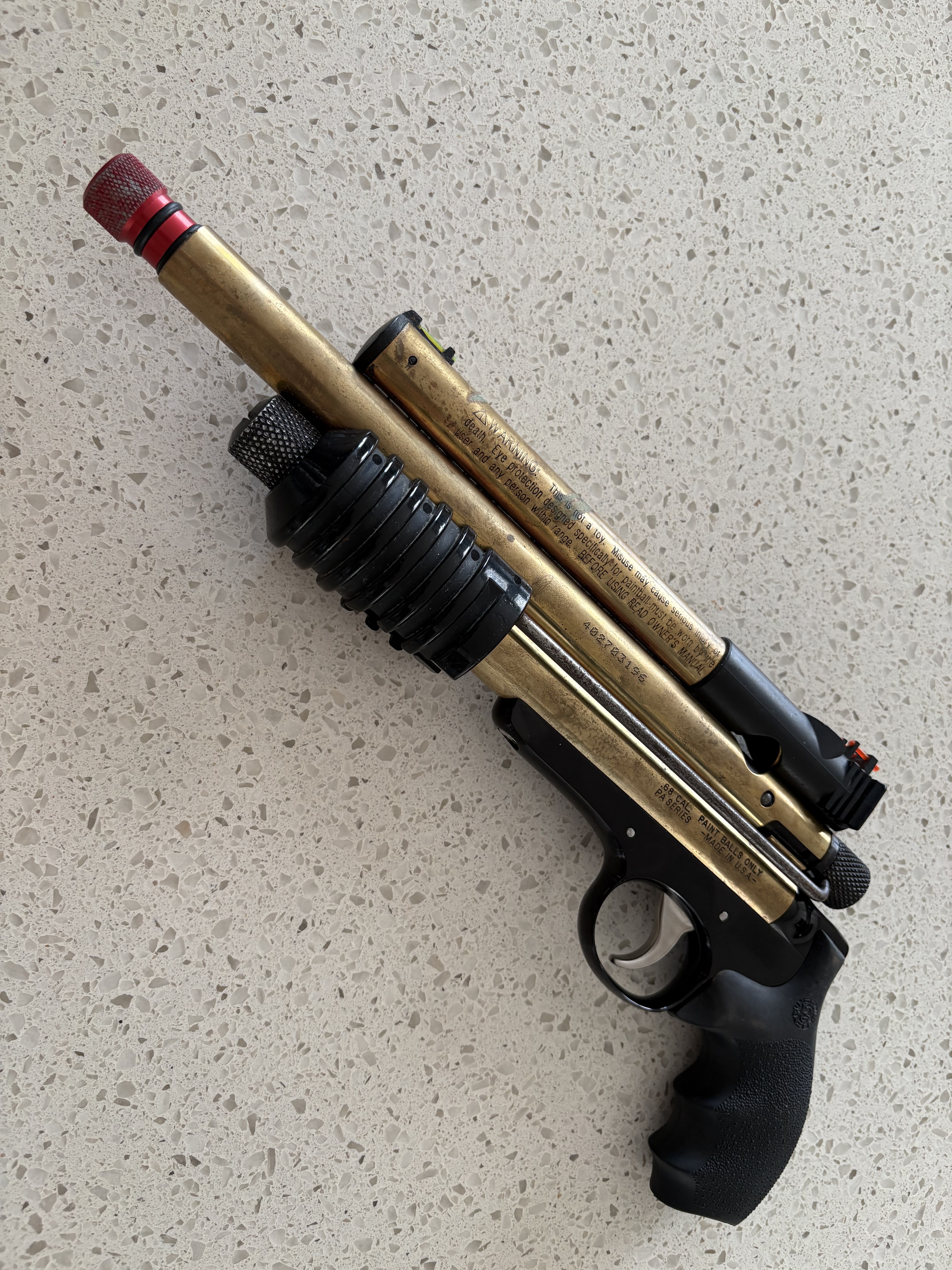

          After 9 months, I’ve finally setup my K-framed PGP 2K. Plan to have this on the field in a couple weeks.
          BigRed's feedback
            The K frame Transfoms how they shoot your going to really enjoy how it aims.
          • BigRed
            BigRed commented
            I totally agree, it’s like an extension of your arm. It’s been about ten years since I had a K-framed PGP setup.
