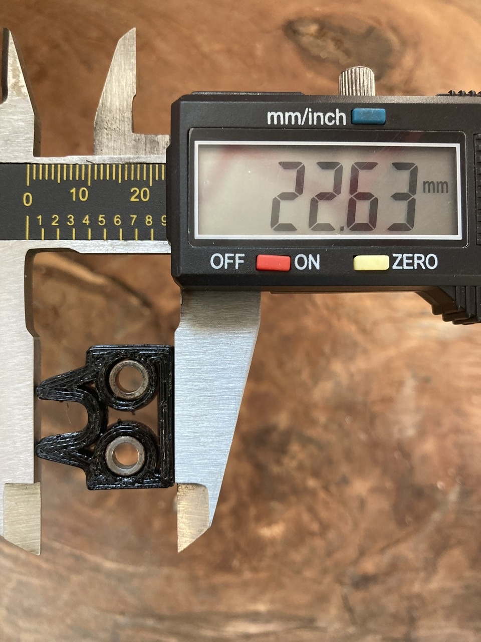

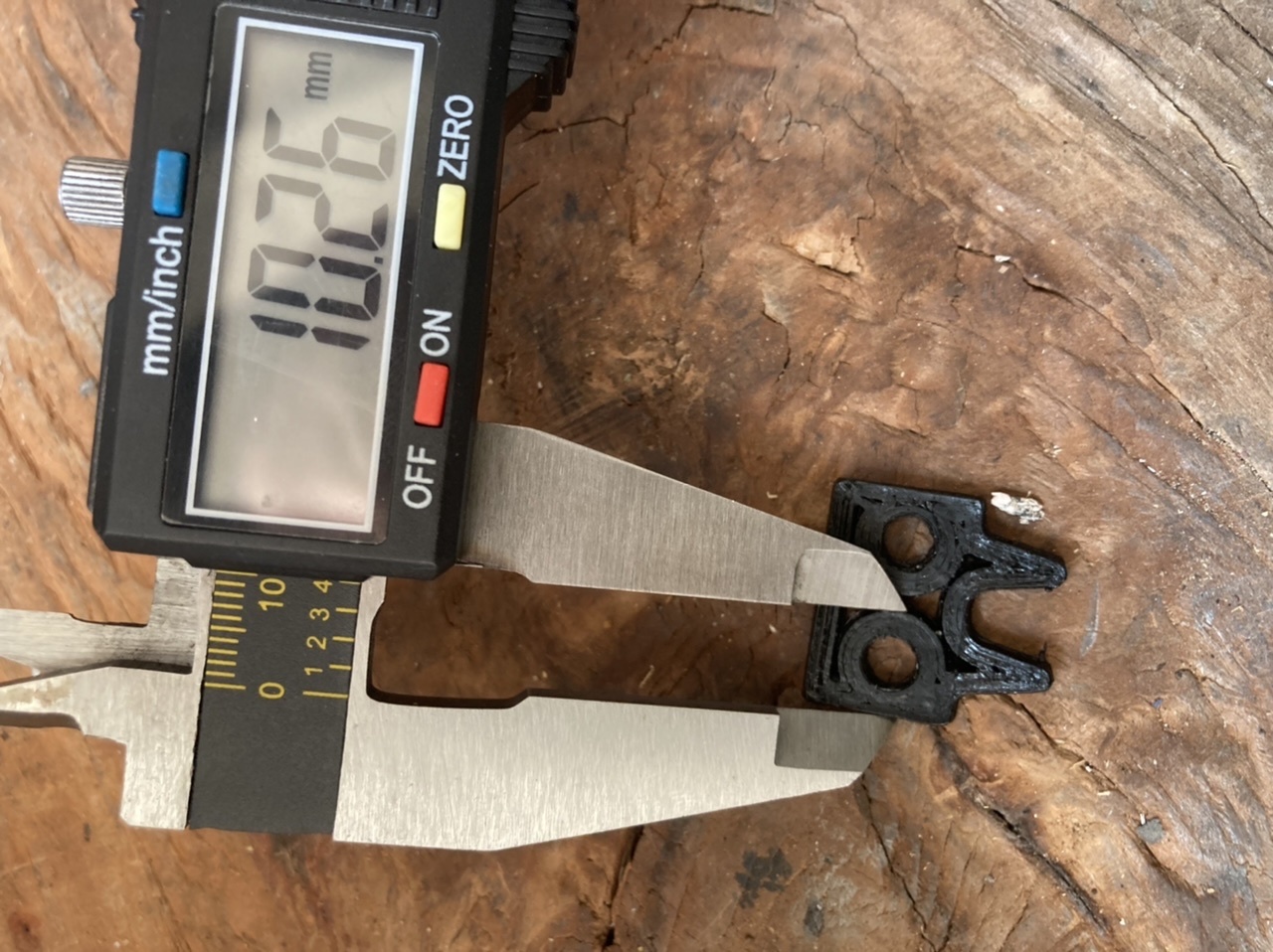

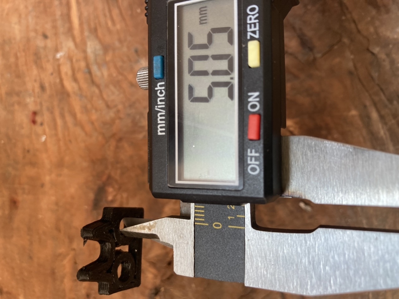

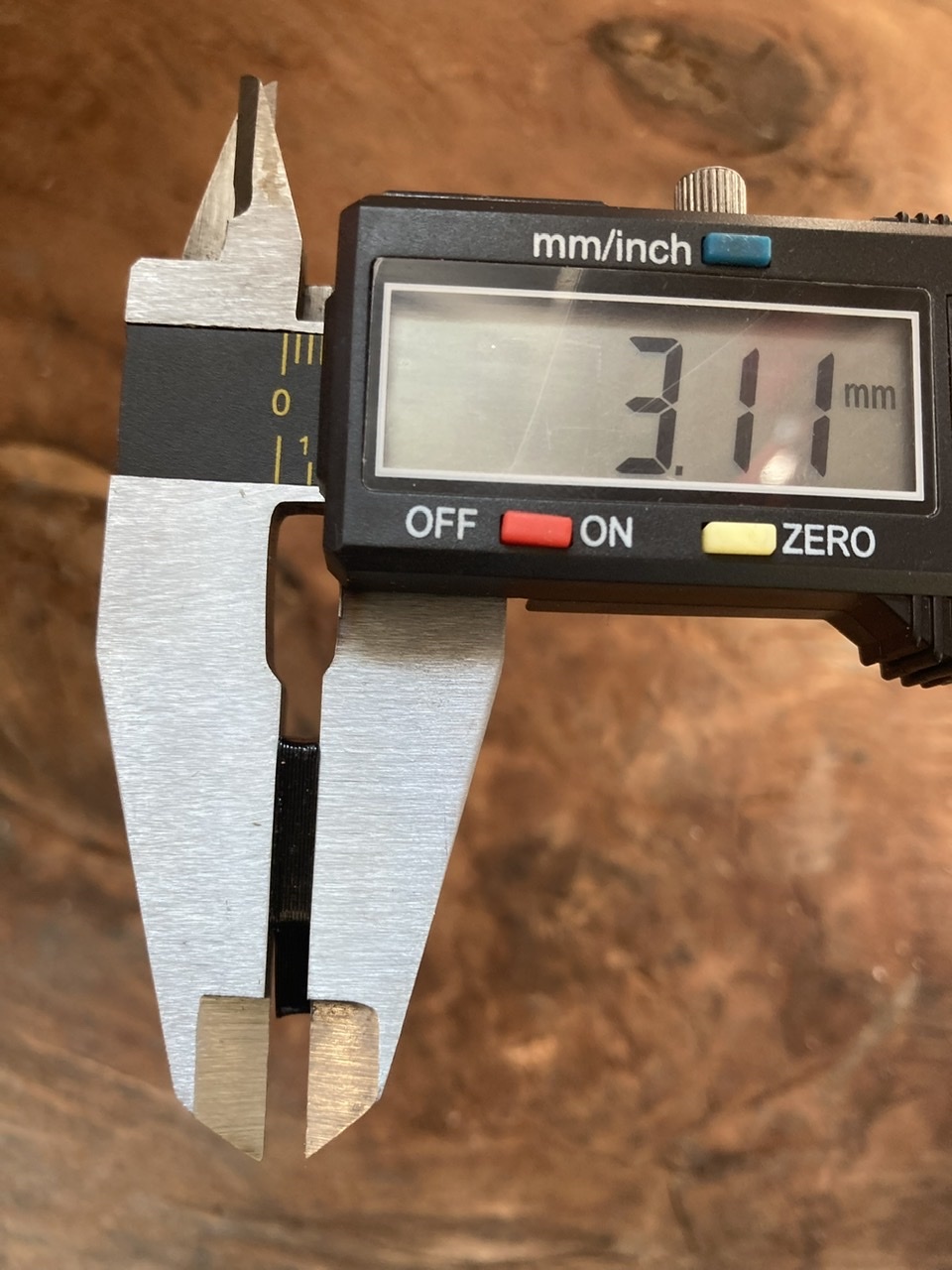

      Sorry don’t have a scanner handy. Here are some pics though. If you need additional measurements of something just let me know and if you prefer standard instead of metric I can do that easy enough as well.

        If you can send me holes inside diameter and hole spacing I think I could get something
        Your pictures are good enough quality to try to use them directly too

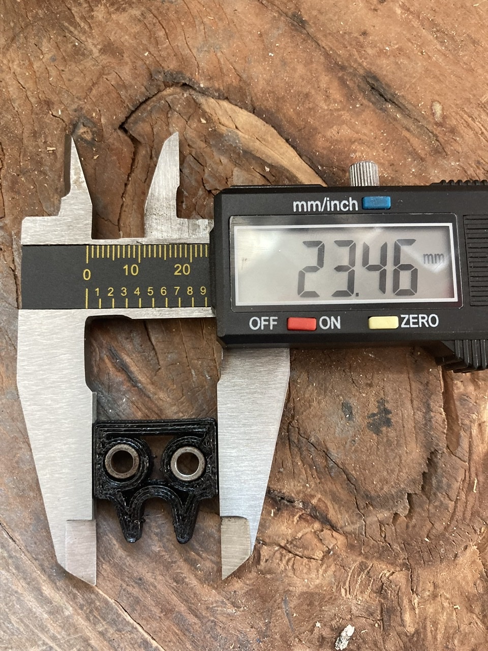

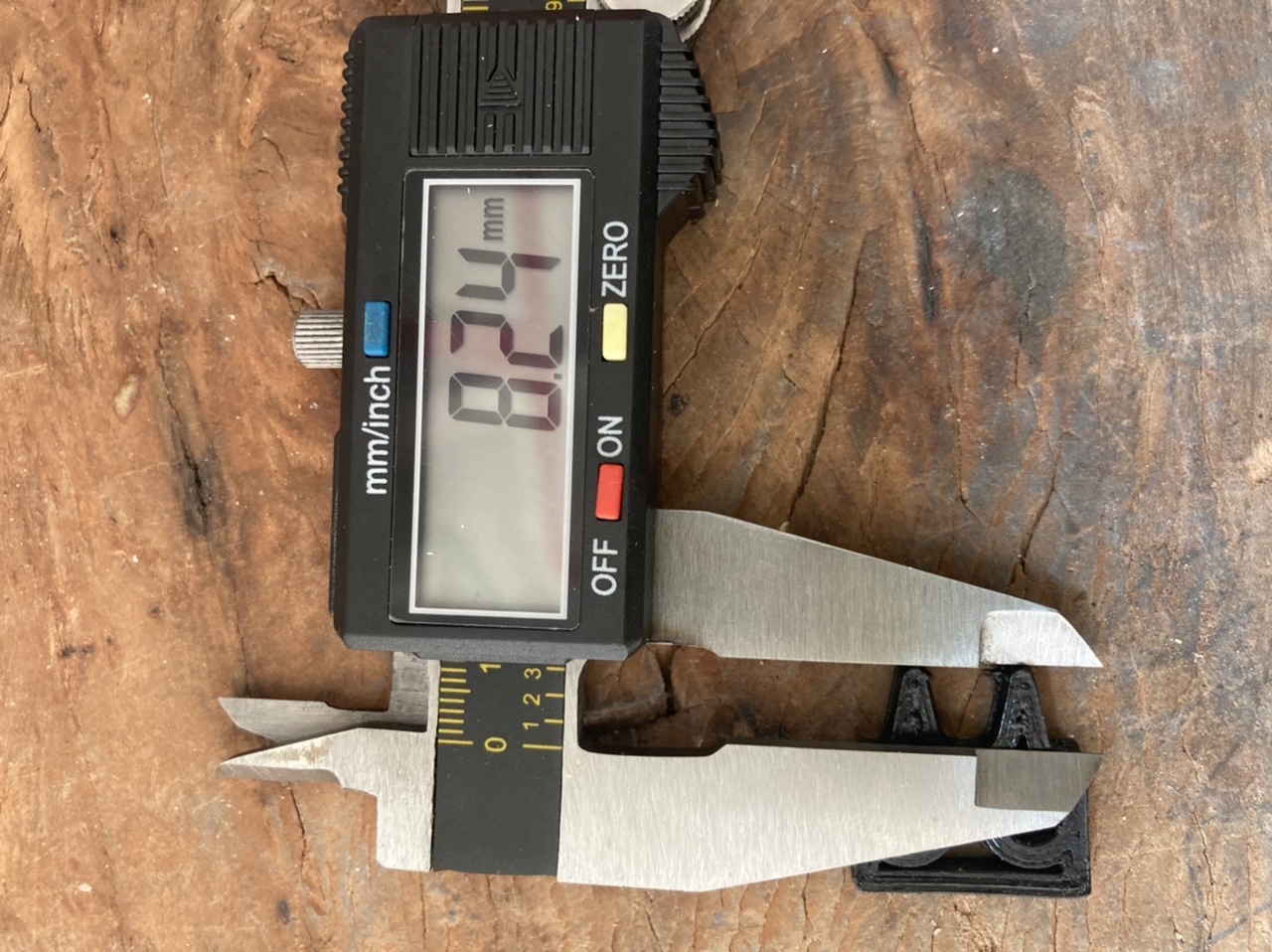

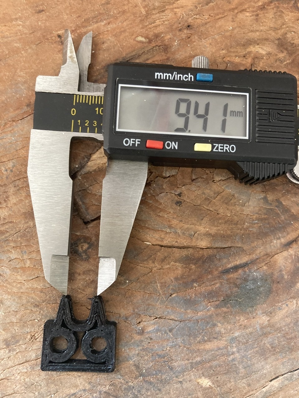

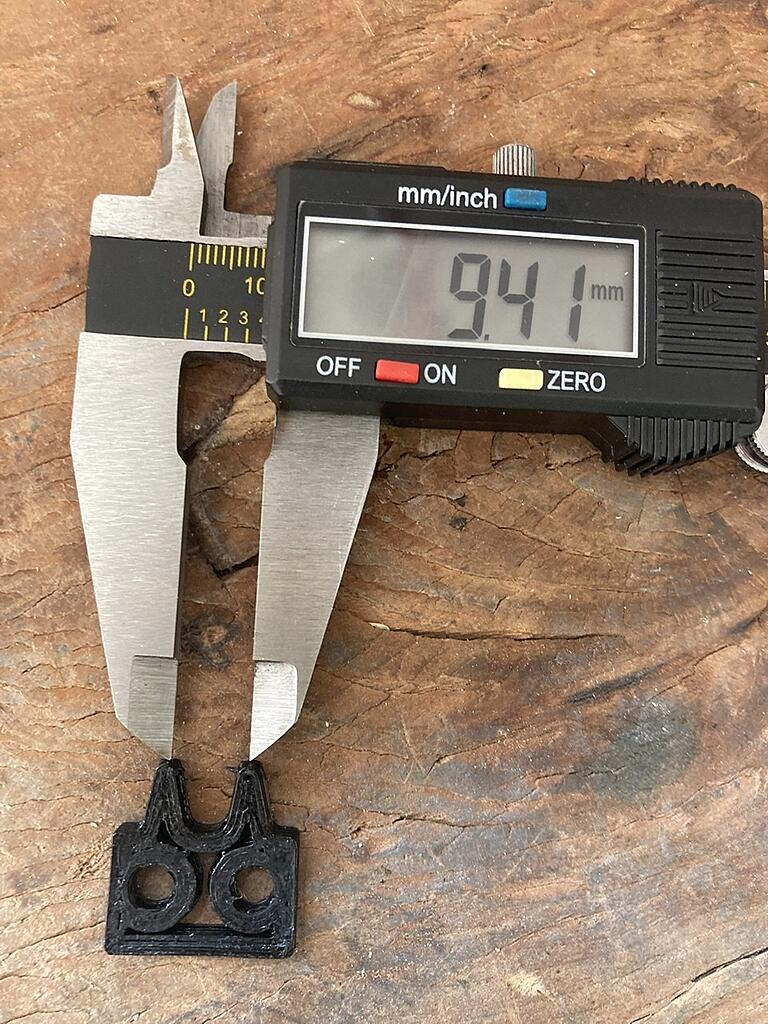

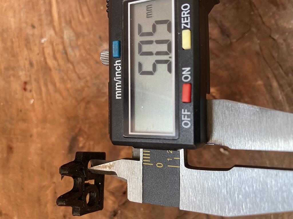

      Here ya go. Let me know if you need anything else.
      ECE7FD58-2A4D-40D9-AEBB-D8B707BAEEFD.jpeg 50D47CCC-4FF4-4234-9F92-3F76163428EE.jpeg 3CDA6F0D-417A-4C9F-8300-A60C3DFEE747.jpeg F7E91348-EDCD-4515-9DDE-6866571ECB3C.jpeg

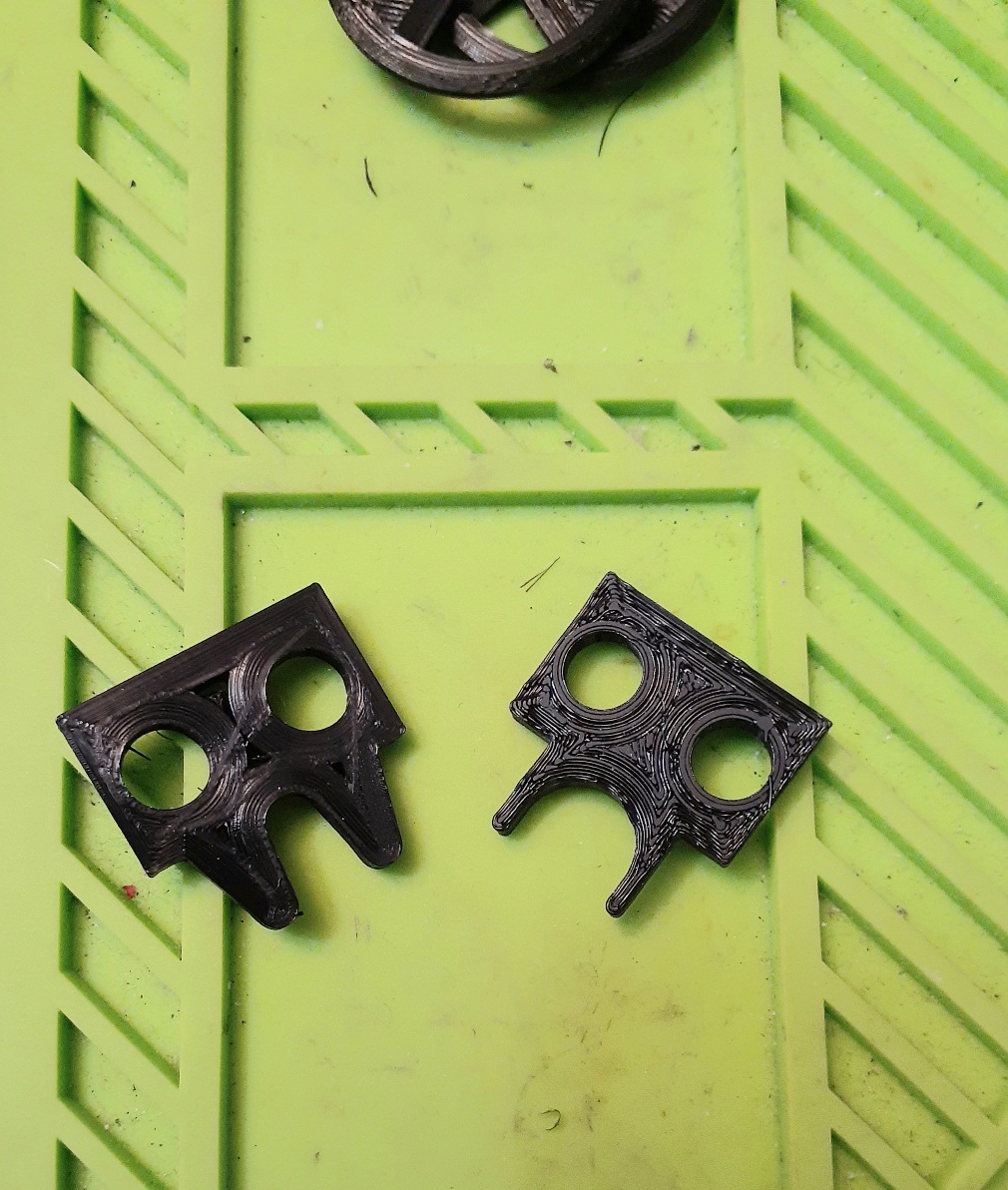

        Thanks wthomas333, printed some in TPU based on the dimension you provided and also made some with the design of Freedummy. Will send those to Jordan for the field test.
        Will put the file on thingiverse if they work
