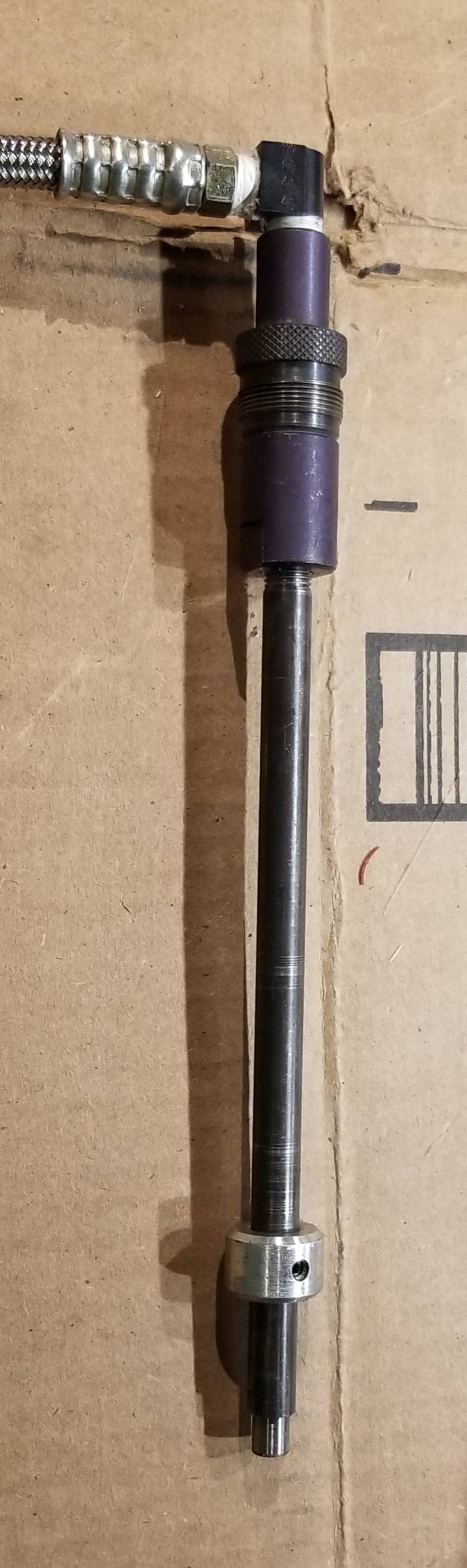

            The constant air adapter is basically a dummy 12g with a 1/8npt port on the front and a nut with the plug threads and a hole through it for the hose to come out.
            I don't have a KP3 to check, but I have a constant air adapter I can show on a PGP (same concept).

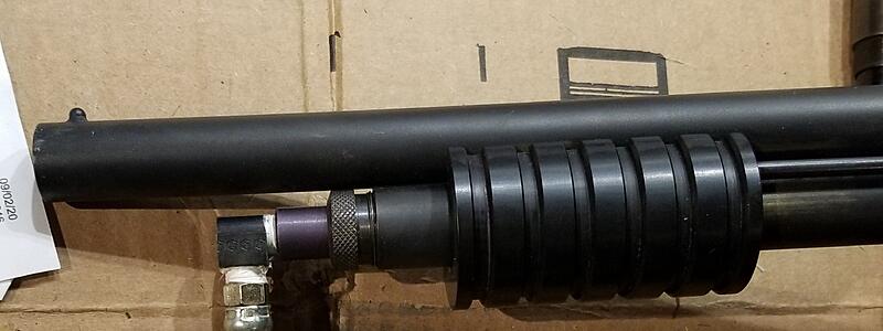

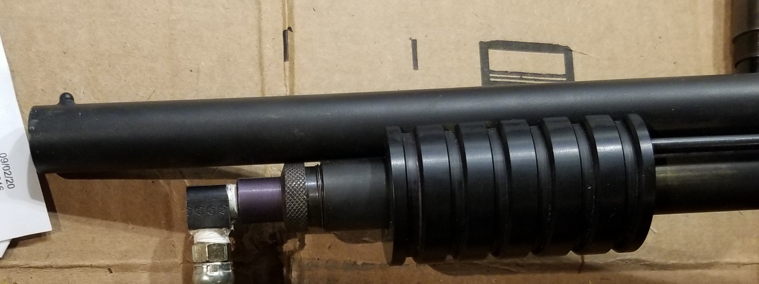

              I believe I follow. What I wanted to do was take out the bottle feed on it and be able to drop a 12g in. Theres a long tube that goes down to the face seal on the valve. I haven't taken it apart to rebuild the valve yet so I don't know if I could make a spacer to accommodate dropping a 12g down instead of the tube. Pics below are what I'm looking at. My 1st one so I'm learning as I go. Click image for larger version
