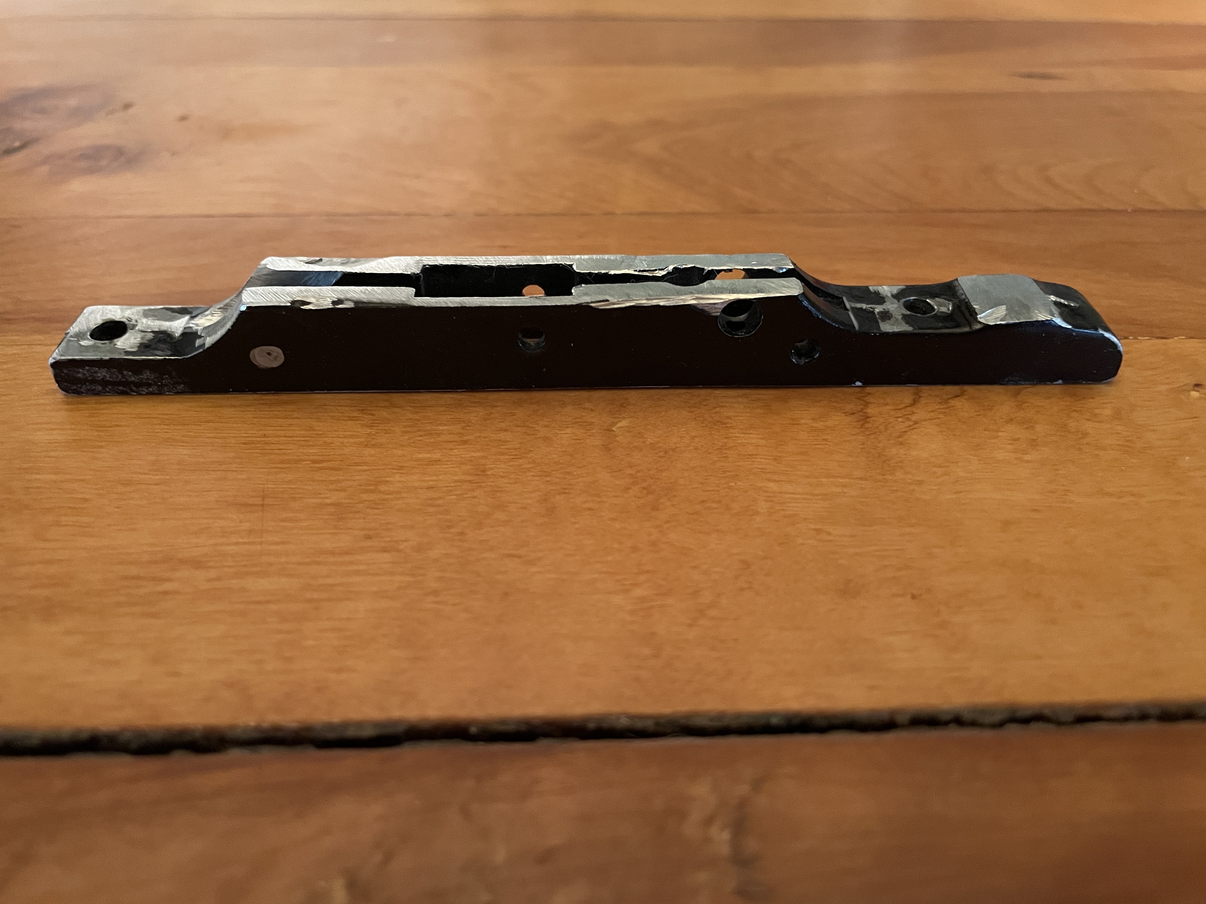

    There is some interest from some members on how to convert a pistol frame into a rifle...or pirate...wood...
    Its pretty simple to do if you have a dremmel tool.

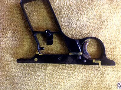

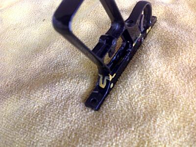

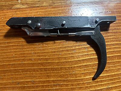

    i pictured a standard pistol frame showing the cuts you need to make.
    First take the guts out and set aside.
    cut frame at lines pictured making sure you do the back slotted one too.
    drill hole for new pin location for new trigger. The circle at the back of the frame...
    make a trigger out of steel or brass. Drill hole for pin and another small 1/16" hole for the clevis..
    you will need two clevises and a small piece of 4/32 threaded rod.
    cut the original trigger down and drill another 1/16" hole for the second clevis.
    try to keep the clevises close to the body so you don't have to inlet to deep for the new trigger group
    I like to round the ends for easer installation.
    you will note the front is cut both for length and depth... needed room when you add a screw and coupler to fasten the body to the wood...
    i didn't show the coupler so I will make one tommorrow and post it up.

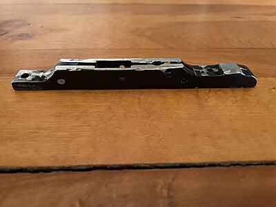

    picture of completed assembly.

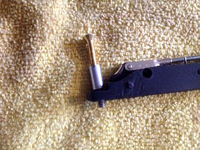

          Here is the coupler for the front of the frame I made..
          i used a 8/32 threaded rod ( you could also cut a screw down) , a cut in half 8/32 coupler ( about 1/2" long) and a 1" 8/32 screw for the stock retainer screw..
          you need to cut a slot in the coupler for a flat head driver ( so you can anchor it from frame to body).

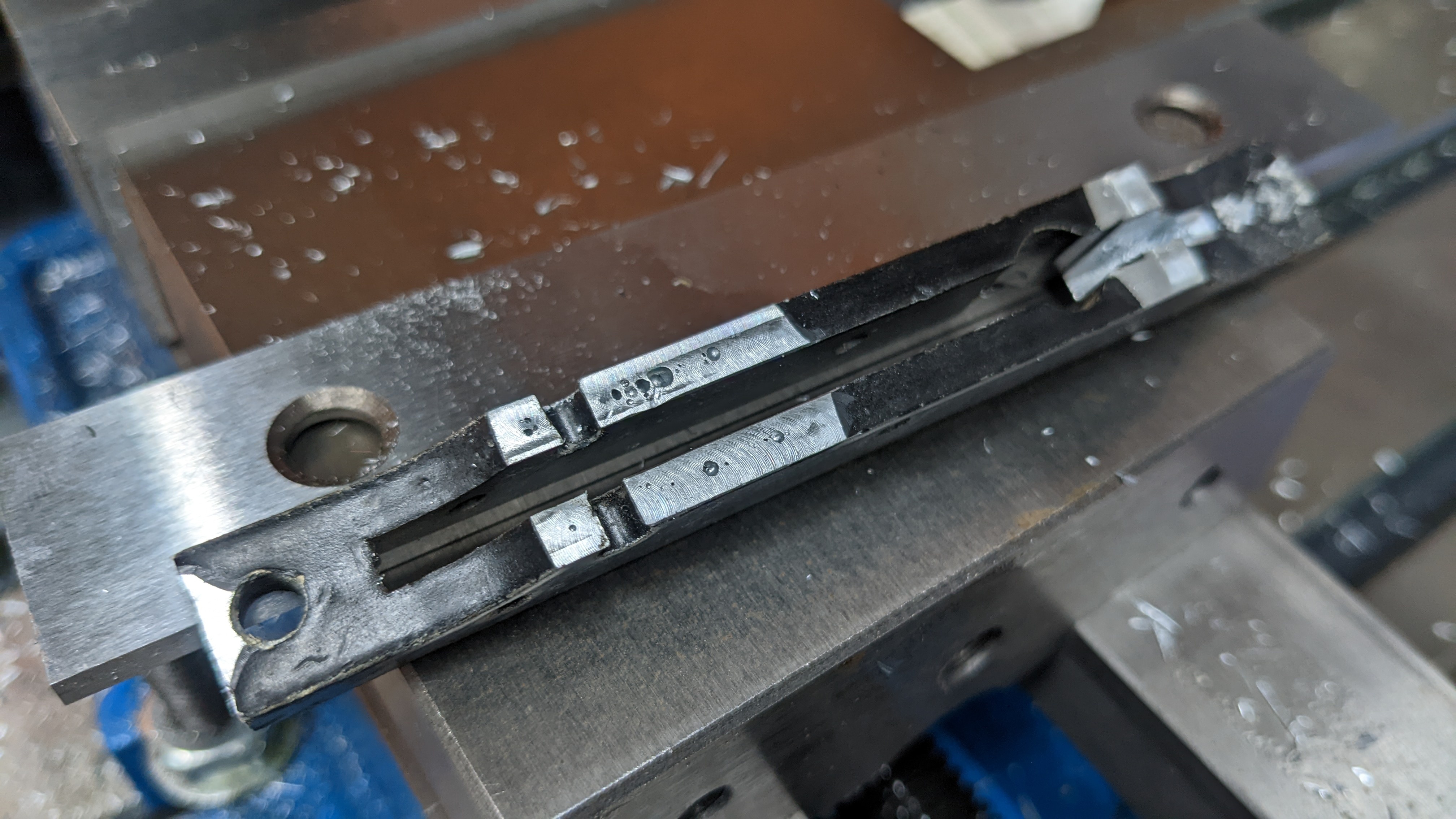

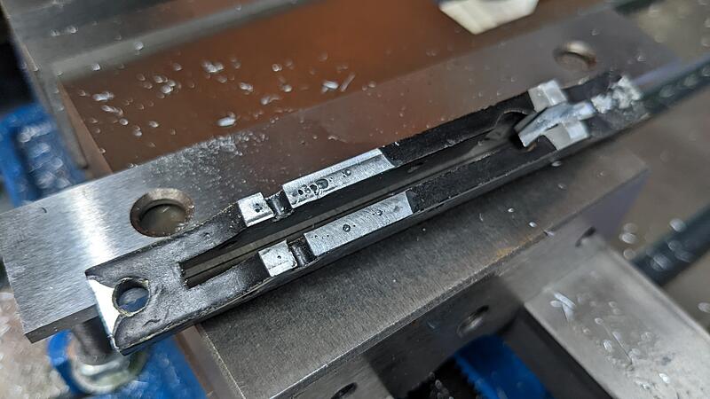

            alright Wally…you inspired me to go for it today! (I hope it’s right).
            Step 1 - done!
            This weekend I should be able to get the trigger pin, trigger pin hole drilled, a new trigger made, and then get it cleaned up with a file.

            • WALZ
              WALZ commented
              Looking good so far..
              Now you need to cut the face down at the front where the screw/coupler will screw the frame to the body.. the pictures are not very good but if you look at the outlined frame above you can see where I just dremmeled/ filed the face down to about 1/8" thick..
              One more thing, at the back where the new trigger will set you need to file/dremmel a longer slot so the trigger sets back further.. ( almost half way to the screw hole).

              JeepDVLZ45 commented
              Makes sense. I definitely just missed the proper “cut” on the front end. The rear notch is “forthcoming”. I think I misunderstood where that one goes. Thank you!
              Thank you again. I’ll toss up another later when I get the cuts done so you can double check my work
              You’re the best!

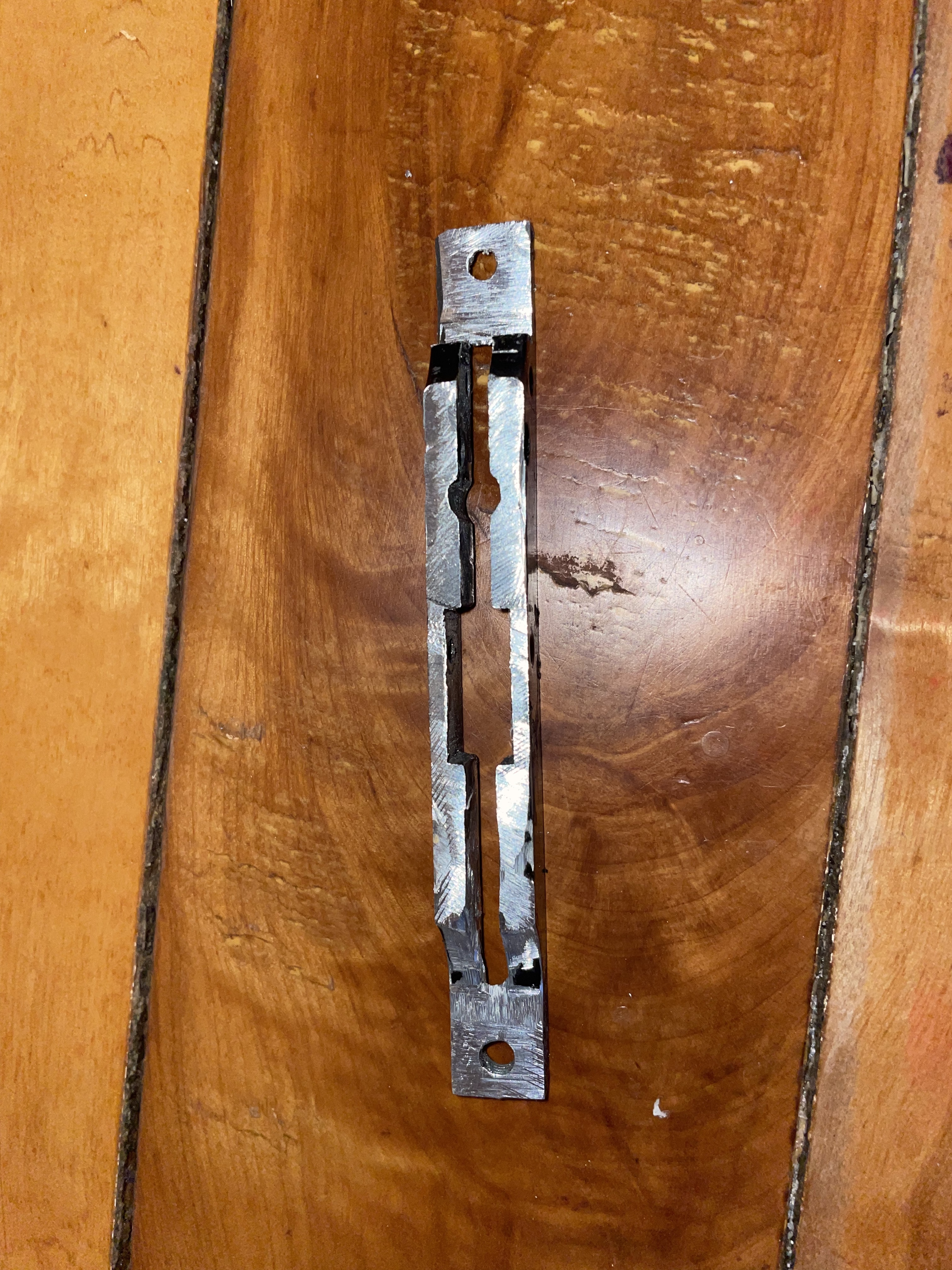

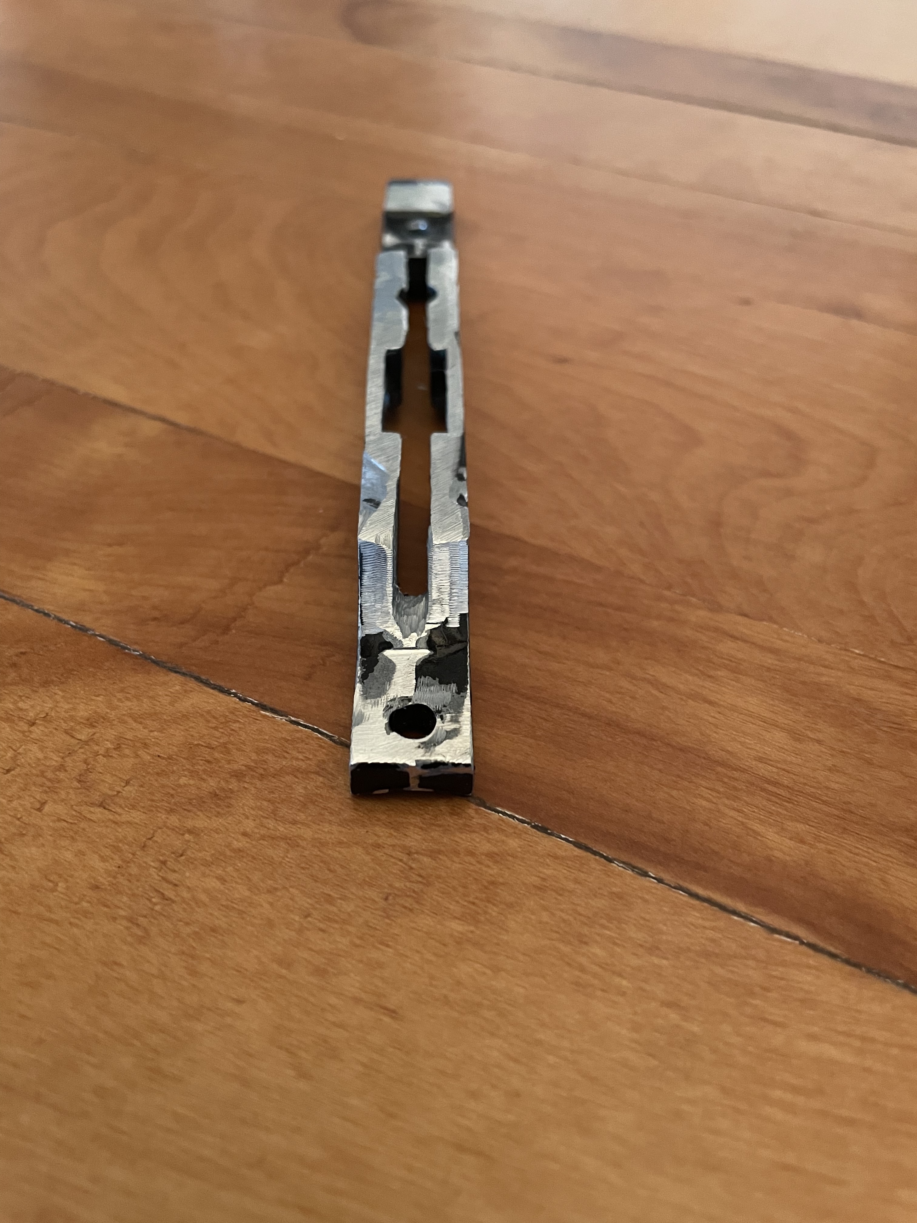

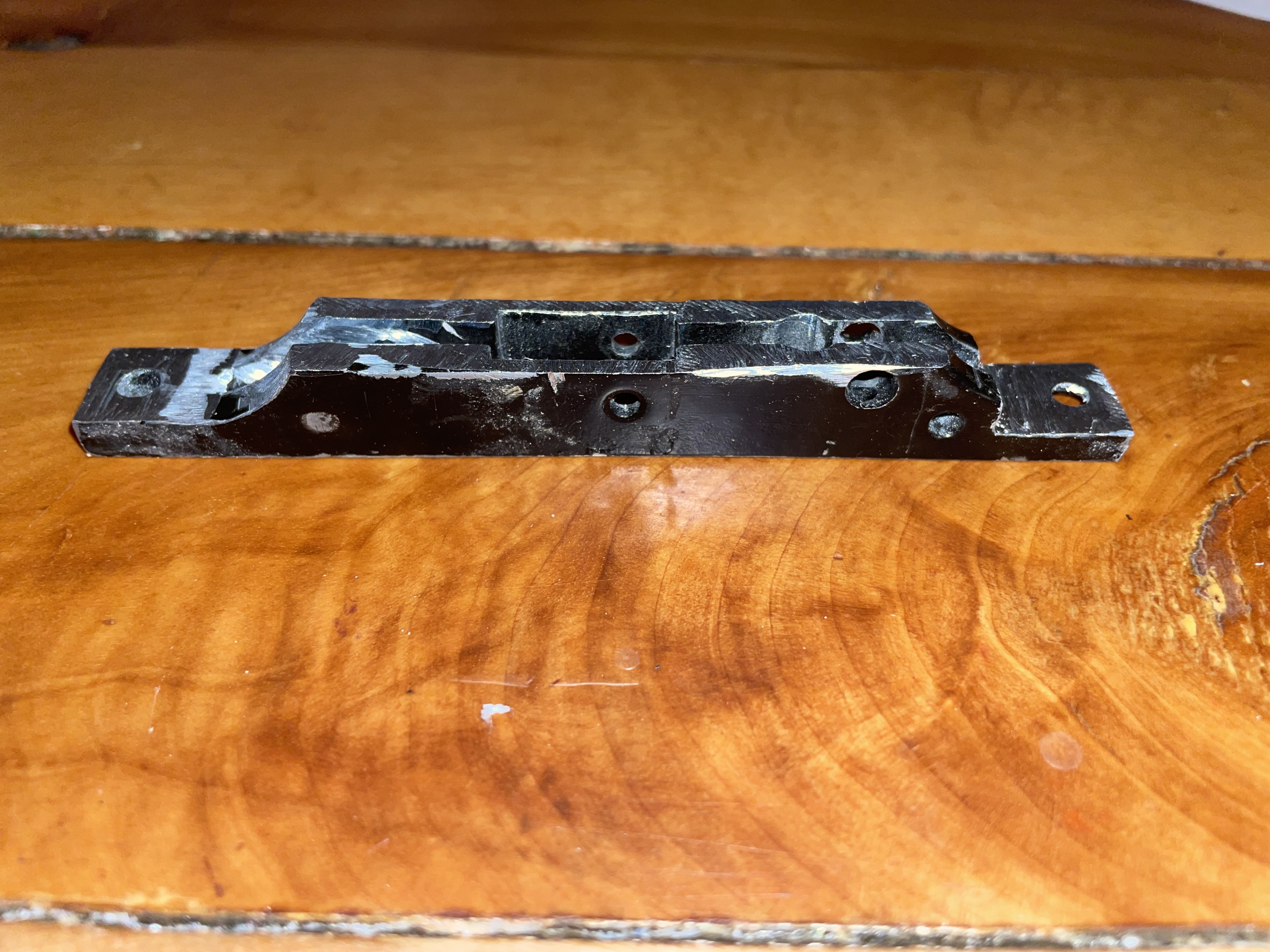

            Getting closer… (never mind that it didn’t dawn on my that if I clamped this down in the middle I’d pinch it and bend the opening shut (oops)
            it was spray-painted black at one point so it looks much worse in pictures than it is

            • WALZ
              WALZ commented
              That's perfect...
              Now make sure you put the trigger back to the end of the radius section.. you will see there is not a lot of wiggle room for the sear if you install it to far forward..
              I like to round the ends, it make it a bit easier to install in your wood.
              When you cut down your trigger try to keep it as low as you can and still have room for the clevises to move freely, same with hole in trigger ( drill this one out just slightly bigger then the clevises pin ( I use 4/40 clevises). Or the trigger may have more play then you like..
