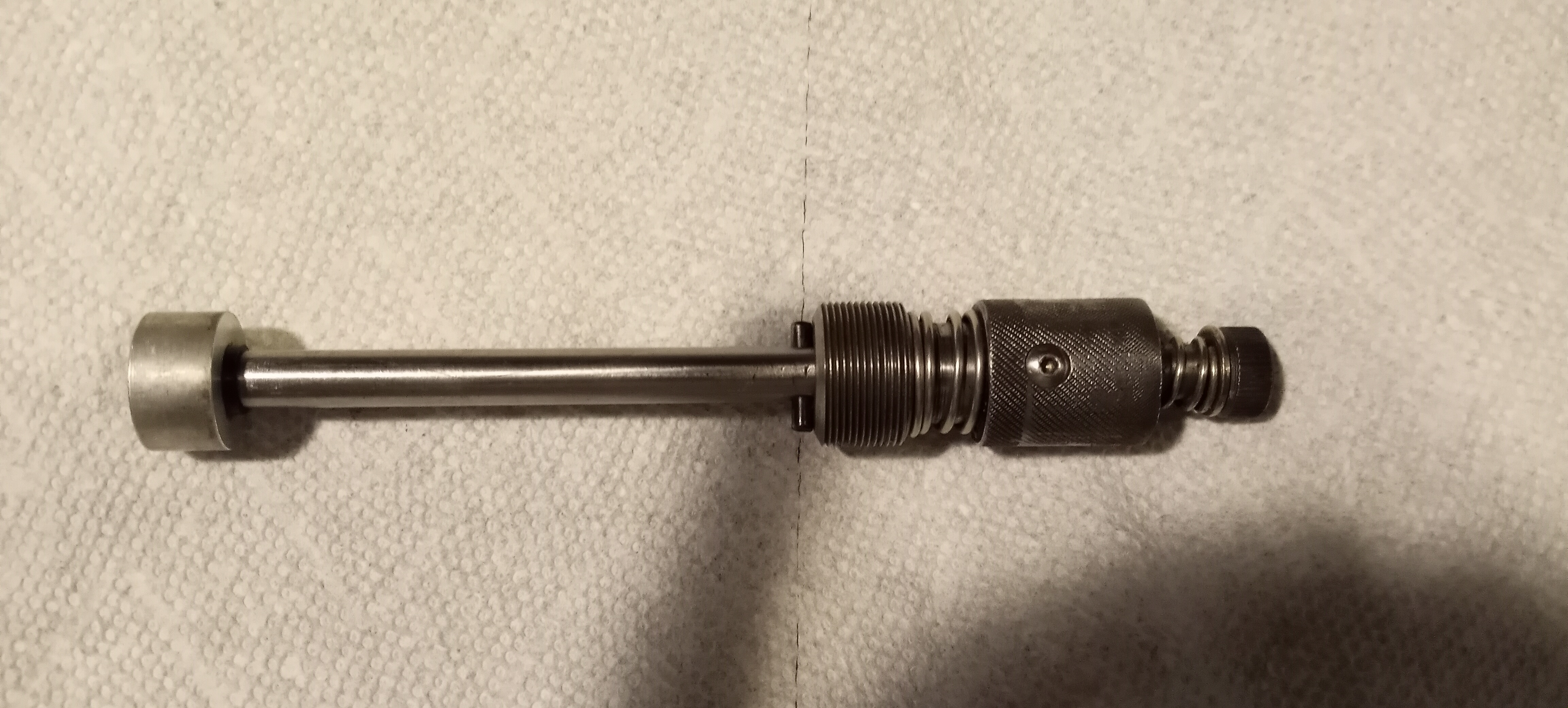

            pretty simple design, kinda like how the slide collar works on a quick disconnect air fitting. there are bearings inside of the collar, that are mounted into the main threaded body, just like a female disconnect. Threaded portion is what screws into the end of the lower tube. there is a version with a much longer rod for the MAC rifle.
            Hold the collar with 2 fingers and push in the center knob at the end. The center rod moves slightly, then all the sudden the collar will snap forward due to pressure from the "back" spring and preloads "front" spring. Cartridge is now loaded. To ensure proper seal rotate collar, this will also rotate the threaded main body. So you can adjust for variations in cartridge length.
            This shows the "cartridge loaded" position
            Click image for larger version  Name:	mac_engaged.jpg Views:	0 Size:	2.33 MB ID:	259028

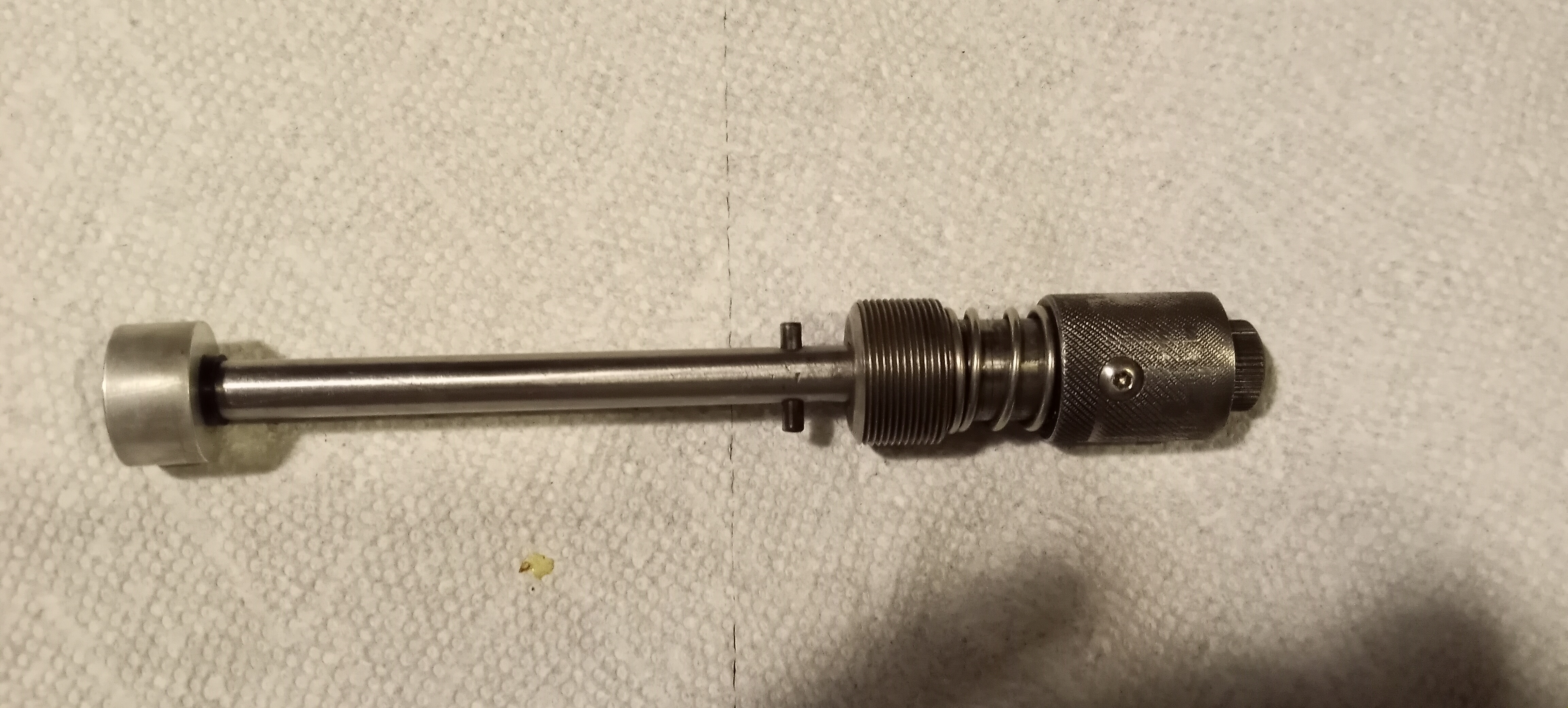

            to eject, slide the collar back towards the body. bearings move out of machined groove, and "front" spring pushes collar back towards marker. Cartridge falls out of the cutout. This shows the disengaged or loading position. Pin prevents shaft from moving too far and preloads rear spring.
            Click image for larger version  Name:	mac_disengaged.jpg Views:	0 Size:	2.32 MB ID:	259029

              Excellent pictures, thank you!

                They come apart fairly easy for servicing. Watch out for the bearings, they are not captured in a race...
