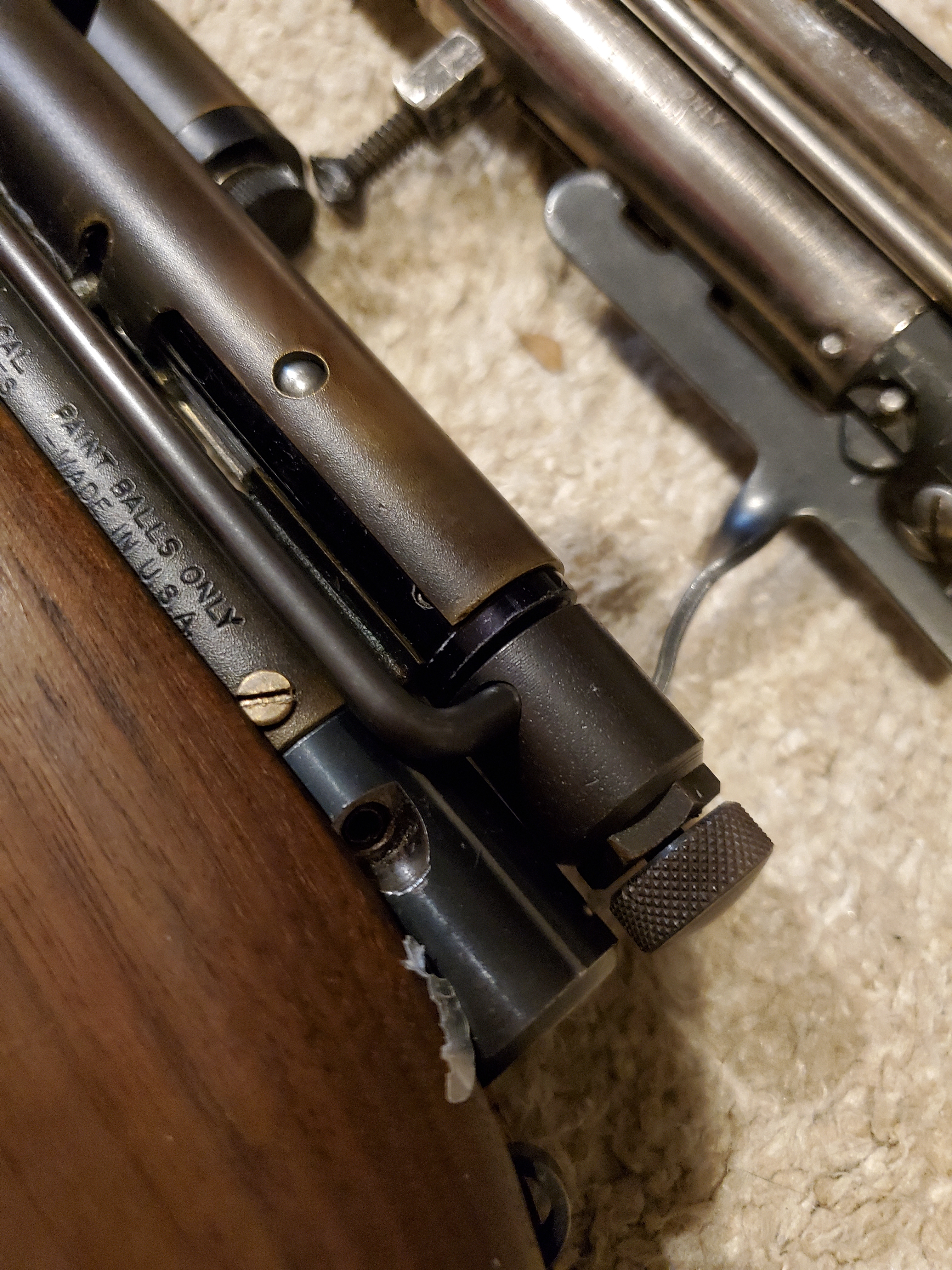

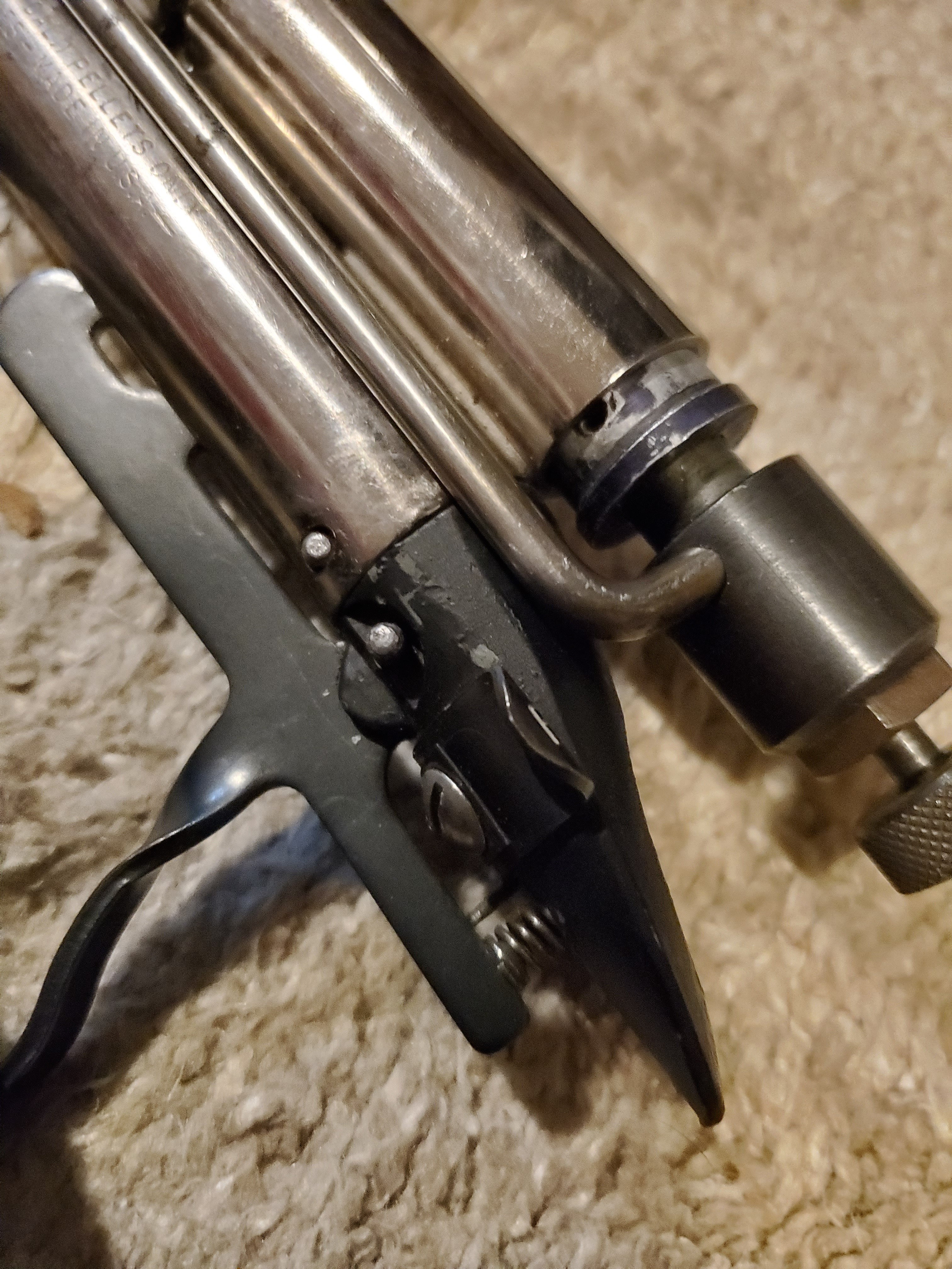

        so a slanted trigger group body is not compatible with a flatback late kp3 trigger group. The slantback uses a cross pin to hold it in place while the flatback uses two side screws.

          • 3511
          Are you averse to drilling holes?
            • 3415
            Well, my bad.. my walz has aslant back and is side drilled like your flat back, so I figured it would work.
