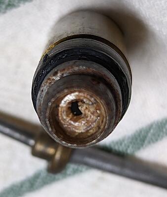

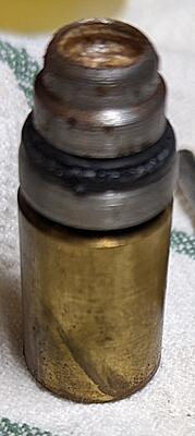

          Got the valve rebuilt with the Palmer's kit (well, mostly a generic paintball o-ring kit) and it's shooting great now. Thanks again everyone!
          The seal and o-rings on the valve had basically disintegrated, guess it was older than I thought.
