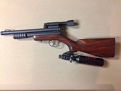

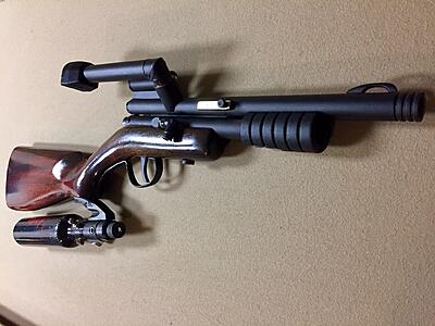

    Metal order finally came in and was able to complete a bit more on her..
    Modified the pistol frame to fit stock and made a trigger.
    Made a trigger guard from a piece of ole barrel tube.
    found a drop that works with this stock and a asa.
    powdercoated everything fine texture black to match the body..
    I just today ordered the stock I need for the butt plate and some 10/32 threaded inserts for the drop to anchor securely.
    Xemon stepped up and made me five feedgates and this is one of them on the marker.. very nice and looks real durable. Uses tipmann detents for the retaining fingers...
    pics of her now..

      this is a beauty!

      The front sight is great.

    So unique!

      Wow that's a super cool build, looks like it would be super comfy to use

        I love everything about this build!!!

          God dang! That looks amazing! And the ergos of that stock looks like it would be perfect.

            Huh, somehow I didn't get notifications that the were posts in here. Nice work walz, it's looking awesome. I'm not sure how he will feel about running 10rd feed but I'm not sure he has really tried before so, everyone has to try at some point right?
            Looks awesome, I'm pretty sure he will really like the color scheme

              Looks like the 10rnd feed may be removable to use it as a direct feed. Unless he soldered it up since the photo.
