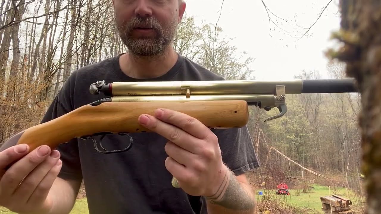

    Thanks,if I understand it right when the lever is flipped forward is when the pressure is applied to the 12 gram?
      If you look up the Delta 68 it works exactly the same.
    • AnarchicArctic
      AnarchicArctic commented
      Yes, the lever arm pushes the plunger, driving the 12 gram onto the face seal
    • Spider!
      Spider! commented
      The 12g lever is also independent of the barrel tilting hinge. They just share that pivot. In case that was confusing.

          Awesome! Looks great... how'd you secure the CF, epoxy or press fit?
          • AnarchicArctic
            Man I loved the village…carbon fiber is attached with a combo of friction fit and gorilla glue.
