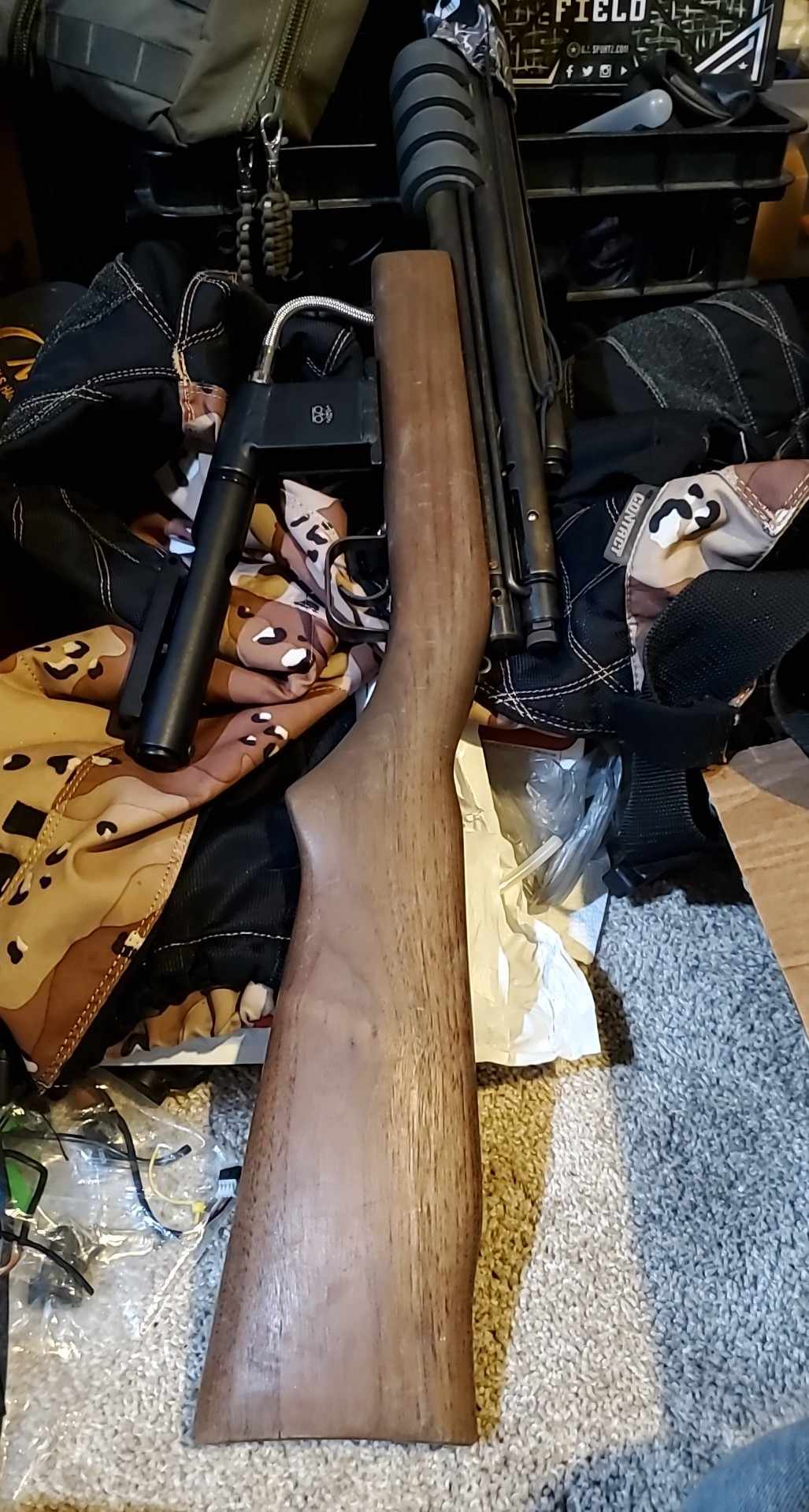

      I just re oiled my walz. I started with Murphys wood oil soap and washed as much gunk out of the grain as I could. Then I simply wiped many coats of boiled linseed oil into, and off the stock.
      Iirc walz recommend that cut the oil used on the first few coats with thinner. To make a better finish.

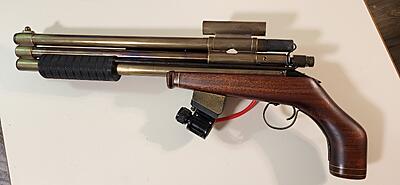

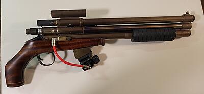

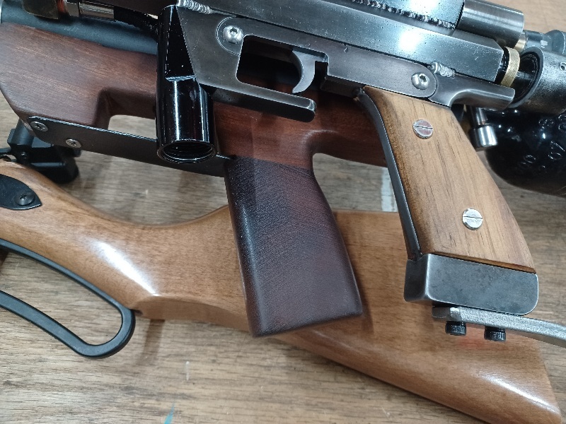

        I pick my wood finishes, depending what environment it will be living in.
        Epoxies and urethanes give a long lasting finish, second-to-none. Great for wall-hangers and people who actually take care of their stuff.
        I beat my wood so the finishes just end up cracking and getting moisure trapped under the surface. So i usually use a wax or just let the gun oil bleed into the wood
        Front: hydraulic oil on raw cedar
        middle: wax on raw mahogany
        rear: wax and urethane on beech
