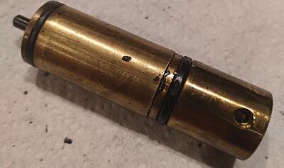

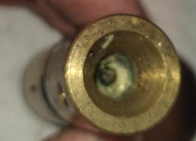

    Well, I aired it up and it leaked out in seconds. Evidently the seals must be fried. Here's the photos. I guess I have the round valve cause it pushed out easily. Looks like the 12g seal is pretty crusty. Guessing that's where it leaked.
    • VintageZoomer
      VintageZoomer commented
      So I just need a phantom cup seal and a couple of rings then? Seems pretty simple
    • Chaos
      Chaos commented
      Exactly,just a couple o-rings and a Phantom Cupseal and you're good to go.... You can refurb the Sheridan Cupseal with a drill, toothpaste and an old toothbrush

    Pro tip: Mark the two halves of the valve before opening it up to ensure the two sides line up properly when you reassemble it.
    My Feedback Thread
    • VintageZoomer
      Did not know the cartridge valve would come apart. Good to know.
  • VintageZoomer
    • Jan 2024
    • 59
    #18
    I got ahold of a Palmer's seal kit with the dynavalve. Aired it up to check for leaks, but didn't have any paintballs. None in stock unless I drive an hour. I had to shoot a good number of times to run out of air, so I'd say the leaks are gone.
