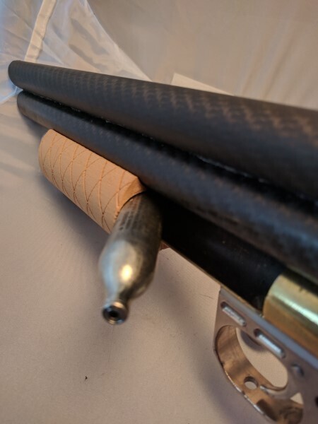

        The 12g "drop out" so you don't have to remove the plug.
        • VintageZoomer
          VintageZoomer commented
          Question: would I have to remove the pump since the pgp is so short? I'm not too keen on that, as I've always had my heart set on a pump action marker.
          XEMON commented
          For this one I made a custom pump handle with a notch and ramp on the side.

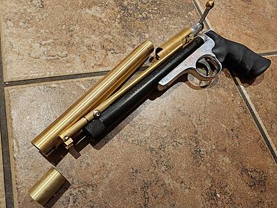

        Here's a pic of one of my favorite builds. Freak bored, bolt action, break barrel single shot PGP

          XEMON I'm a little confused on that one you have there how does that work with pump handle?
          • JeeperCreeper
            Multi-purpose
            • 2129
            • Western MA
            He mentioned in a comment, he carved a small ramp in the side, for clearance to pop the 12ie out.

              • 6250
              Yeah I think I understood that part but my question is how does that handle pump the marker but then also normally hold the 12 g in? What happens when he needs to change the 12 g? Does the pump handle move more forward to make room?
              • JeeperCreeper
                Multi-purpose
                • 2129
                • Western MA
                The pump handle doesn't hold the 12g in. It stays in place when it's pressurized. To remove a 12g, unscrew the changer until it drops out. The pump handle would likely be all the way forward to do this. It normally wouldn't fit out there, that's why the pump handle is carved.

                    • 6250
                    Ok got it now. I thought the pump handle was holding the 12g in or at least covering it up while at rest. Thanks for the explanation
                    Maybe I'll try building one some day. Looks fun
                      XEMON commented
                      @jeepcreeper described it well.
                      Also moved the pump rod to the right side to make more room and an extended plug for better grip 😁
