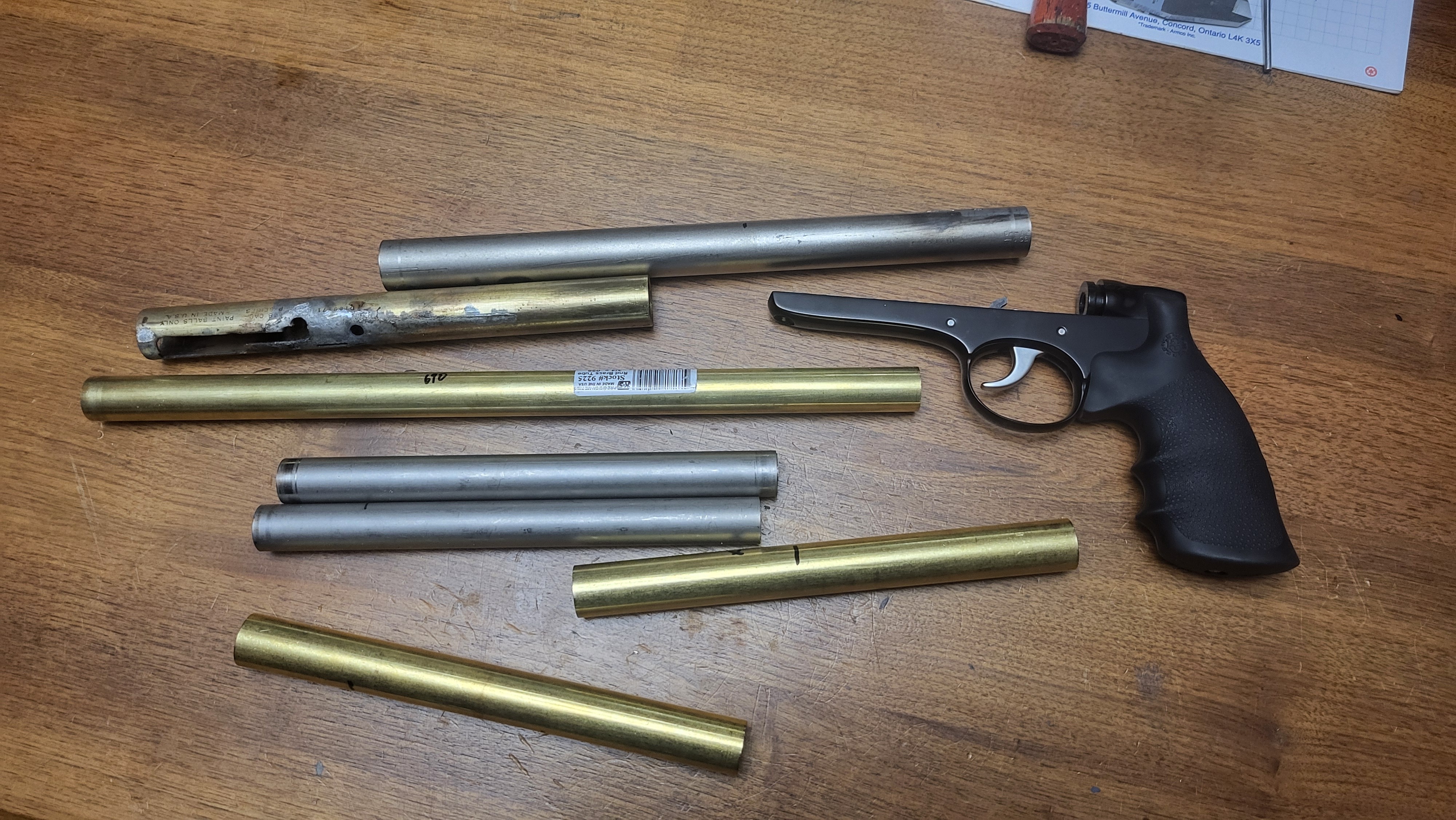

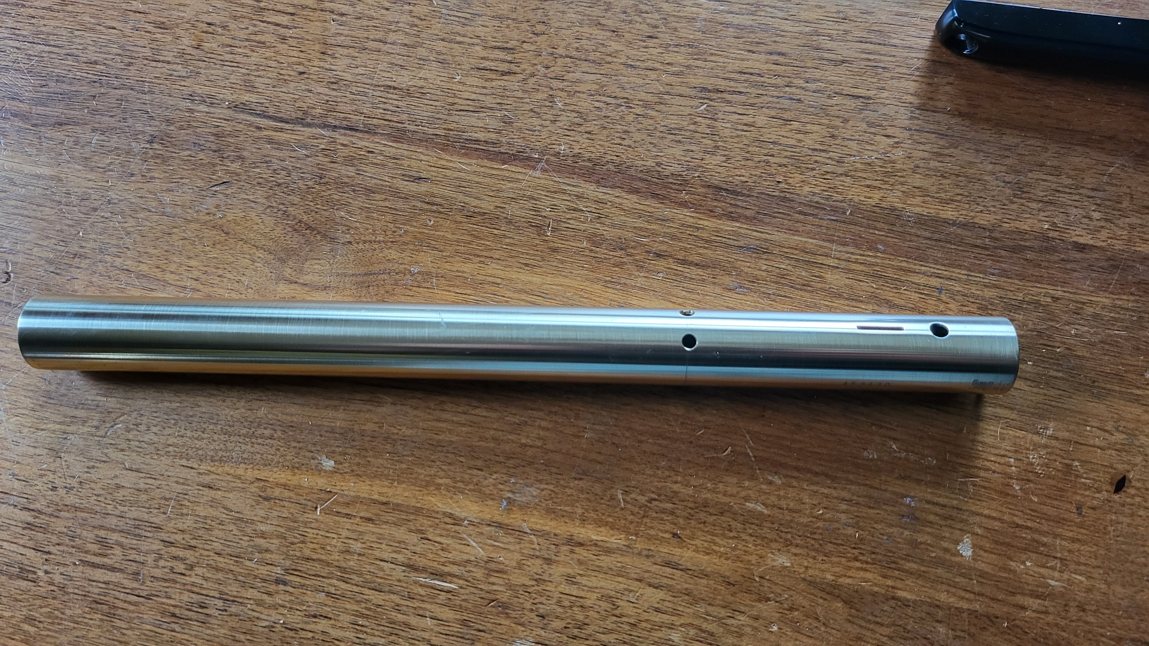

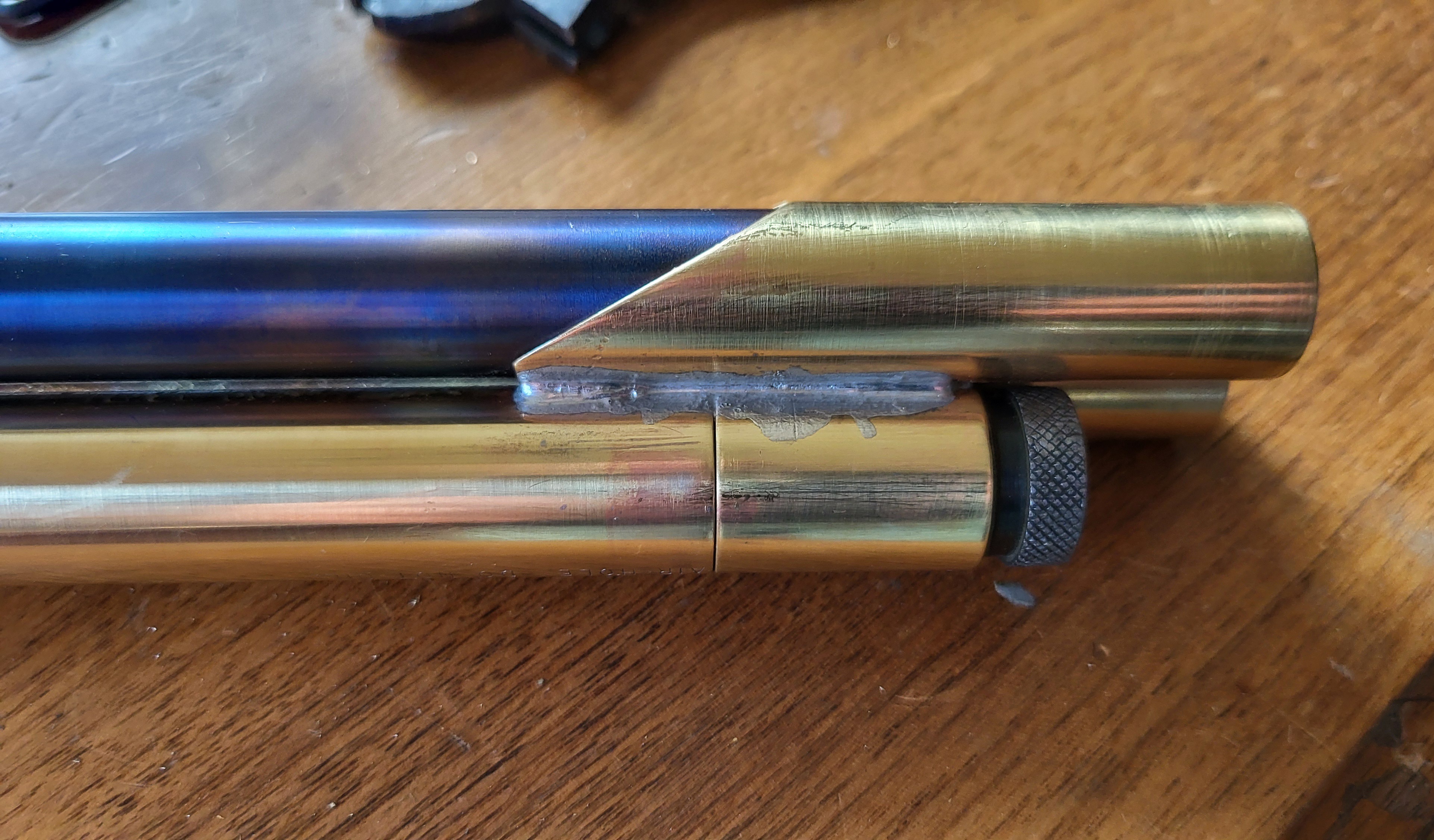

      The lower tube is a chunk of Bluestreak/Silverstreak tubing I got from Bacci a while back with the intent of doing this. I removed the Nickel plating so I can solder it all up and marked/drilled the new valve ports - you can see the original one near the end of the tube.
      Click image for larger version  Name:	20240331_111924.jpg Views:	0 Size:	2.45 MB ID:	526975

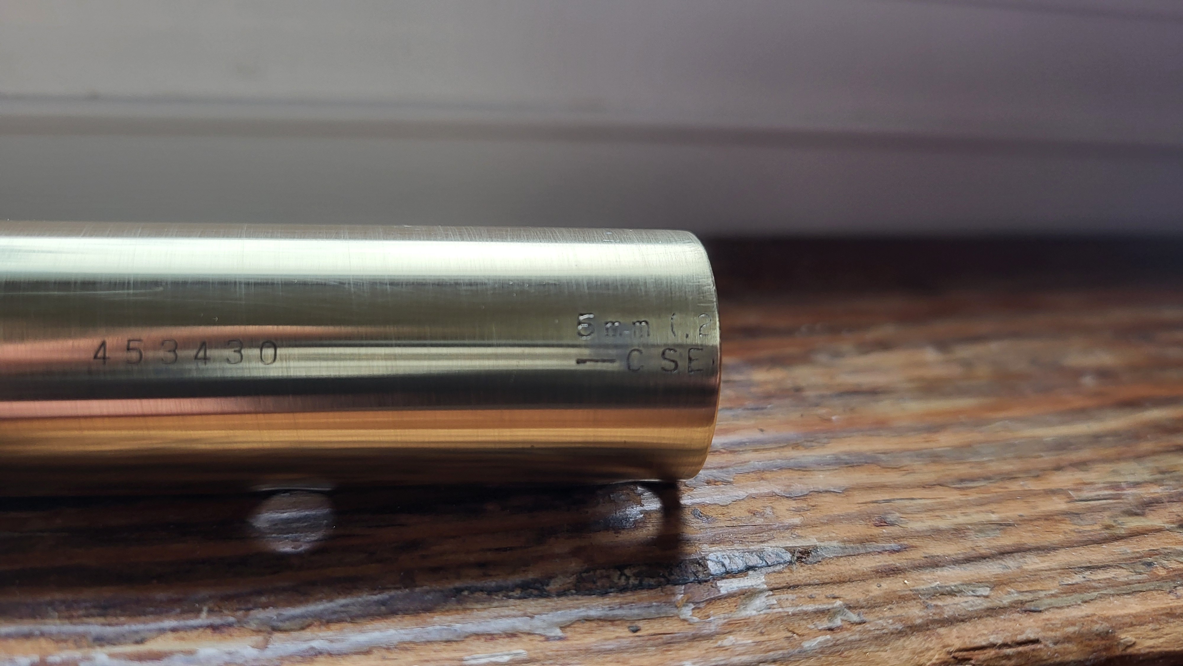

      It has a fragment of the original lettering on it - looks like a couple inches were removed at some point. You can see the "5mm" stamping - .20 cal, I think?.
      Click image for larger version  Name:	20240331_111913.jpg Views:	0 Size:	1.41 MB ID:	526974

        For future reference, solder sticks to nickel very well. I use the same solder and flux and get good results.
        Ion Long Rifle
        Spyder Pump
        BST Feedback
        Brass Thread
        - - YouTube - -
          Jordan commented
          I wanted to go all brass on this one so I sanded the nickel off... but I'll remember that for the next one!

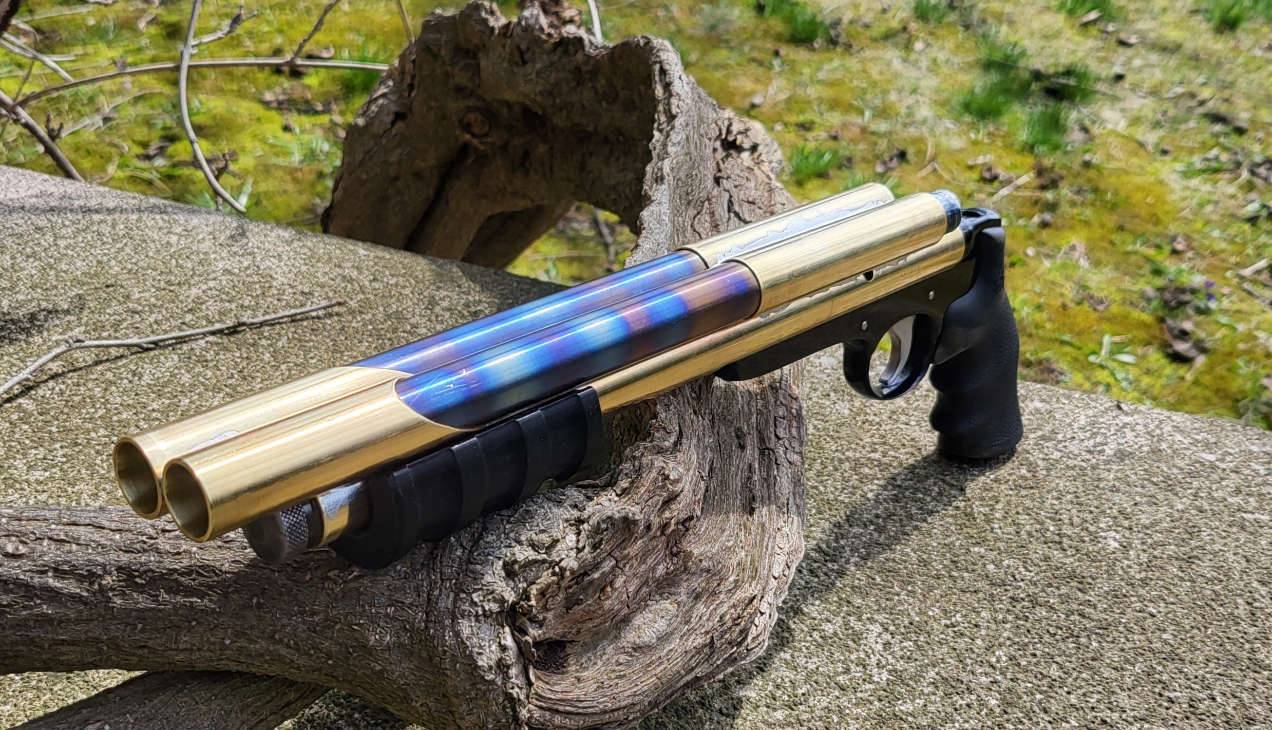

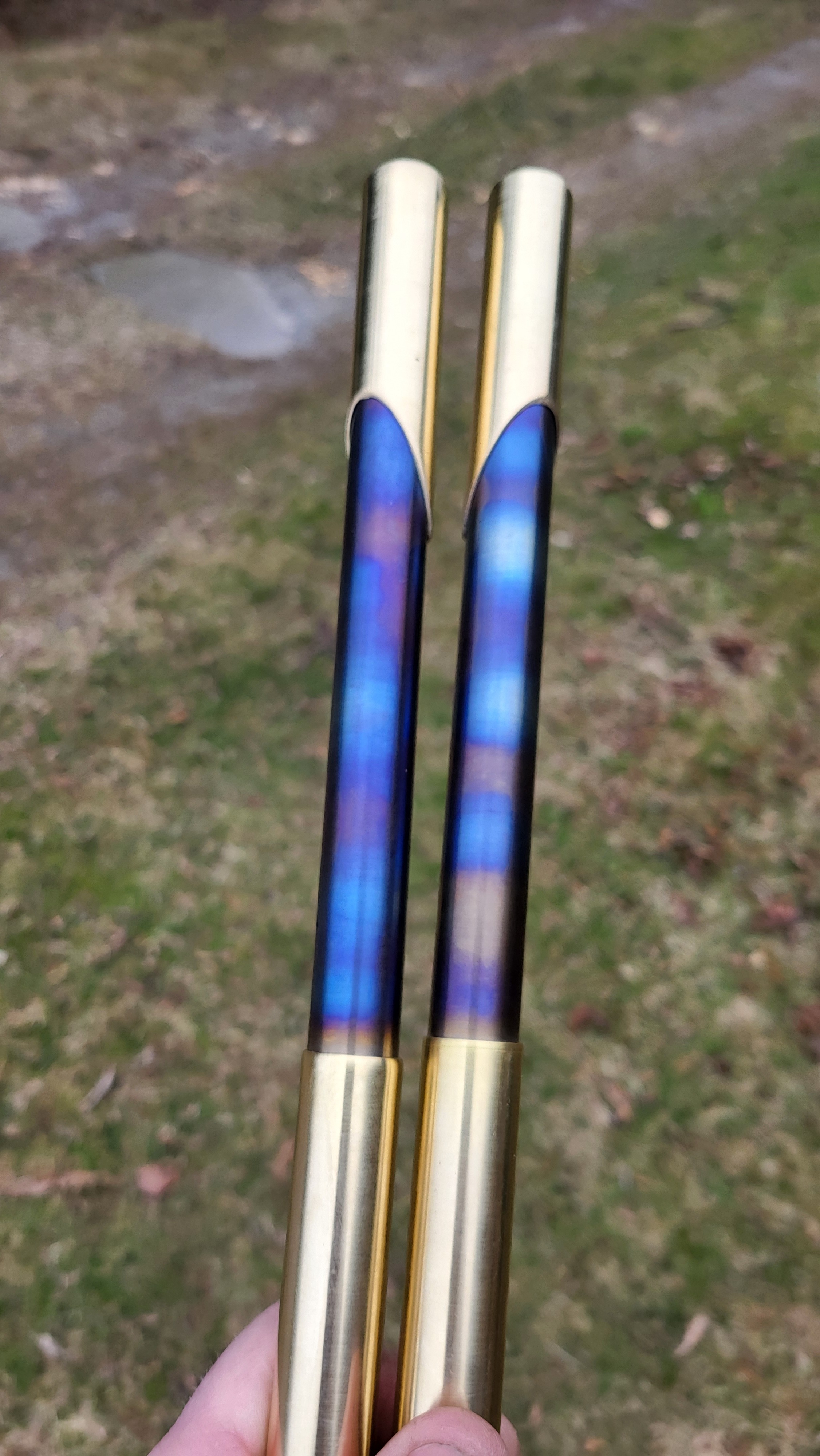

        Couple of barrel assemblies...
        • JeeperCreeper
          JeeperCreeper commented
          Very nice. Love the 45 cuts.
          BrickHaus commented
          Bruuuh
          Oh my that is gorgeous!
        I. Am. Canadian. 🇨🇦
        • 3508
        Thanks! I needed to add a threaded piece for the 12gram cap but I didn't want a super long section of brass covering the Titanium, so I figured that was a good compromise.
        Here's what was added...

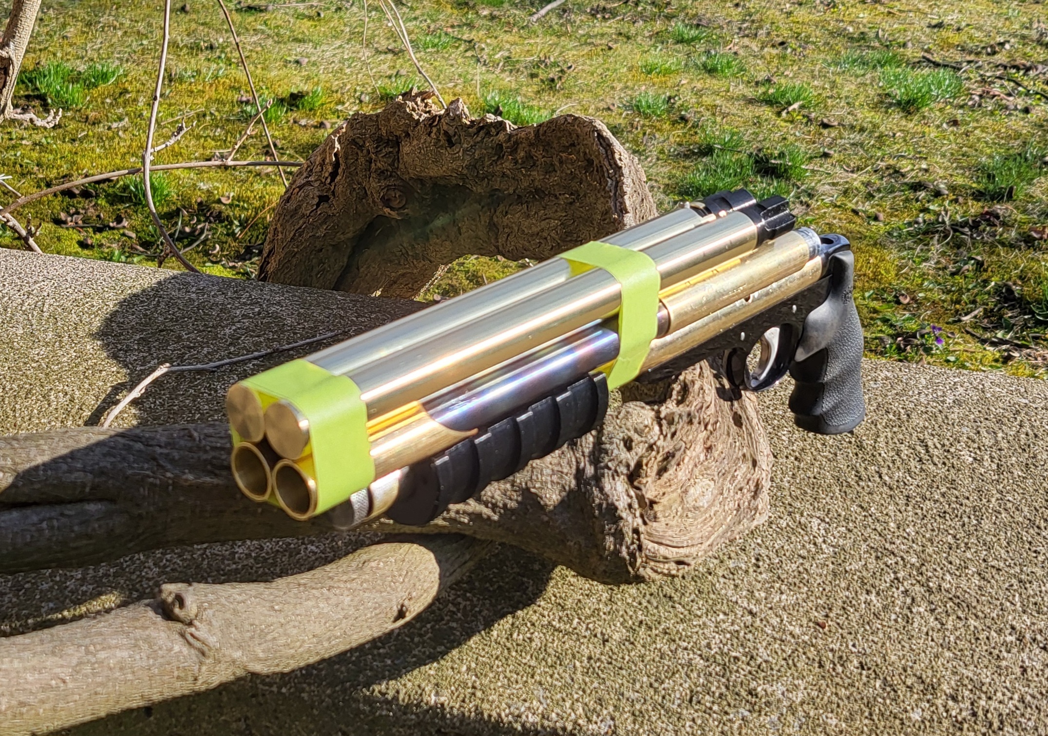

          I. Am. Canadian. 🇨🇦
          • 3508

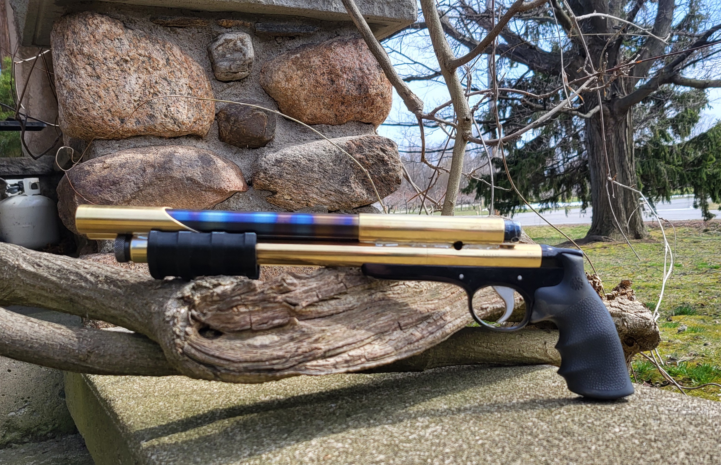

          The road so far...
          I still need to cut the feedholes and make up a couple of feedtubes with Thadapters of some kind, and get a couple of bolts. And make a pump arm, probably brass.
          Leave it brass? I'm not 100% sold on the Kframe either, might make it a pirate or put my .45 on.
            • 3415
            You are seriously a wizard my guy.
            • AnarchicArctic
              💀Founder Ragnastock💀
              • 963
              • Berkshires
              I’m a big fan of 45° cuts too. Looking real sharp man good work! I vote pirate for what it’s worth
                Pirate stock for sure it will complete that boom stick look.
              • 3415
              Unpopular opinion, but I'd put a cocker frame under it. With 2x barrels, and 2x feed tubes it'll center your gravity a bit better. Plus I enjoy stretched out grips, but it seems to be a long reach as it sits, and a pirate will space the same.
                Jordan commented
                I do like the rifle feel - my KP with my Tactical Pirate Grip Mod is a blast to use - so I'll try it out with the Kframe first, but I've got my .45 Mag frame (that used to live on my Pursuit pump) that I can use.
            • AnarchicArctic
              • 963
              • Berkshires

                The breeches are made of 3/4" OD brass tubing [0.692 ID) that is sanded down and pressed into 21mm (19mm or 3/4" ID) brass tube. I made the outer tube slightly longer than the inner by about an inch, then sanded down the exterior of the titanium tubing (also 3/4" OD) and pressed that into the breech assemblies.
                The end tips are made the same way - there's roughly another inch of brass .692 ID tubing that finishes off the ends, so the titanium is sandwiched between two sections of brass.
                The brass bits get soldered in place like usual... the Ti seems to act like a heatsink so the tips took a little longer to heat up and cool down.
                • AnarchicArctic
                  AnarchicArctic commented
                  Word. I had my suspicions, thanks for the confirmation. How long did it take to sand that titanium?
                  Jordan commented
                  Way too long. 🙂

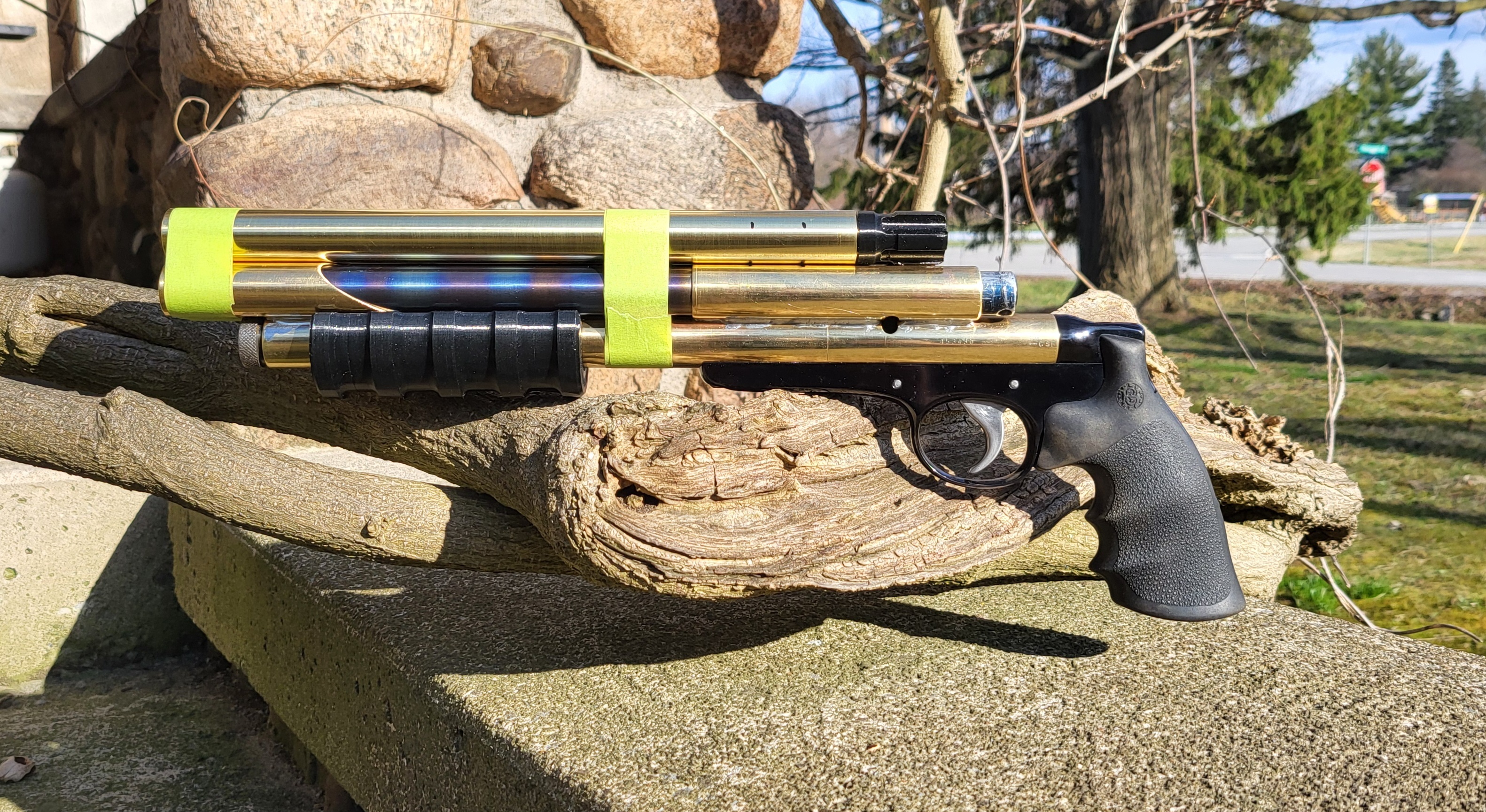

                I. Am. Canadian. 🇨🇦
                • 3508
                Got the feedtubes made - I dug through several boxes and found back some matching feedplugs and a longer pump handle that Alexndl printed me, so that part's set - but I still need to cut the feedholes in both the feeds and the breeches.
                I taped 'er up to see how it looks... I think it's turning out pretty decent.
ID:	527105 Click image for larger version
                • Cal440
                  Cal440 commented
                  Very nice work!,the feed tubes going all the way to the front is quite intimidating 😳
