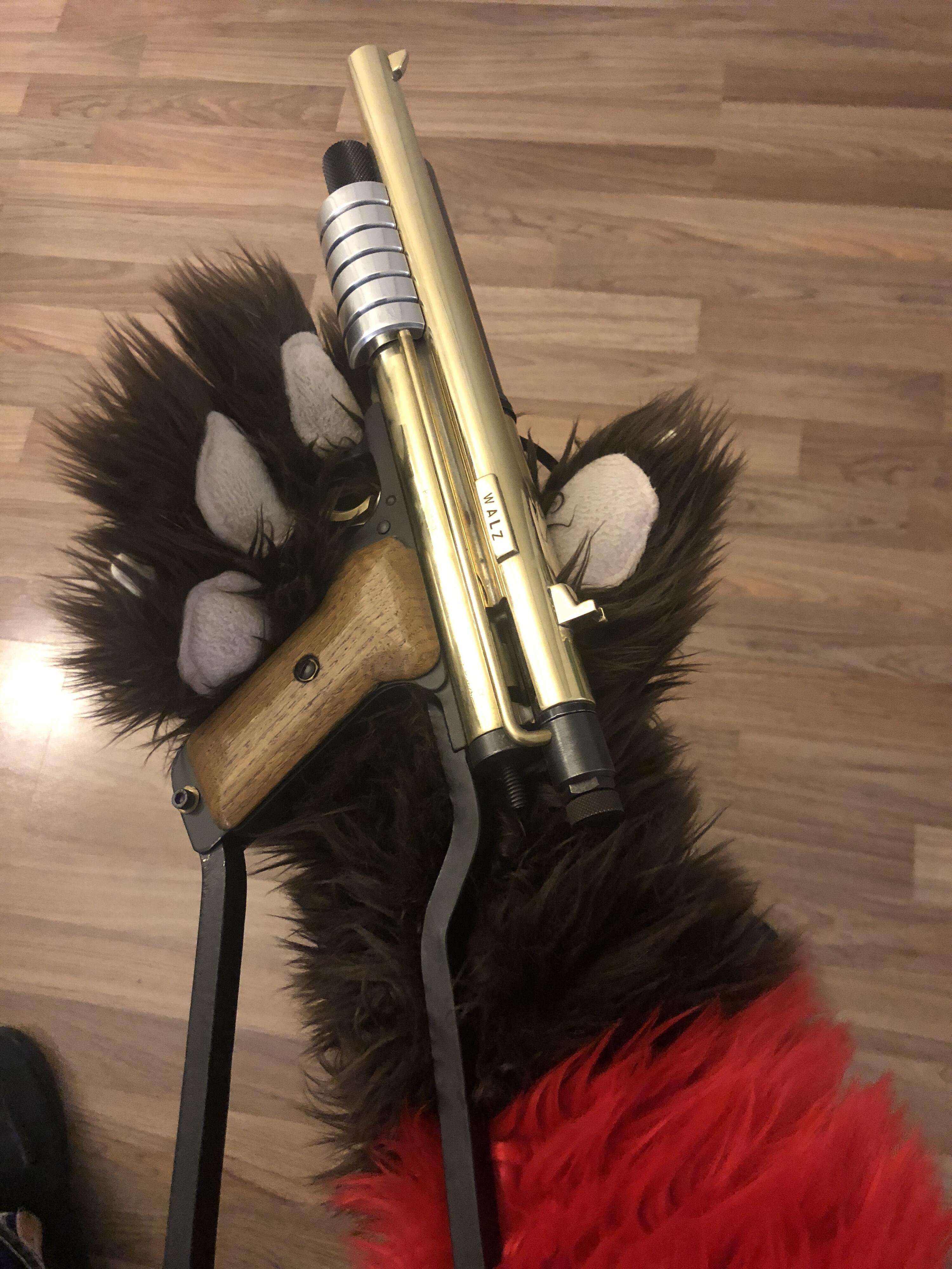

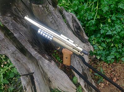

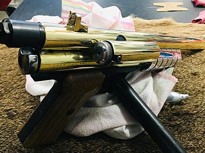

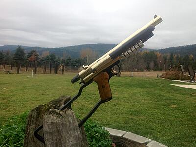

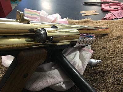

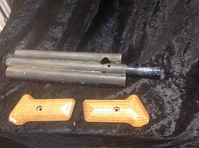

    Last year BeniotOWN received a pgp body, bolt and a set of grips...
    I offered to make him a working marker so he sent me his parts..
    He bought a piece of new barrel tube from xemon and had it sent also..
    I cut his pgp tubes apart to use the bottom tube but the threads for the co2 nut were trashed so I found another lower tube to work with..
    cut his new barrel to length, drilled out transfer tube passages to 1/4"', slotted it for hammer lug, made a quick strip notch, and drilled out for side tube feed. Cut a couple pieces of tube for the side feed and sleeved them together and drilled out ball passage.
    I had a speed demon bolt so feed passages were cut pmi bolt length instead of pgp length.
    Soldered the whole together and drilled out and added a brass detent.
    opened up the valve and drilled and tapped for a grub screw on underside to hold valve hole aligned straight up..
    installed a palmers fast changer that BeniotOWN had palmers send me...
    made a WALZ logo for her.
    The stock pump rod was to short for the pmi bolt so I made a new one with brass...
    Made a simple set of front and rear sites...
    new main spring with ball on modded back plug rva...
    cut groove into handle to bypass feed and polished pump handle..
    added a metal stock that comes with two rings for mounting tank
    aslo came up with a constant air adaptor, hose and asa for it..
    tossed in a umb for bottom grip mounting also....
    i think that is it....

    Very Snazzy. Wonderful Work, good sir!
      Frenchy is here!
      • 3019
      • Nor Cal
      So shiiinyyyy ...
      • Axel
        AI-Powered Mod Bot
        • 2233
        All that glitters is not gold
        Sometimes it's brass 👍
        • Trygve
          • 179
          Dang thats beautiful
            • 6380
            So nice!
            • BenoitOWN
              Foxy
              • 557
              • Canada
              It’s in fox paw’s now.
              • BenoitOWN
                BenoitOWN commented
                Sadly it barely fit in those big fingers!
                Thanks Wally for your work and offering.
