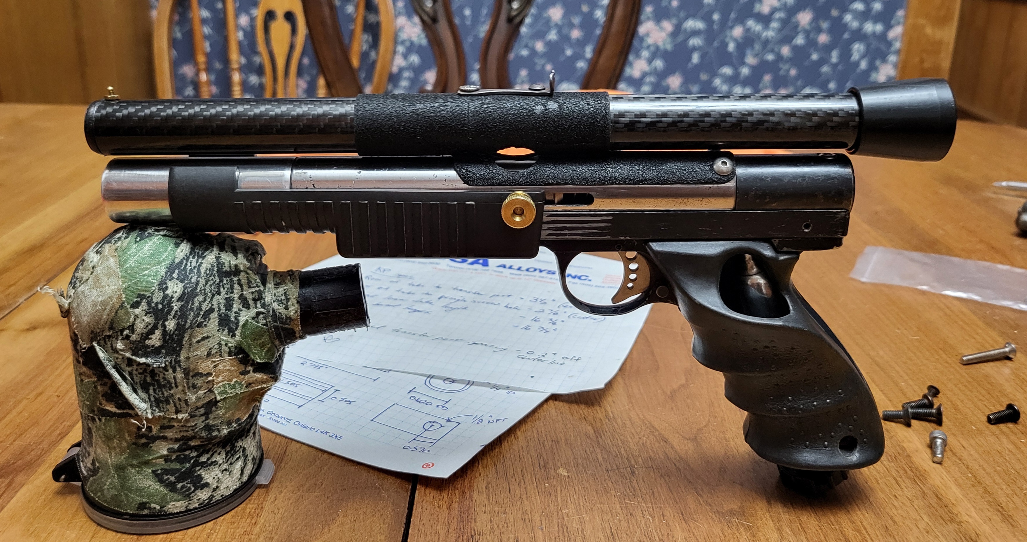

    I think I'll be building a CF Freak XL for one of my pumps.
    Tubing is here: https://a.co/d/206PhBw
    I used some metric brass tubing for my upper tube on my PMI Pursuit build - it's 23mm OD, 21mm ID, which fits almost perfectly over the CF tube.
    23mm tube is here: https://a.co/d/2t4MoeM
    If I add a tip I'm going to use a piece of thinwall 3/4" OD brass tube I got from Online Metals last year - it mic'ed at .685 ID and my largest XL insert is .684 - and I'll slide some 21mm OD tubing over it to protect it a bit, probably spiral port it to keep everything quiet.

    Thanks for sharing this information!
      XEMON commented
      I've made a few Sheridan's with cf barrels and feed tubes 👍
      Jordan commented
      XEMON - I've seen 'em and they're awesome. 🙂
      I'm not claiming to be the first to do this, I just seem to be the first to post info on what I'm using and where to get it.
      XEMON commented
      I do like your idea with freak inserts. I used stiffy barrels with mine 😁
      I will need to copy your idea on the next one 👍

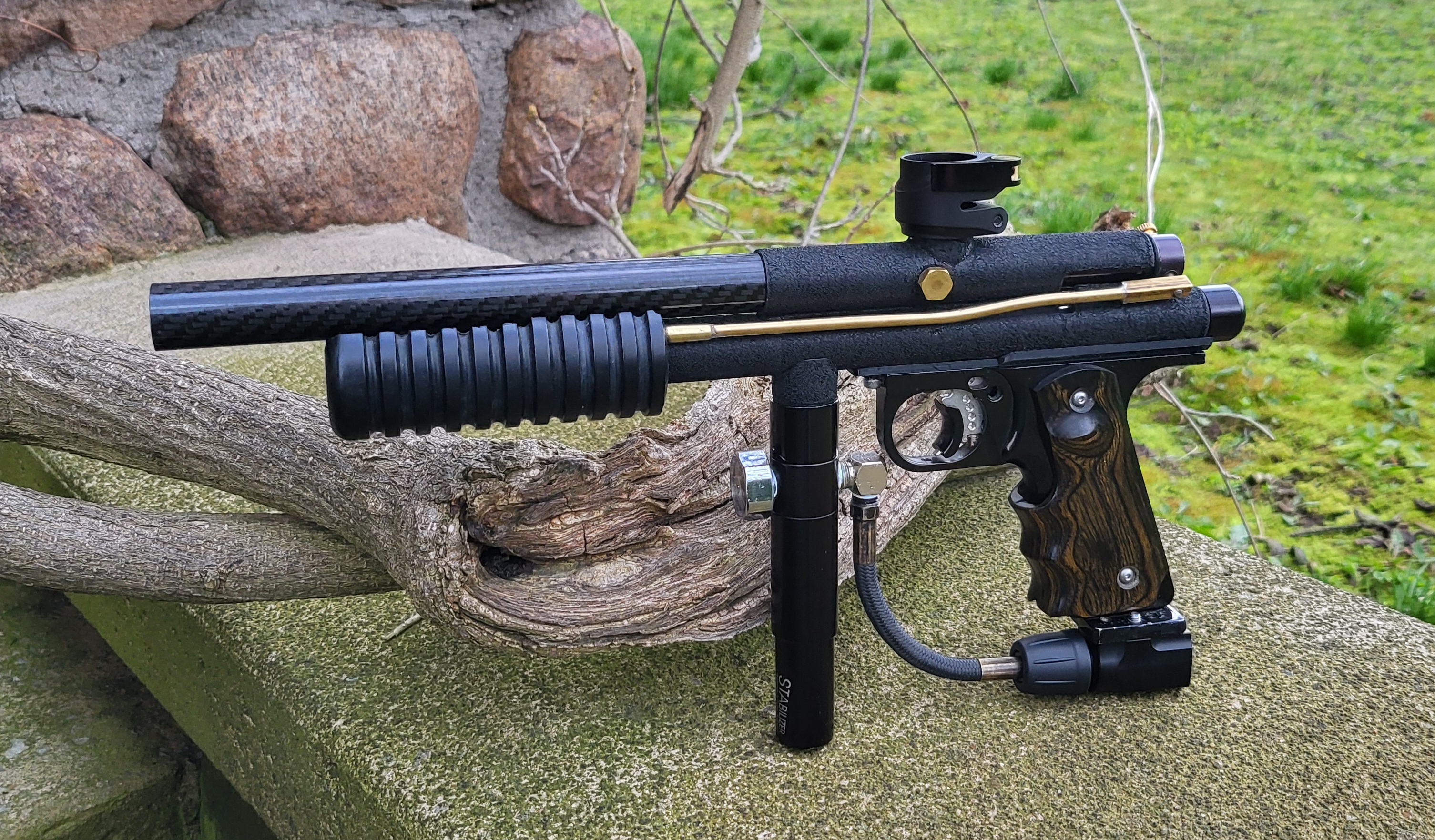

    And the reason I bought the tube in the first place... my Nelspot. The feedtube setup I built uses some 23mm tube soldered together, a small piece of 21mm tube inset inside with a 3dprinted end plug and feedplug from Alexndl, and the CF tubing. I added the PGP sightrail and beadsight to class it up a little - gotta have some brass in there, after all. 😉

    • flyweightnate
      flyweightnate commented
      I love this build.
    • Cal440
      Cal440 commented
      Wow,nice nelspot!
    • Psycho91
      Psycho91 commented
      This is probably the only Nelly I'd ever play with, doesn't have some junky looking feed on it lol
  • maggot
    • 497
    Damn, dude. Those are two sweet builds!
      Jordan commented
      Thanks, my dude! Been picking away at them for a while, just a couple little things to finish up.

        Is there specific equipment or procedures needed to drill a feed size hole in the cf tube?
          I. Am. Canadian. 🇨🇦
          • 3525
          Probably. I didn't want to mess around that - CF dust is sorta bad for you - so I used the brass bits for that part. The CF tube is two separate pieces joined together by the brass section. Assembly is much easier that way as well.
          • Cal440
            Cal440 commented
            Thanks Jordan for pointing out my lack of paying attention to what I read.I should of looked a little longer at the picture, I might have figured it out. You really do build some cool shooters. Did you print the 007 pump handle, would like to find one for mine?
            Jordan commented
            Cal440 thank you sir! That is a stock 007 pump handle, I don't have a 3d printer and rely on the patience and generosity of a couple of members, who do, to provide me with all my 3d printed components I use.
            Wish I did, but then again that sort of tech stuff is not my strong suit. I'm much better suited to manipulating physical materials in real time.

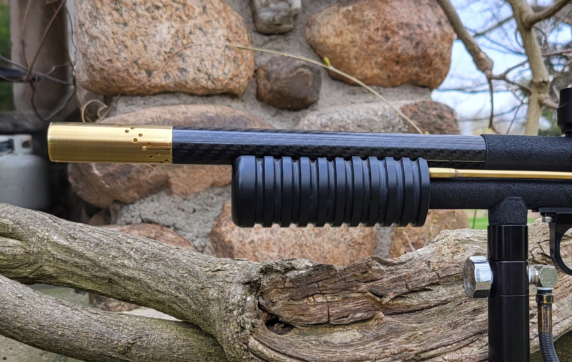

          Finished off the barrel tip this morning and epoxied it in an hour ago - I'll test it out tomorrow.
          I wanted to try out a different porting pattern as well - I went with a dual spiral in a tighter curve than I usually do.
          • Cal440
            Cal440 commented
            The brass, cf,black color combo looks excellent, really like the look!
          • JeeperCreeper
            JeeperCreeper commented
            That's hot 🔥
