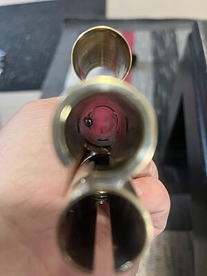

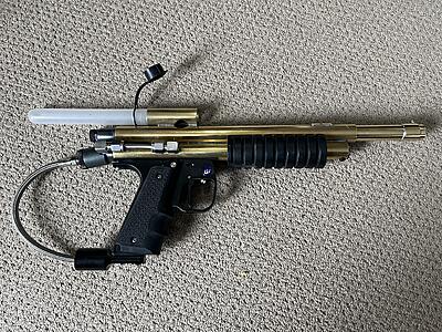

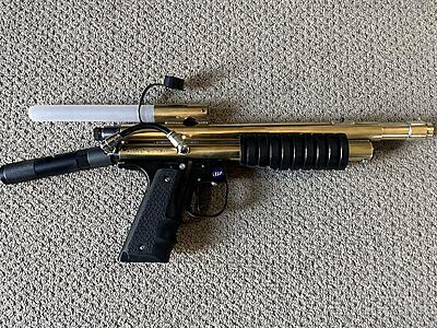

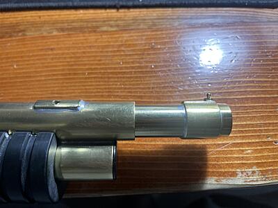

    Shortened the Barrel, to 10" OAL, 5" of freak insert, and 5" tip, also added a ring and a bead sit to make it more than just a tube haha. Waiting on a brass thumb screw that will secure the barrel tip.

      Really like the look of the barrel front.

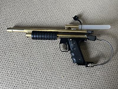

      Had some cocker frame adapters 3d printed, and stuck a WGP 1.5 frame on it. Have to find a 7/8'' powerfeed plug for the front of the cram N jam, and am thinking of adding a T stock, either with a bottle mount on it or 12 gram lever changer T stock, something along those lines...

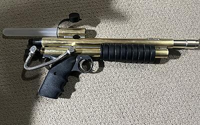

        Made a Power feed Plug from a piece of Maple Dowel, painted black, Switched to macro line, kept having leaking issues with the hardline, did some test shooting today getting about 35 shots on a 12g C02 @ 285fps. eventually may add a rubber spyder style detent if double feeding becomes a issue in game.

          Looks great, really like the setup now with the 12 gram changer. Could you show a closeup of your barrel retention, also nice design on the barrel tip.

        Its essentially friction fit, with a 8-32 brass tipped set screw. soldered on some more material to have more threads for the set screw. I tighten the set screw minimally.

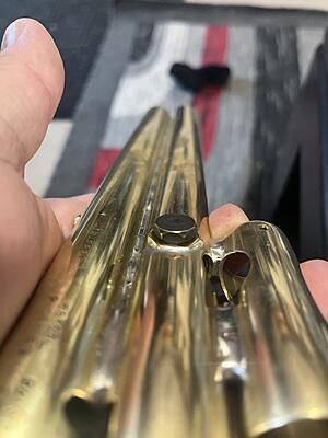

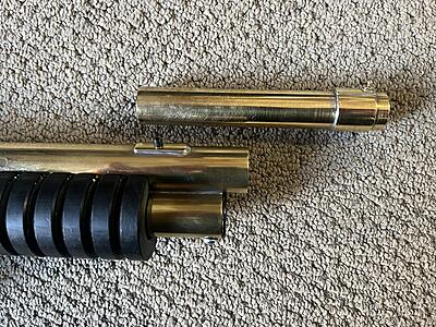

        Experienced a couple double feeds my first game out with the PMI II, so decided to install a Cocker detent to remedy that.

          Did you just braze a flat onto the side or did you use a piece already threaded for cocker detent threads?
        • Heavy_D
          Heavy_D commented
          Yes, I took a 3/8-24 brass nut, cut it in half, then sanded to the tube profile, drilled the tap size, used a dowel to align it, Solder it on, then tapped all the way through, then spent a while filing it to custom fit the depth of the detent.
