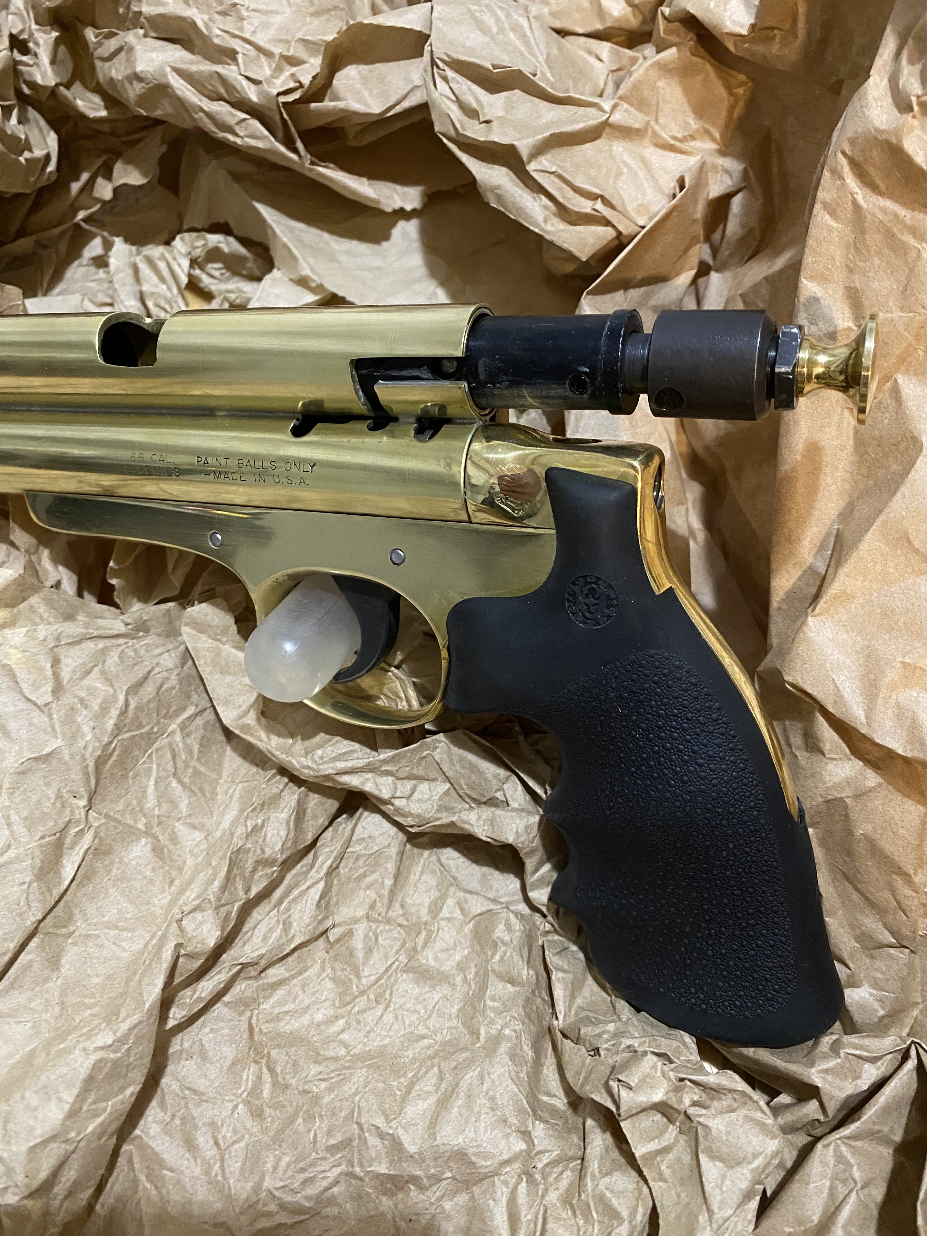

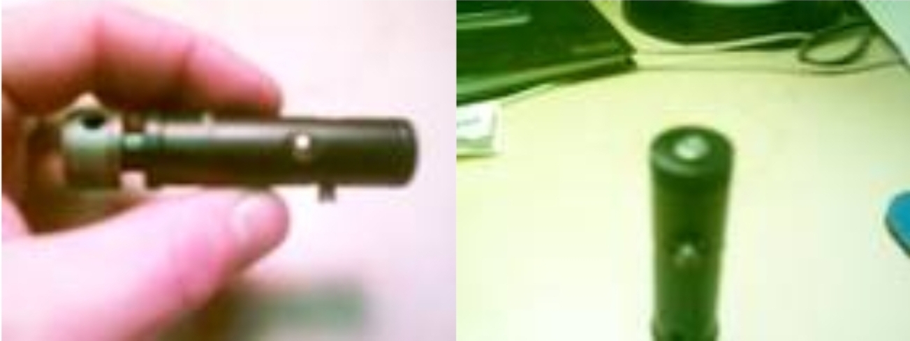

        Here's the bolt I have;
        Here's what it looks like fully cocked back:
        And here's where you can see how the shop trimmed the original bolt to length so it'd fit in my gun.
        ETA: Reeeally not sure what happened with the pics here.

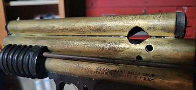

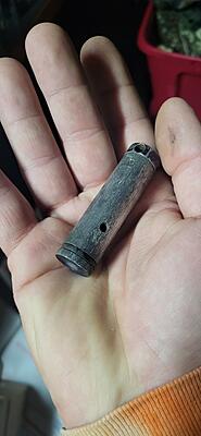

              Poking around, I found one pgp bolt where the someone poked one of the Teo bearings out of the bolt. The right side bearing is in there still.
              The other bolt is from a super crusty rental my friend sold me. Probably an early pgp or pg convert, but has no bearings nor no body holes for said bearings.
              • chplnstone
                chplnstone commented
                bolt's likely from a bb-in-handle type pgp, they bridged the gap between pg & double bb in bolt

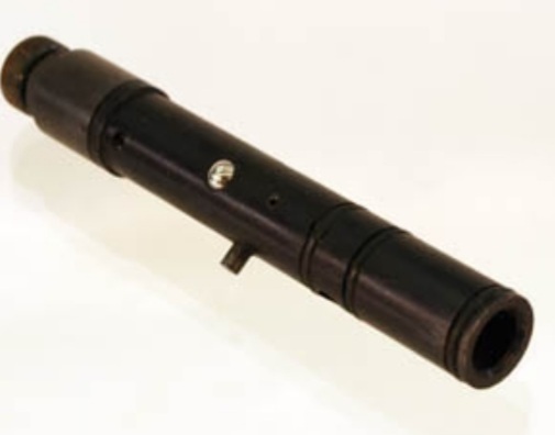

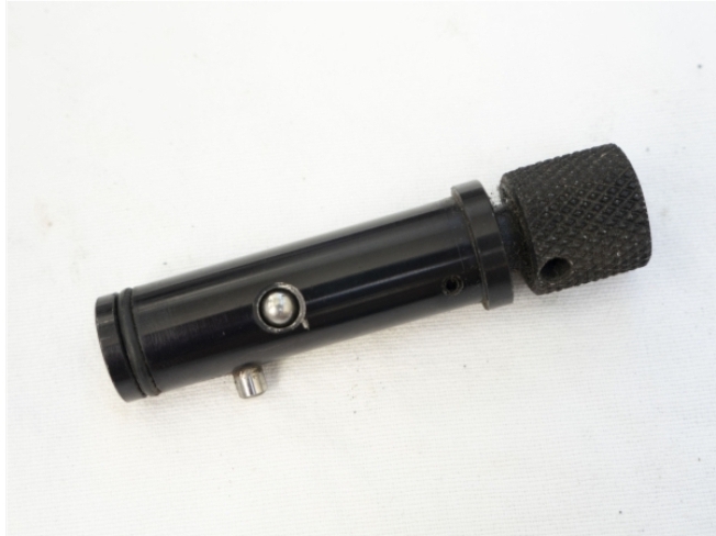

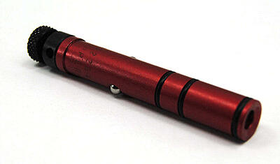

                The PGP2k bolt also have a similar design as the "speed demon" one. I'm not sure I ever saw a "Speed demon" bolt for PGP, they where always the longer PMI spec (PMI 1, P68SC ans other). But you could put the PMI bolt on a lathe to make it PGP spec. Cooper T seem to have made a few PGP bolt but they are quite rare.
                Cooper T bolt
                Click image for larger version  Name:	Screenshot_20250102-082042_Chrome.jpg Views:	0 Size:	197.6 KB ID:	638608
                https://www.stockclasspaintball.com/.../pgp2kbr.shtml
                Speed demon bolt
                PGP 2K bolt
                Your best option would be to find a PGP2k bolt.
                PGP 2k had all the improvement you could want on a standard PGP (upgraded bolt, fast change 12g thread, RVA, cartridge valve and quick feed).

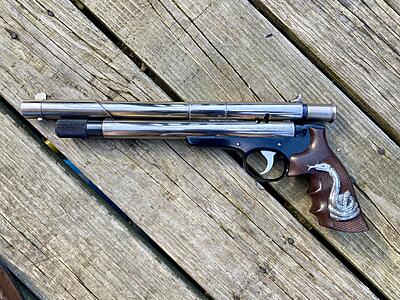

                    I put a kp bolt into my scrap pgp build. But there were definitely some shenanigans involved. Note the longer top tube
