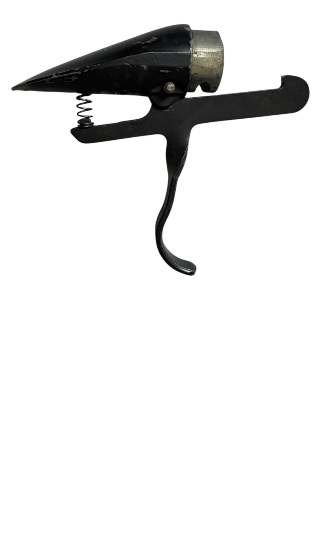

    Like the title says I'm looking for info on the air rifle back caps that people use in kp style builds with Sheridan bodies like the pgp. I think I've found a lead in some that are compatible with some Sheridan streak models. I've attached a photo of the one in looking at in case that helps Screenshot_20250201-191309.png

    That's a Bluestreak trigger group. The cap works on any K-series (or P-series, really) but the trigger will only work with a Bluestreak, or "C" hammer. It might work with a P-series hammer with modification.
    You need the double-lobe trigger for a KP.
      BrickHaus commented
      the single lobe trigger is whats on my pgpness. itll work, you may have to file either the sear, or the cap a bit to make clearance depending on tolerances.

    Would a trigger like the one in this link be a simple swap out job to make it work with a p-series?
    https://www.jgairguns.biz/c-c-78_332...r-p-13728.html
    I'm debating grabbing one of these back caps for a project down the line, but it's a bit pricey so I'd prefer to keep any modifications if need to make simple and reversible

      they are spendy for sure, once you built a brass up you quickly realize why people want 600-800 dollars for built brass. That double lobe trigger wont work in a ppgp lower unless you take the second lobe off. There isnt enough travel to utilize the second lobe.... Well maybe is you have a newer stype p series hammer with the relief in it it may work, but I havent tried it.

    looks like the original question is answered, I had a thread on k-converting p-series that was unfortunately lost to the hack that had more detail. as people have said, the single lobe c-series is the closest to the right length as you'll find pre-made, i typically cut the hammer to fit the sear vs. the other way round (or simply make a trigger/sear to fit from scrap tool steel).

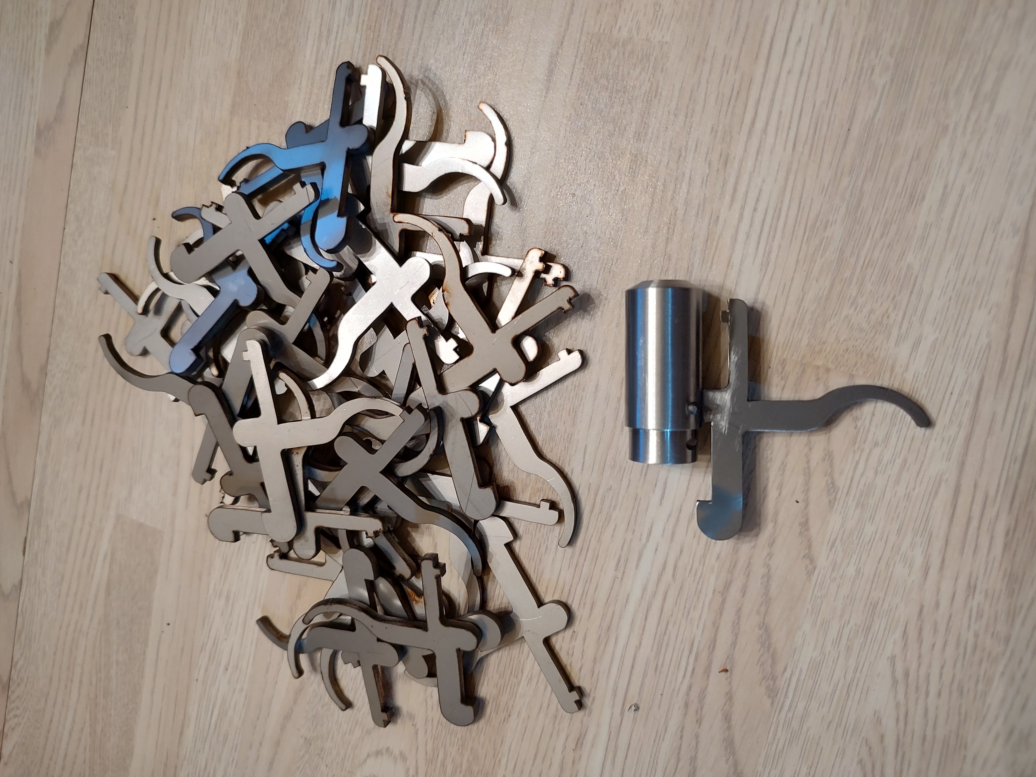

        G&H Custom Works offers a custom rear block with trigger plate. RVA incorporated. It can be set up for either a K or P series Sheridan. IMG_20240815_201733226_HDR.jpg
        G&H Customs
        We don't make show ponies. We make war horses.
        • Impactfour
          Impactfour commented
          It looks like my order did go through with the airgun website, we'll see if I can make it work when it arrives some time next week. If not then an incorporated RVA sounds pretty nice!
