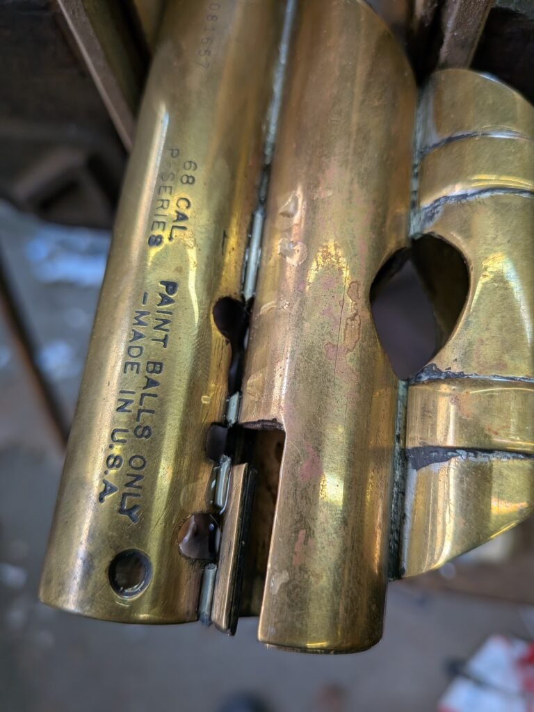

    Issue: the bolt was skipping past the hammer every couple strokes.
    Root cause: failed solder joint.
    The plan: repair the joint, then reassess the connector pin length. If it’s short, we make a better one.​

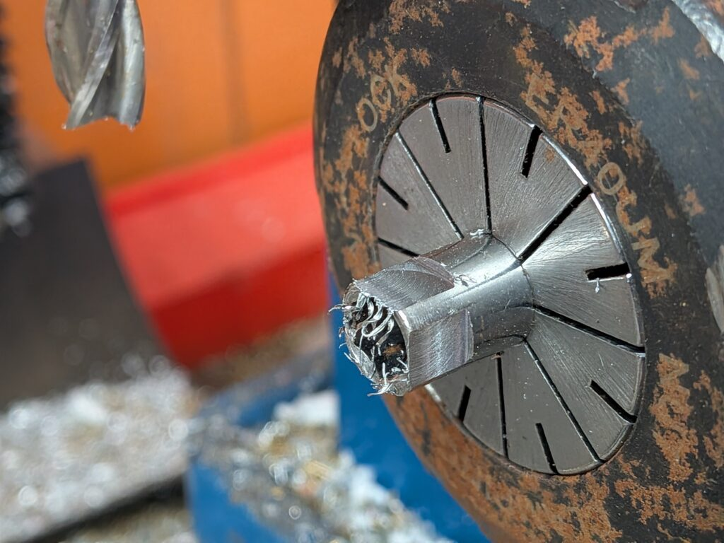

    ​Naturally, I forgot my valve tool.
    So… side quest #1: make a valve tool.​
    Then, silver soldder.

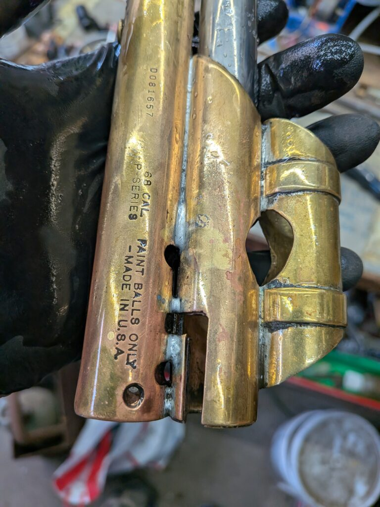

    Once everything is cleaned and fluxed, I cut a few small bits of silver solder and place them along the failed joint.
    All soldered up!

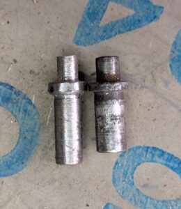

    Once reassembled and tested, of course the pin is too short.
    After a few minutes on the lath, we have a new, longer pin.

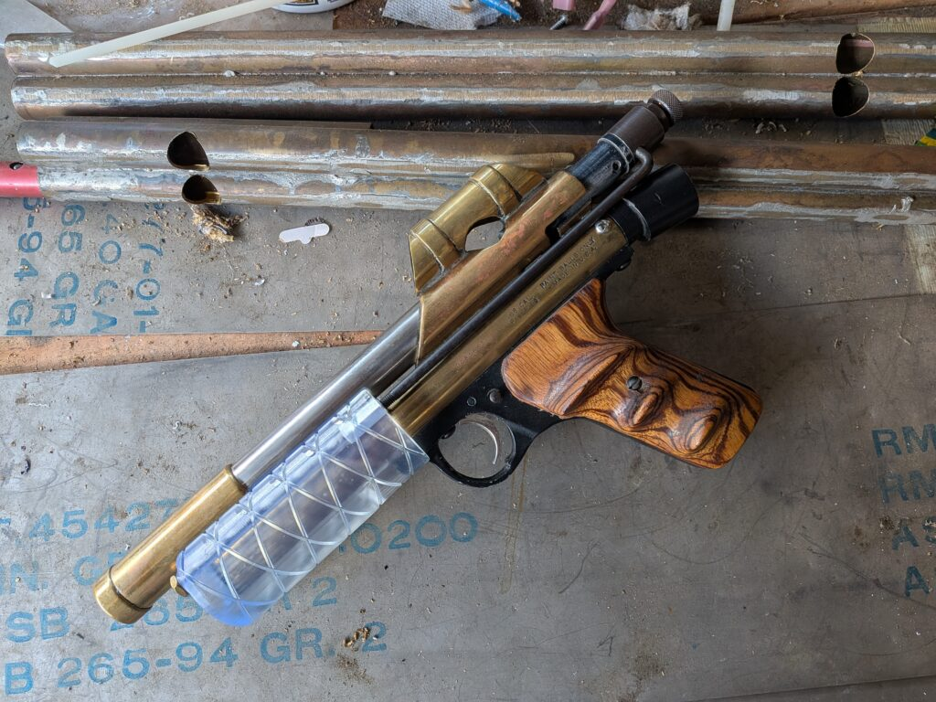

    After a final re-assembly, we have a fully functional and ready for the field “Little WALZ Shooter”
    And we got a bonus Sheridan valve tool too.
