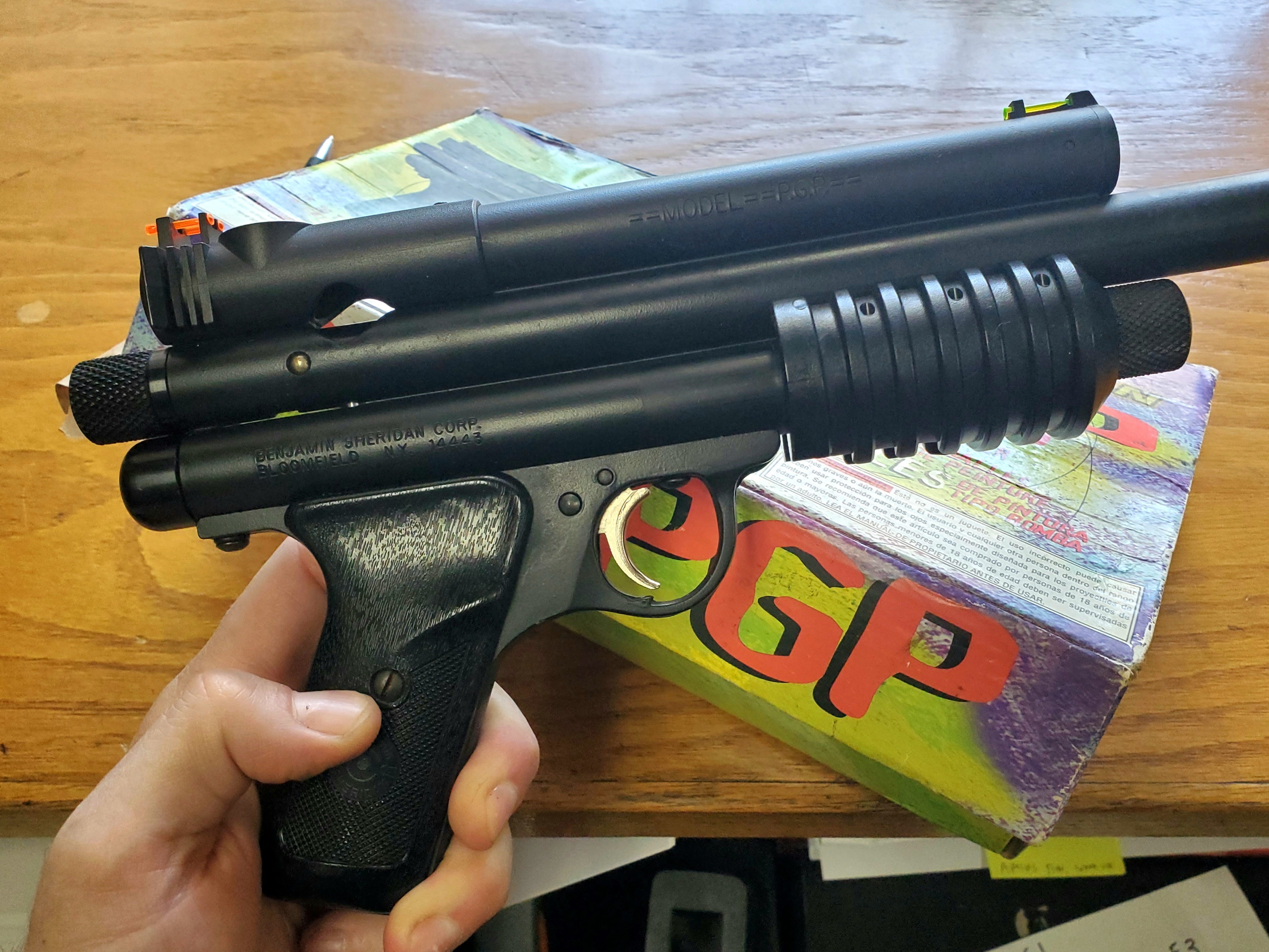

    I just got this on ebay, its a like new pgp2k which I've always wanted. Even has the sales receipt.
    I want to bring this into service and use it, I just ordered seals from PGP junkies (from what I can tell the 12 gram seal is crumbled so it leaks when you put a cart in it)
    everything else seems perfect but I know the plastic feed gates break easily on these
    and I remember the bolt tends to chop paint and there was a Cooper T upgrade.
    And does anyone freak these barrels or install detents?
    Also grips. Is there a source for any other thing now or do I just put a WTB ad out?​

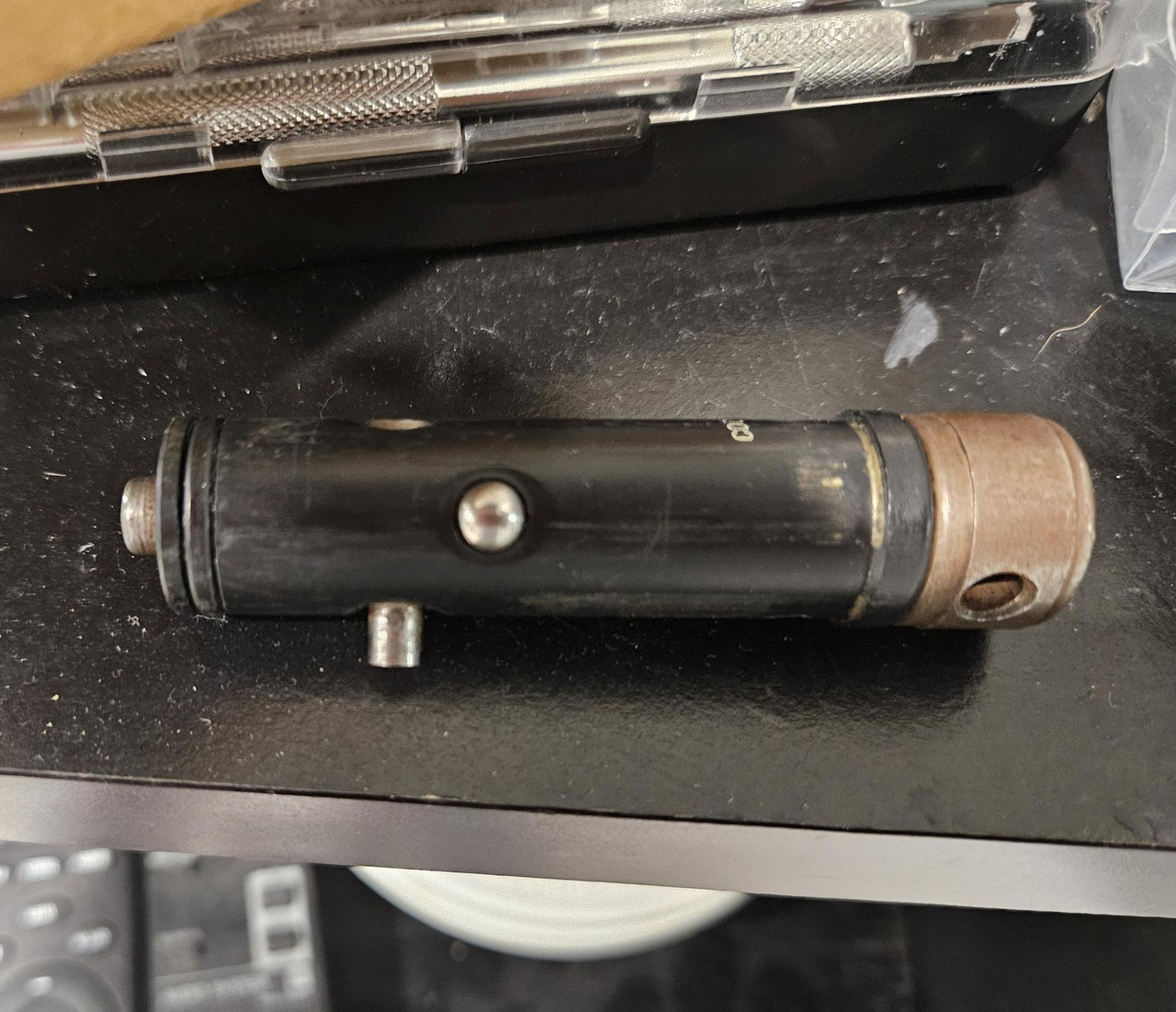

                  I have one of these as well in pieces bit with a modified Bolt from Punishers Customs back in the day. Essentially, the bolt face was drill in the center and a small flat bolt got connected to the rear part of Bolt that unlock ball bearings. The Bolt on face is then flush in rearmost position and when pushed forward, it would move the ball forward the distance up the lock up. This effectively moves the ball PAST the valve port a bit which solved the problem. Sheridan put the valve opening too direct beneath the ball. This is worth looking into as well, but would need to be done a bit forwad if you do the bolt mod:
                  https://youtu.be/S39vzP5XyJ4?si=SlSpeBQchNtmiMLK

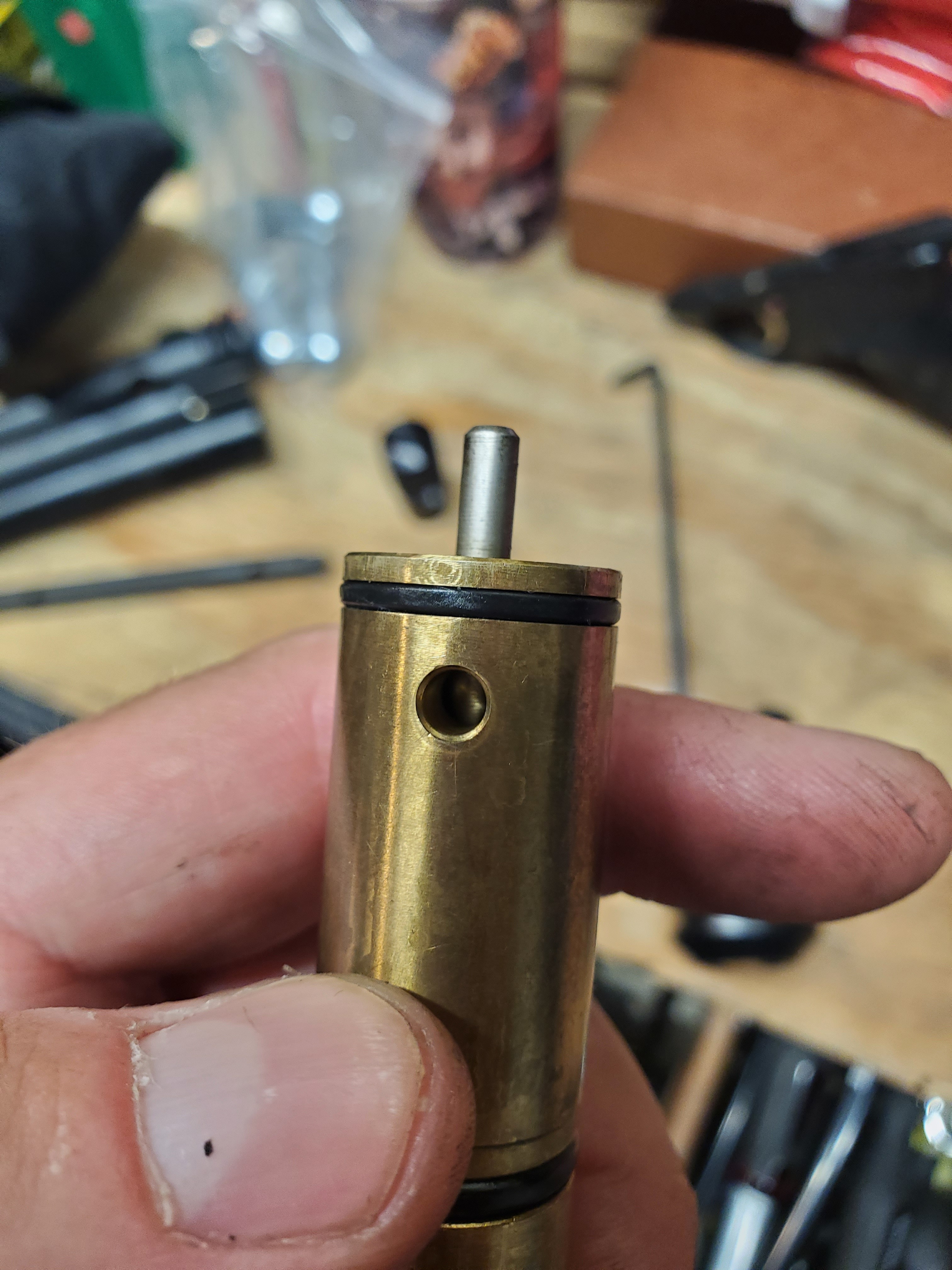

                    Jim used CCM S6 detent covers to add finger detents to his brass build. I thought that was a really cool idea and it looks clean and works well. Eliminates rolls outs with the need for a freak. I would do this mod after you figure out what you want to do with the bolt because it may change the balls location.
                    There are a few different center fire bolt options however they can be hard to find or a lil more costly to get someone to let it go. I have found a decent amount of them at local stock class events.
                    My Creeper Customs “PGP” was modified for a KP Speed Demon center fire bolt. It requires a bit of customization to work.
                    Another option is to start with a PMI that’s already KP length speed demon that is center fire.
