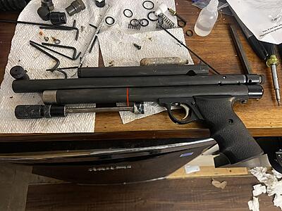

    I’ve had this since 2002 or so and never got it running. The 12g changer is too long. Would that fit some other model or do I just need to chop it down and rethread?

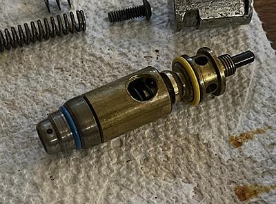

    Also, is the hole in the space normal? I am rebuilding this and realized I hadn’t seen others with that hole. Thanks!

    I think the quick change setup is for a kp type and as far as that hole in the valve sleeve, I have never seen that done or know what purpose it serves. That’s a first for me, home brewed.

      That hole is from a side tapped sheridan, should not be an issue ...
      The quick change is definitely for a longer lower tube.
      Do you have a side port on the other side?
      • jonbobshinigin
        jonbobshinigin commented
        No holes anywhere on body.

      Just cut down the CO2 rod, looks like a PMI 1 SC with an RVA and "Fasst Change" added. The Speed Demon Bolt is the giveaway...
