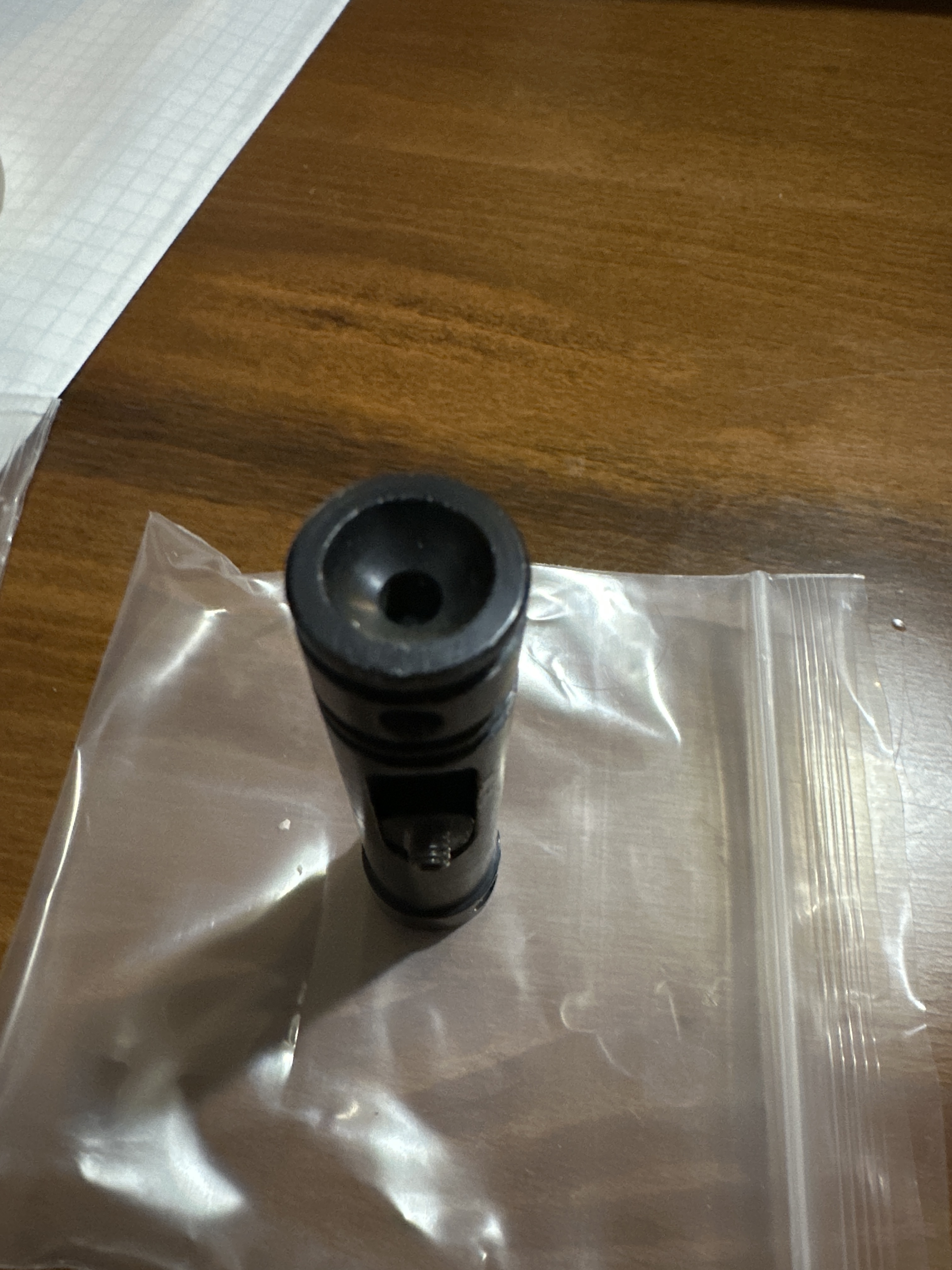

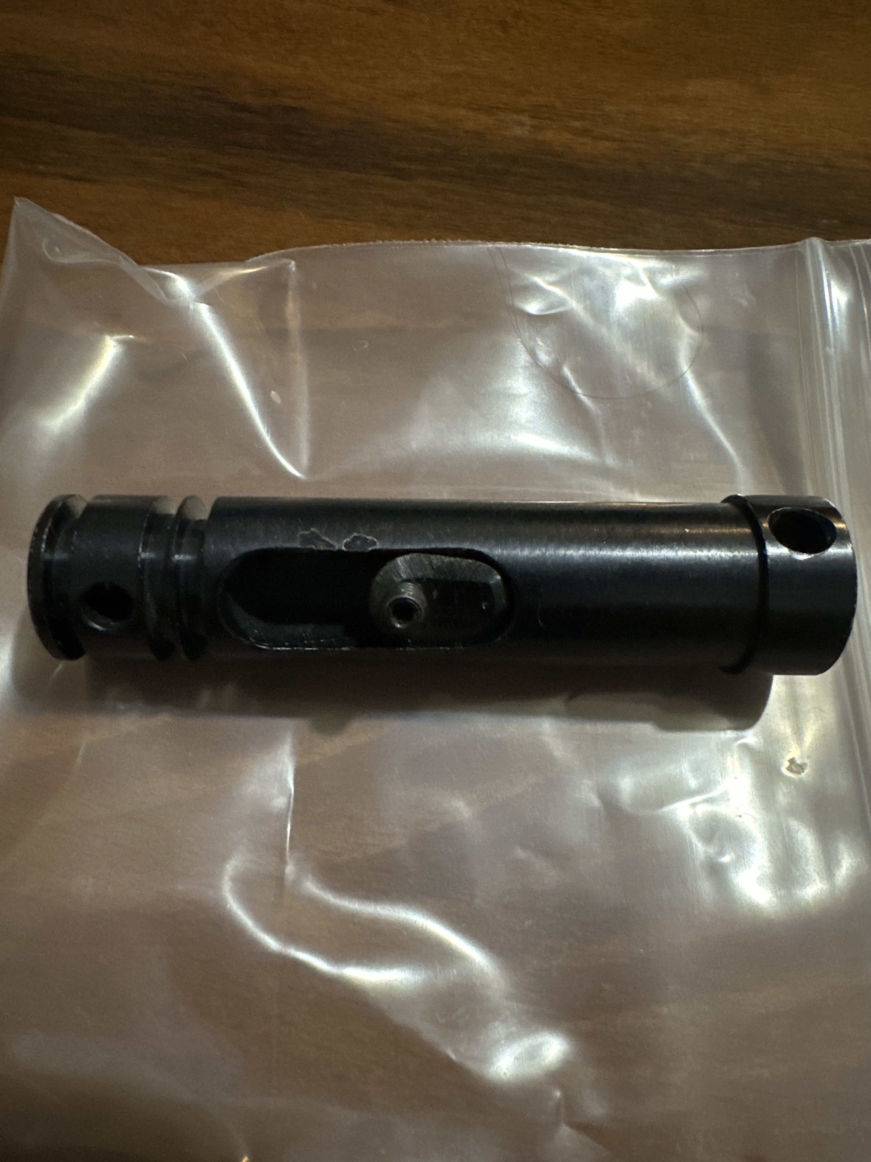

              Also these are the General Joes bolts I was talking about. They are PGP spec have breach orings and convert a PGP to center fire. They make a big difference in paint handling and feel. They slightly increase pump stroke length by about 1/2”.
