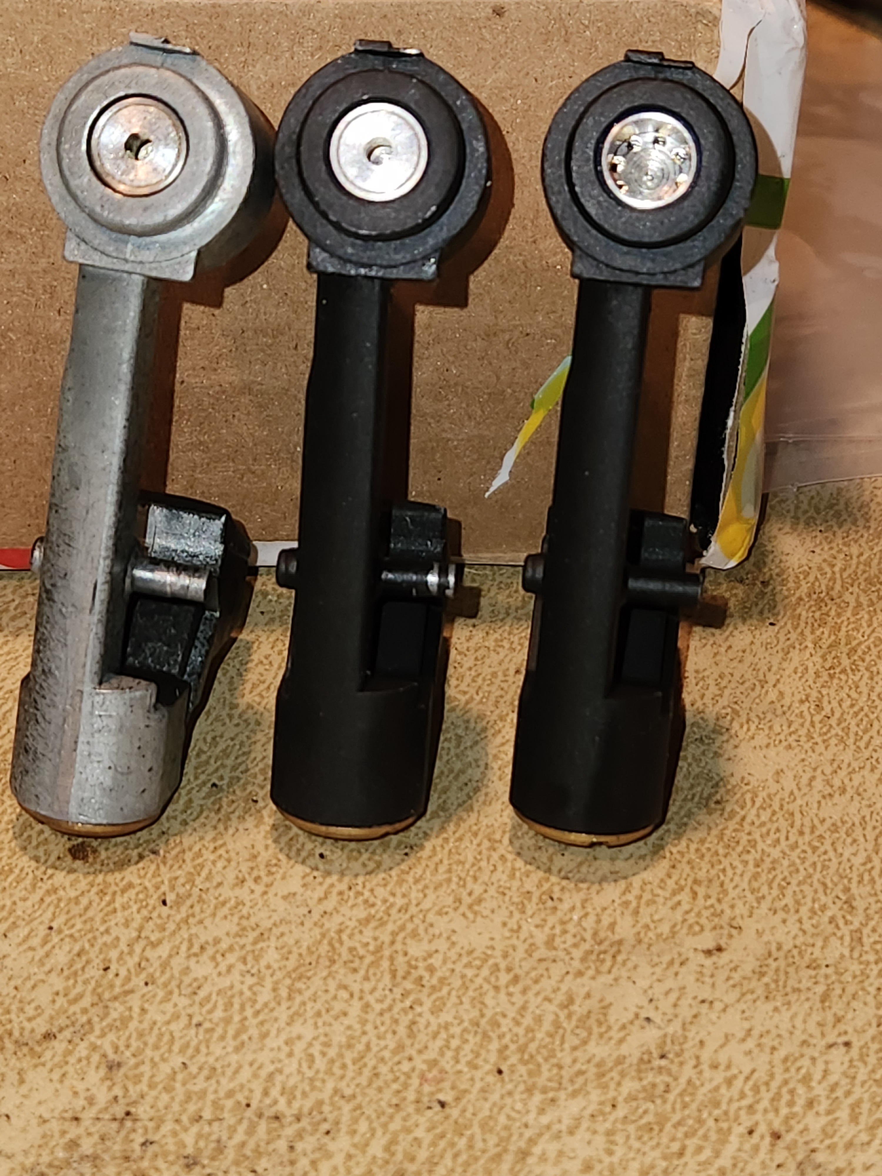

                              These are Roscoe Valves that I have. The far left is a Gen1 low impact valve. Middle is another low impact . Not sure if is a swap out or a Gen2 low impact. The far right is a high impact valve, fresh out of the package.
