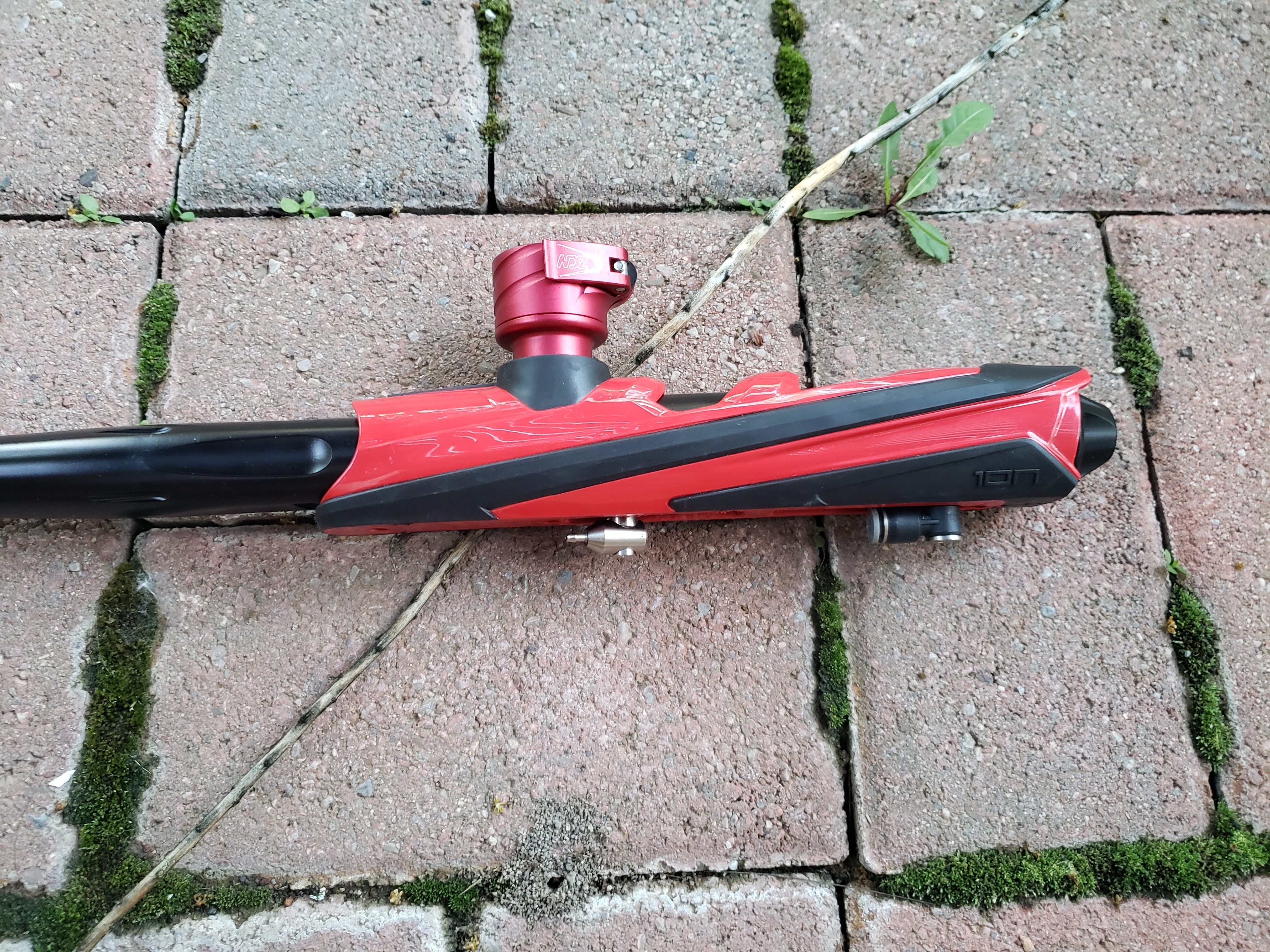

          I have an XE breech/firing can and red body kit that I'm planning on using, with a Shocktech bolt... I decided on a BOB (bolt out back) setup so I didn't have to worry about pinching hoses and removing fittings every time I service it.
          I have a matching reg cover and set of grips as well. Gotta keep everything matchy-matchy! πŸ™‚

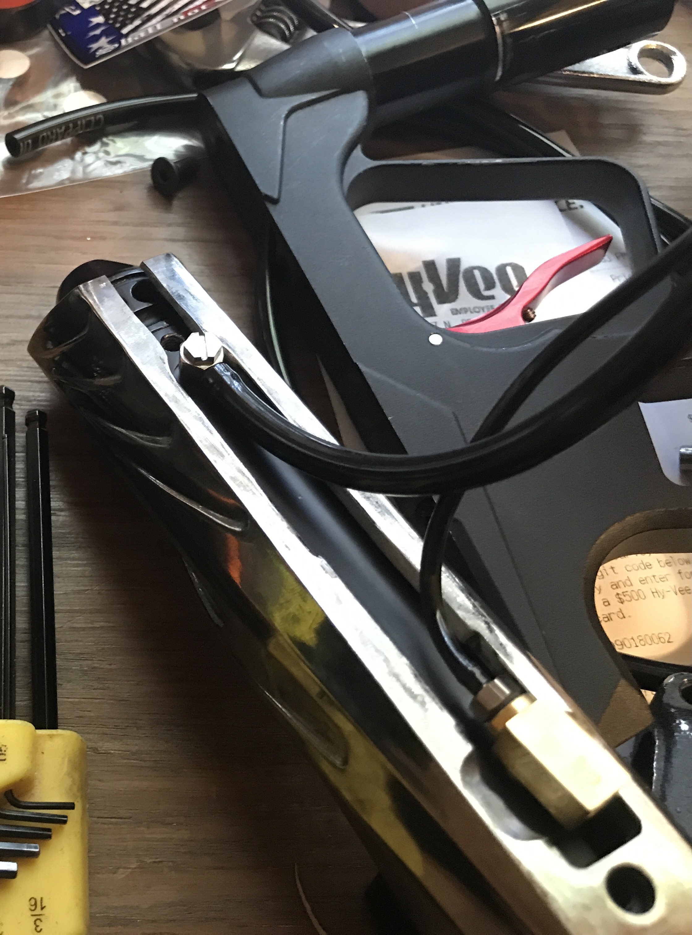

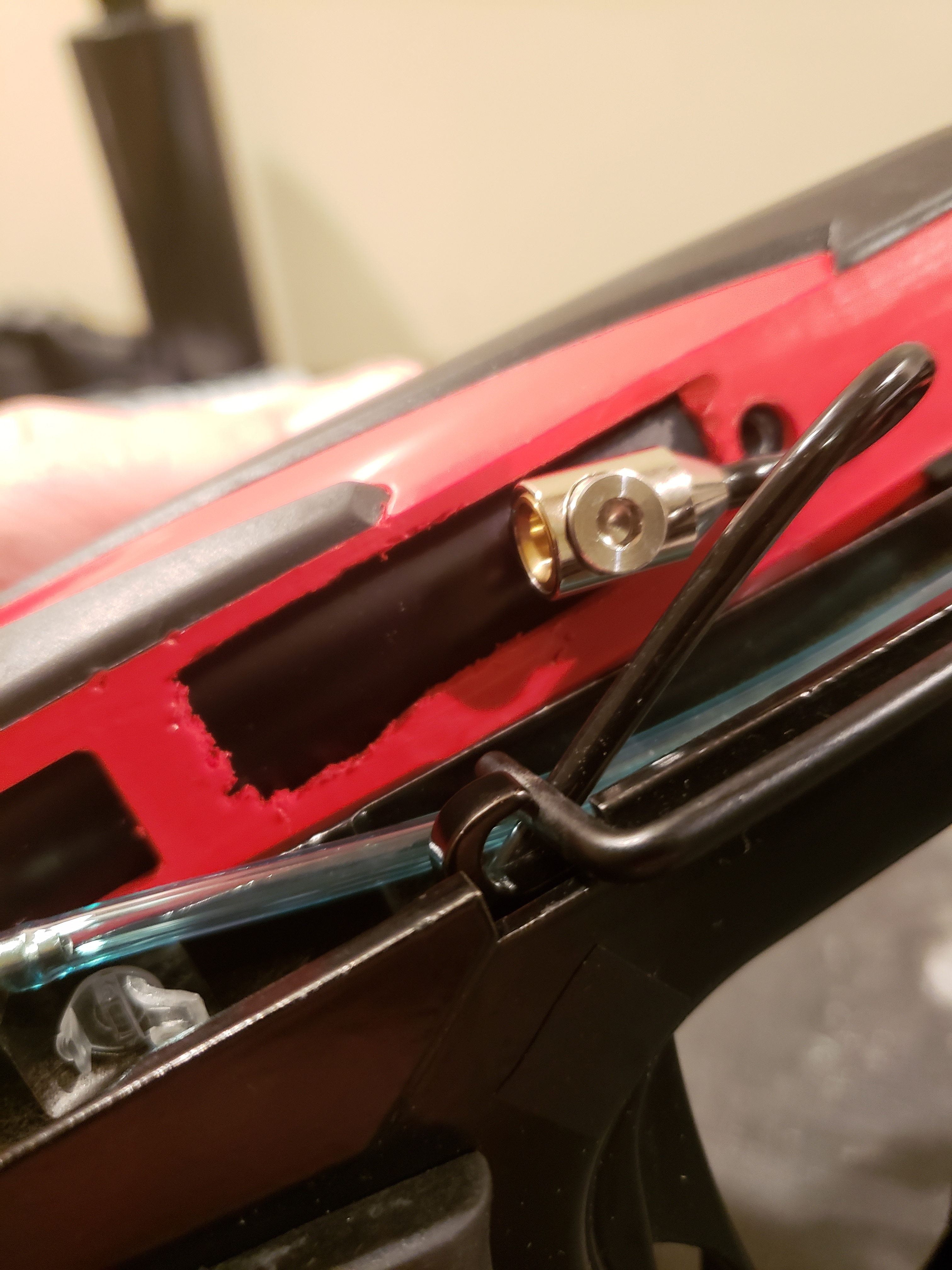

          Here is my test setup
          • nobbie333
            MCB Member for life
            • 465
            • Kansas City, Missouri
            I also discovered that if you remove a couple of the cross supports you can remove the body with out removing the hoses

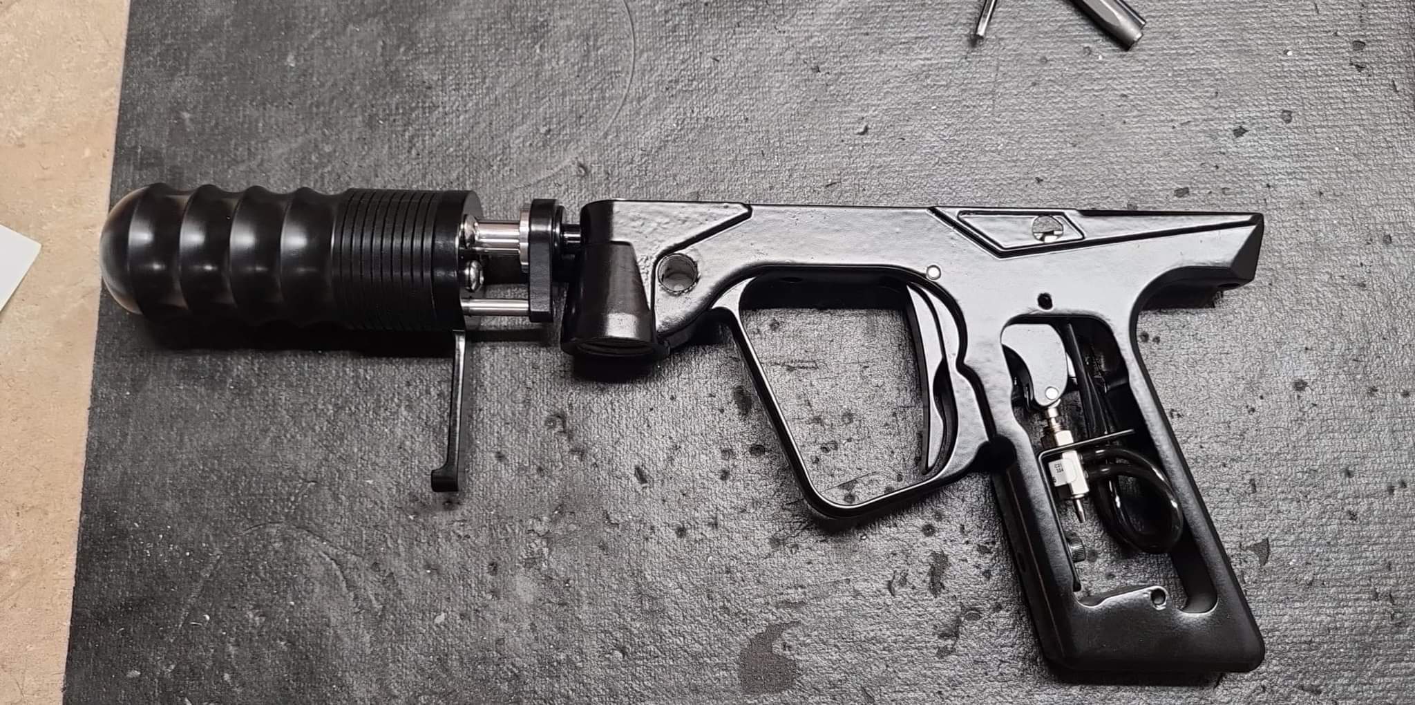

                The pump arm just resets the trigger - there are no additional bits inside other than the custom trigger plate Ed designed.
                The SMAV is relocated, from behind the trigger to below the trigger... when the gun is "cocked" the trigger plate pushed down on the 3way valve which directs air to the front of the bolt, pushing the bolt back. When the trigger is pulled, the bottom tip of the trigger plate, where it interacts with the 3way, pulls away from the 3way, releasing it and venting the air in front of the bolt, allowing it to move forward and fire the gun.
                That custom pump Ion that uses two valves to fire is very cool and not at all how Ed's pump Ions work. It's similar to a pump Automag in that it's essentially a broken mech Ion.

                  Ahhhhh, so it operates as open bolt! This fixes so many things I've been assuming with how these things work!
                  Fred aka ChoSanJuan
                  Team: With Intent
                    I. Am. Canadian. πŸ‡¨πŸ‡¦
                    • 3512
                    Yup... one reason I like it, no rollouts.
