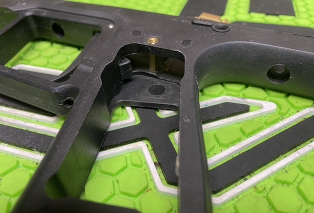

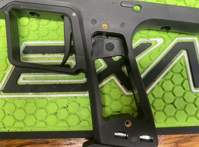

                        • 4565
                        Here’s the frame of an SP1. They annoyingly use essentially a very long nut for the grip frame screws, so it is solid between the grip holes. Looks like best option would be to find a normal nut that size or cut this as it’s the ideal spot for the SMAV.
                        0BD2D1C9-5CFA-4797-BEBB-6CF5ED7AAD3B.jpeg 8DE31549-83BB-42AE-9D81-D5D44FD25686.jpeg
                          Cdn_Cuda commented
                          I ended up mounting the SMAV on top of the large nut that holds the grip frame screws. The SMAV sits and an angle and has good contact with the trigger and should be enough room for the hoses. I'll update with a picture of the horrors I committed to mount the SMAV once I confirm it works.
                          Cdn_Cuda commented
                          It’s alive! Finished fixing the hosing on my SP1 and closed it all up and everything is working. Pretty easy to do. Though my QEV seems to squeak.
